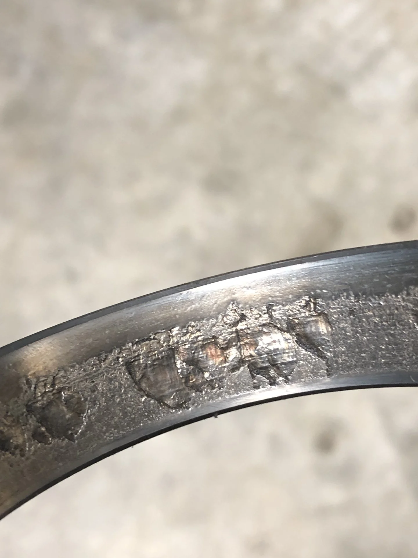

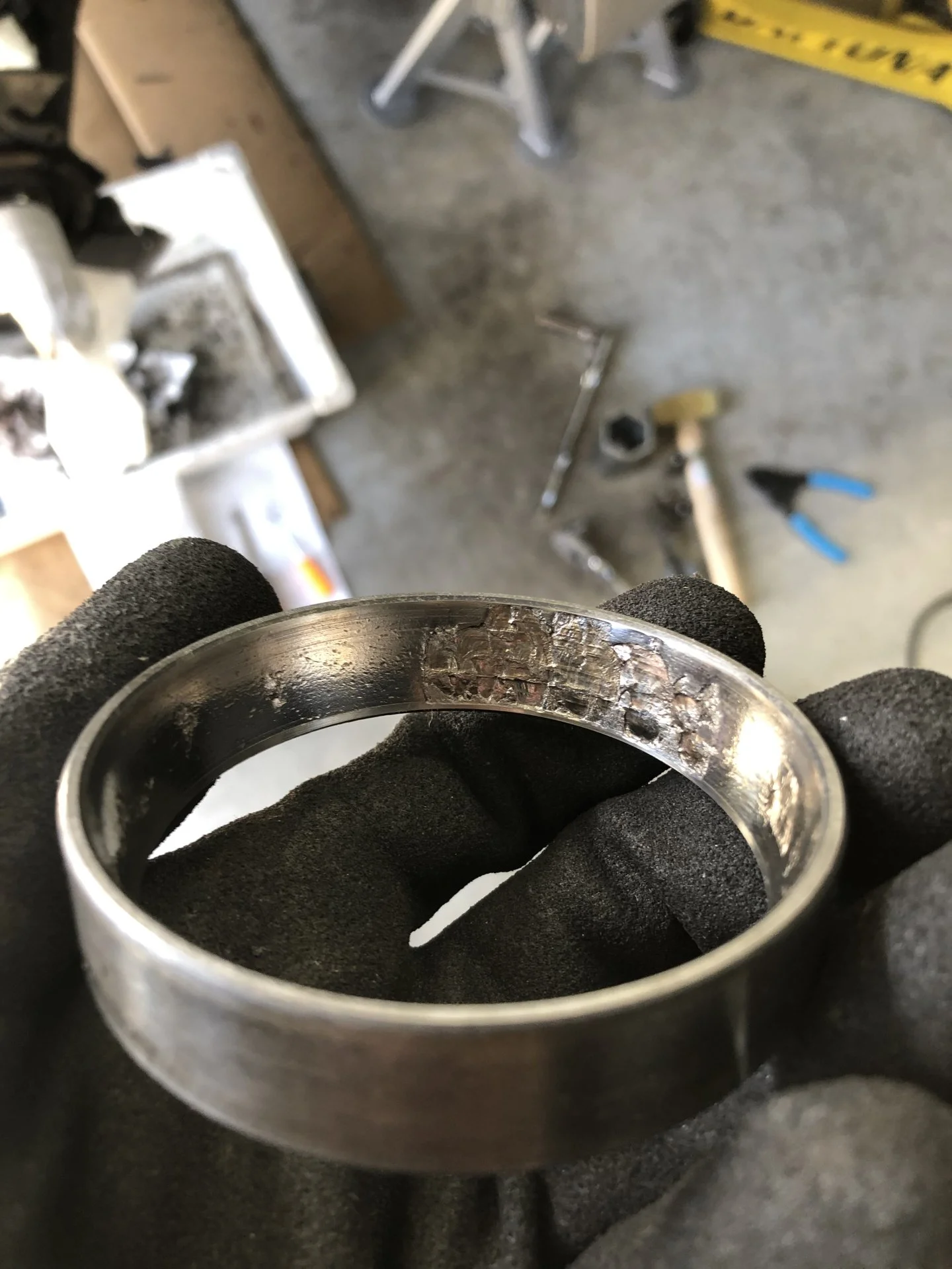

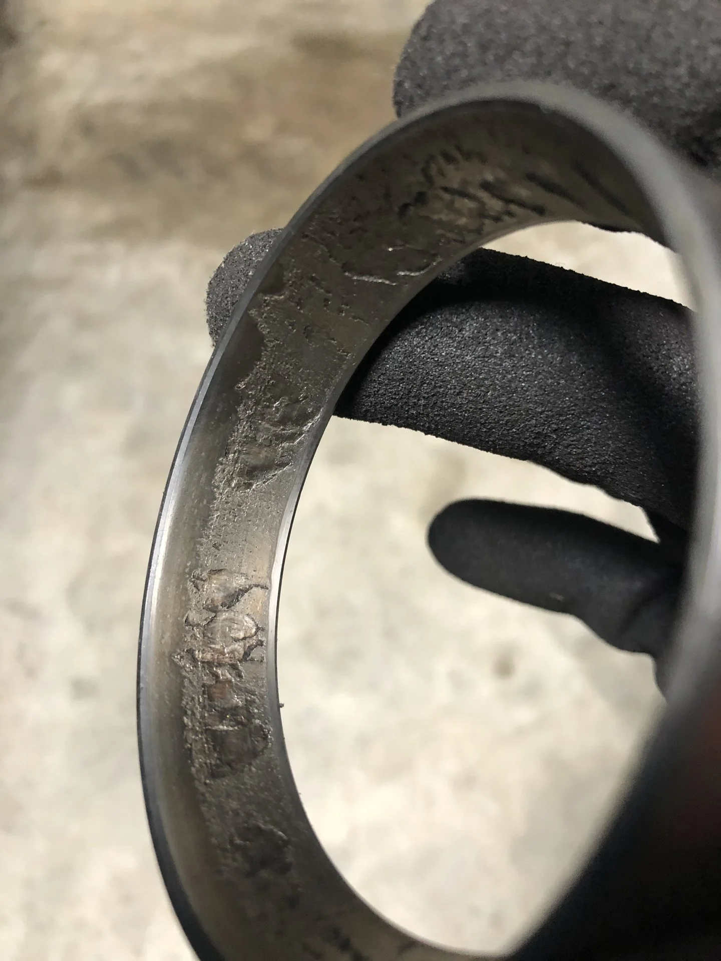

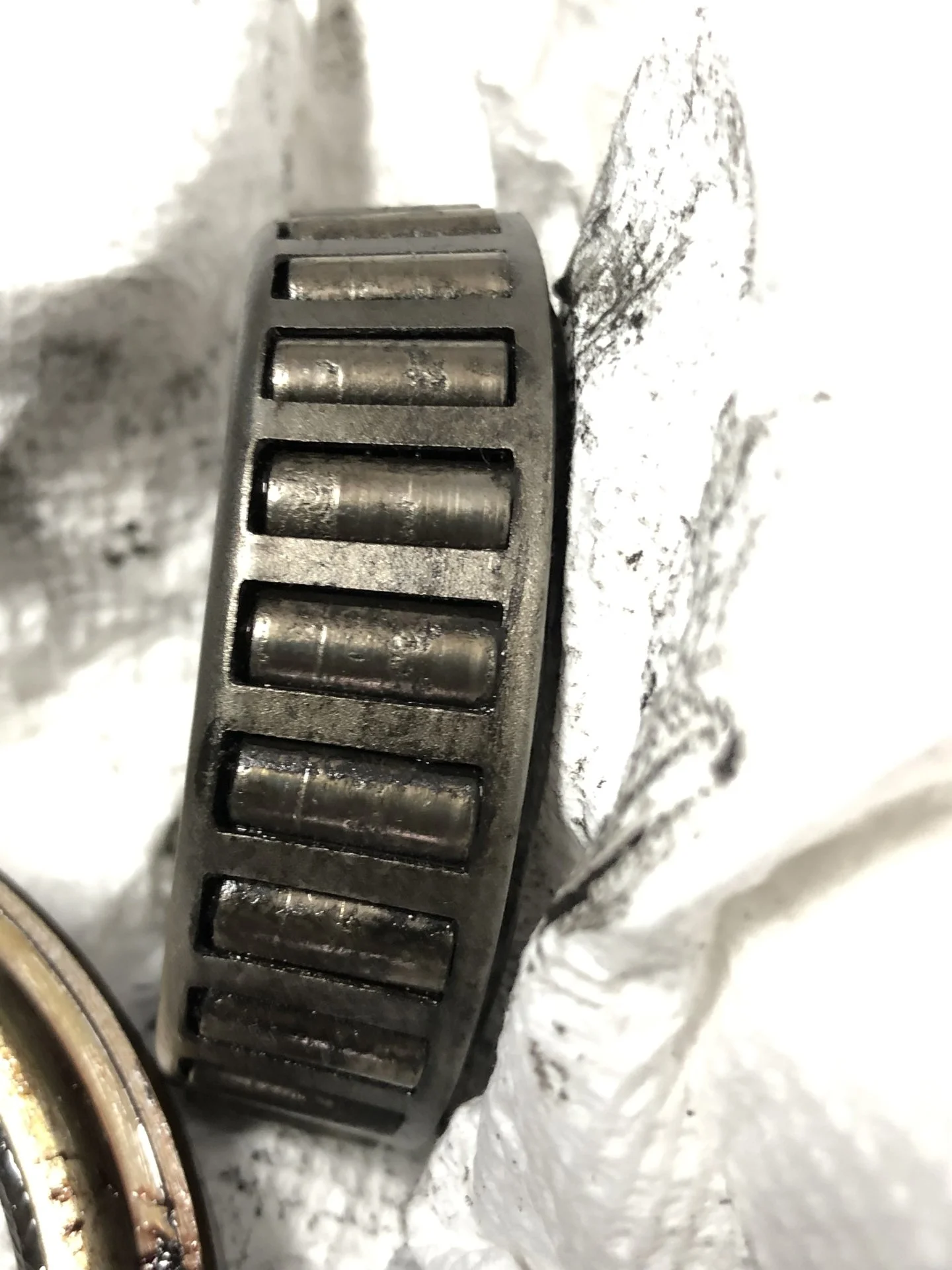

I just spent the better part of 3 days replacing front wheel bearings (including races) and new OEM brake rotors and calipers (while I’m in there, right?). Look at those races! I was actually happy to see this - I had a subtle rotational noise and vibration I could feel in the floor boards and pedals. Figured it was bearings and holy cow! Inner races were all fine but I outers were both trashed. I assume these are original with 210k miles. No records of if/when repacking was done. Looking forward to the test drive soon!
Those are the worst races I've seen in a minute!

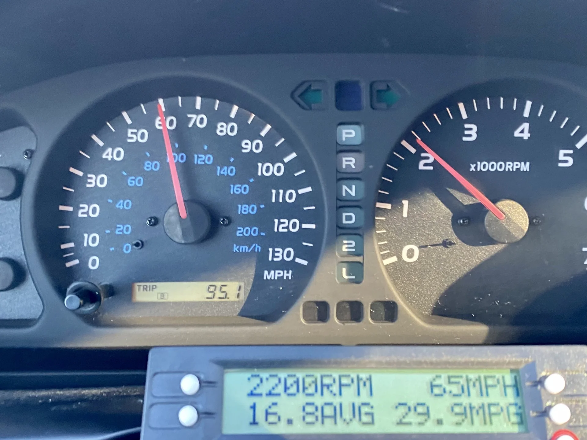

Put the scan gauge in today. Ever since I’ve been running the Rock Warriors with 285 70 17 BFG KO2s my speedometer has been off by 5 mph. The scan gauge lets you recalibrate so you can get an accurate reading. I dialed it in with the GPS app on my phone. 16.8 mpg running 65 mph. Not bad, but I can get to 17-18 mpg on cruise control.

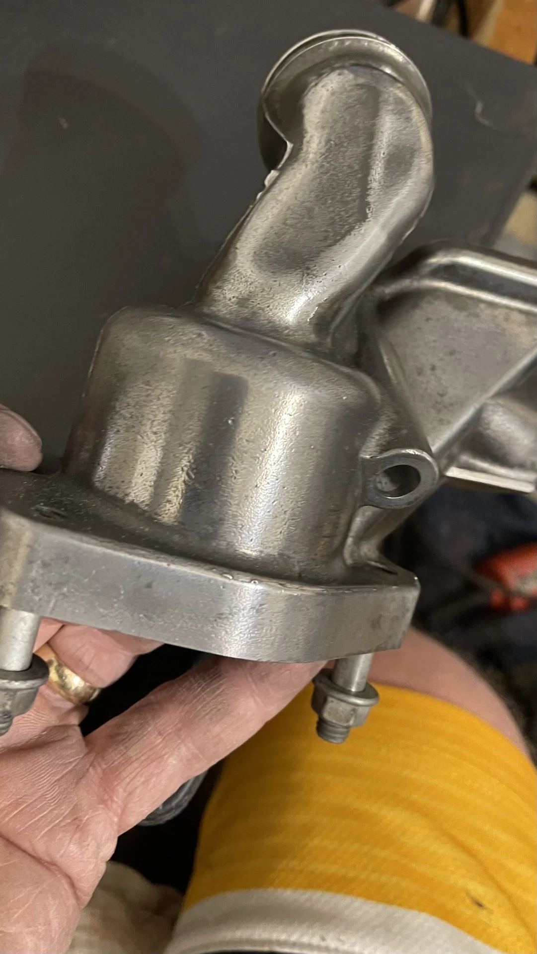

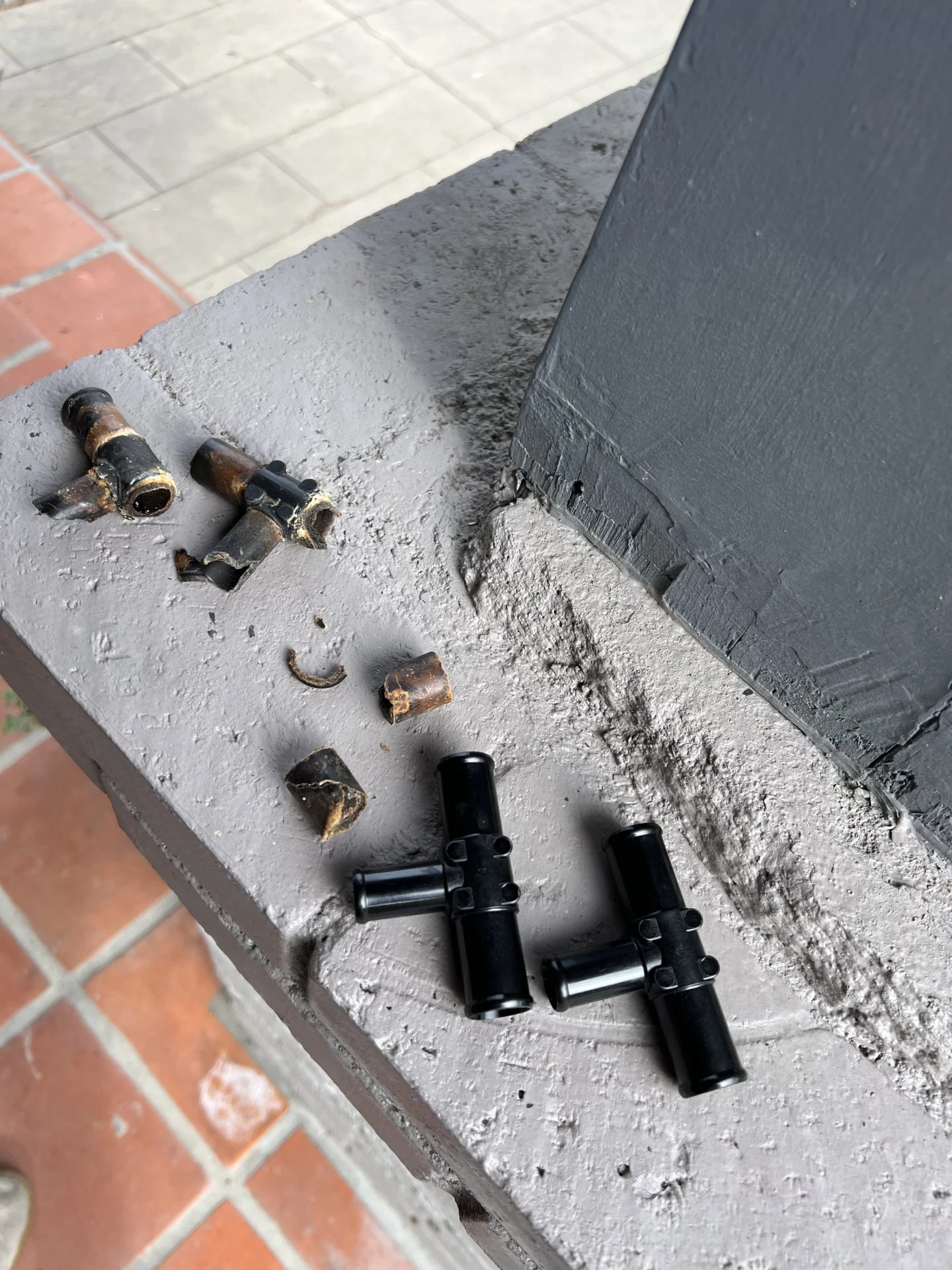

waited (clearly) far too long to do the heater T replacement.
now that the boring stuff is out of the way.

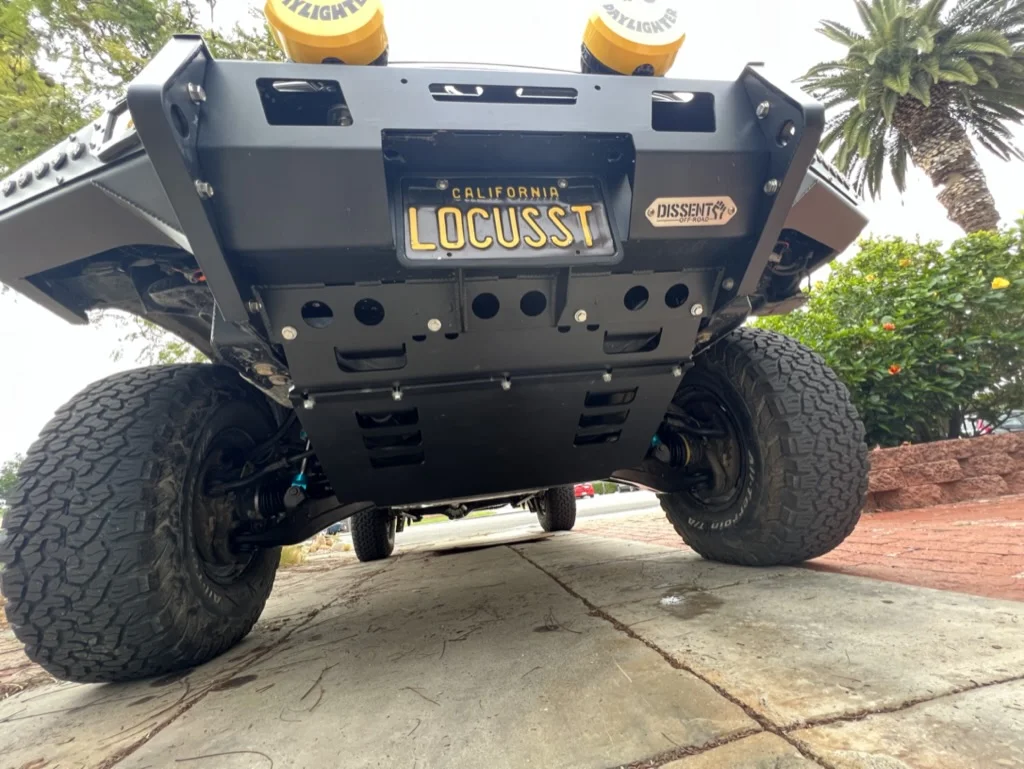

I also installed my Dissent Skid plates. I primed and painted the front skid Rustoleum Textured Black that matches the powder-coat on the rest of the bumpers. love how the skid ties into the Dissent front bumper.
