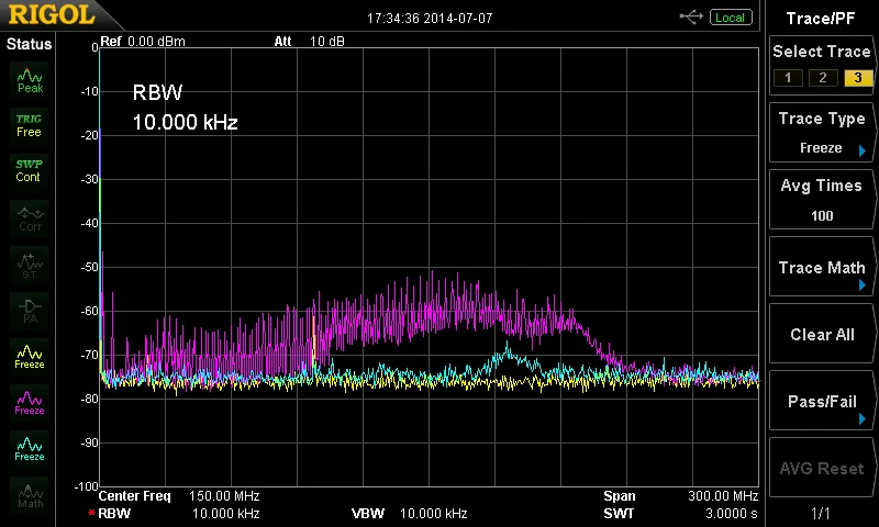

The issue is with LEDs that have DC : DC switching regulators to create the constant drive current for the LEDs. The switching noise that runs at a few hundred kHz is what the radio etc picks up. The switching that occurs has very fast and high current edges and the harmonics is what then becomes bad news for AM/FM frequencies.
Here's an example of a Rigid LED (4x LED) rectangular light. The purple trace is the conducted noise on the power leads of the Rigid light. This is a scan from essentially DC to 300MHz. The yellow trace is with the power turned off - the wires are just acting like an antenna and you can see a peak where a strong FM radio station is being 'received' (near 100MHz). Pretty clear that if the Rigid power wiring was near where the radio antenna lives that the FM station (well all of them...) would be wiped out.
The blue scan is of one of my 60W LED drivers being tested. Significantly quieter...
Date as can be seen is back in 2014. I've had to resolve these kind of issues at design time to provide a quality product. The Rigid is considerably better than some no-brand units I checked. Unfortunately this kind of information is not provided to potential customers so it becomes a total luck of the draw what you end up with. Then add in differences in how the LED lights are wired up and located and it's not surprising that some folk have (or perceive) no issues and vice versa :)
Many/most of the LED light resellers have no idea of these issues or how to address them. So, suggestions of ground wires or replacement units are thrown out in the hope that the customer just learns to live with the issue. Or maybe the replacement unit comes from another batch and the driver design is different (the made in china stuff changes daily...) and the noise spectrum is different. Also depends on how strong your am/fm radio stations are and which ones you listen to (different frequency) etc etc...
