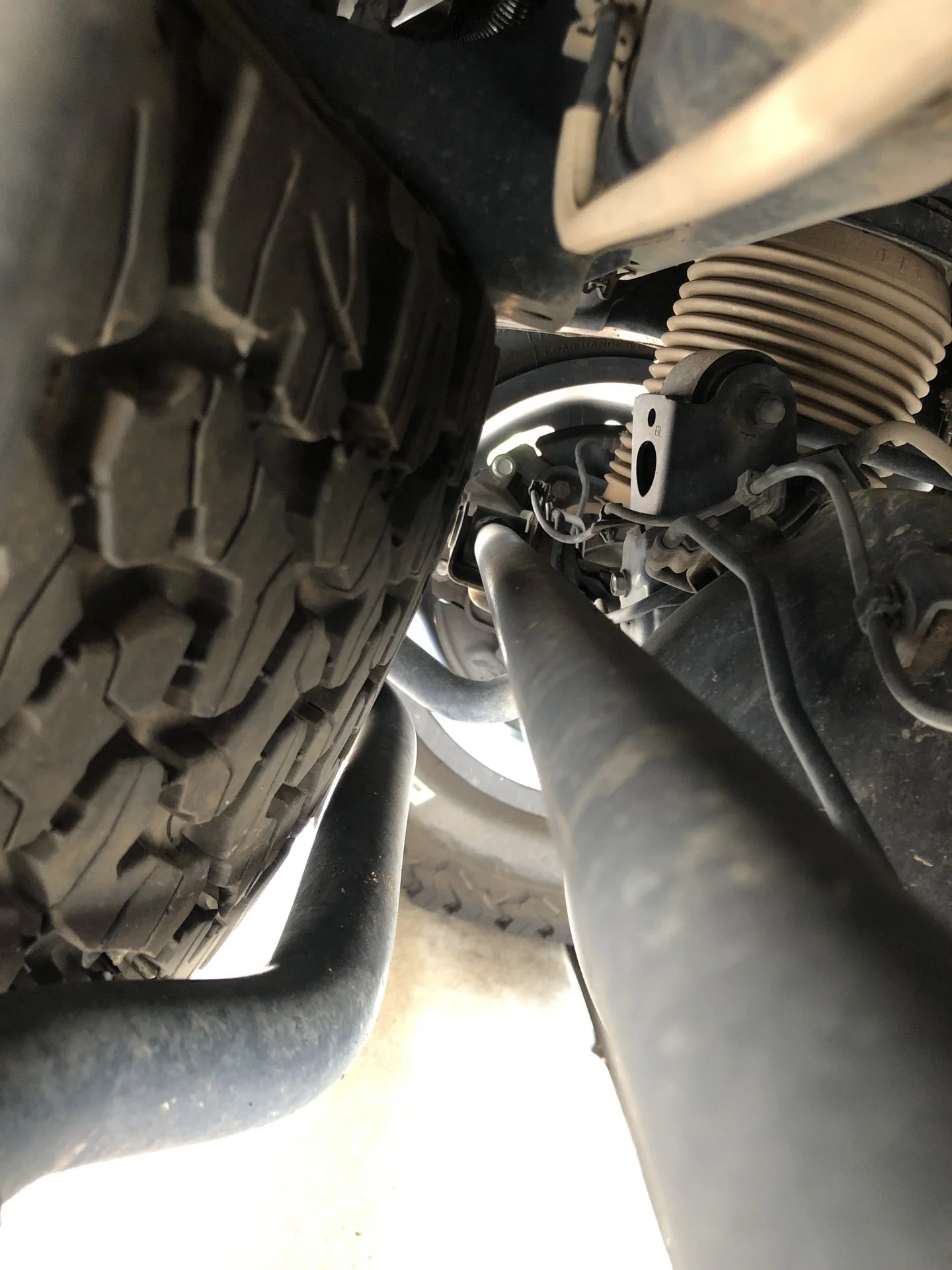

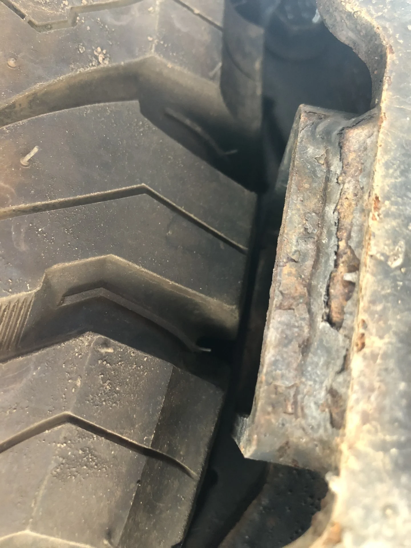

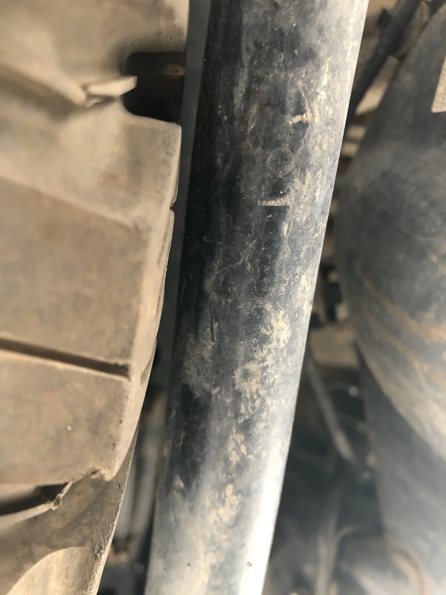

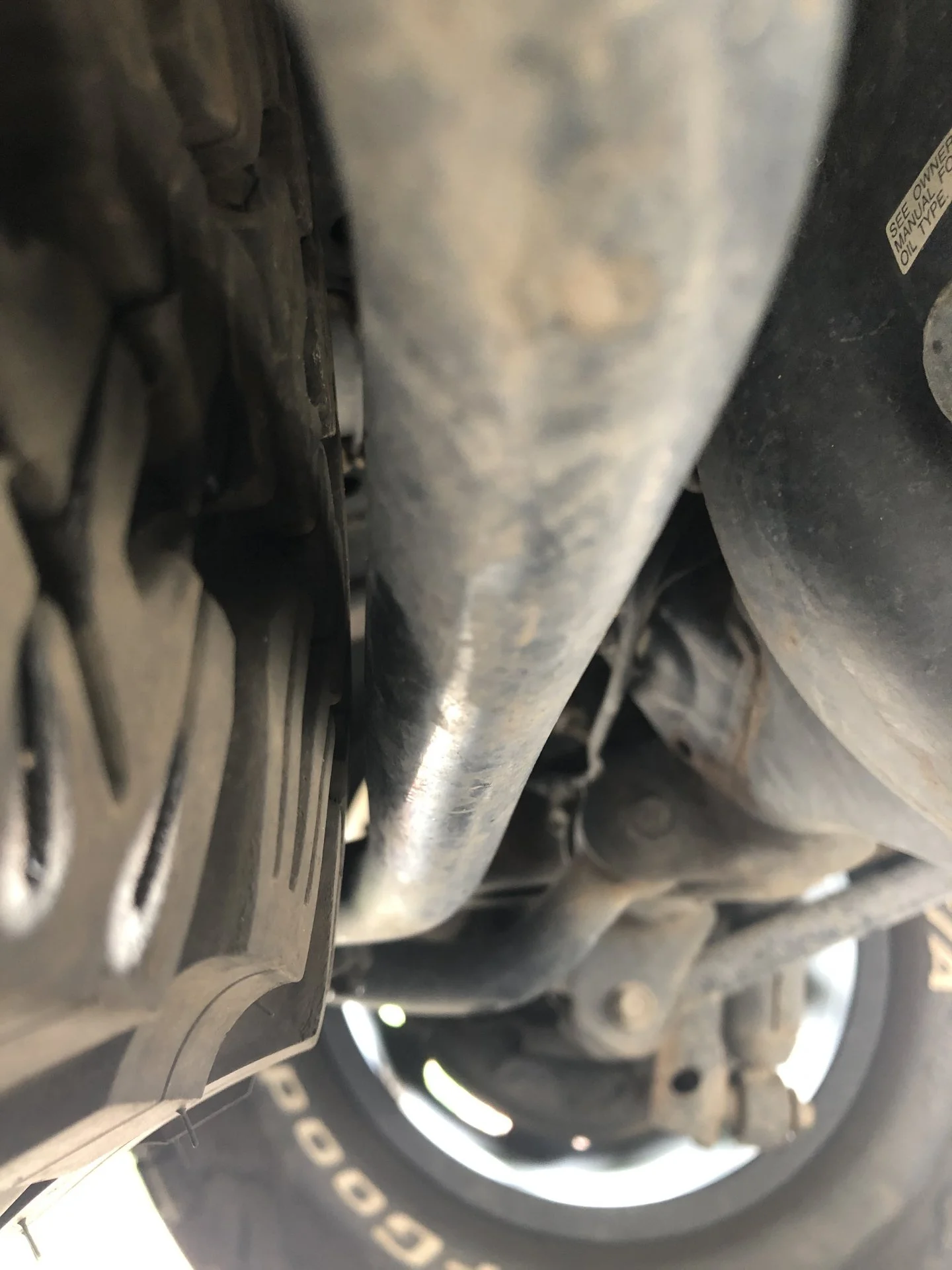

I just stuck my head under and there is much less room than I thought. Im actually touching the hitch and it looks like the sway bar rubs on it under compression. Theres no way anything bigger than what Im running will go under there, hitch or not… unless you were getting crazy and removing the sway bar altogether.
I'm not surprised it is tighter than you thought, makes sense.
I looked at grinding the back of the receiver hitch, but it looked like I would have only been able to gain a quarter inch or so, not enough. The spare tire I was using was the same diameter as the BFG ATs.
At the time I did think about loosening the hitch bolts like you said but didn't actually try it as it didn't seem likely to have that much slack in the bolt holes. Maybe I should try it anyway.
