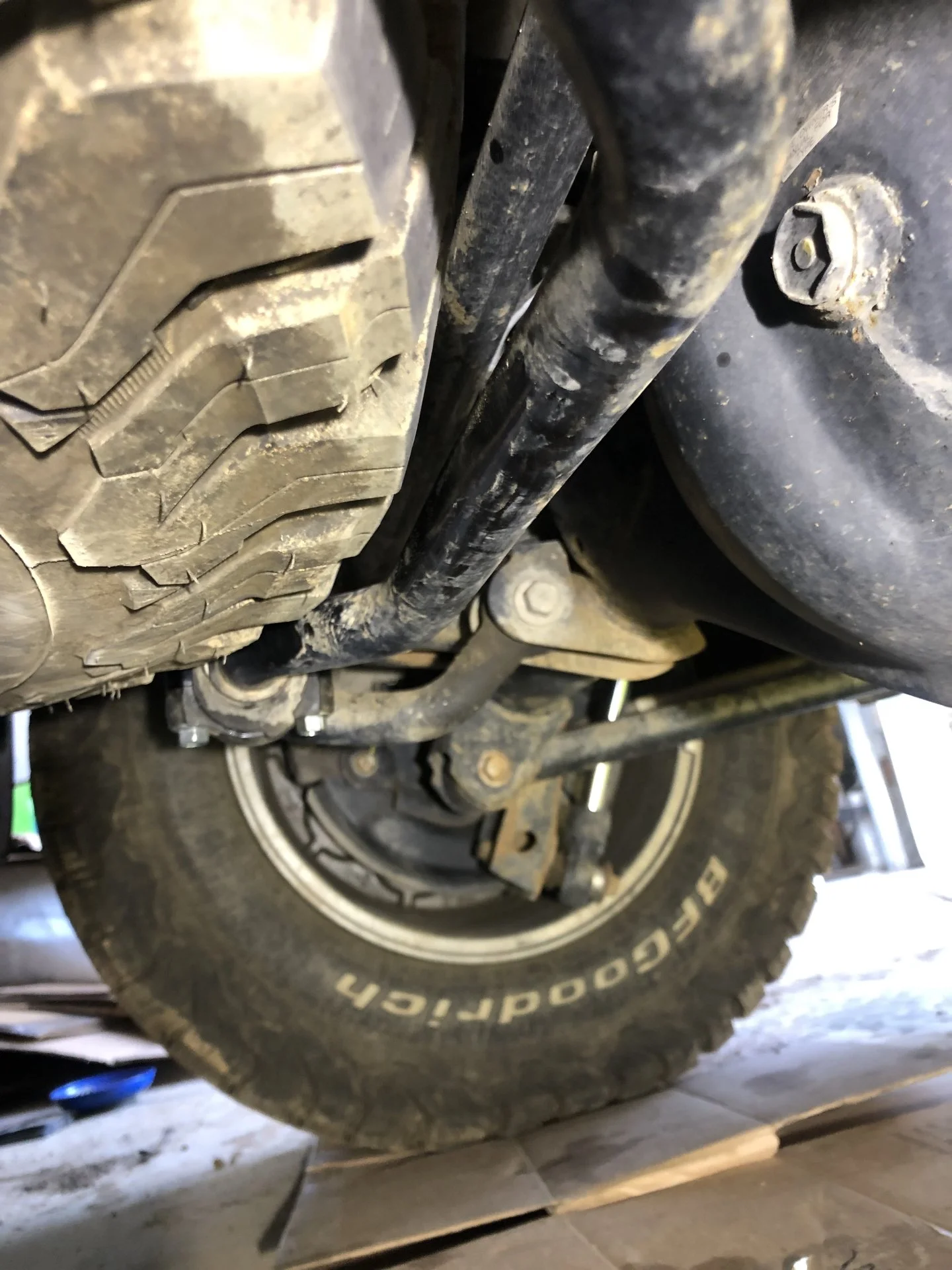

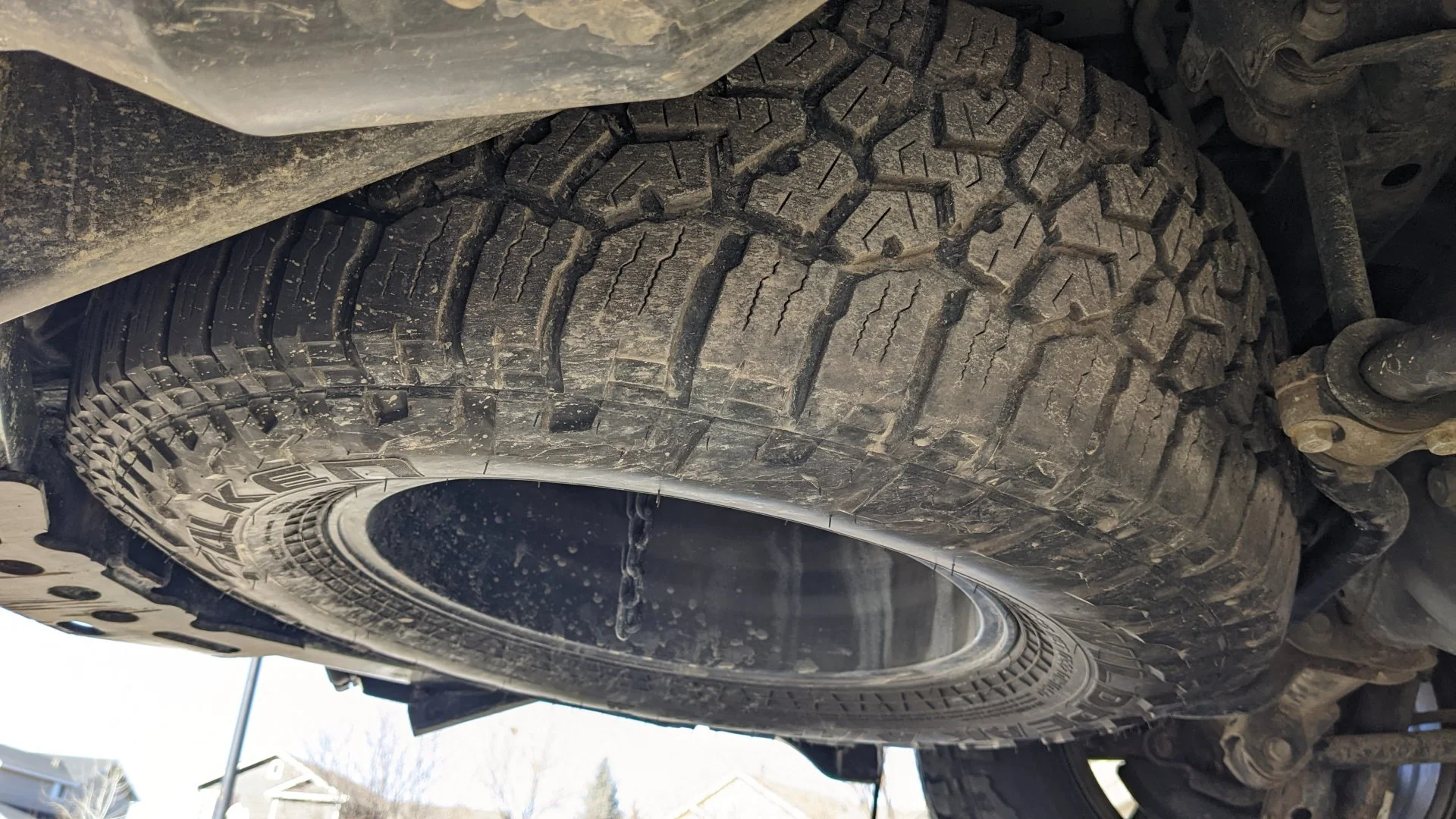

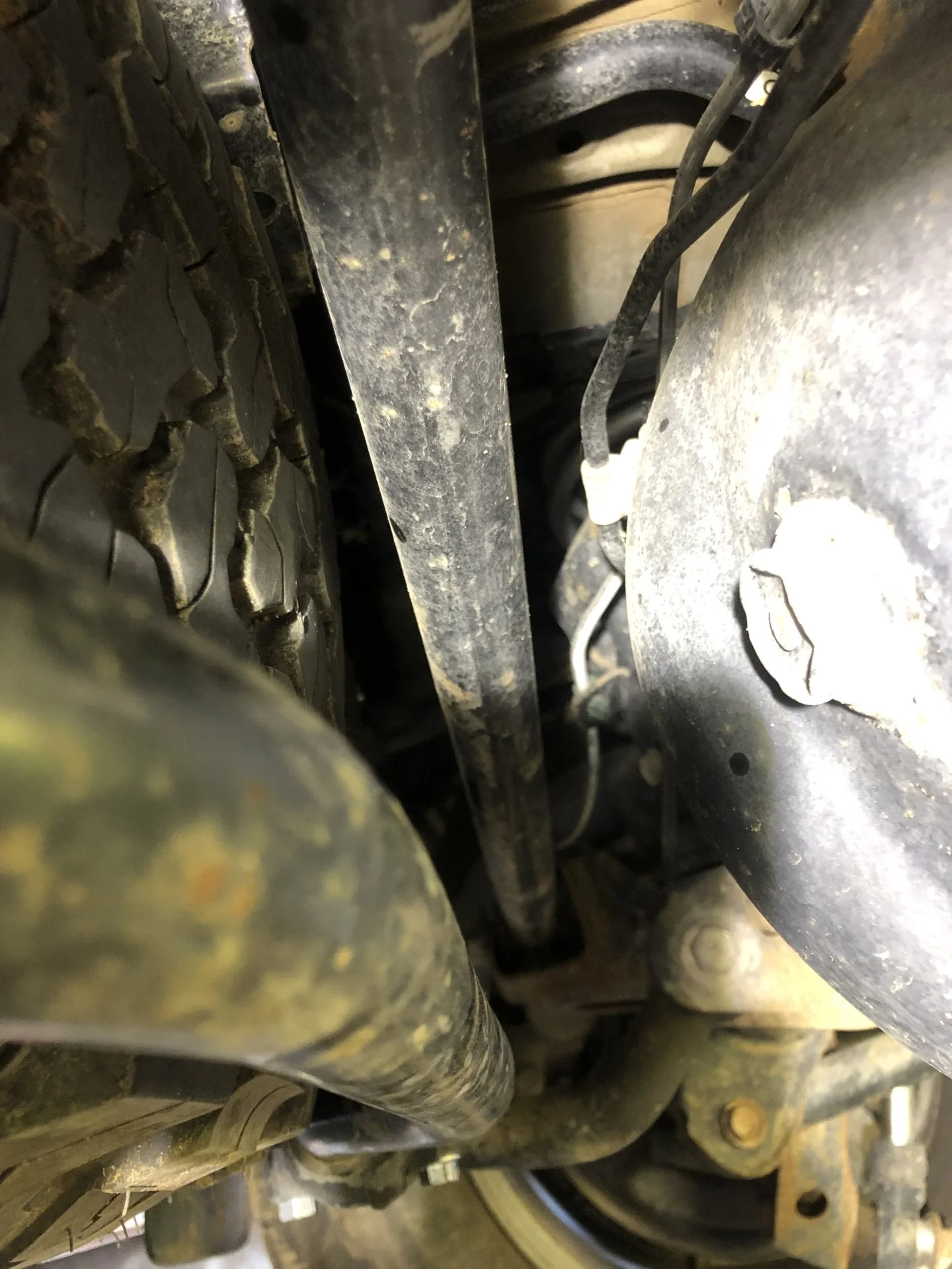

I installed my rear KDSS spacers today and was subsequently able to fit my 275/70-17 spare tire in the stock location, fully inflated. I removed my tow hitch previously, so I can't say whether it will still fit with the hitch installed.
That's great. Do you think a 33 can fit in there or was there no room left?

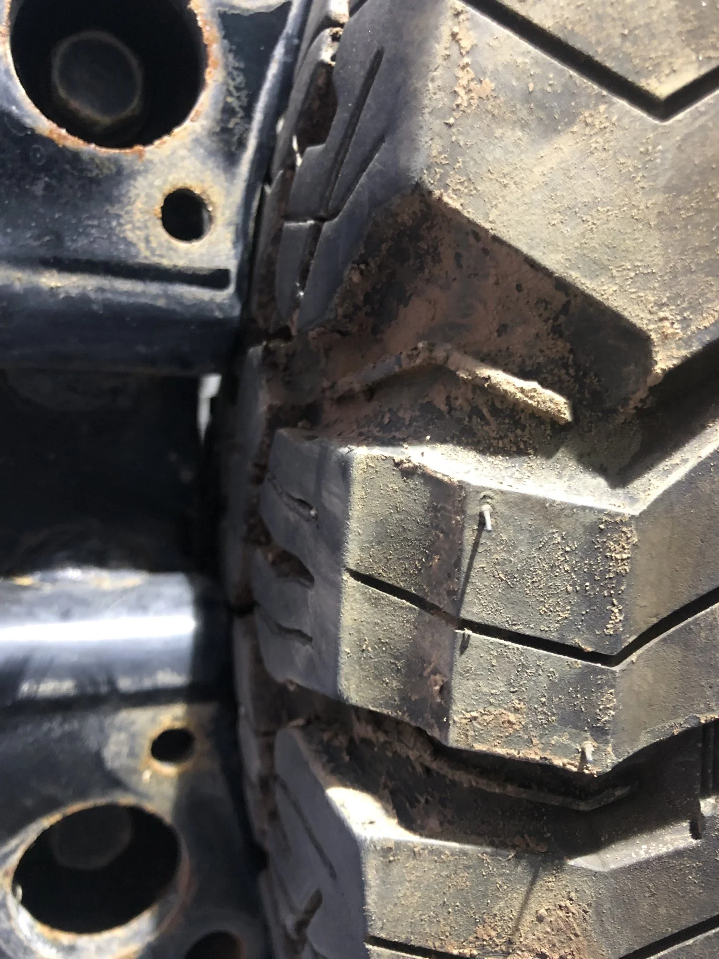

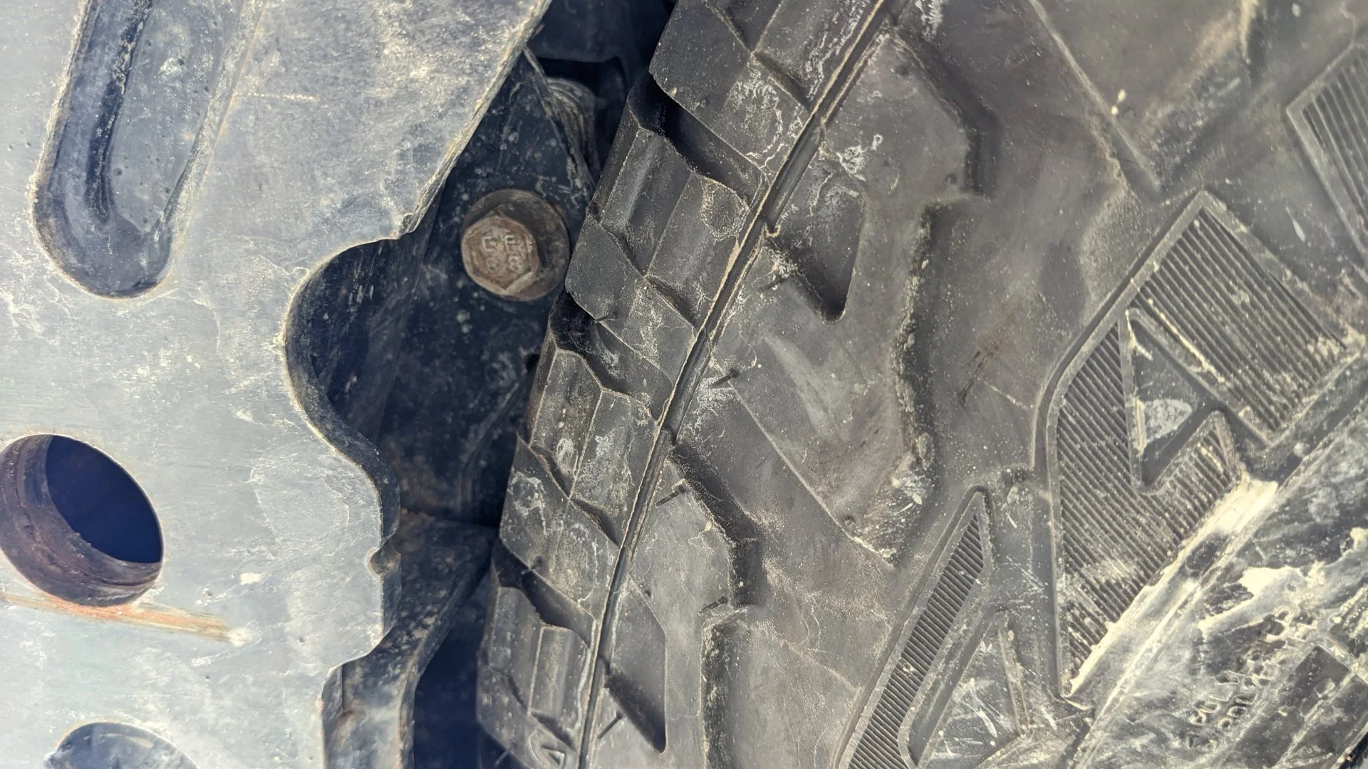

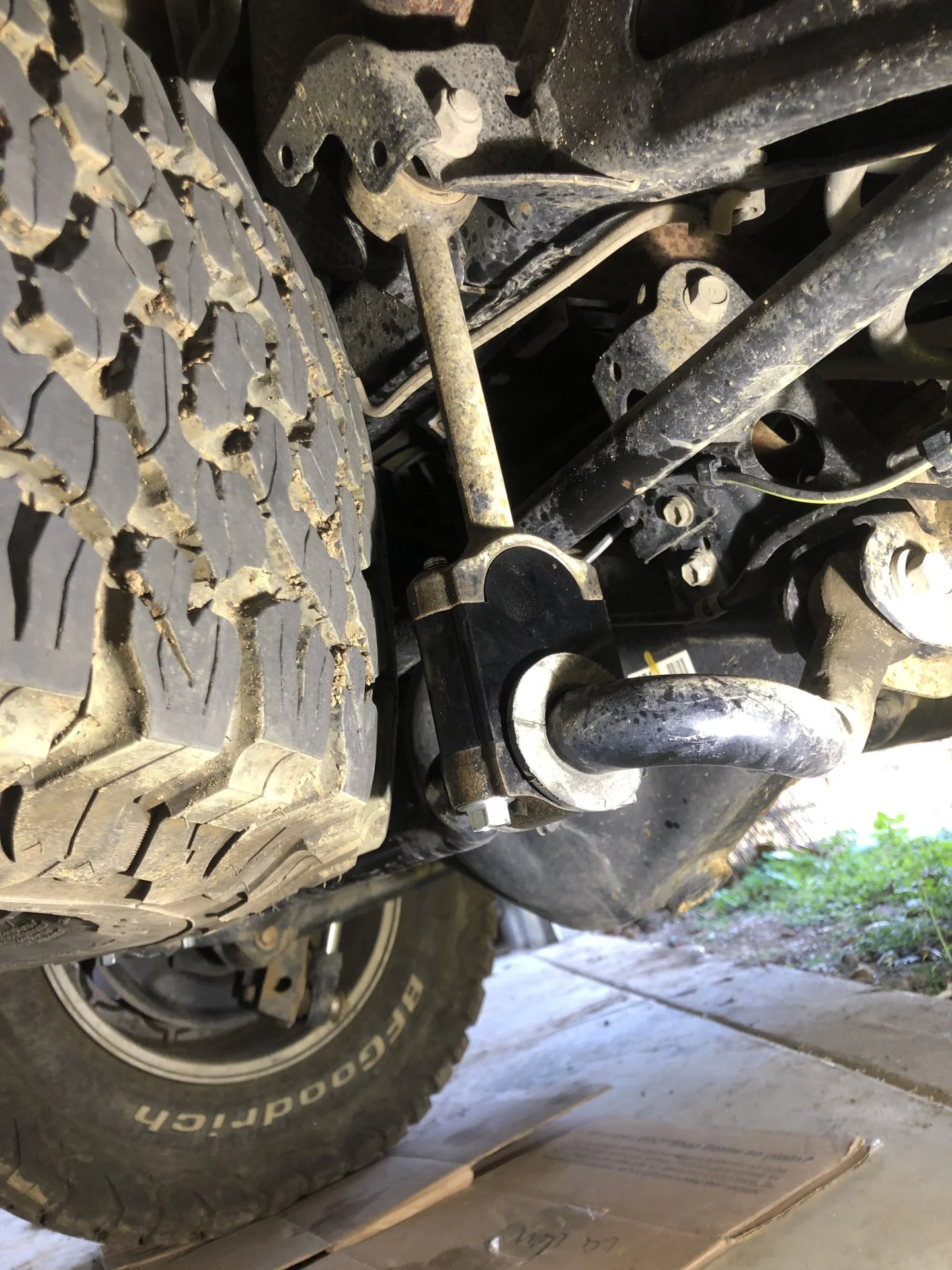

The tire is right up against the metal bracing at the back, so no more room back there. There is < 1" of space in the front, between the tire and the rear sway bar. I didn't measure, but it's getting tight up at the front. I wouldn't count on putting an inflated 33 in there, but you might be able to squeeze a deflated one in.

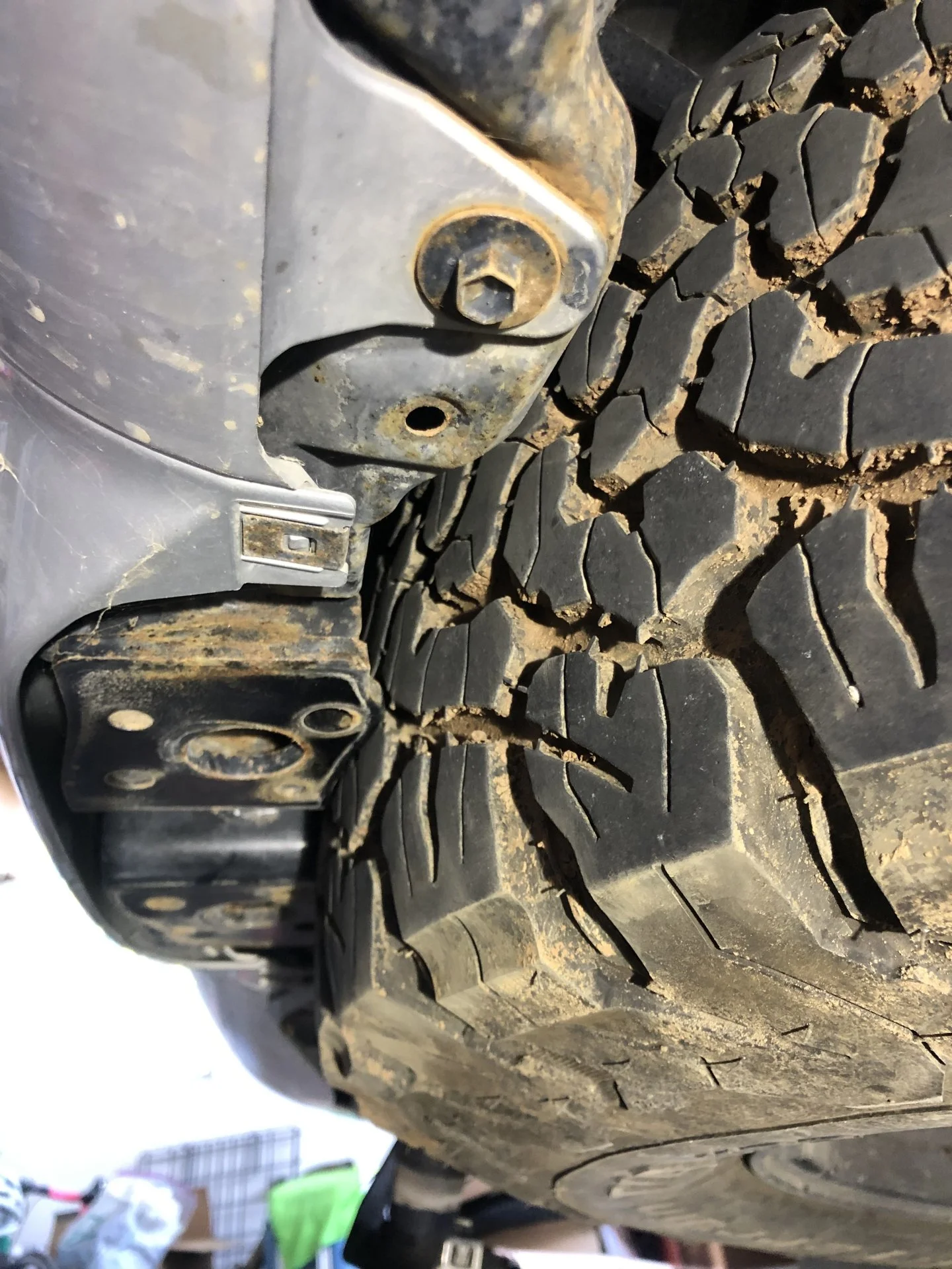

All I can say is that it doesn’t fit with the class 3 receiver… might fit (crammed at best) if i removed it, but that’s not an option for me so I didn’t try

I have rear spacers, 275/70/17 Wildpeaks and had to remove the class 3 receiver I had on there to squeeze the tire in fully inflated.
Sounds like that’s about as big as you can go with the spacers and no receiver and having to cram it then… 275/70/17 is 32.16” and 285/70/17 is 32.71”
