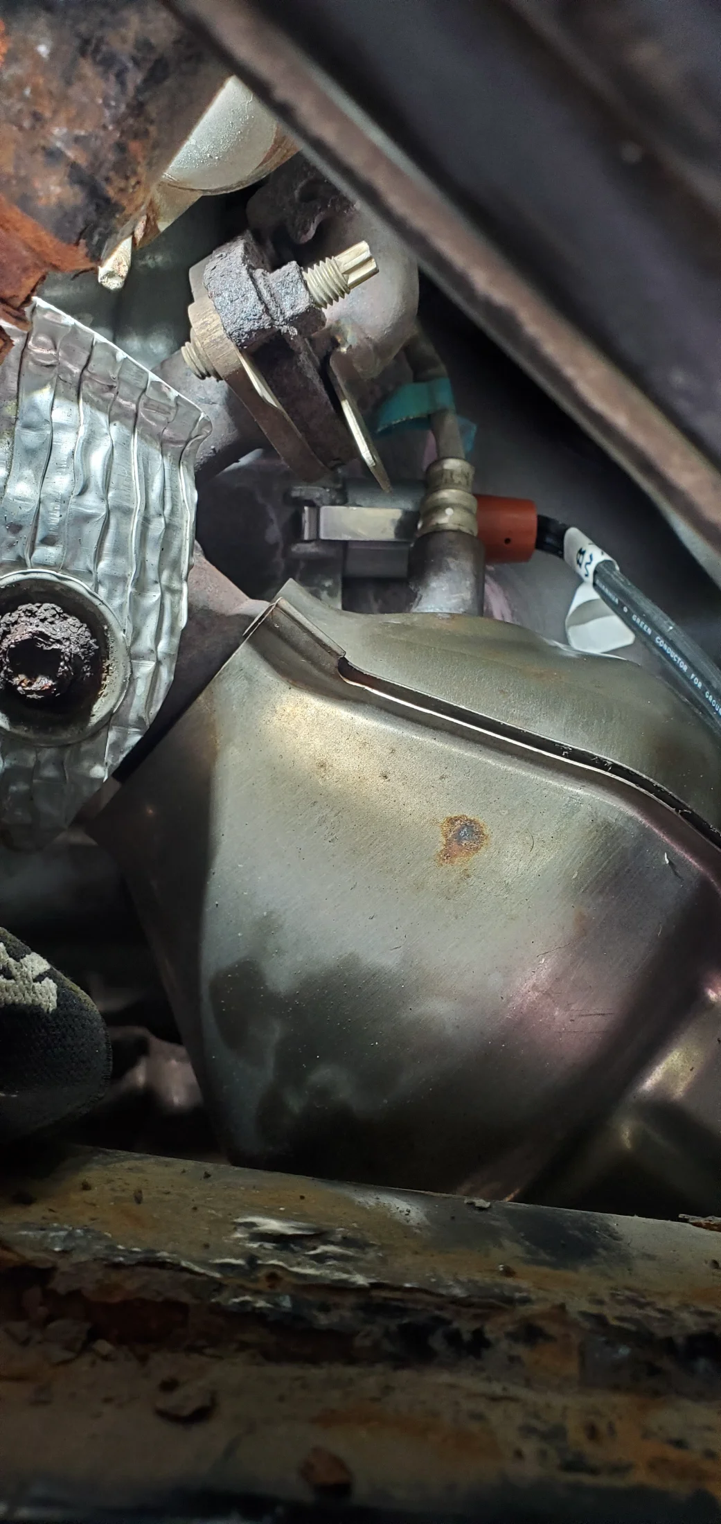

Hi all, does anyone know where the blockheater gets installed on the GX460? I just figure someone might know off the top of their head and save me some hassle looking for it.
Edit: it is indeed difficult to find, but I found it. If you look through drivers wheel well, you'll see the 02 sensor, it's right behind that facing rearward. I honestly never got eyes on it, but felt for it, and studied eBay ads for used engines. And yes, I can see the coolant as well. Hoping I can get through the winter, but just keep an eye on the level
