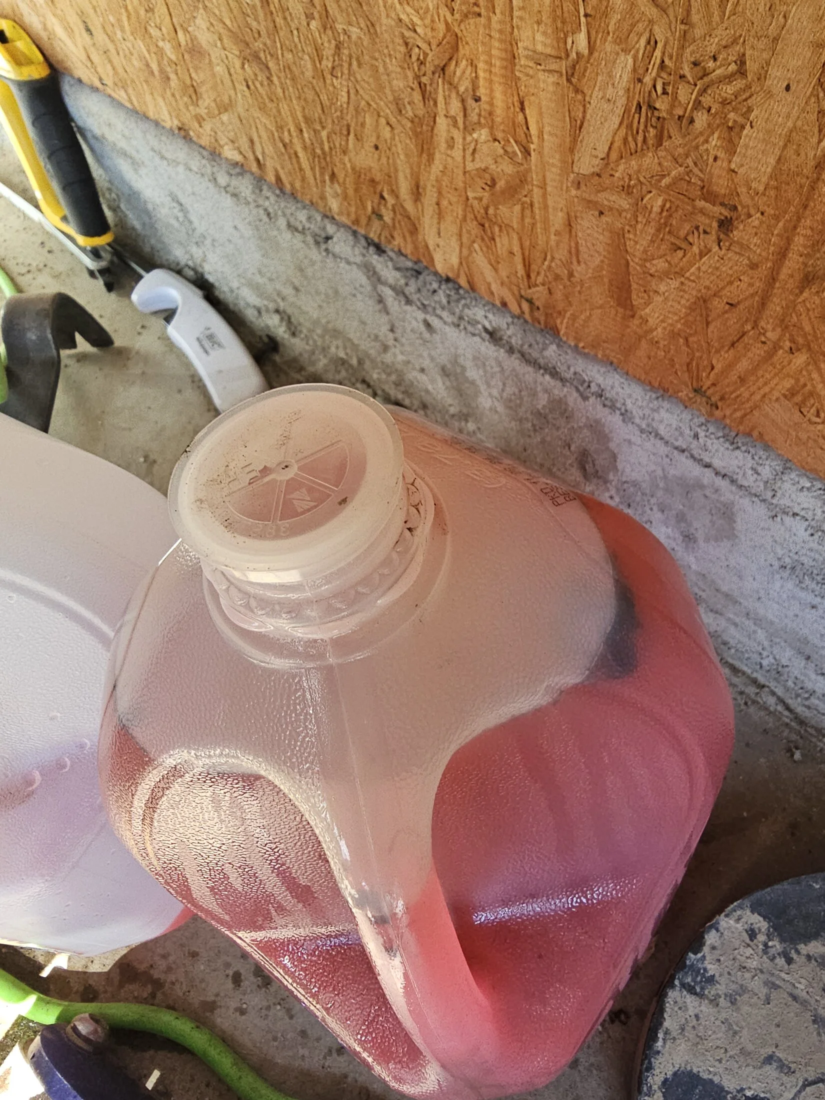

Its draining right now. I cleaned out the sludge, it may have come from the hoses.
I am not going to do a full flush, I am going to dump the radiator to dilute it, and see how it looks.
Black chunks came out of my cooling system, otherwise the antifreeze was clear.
Bled it and going to check it in a few hours to see what it looks like. I have enough coolant to do 2 more drain and fills, if I need to.
When was the last time you did a drain on the coolant? Wonder what the black chunks could be?
Less than 10k miles. Its from the hoses.
