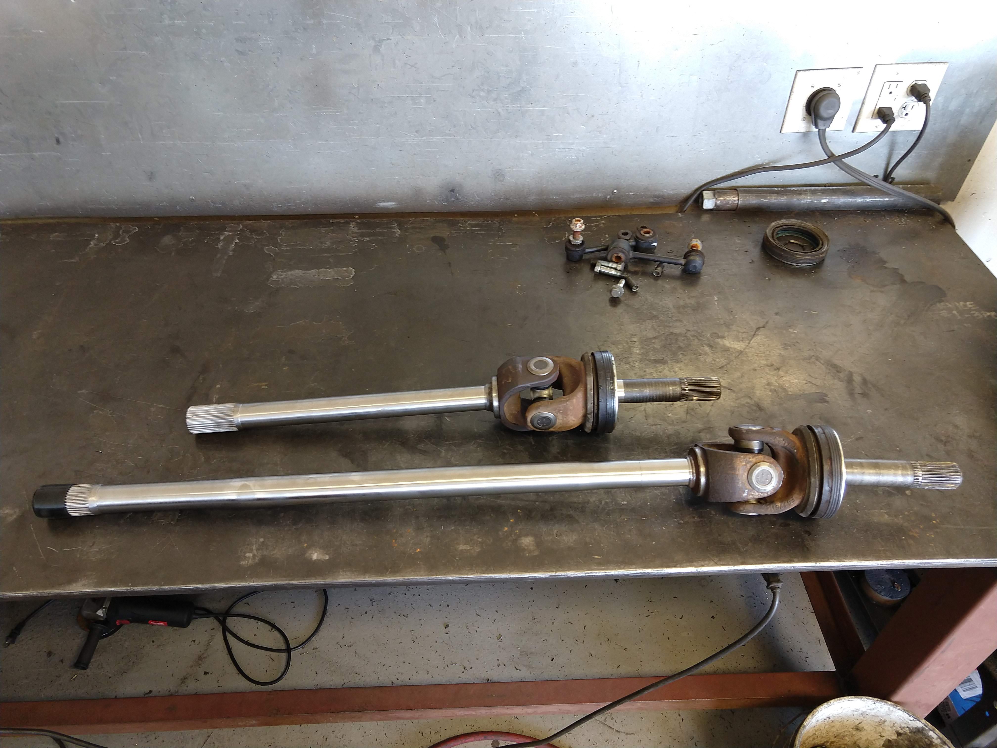

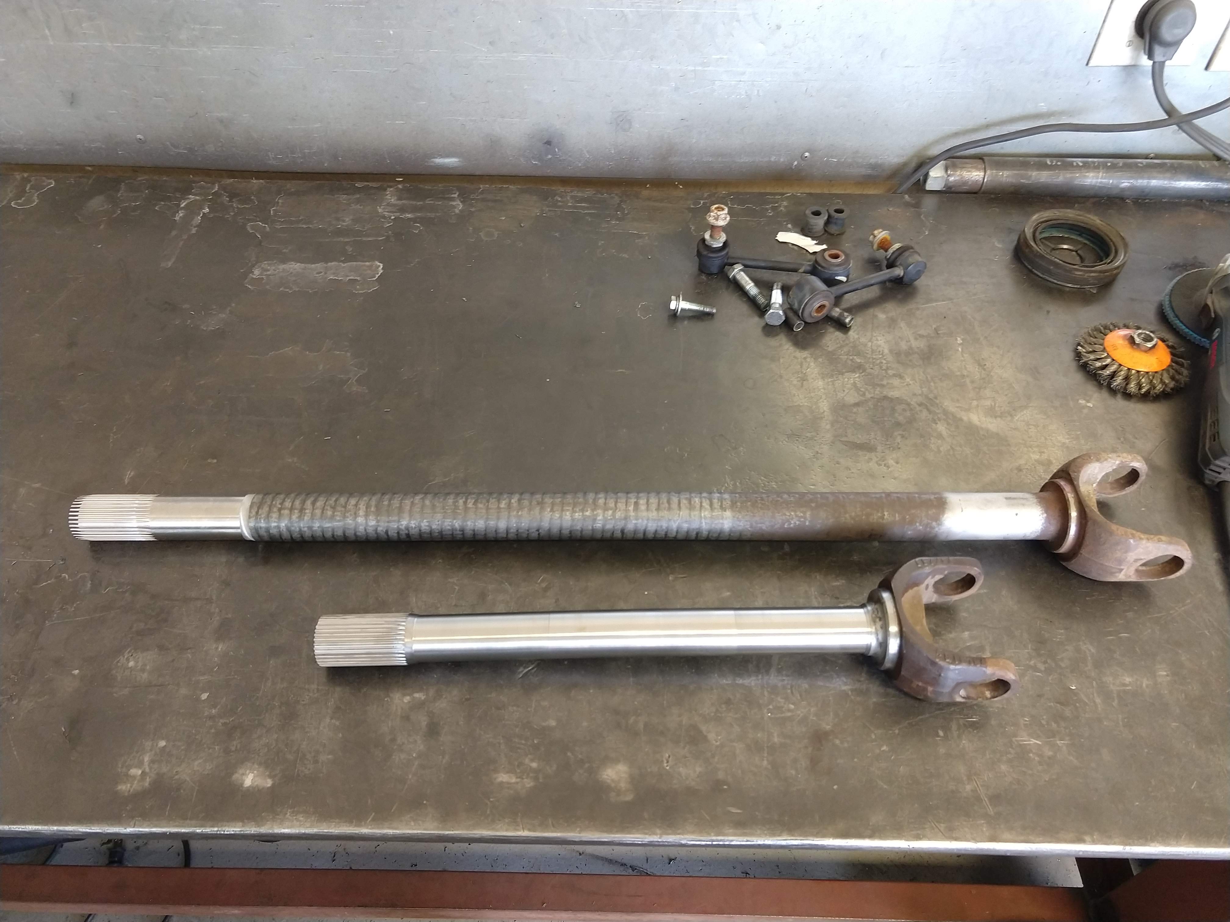

Getting back to work on this--I sent both of the long-side inner axleshafts to Dutchman Axles to have them shortened and re-splined. The top one is how I received them, the bottom one is after I cut down the O.D. of the shaft to better fit through the oil seal I'm using. A side benefit of this is having a slightly more "flexible" axleshaft; it will act a bit more like a torsion bar, which can improve the durability of the shaft, as well as things like the ring and pinion gear. The shaft can absorb some of the shock that could otherwise damage other parts. (it can also absorb shocks that could twist/break splines too)
That said, I'm an idiot for not just having the D44 center machined to accept standard D60 axle seals while it was all apart. Oops. I tried to think of everything I wanted, and that one slipped my mind.
And here are both shafts machined, and assembled with the original outer stub shafts, with new Spicer U-joints. The long side didn't get cut down its full length, just 8" or so on each end. The middle section I turned down some, but it still remains larger than the ends. That's for two reasons--for one, that more or less gives me the same length of "small" shaft as the short side, and saves me time machining. (the hardened steel takes FOREVER to machine)
Installed shafts! :D

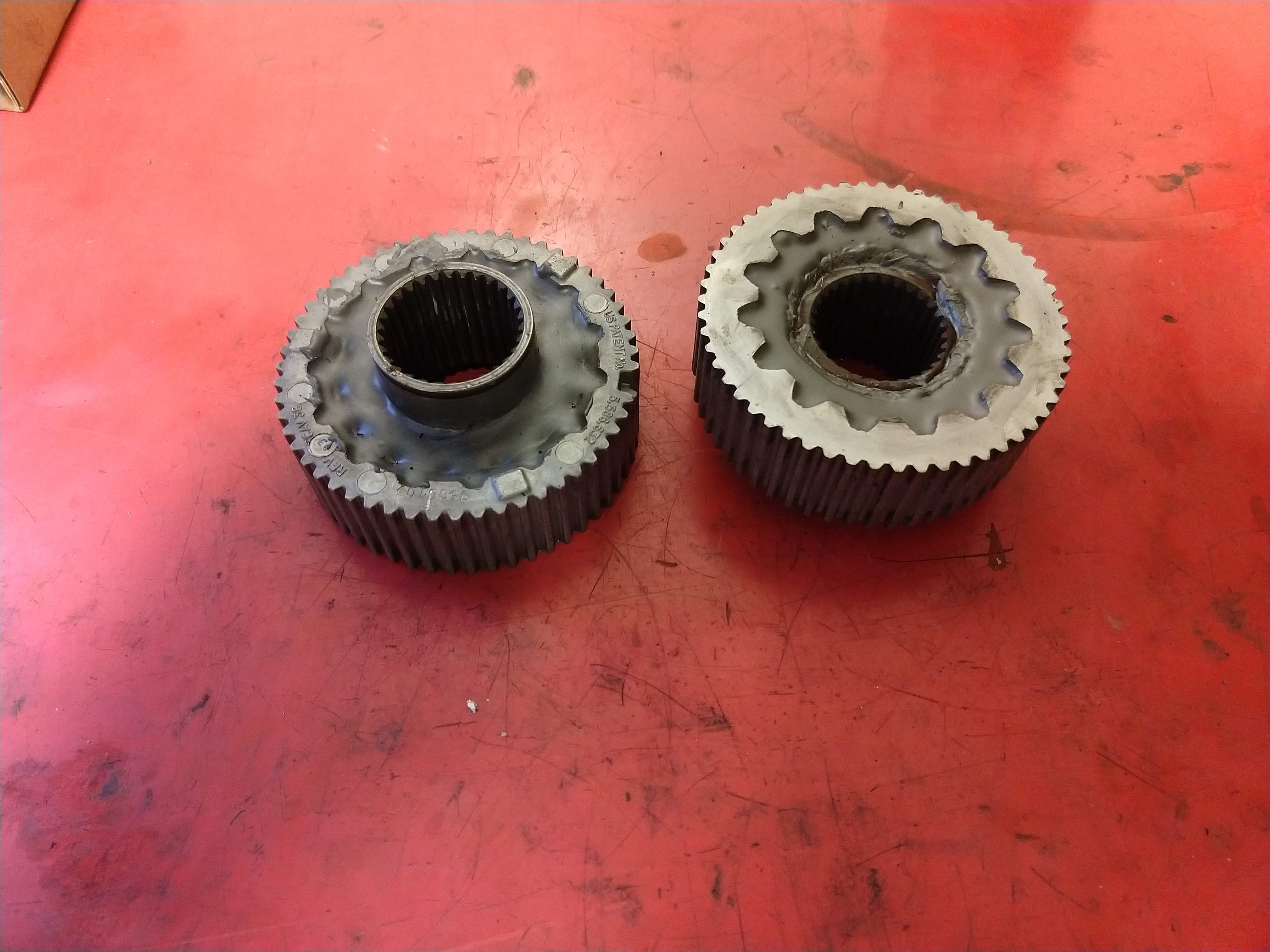

Since this will still be full-time 4WD, I needed a drive slug to fit the D60 wheel bearing. Nobody makes a 30 spline drive slug, and I'm not feeling the need to upgrade to 35 spline stubs, so I made my own. I gutted one of the sets of Ford hubs, welded the sliding gear to the inner splines, then placed them into the aluminum outer splined piece, bedded with JB Weld. The teeth are fully engaged, so the epoxy just has to keep the inner steel parts from coming out of the outer aluminum part--it doesn't need to take any driving force.
