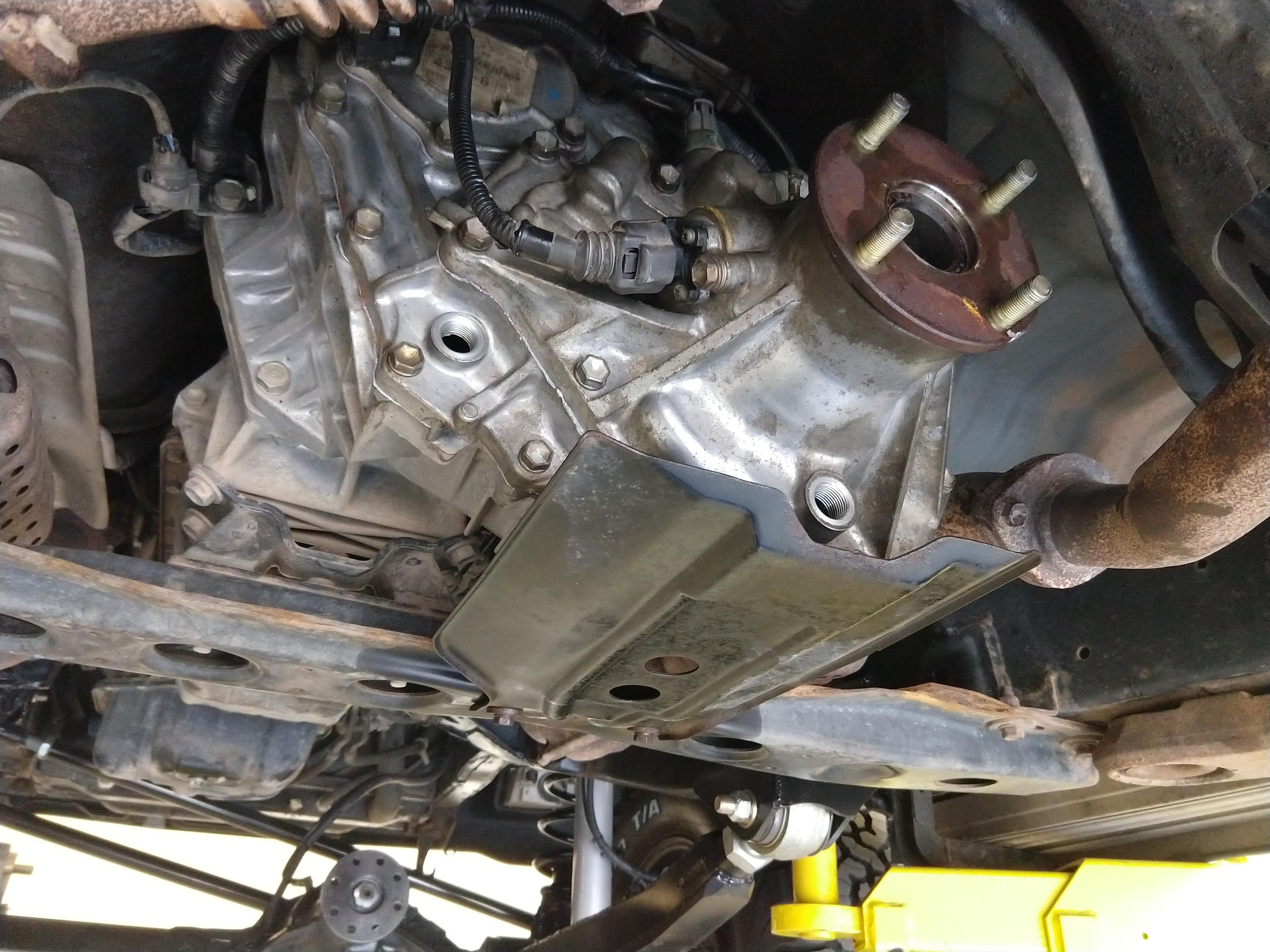

Driving it in 4WD wasn't as wonderful as I was hoping. Despite the center differential relieving drivetrain bind, the front axle U-joints are pretty noticeable, especially accelerating around a corner. That could be cured by using axleshafts with a CV joint in it--RCV or similar. Those are a BUNCH of money...and combine that with the little driveline vibration I have, made the next choice easy. The driveline vibration is because I totally nailed the pinion angle when assembling the axle. It's perfectly wrong for both a standard U-joint shaft, as well as wrong for a double cardan driveshaft. :(

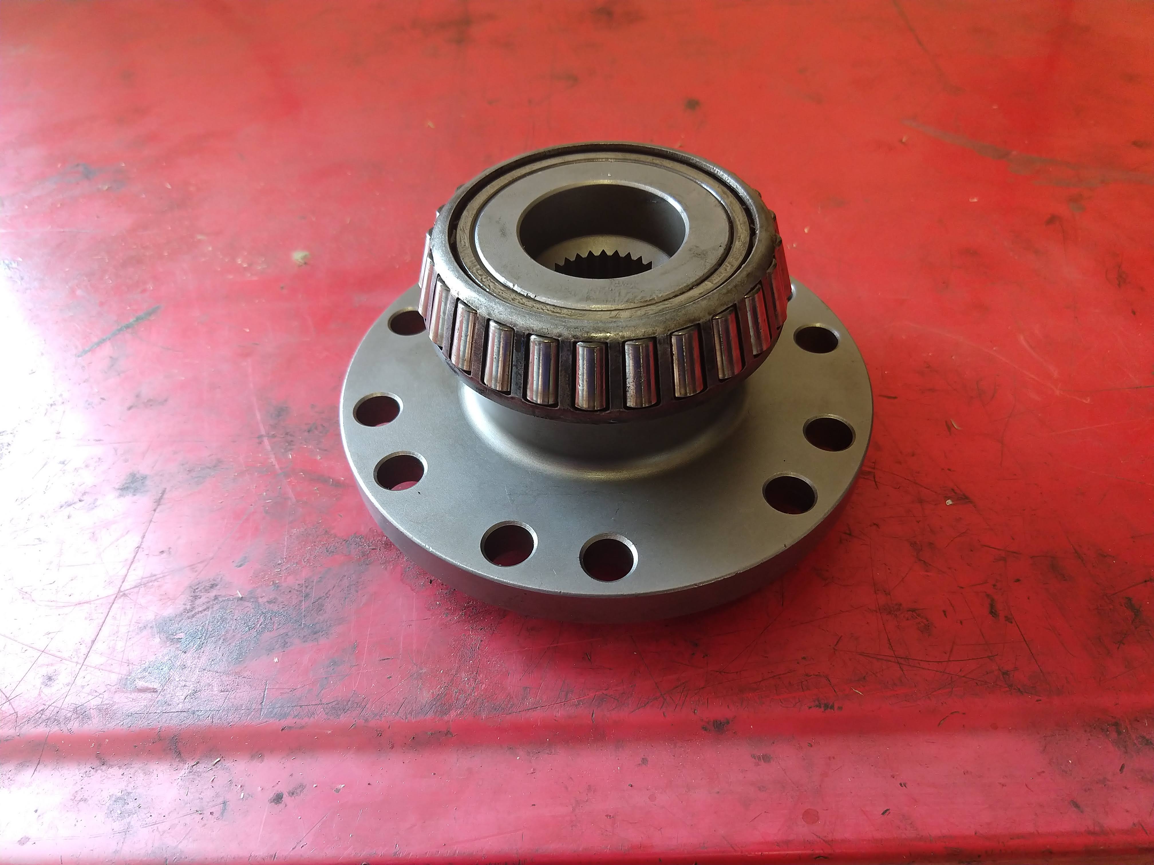

So, part-time 4WD here we come! @cruiseroutfit had the kit in stock for me, which I picked up yesterday at the BBQ. Here it is after I pressed the bearing onto it:

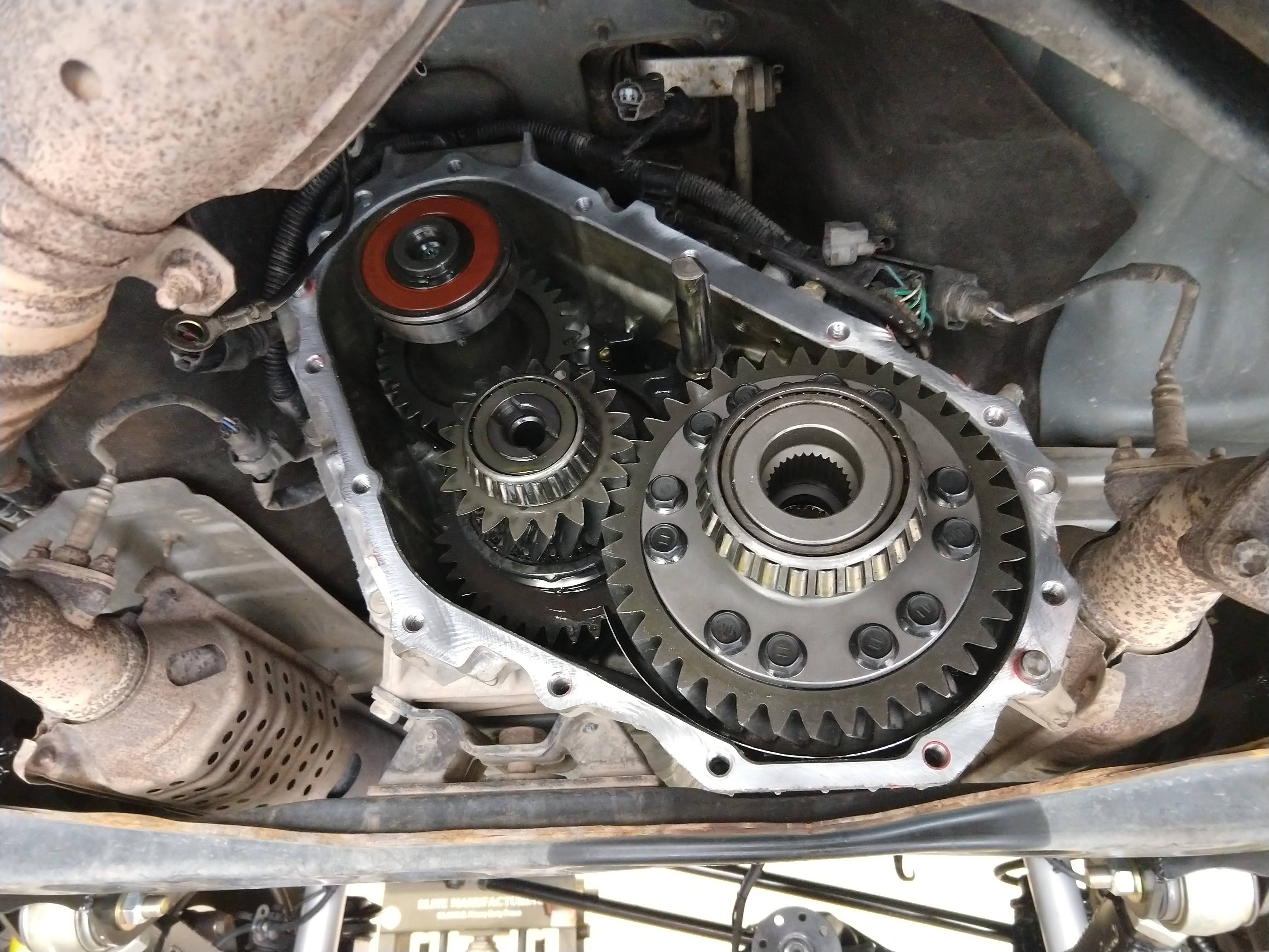

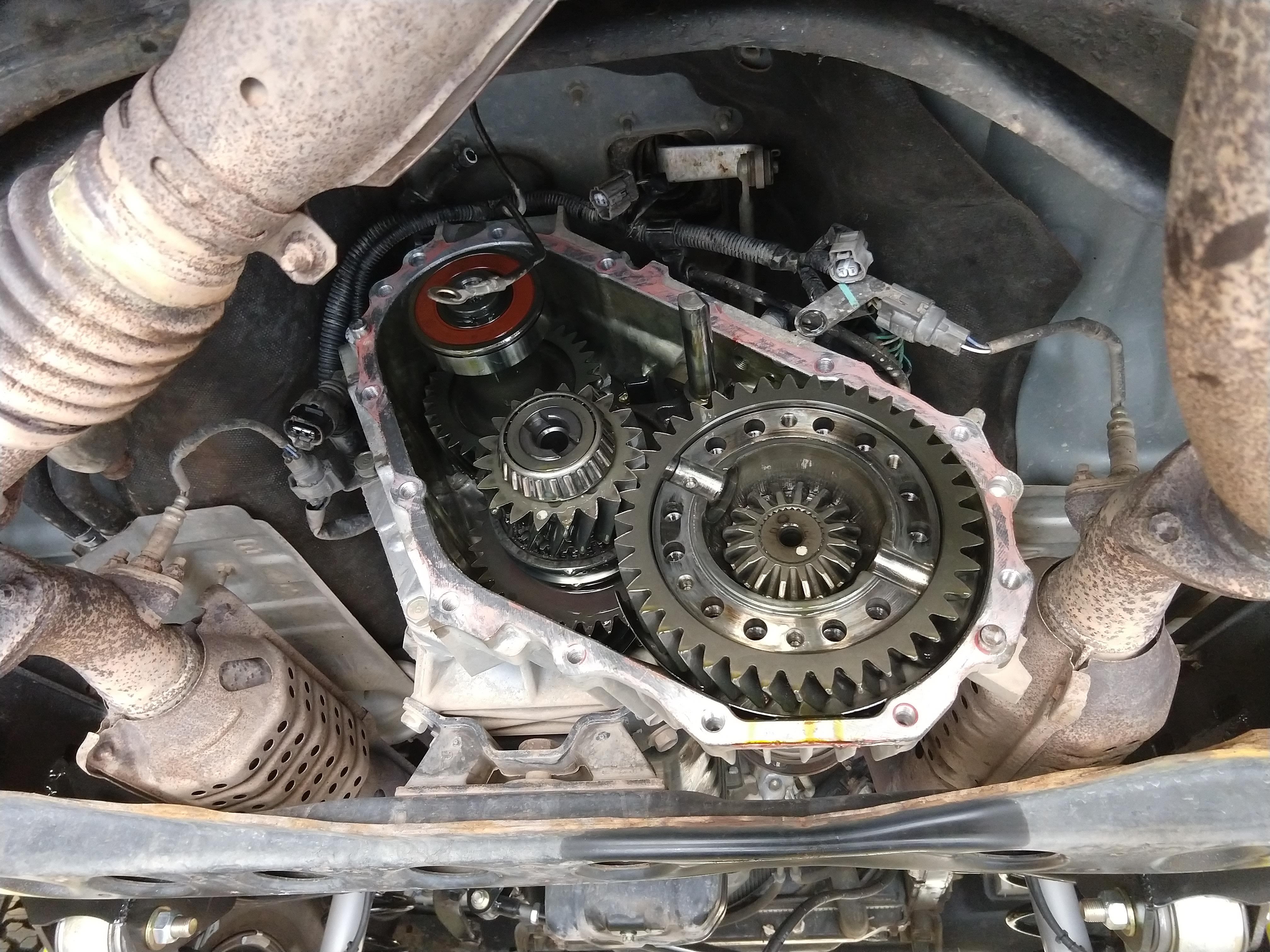

Installation is pretty simple--basically, take the back half the transfer case apart to access the center diff. Replace the rear half of the differential with this spool. Reassemble. This pic is as far as it gets disassembled...ready to start putting it back together.
Here it is with the spool bolted on, ready to put the case parts back:
All buttoned up. I'll give it overnight for the silicone to cure before filling with oil and getting it back on the road. :cool:
Now, the former Center Diff Lock button on the dash will engage front-wheel-drive instead. Hubs are easy on this axle--for now I have the stock Ford locking hubs on it, but they're pretty ugly so I'll replace them soon.

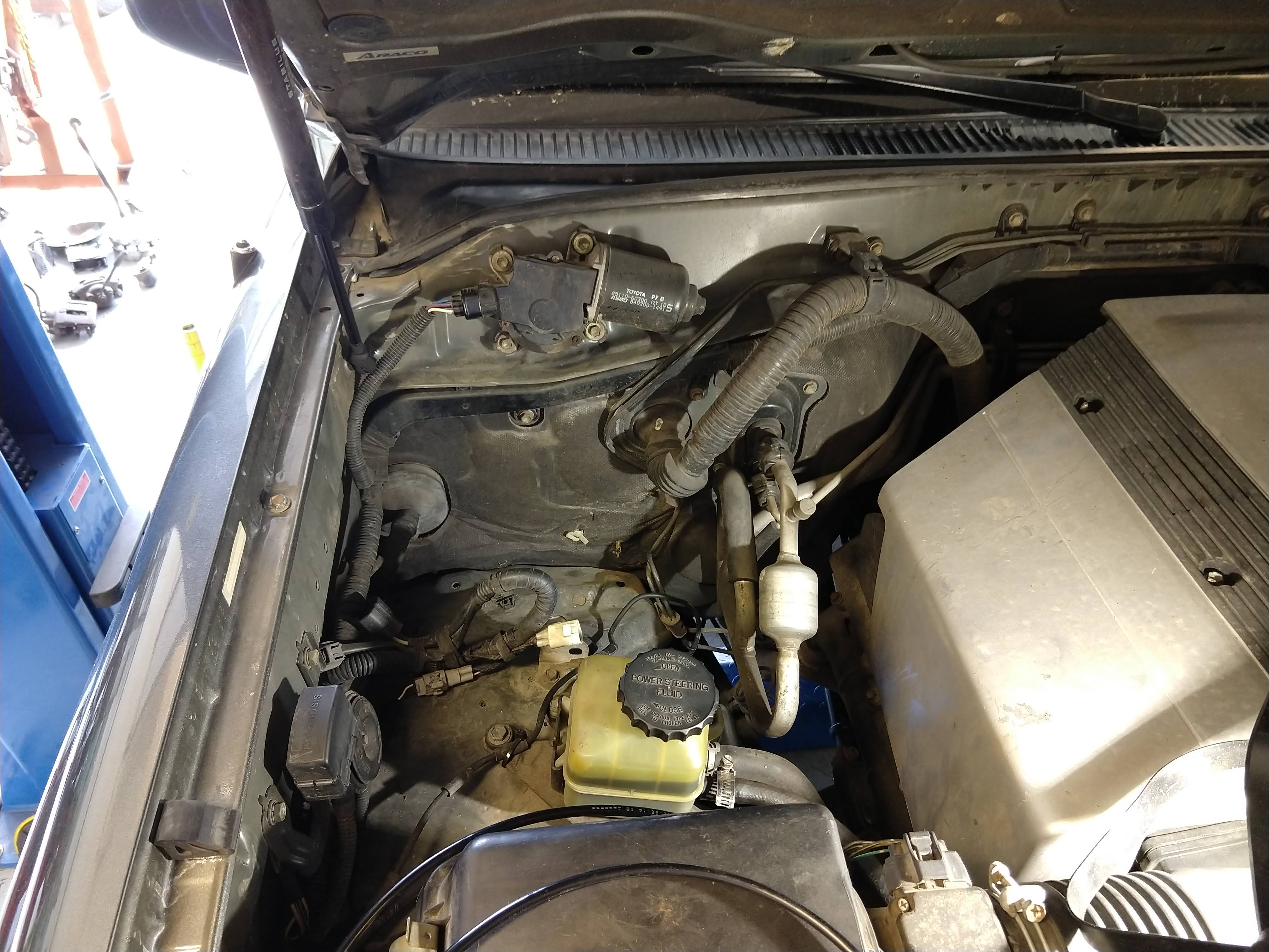

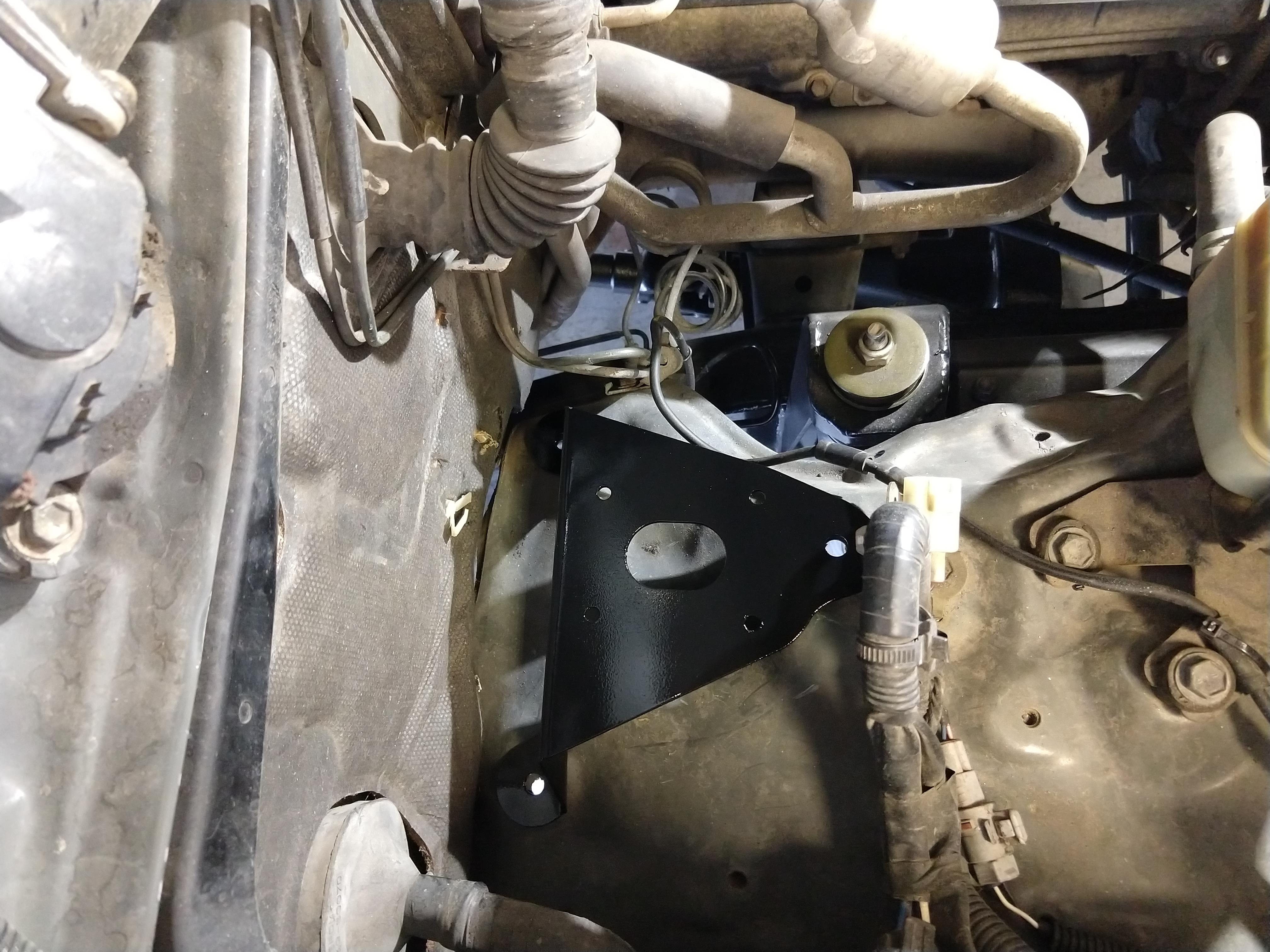

This looks like a nice spot to place the compressor.

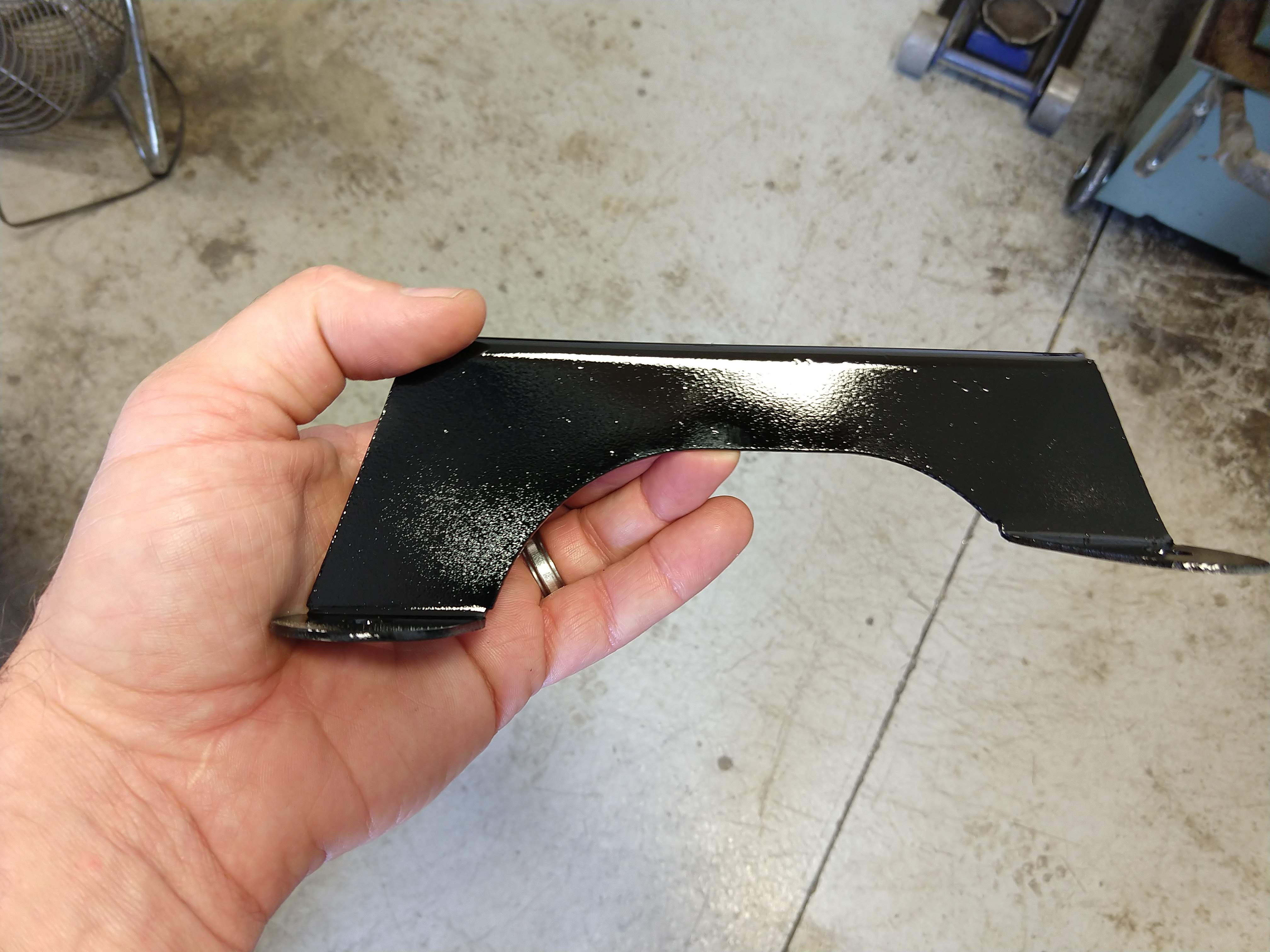

Little bracket that bolts into 3 existing holes in the fender.
What you can't see easily, is that the 3 mounting points are not only 3 different heights, they're also 3 different angles. :( I'm not sure if that's original, or still a leftover from the wreck.

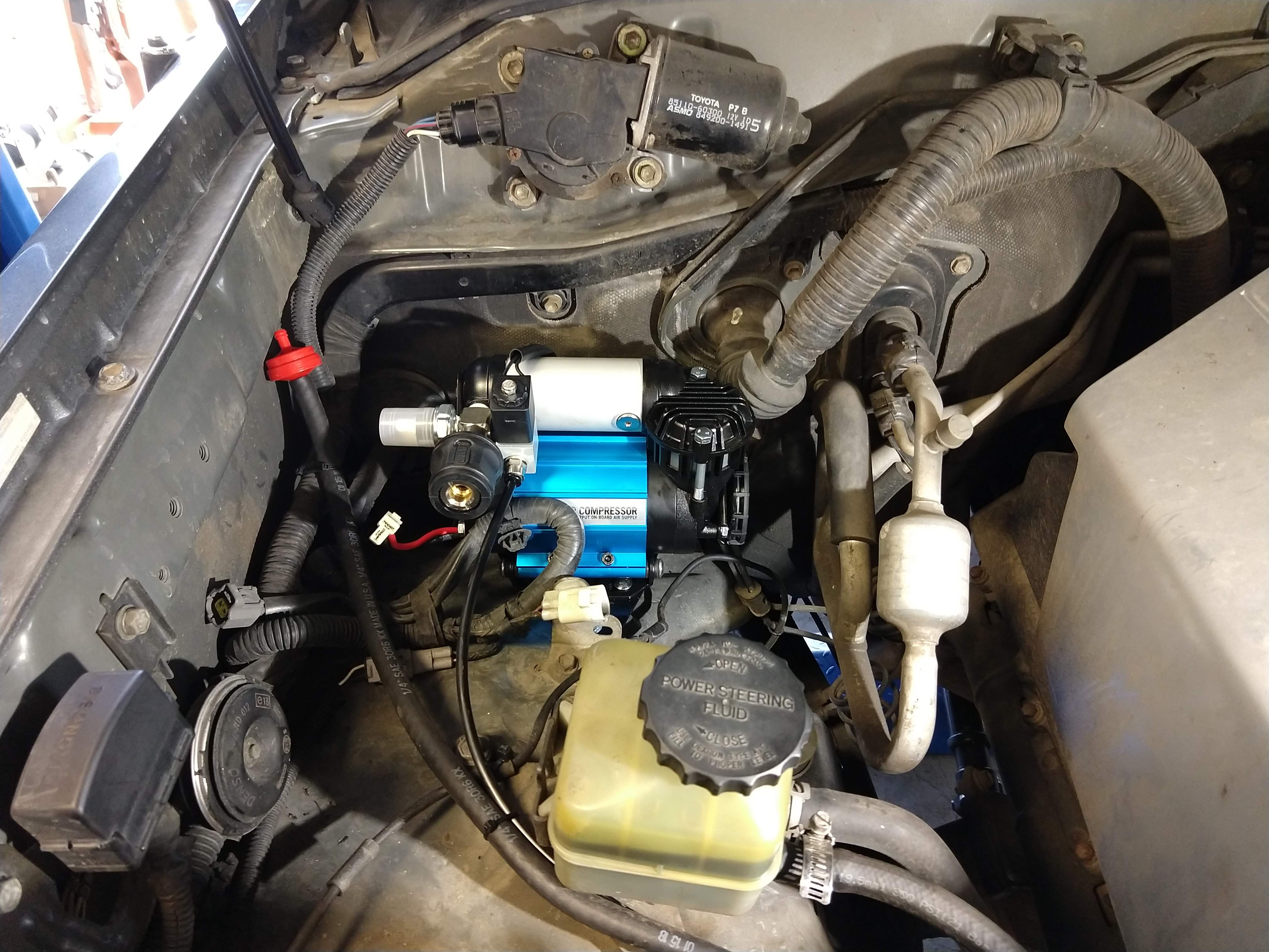

Either way, it all works in the end. Compressor is mounted and partially wired...ran out of time to complete the in-dash wiring, that will have to come next time.

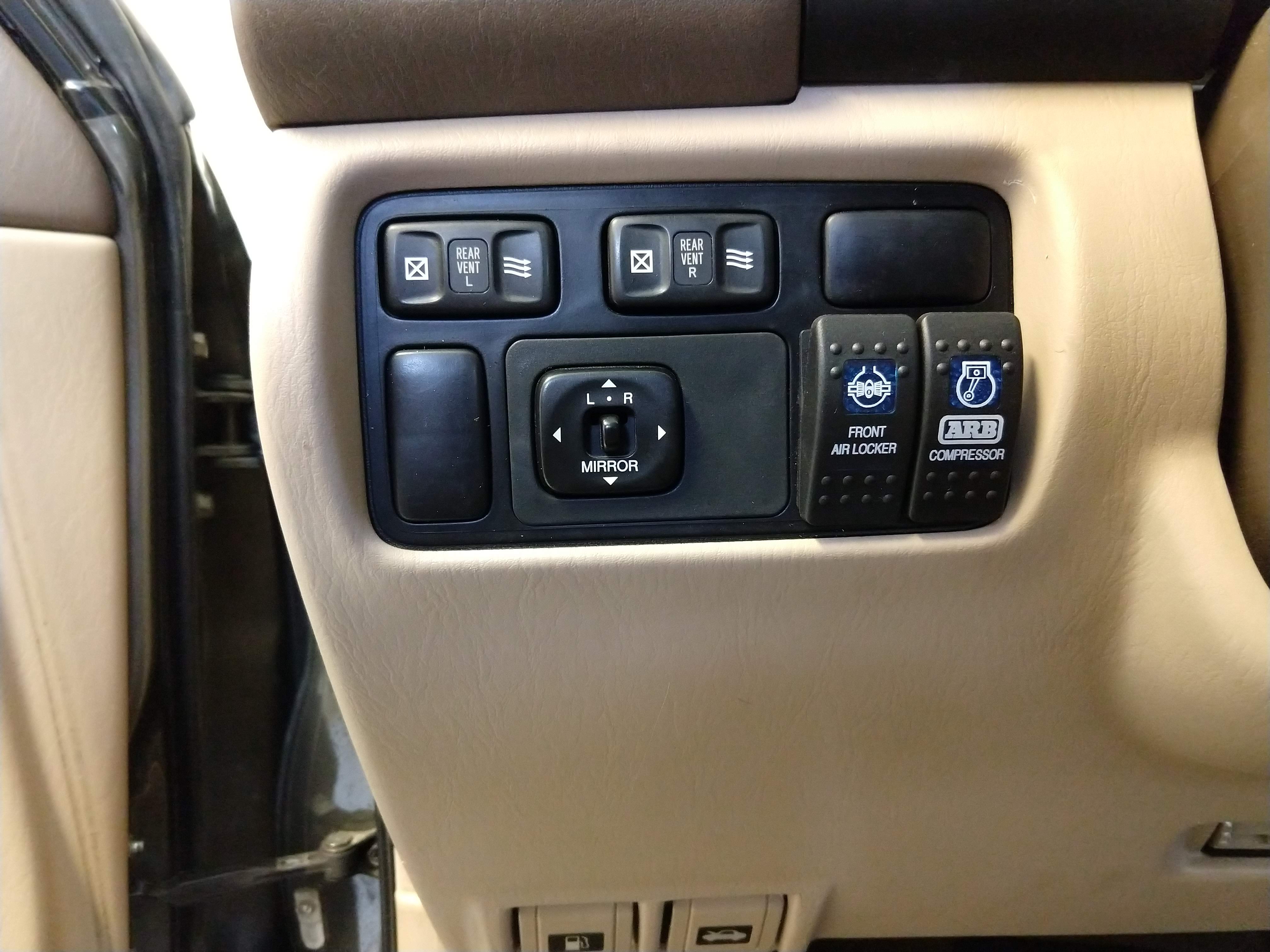

No pretty pics of the inside of my dashboard, but the compressor and locker are now fully functional. :cool: I put both switches where the factory locker switch blank was.

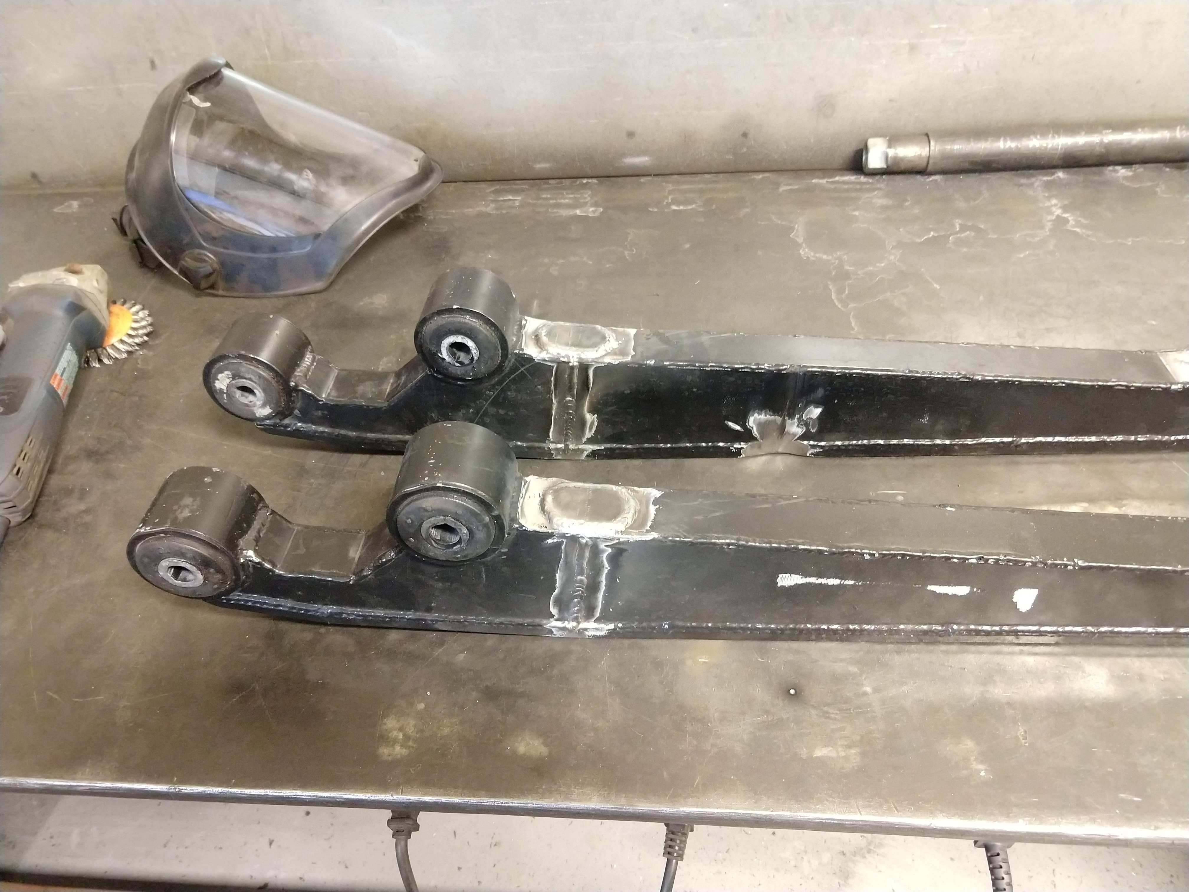

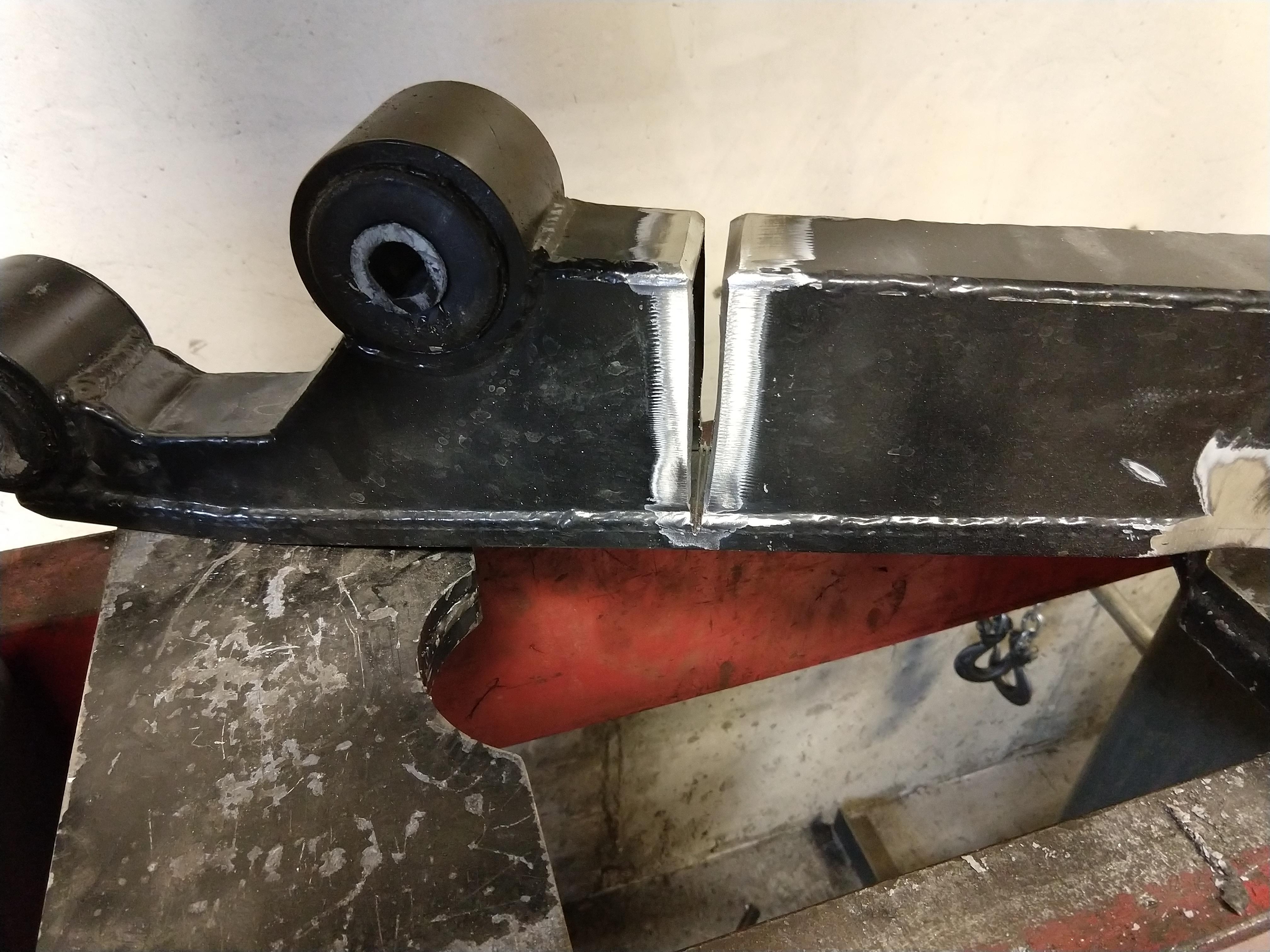

Since my caster adjustment was maxed out, I decided to modify the radius arms. I cut a wedge out with a bandsaw, stuck them in the press to bend the bottom plate, welded them back together and added a fishplate on top. That added about 4 degrees of caster.
Previously, I hadlowered the front ride height about 5/8", which would have given me approximately 1 degree of caster--moving from 3.5* to 4.5*, which completely took care of the little bit of twitchy steering it had on the highway. With this change to the radius arms, I added another degree, so I should be pretty close to 5.5* now, AND the adjustment is right in the middle of its range, so i can now add or subtract caster easily. I can also bring the front ride height back up if I care to, without compromising road manners.

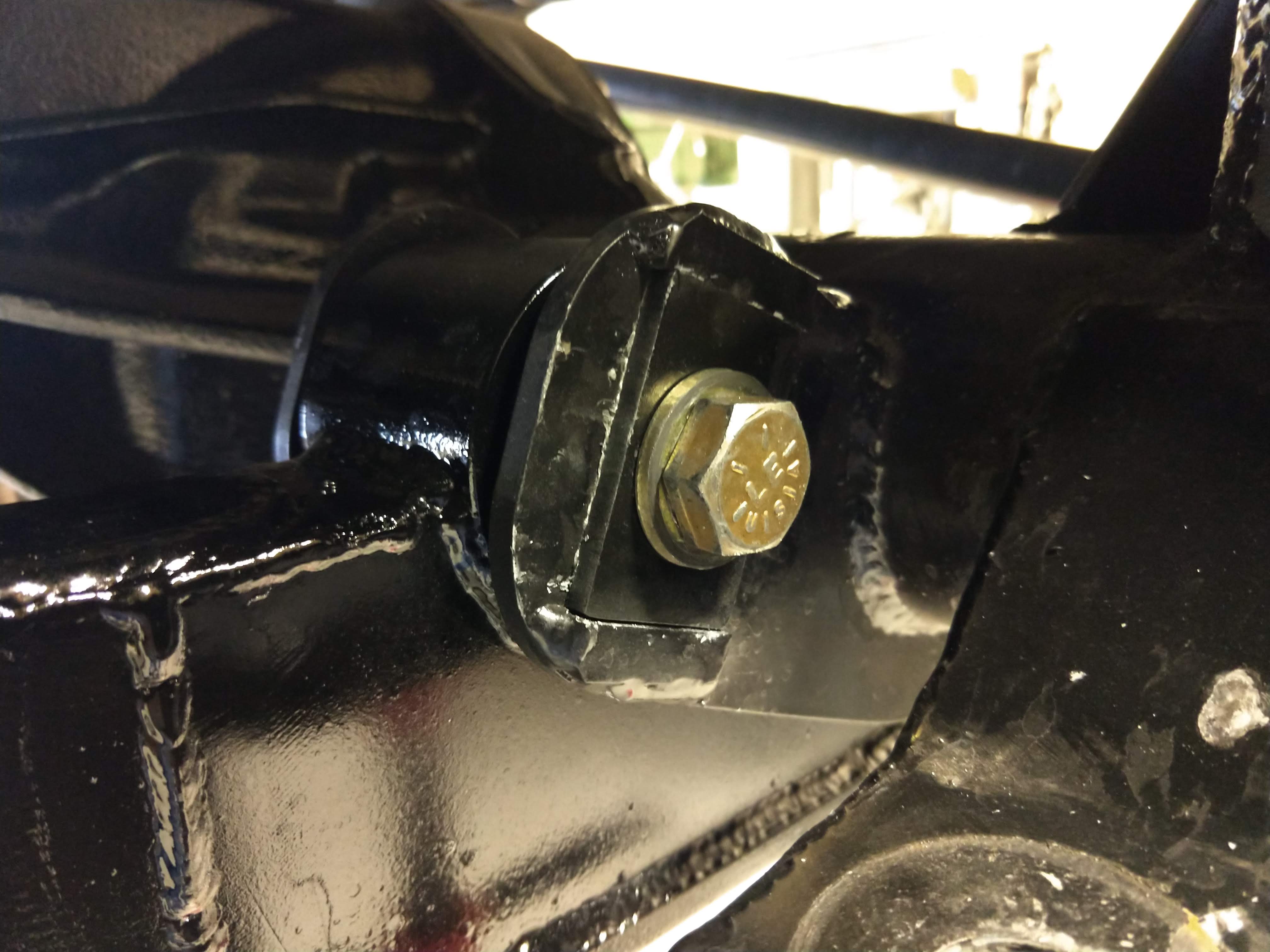

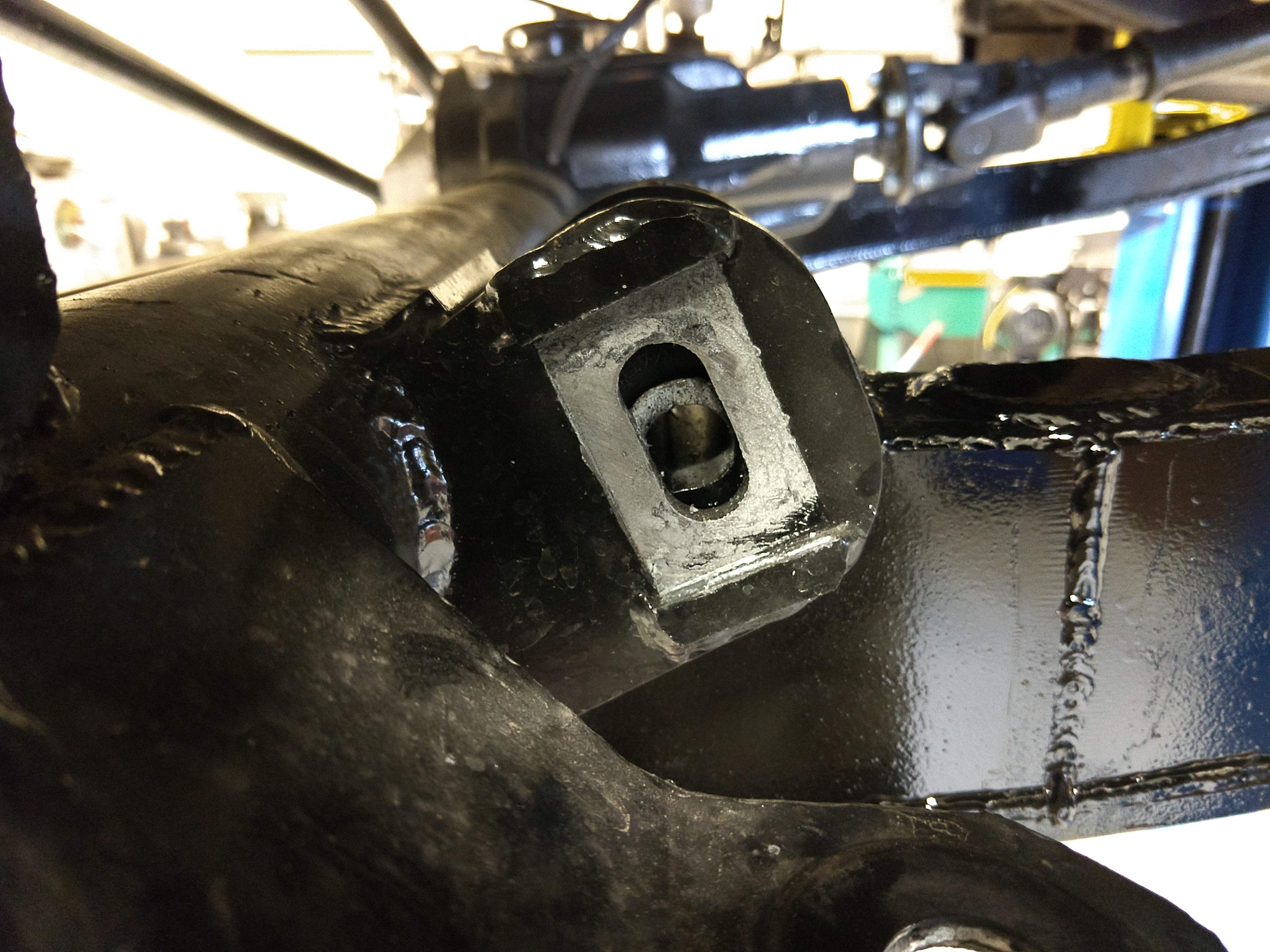

In this pic, the caster angle is the same as before, when the bolt hole was all the way at the top of the slot. :)
The added caster made it even more rock-solid on the highway, although it does seem to want to pull right or left due to road crown a little bit more than it did before. Not necessarily in a bad way, just a change.

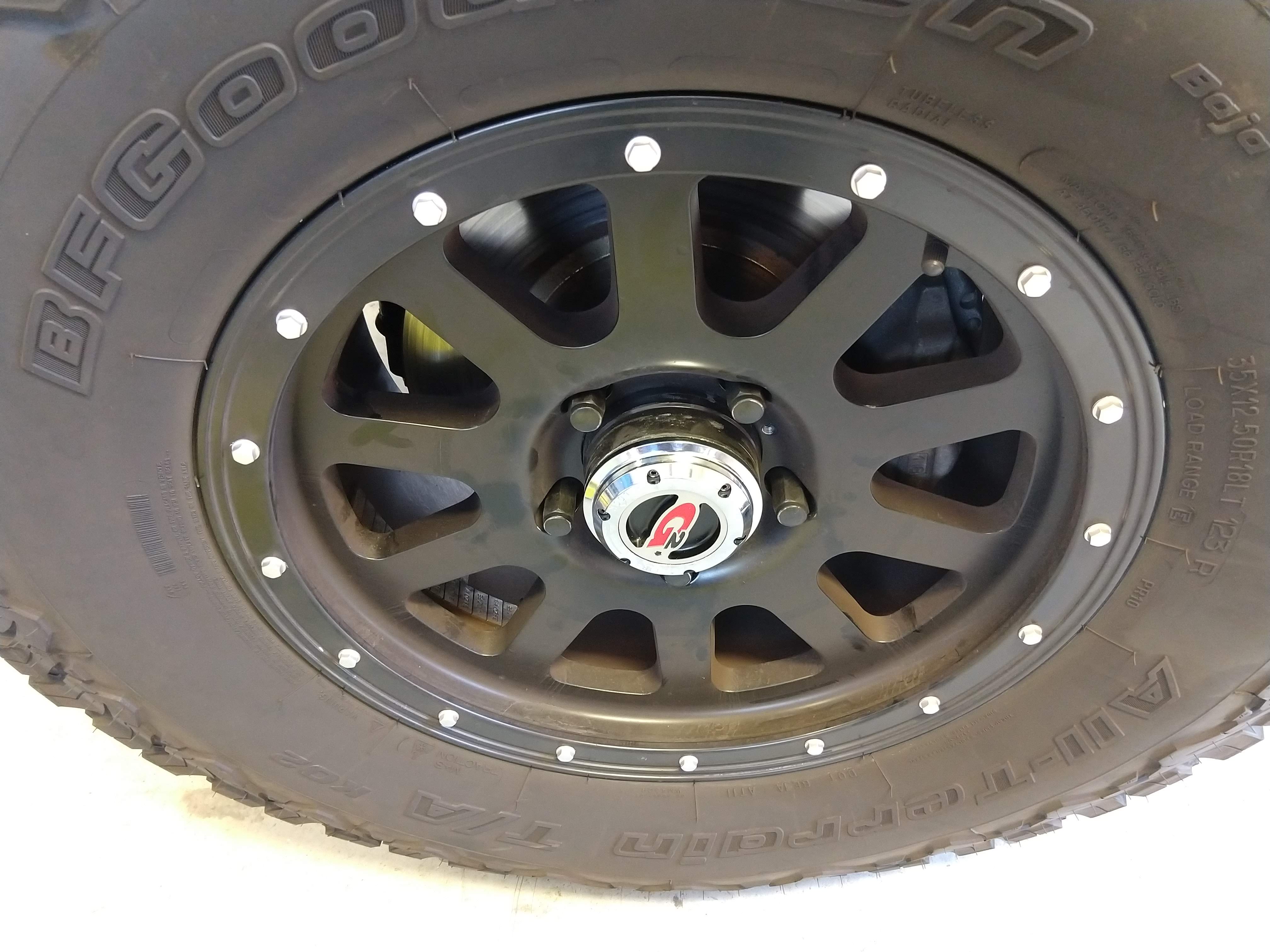

New wheels! There wasn't a single thing wrong with my black wheels, other than I can't find a 5th matching one. But, Method has a closeout special going on that I couldn't pass up. :)
Before:
After: (but I hadn't put the center caps on the rear yet)
The black MB wheels (which will be for sale) are 18x9, +25 offset. The Methods are also 18x9, but +18 offset--so they'll poke out 7mm more, no big deal. That will probably be enough to eliminate the rubbing on the radius arms, but will also make the rubbing at the back of the fender liner a bit worse.
