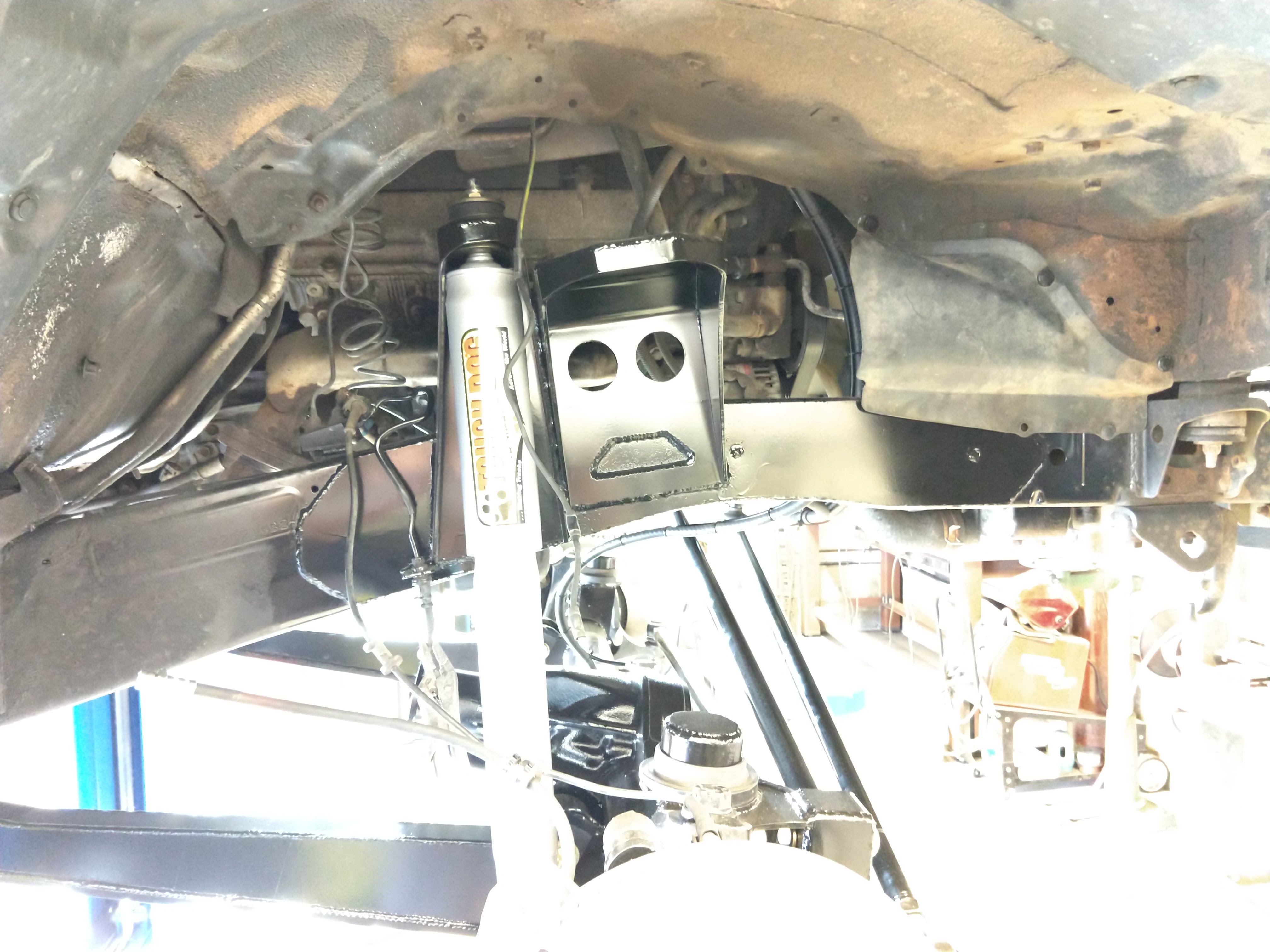

While I'm waiting for my springs to arrive, I took today to take care of some of the time-consuming, but necessary items.

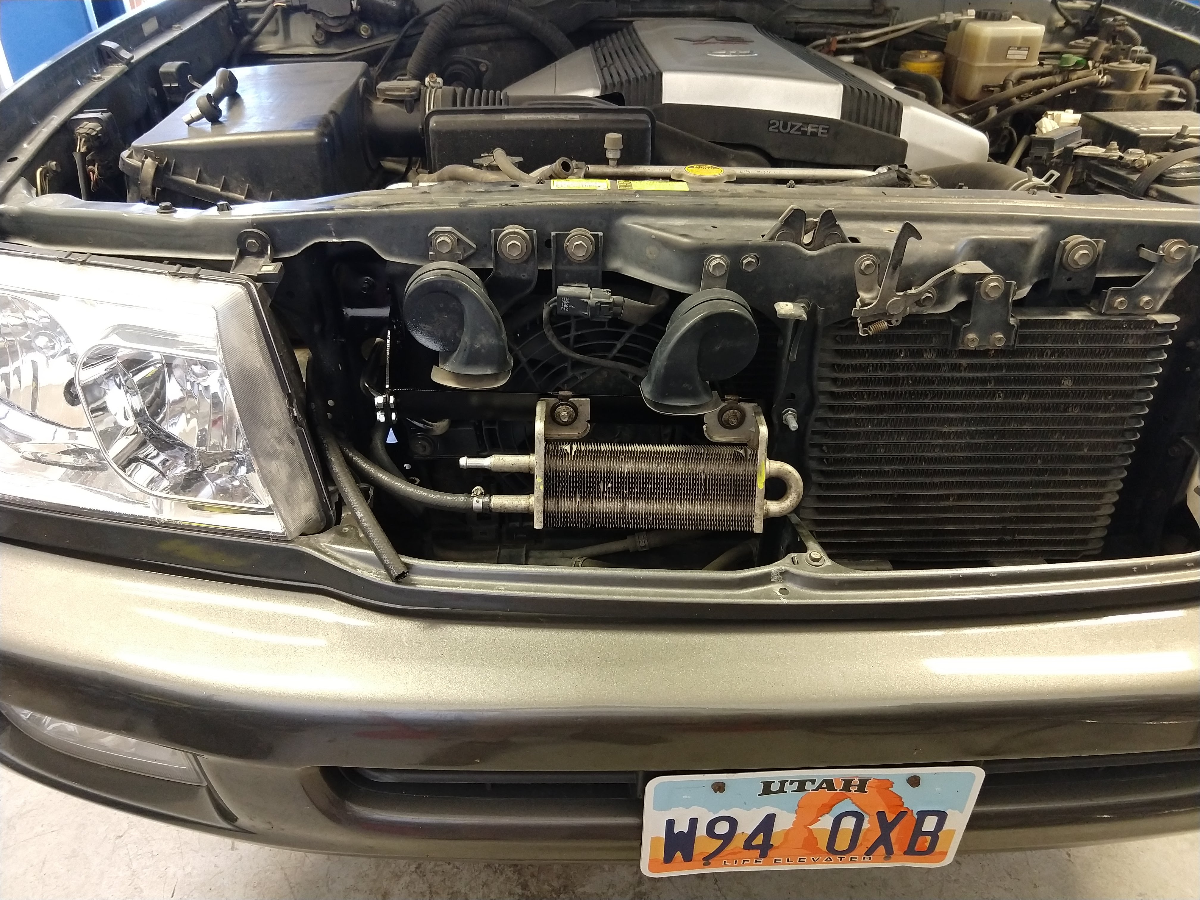

Plumbed the power steering, and added in this cooler from an Expedition. (there is no cooler from the factory, just the hard lines to the steering rack) Had to build a little bracket to hold it in front of the aux fan.

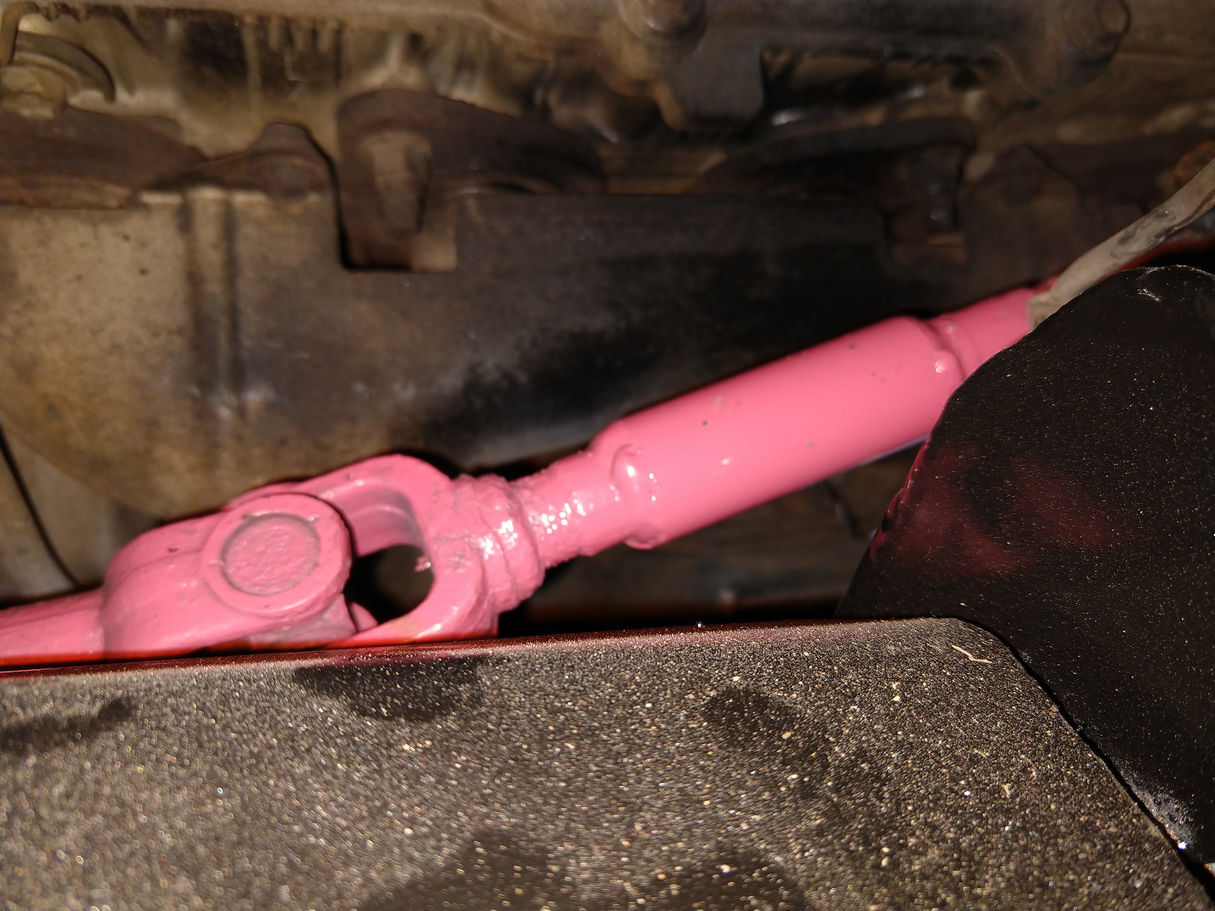

Installed my steering intermediate shaft, which had mysteriously turned itself pink. :confused:

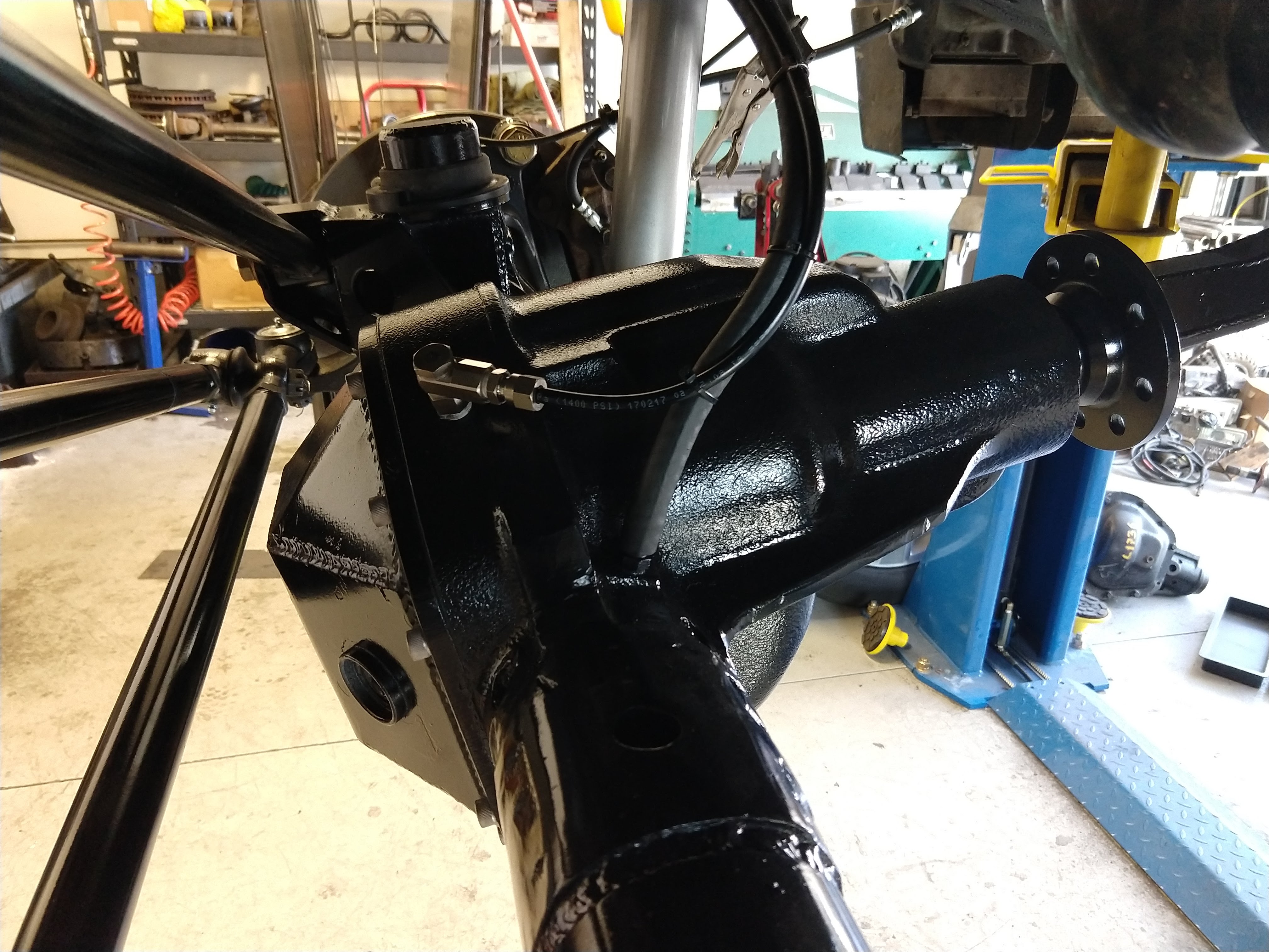

Plumbed the ARB and diff breather.

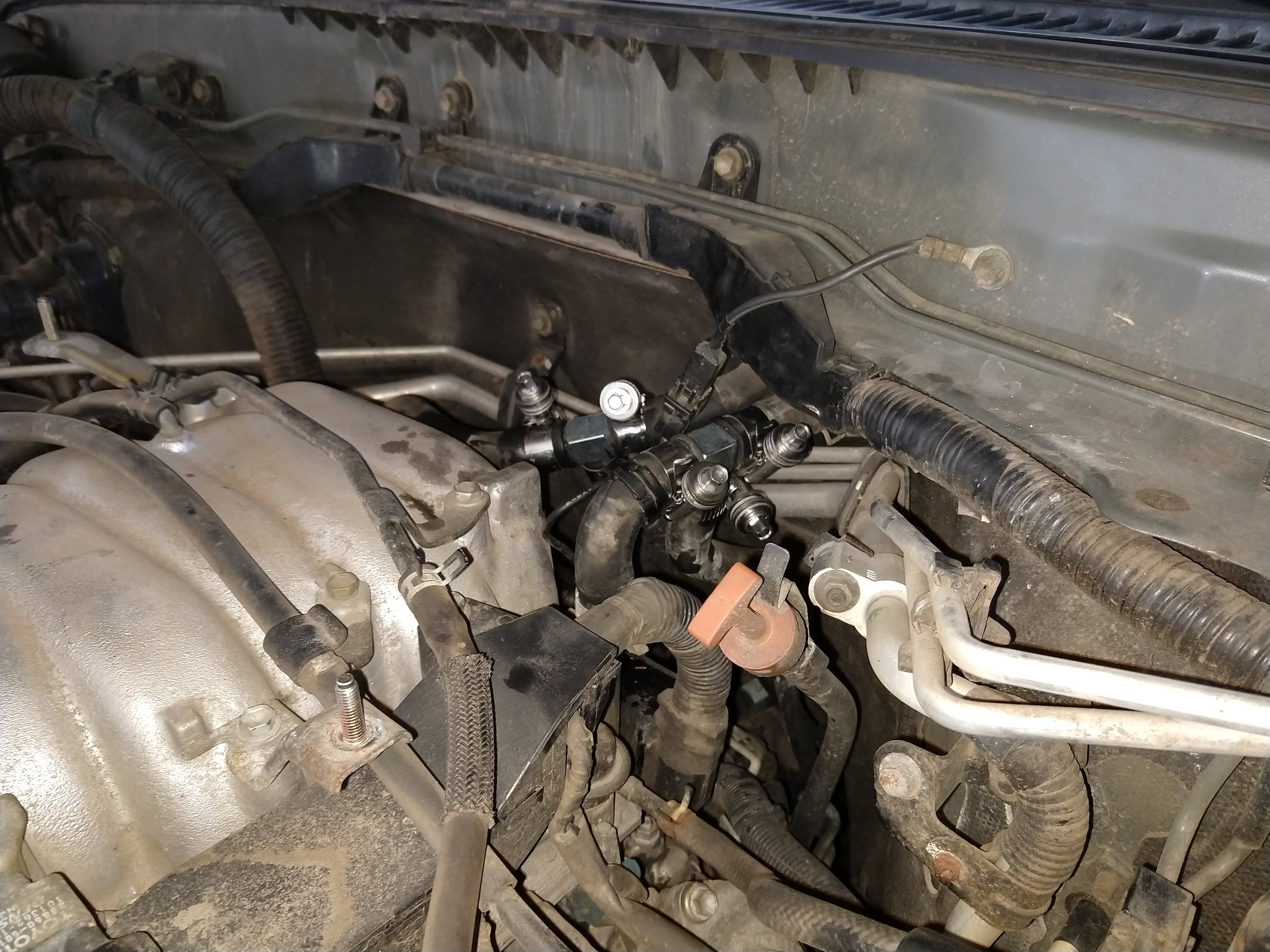

Changed the plastic heater T's to stainless ones, with upgraded clamps.
Trimmed and reinstalled the inner fender shields. I don't have the rear one for the passenger side, maybe I'll try to find one of those.

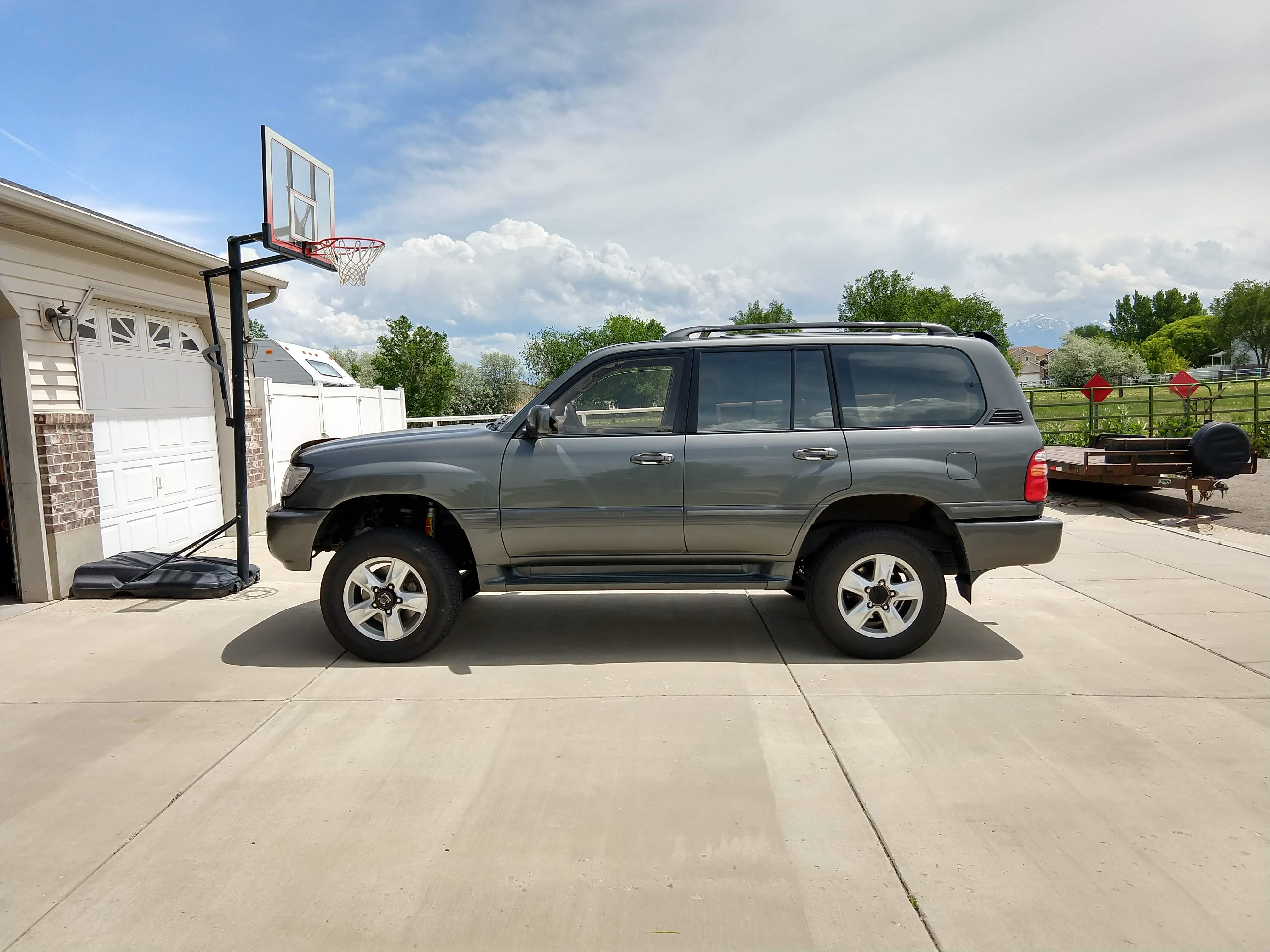

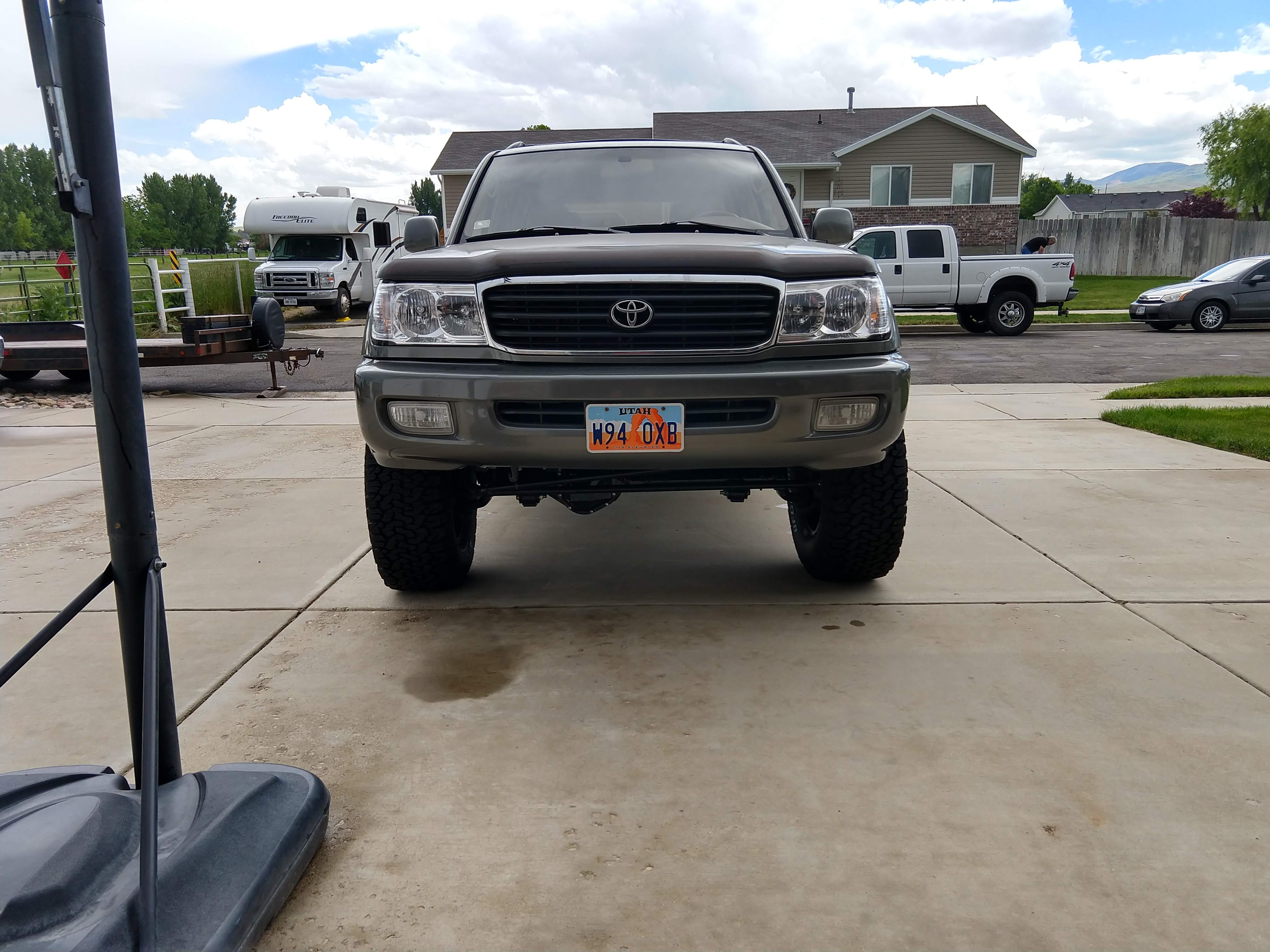

It's out and about. 35/12.50 18's and new wheels will be here this afternoon, but I'll leave the 200 wheels/tires on until after it gets aligned tomorrow morning. It's sitting a little higher in the front than I was hoping, since it's basically level right now--I was shooting for a little bit of rake like "normal" for 100's. I'm not sure if the OME 851 springs will settle any, or not...I'd love for them to sag 1/2" or something. Hub-to-fender measures right about 24" F&R. The rear is OME 860 + a 30mm spacer. Those springs are used, so I'll be surprised if they sag.

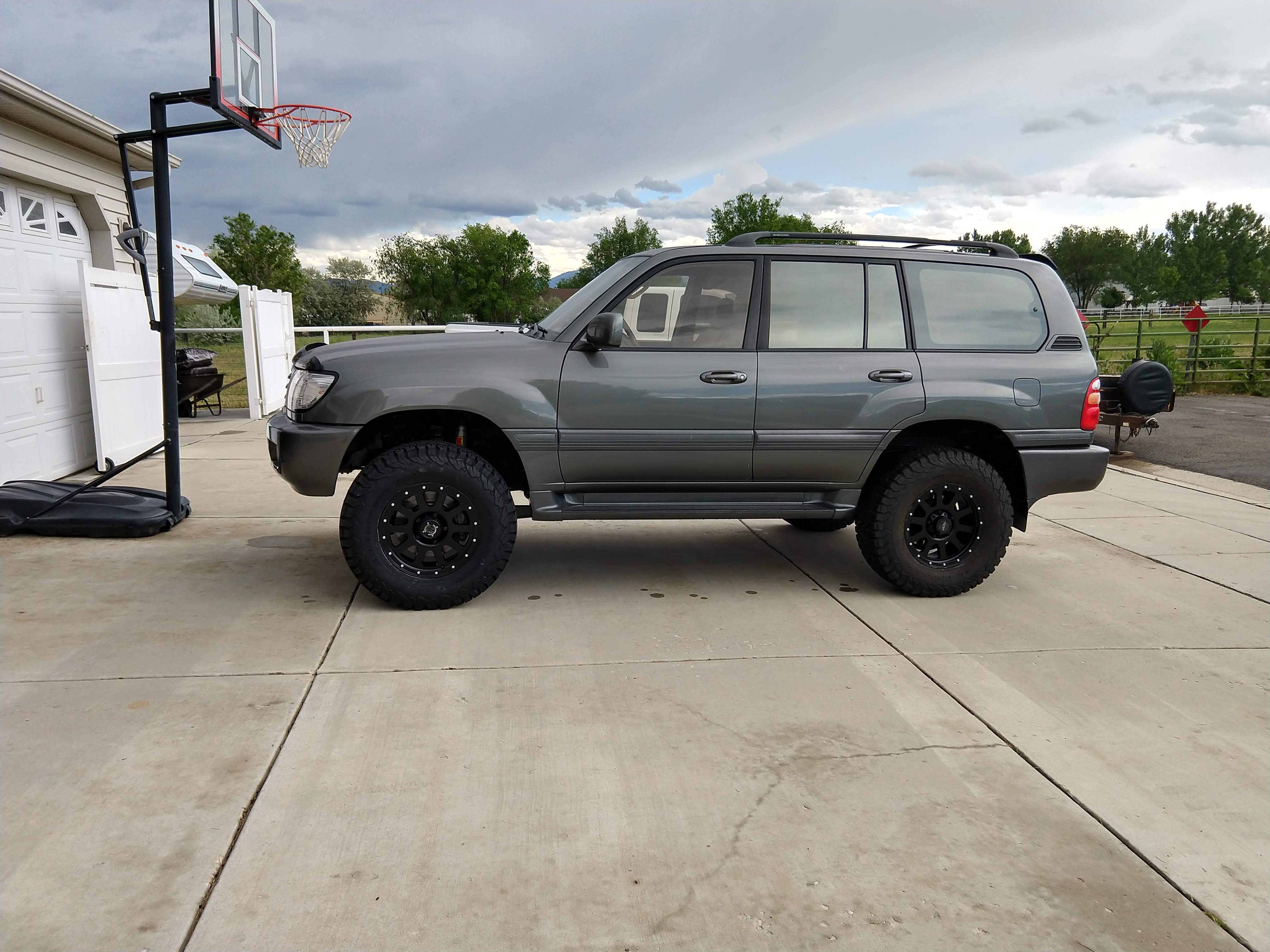

I bought a pair of used 35x12.50-18 BFG AT KO2's, so that made my decision easy for what tire I want to run. :D I bought two matching new ones and had them all mounted on the 18x9 +25 MB Wheels I purchased a couple months ago. Here's what it looks like with them on it:
There is some tire rubbing at times that I'll need to address. I suspect it's hitting the bottom corner of the front bumper, so that will be easy to trim. They also rub the plastic inner fender where it goes over the pinch seam--but there seems to be a lot of room behind the plastic, so I might try to heat/shape the plastic for more clearance. Failing that, it will also be an easy spot to trim.
Turning, at full lock the tire blocks just touch the radius arm. Not very hard, they aren't crammed into it or anything--so I'll leave that one alone for now, rather than limit the steering. It does make me glad I inboarded the radius arm mount though. :)
