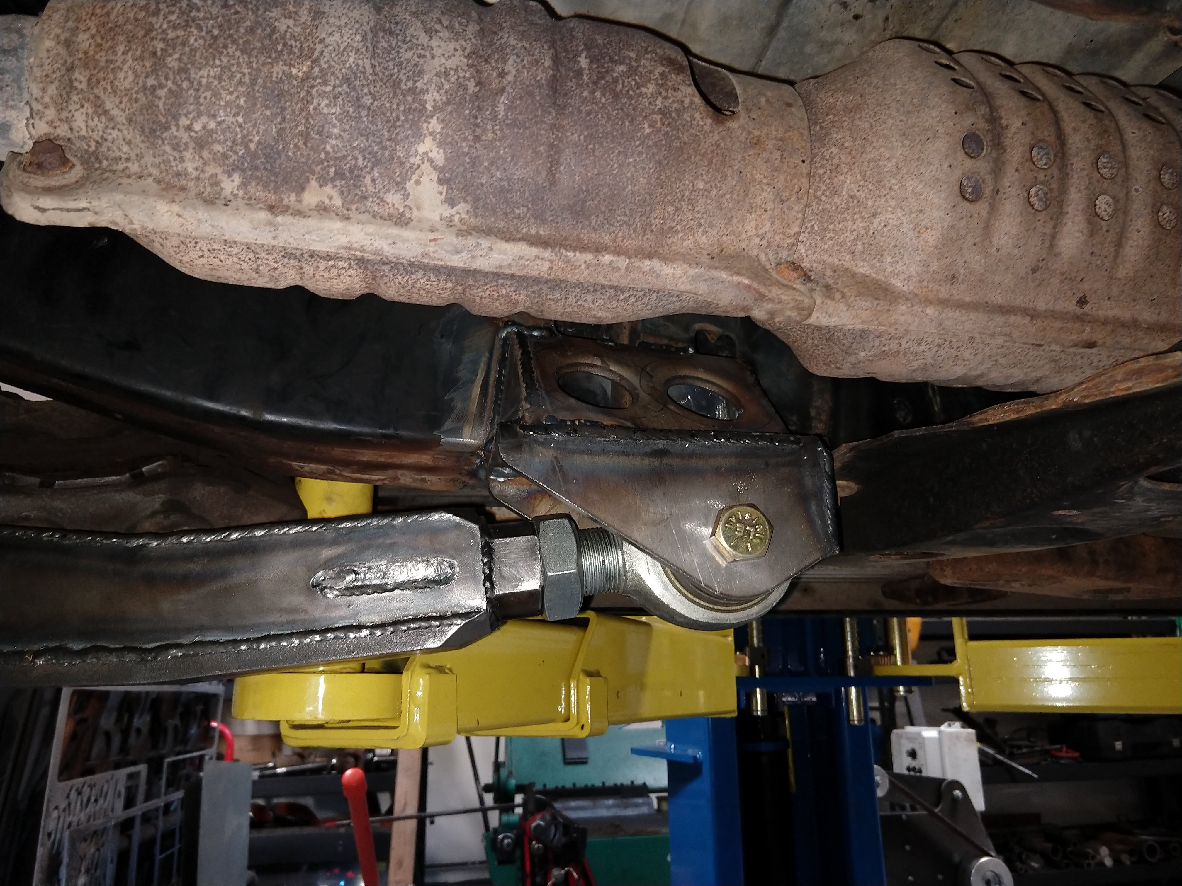

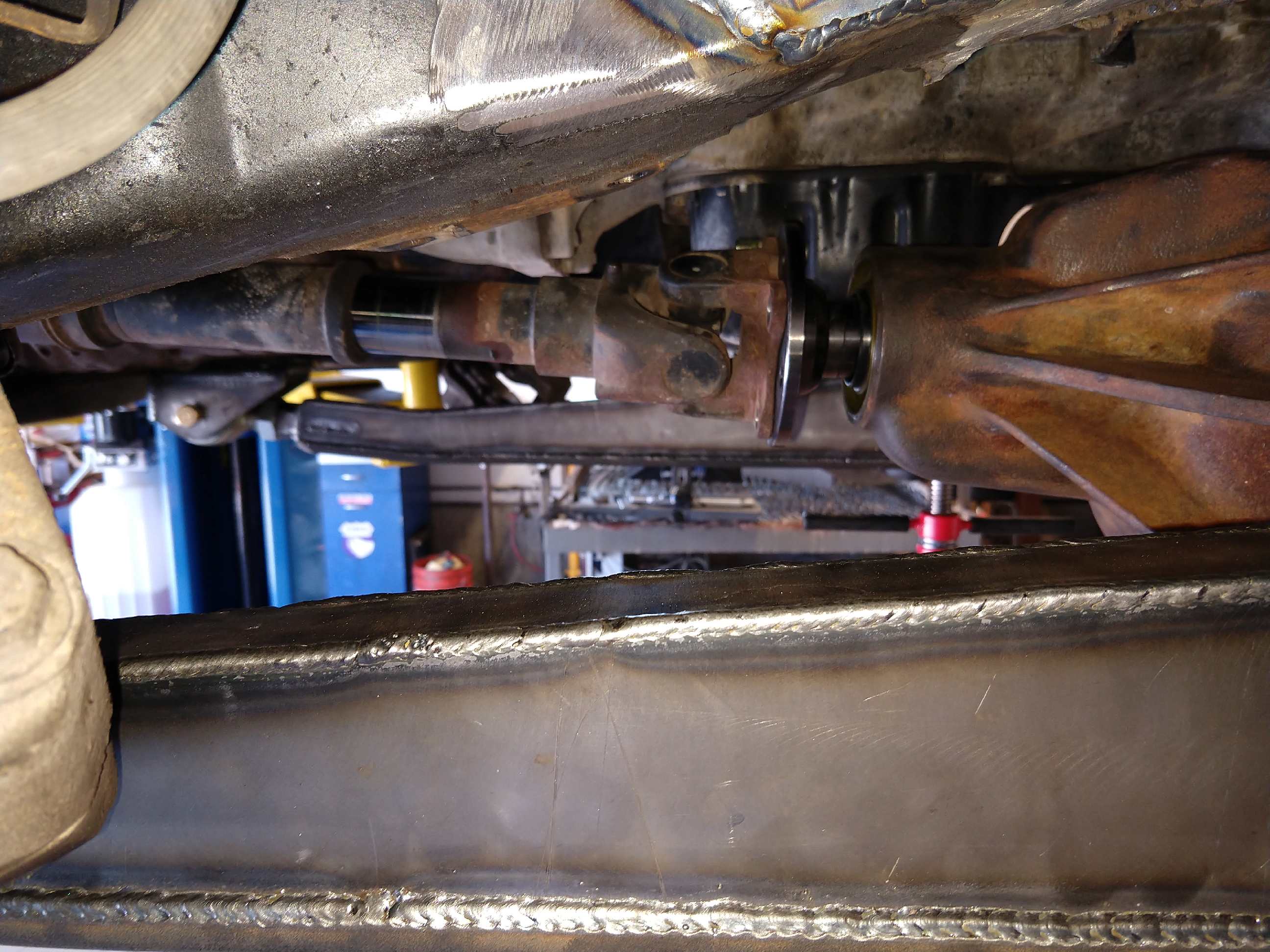

Today I finished up the frame-side radius arm mounts.

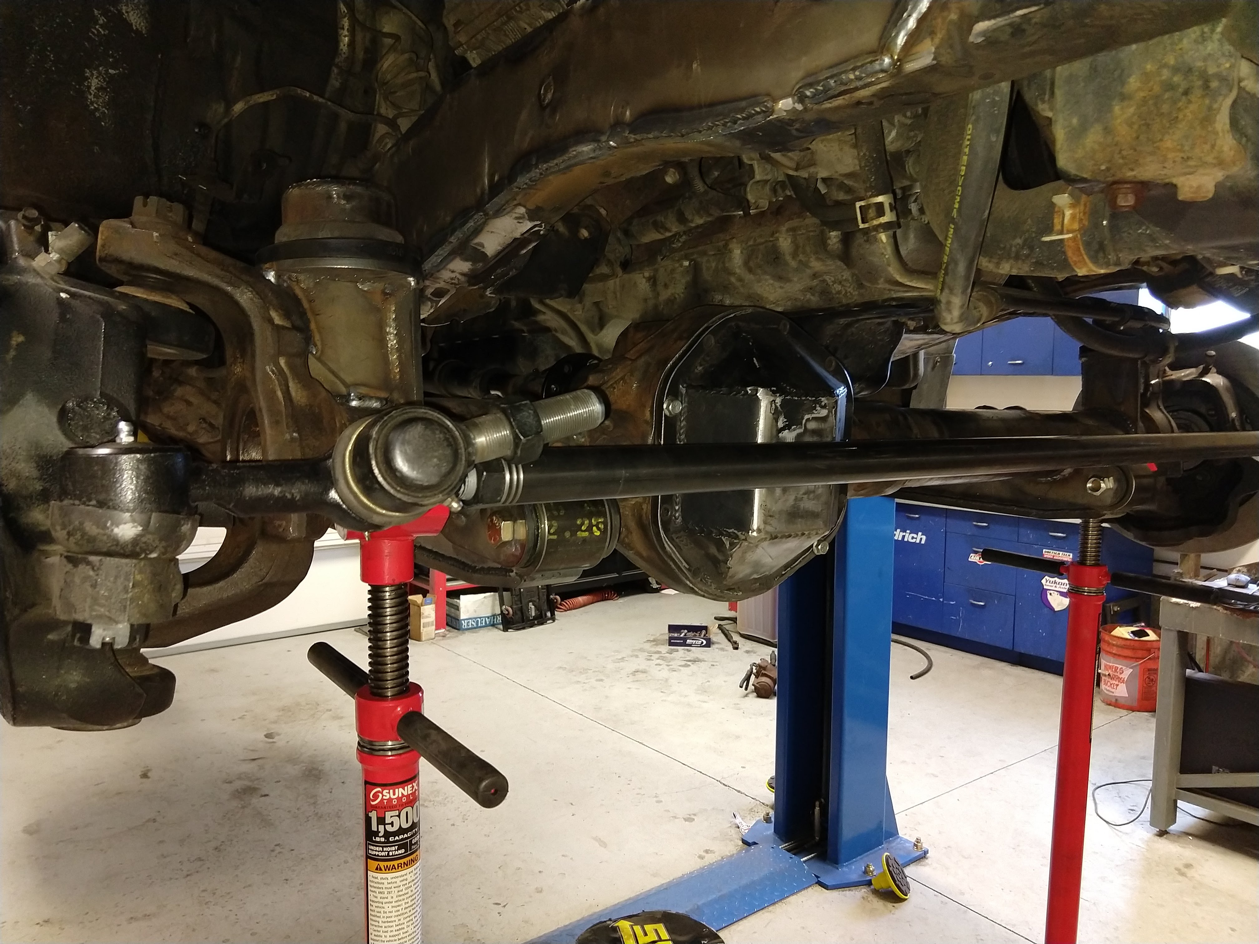

Installed the knuckles, unit bearings, and tie rod. I'm going to do the drag-link-attached-to-tie-rod "inverted T" steering...which I don't like as much as other options, but it is simple, works decently well, and keeps everything out of the frame.
Made some spacers to go between the axle and frame, and set the thing down on its wheels to measure the wheelbase more accurately. The height shown is about 1.5" higher in front than it was in the "before" pics. (before measured 21.25", this is 22.75" center of hub to fender) Actual ride height will probably end up a tiny bit taller. Wheelbase in the pic is 113.5", which is 1.25" longer than factory. (in my case, I measured 112.625 on the driver side, and 111.875 on the passenger) I think I'll pull the axle back .5"...so that should be about .75" forward of stock. Anyone have any input on that dimension? I can still change it easily, since I haven't welded the upper coil mounts on yet.
And lastly, here's a pic showing the pinion/driveshaft angle. This is the factory front shaft, which is a bit short. I have a CV shaft that will be going on there eventually, which I bought from @Jake97T here. :)

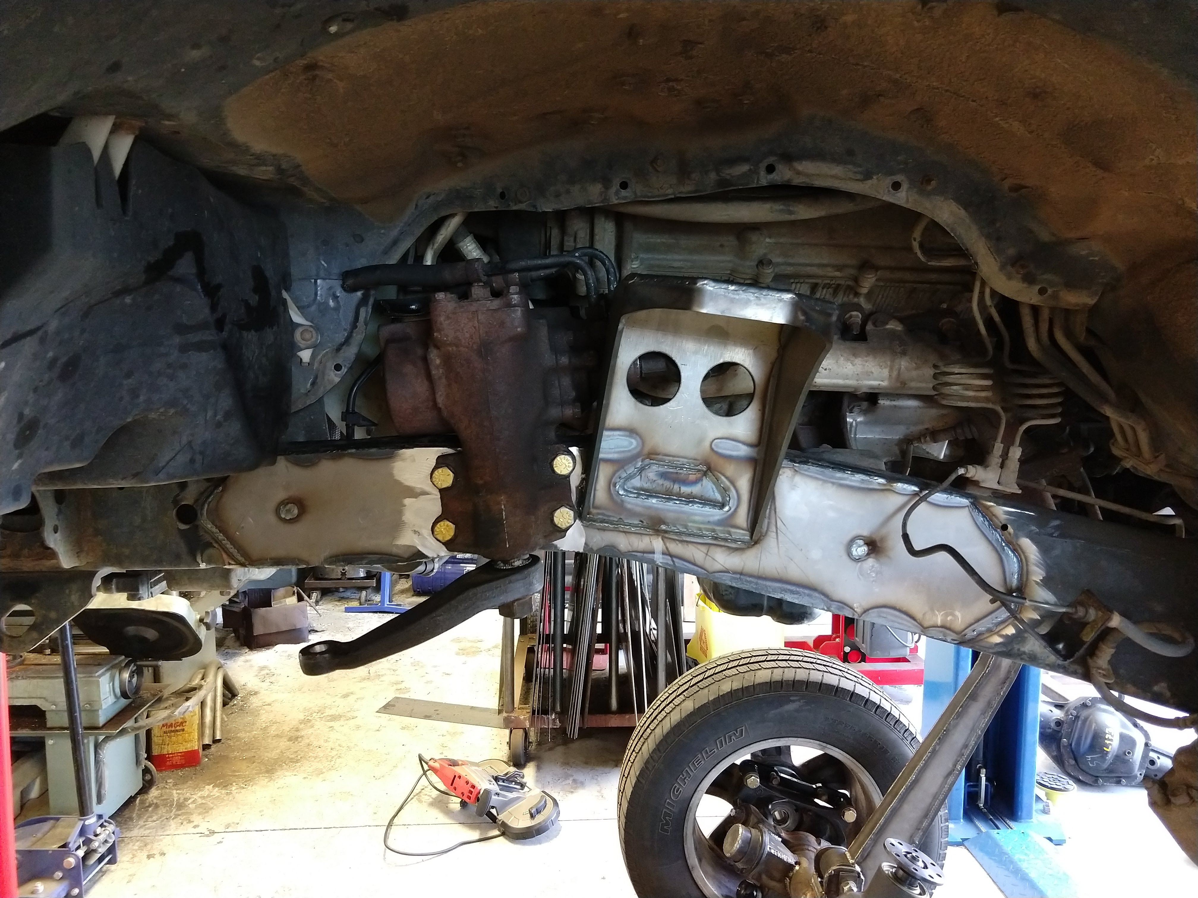

Only one pic from today...but I shortened the radius arms 1/2", put the upper coil buckets in place, mounted the steering box (welded sleeves in the frame), reamed the tapered hole in the pitman arm, and made the drag link.
Good news: I was worried about the oil filter, but the drag link will go under it no problem.
Good news #2: I do NOT have to relocate the passenger side engine mount to clear the pumpkin...which also means I do not need to make a new oil pan. :)

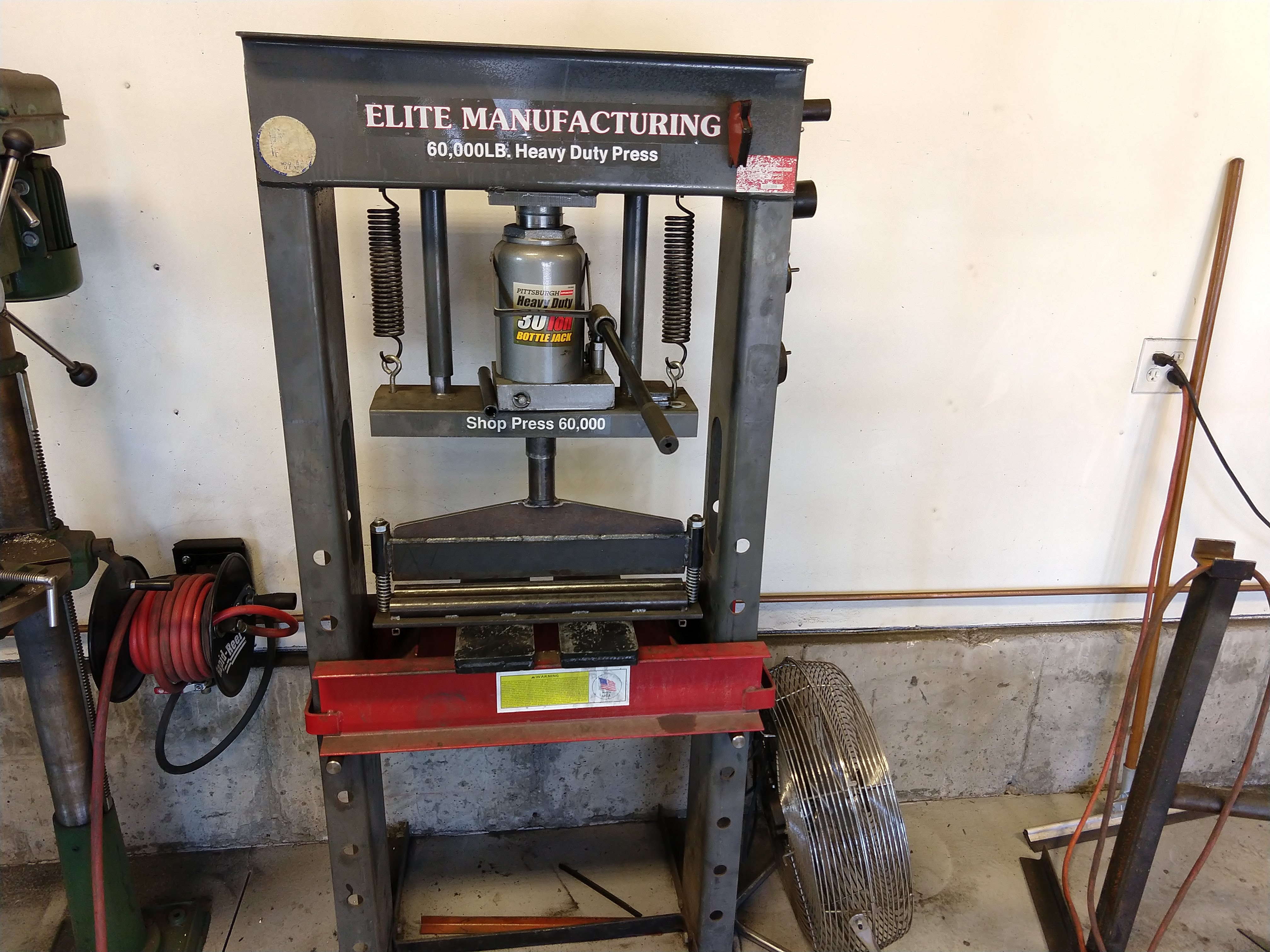

Do you do your own bending? What does your brake setup look like? Basically, what I am saying is, I want to see how your garage is set up :)
Yeah, I just have a homebrew press brake. If I had to do it over again I'd just buy the SWAG one, but this one works.
