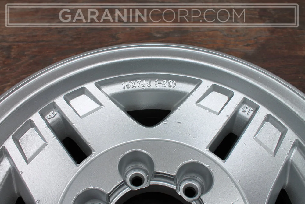

That wheel style comes in all kinds of sizing. You see that style on the 70 series, 80 series, 4runner, Toyota pickups, etc. I have never seen 15X7 -22 offset myself but I wouldn't be surprised if it exists.
You are correct, that wheel did come on many different vehicles from Toyota during the late 80's and 90's in the US and other markets. I was surprised too as I assumed they were all the same, but they are not. You will know by looking at the numbers printed down in the wheel openings. Correction, -20, not -22 offset. Since I don't have my wheels in front of me, I'll reference this website and photos. Credit to www.garanincorp.com
15X7 ET-20 (Same thing as offset.) is what I mentioned earlier in this thread and do have this specific size on my own HZJ77. It is a very common JDM size for the 77 series.
