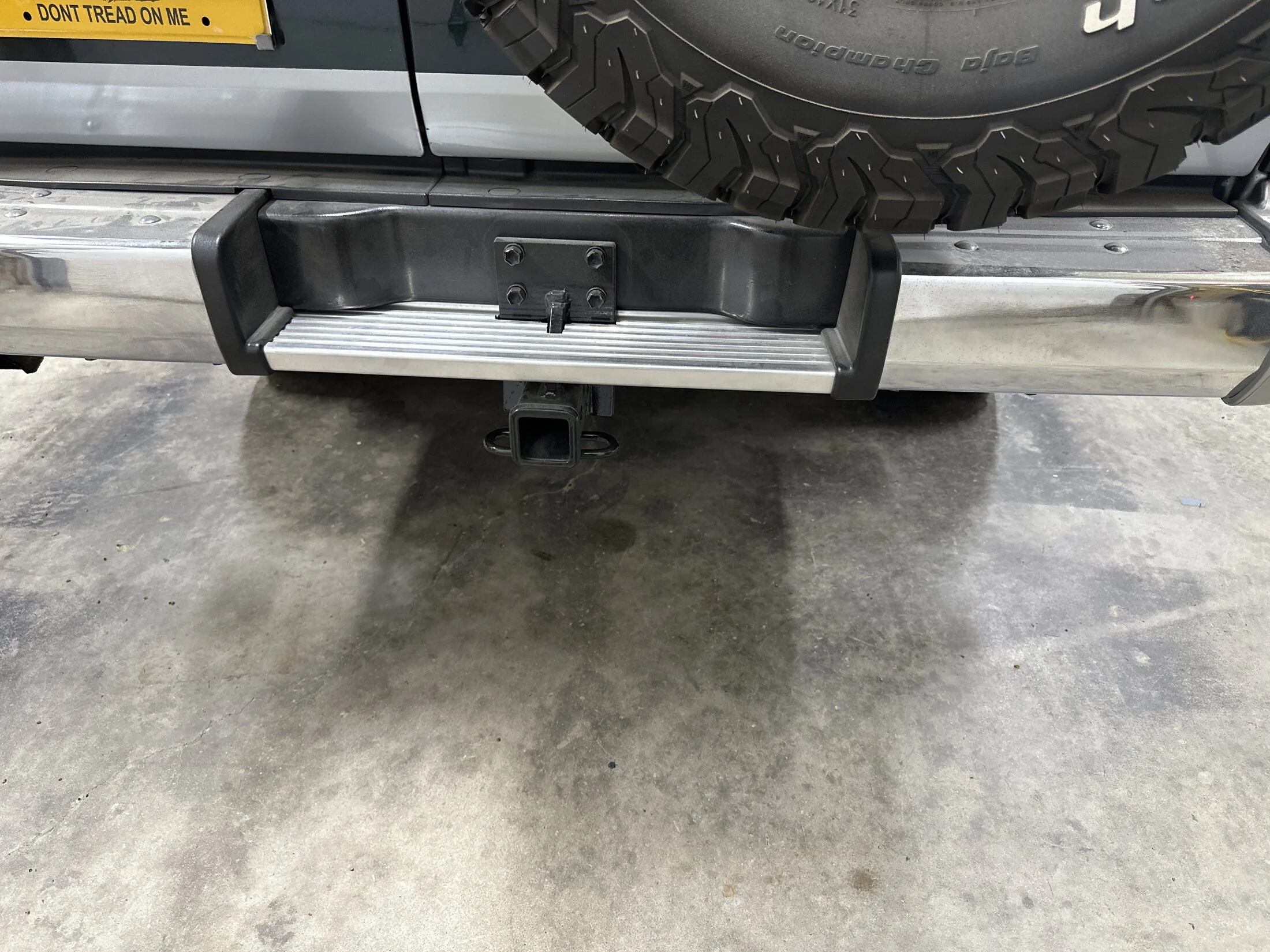

Something like this but you have to find the right bolt pattern that matches your trucks. I personally wouldn’t tow with this but should work fine for a bike rack
lol. Does it really come with 4 lag bolts and 4 expansion anchors?

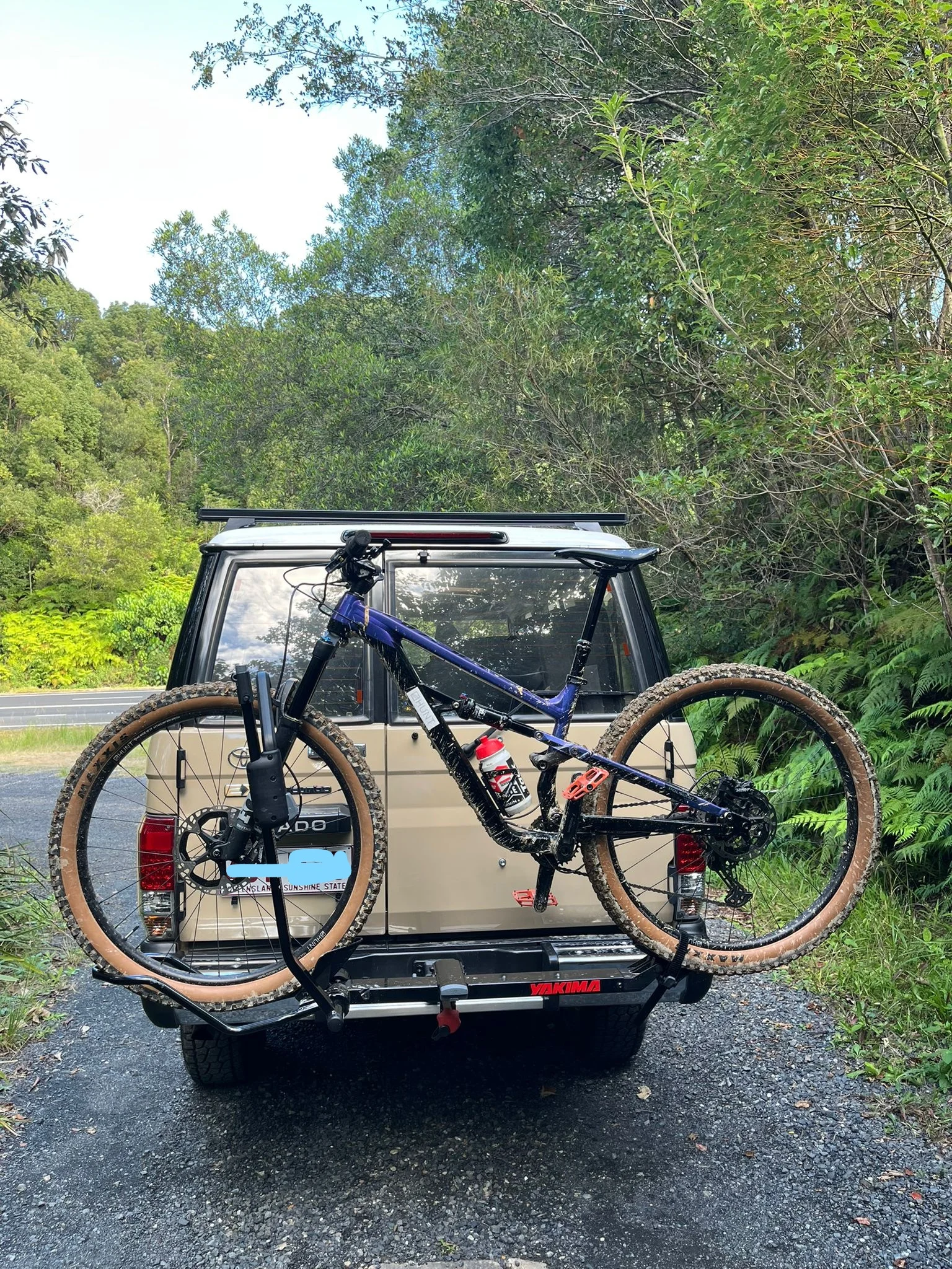

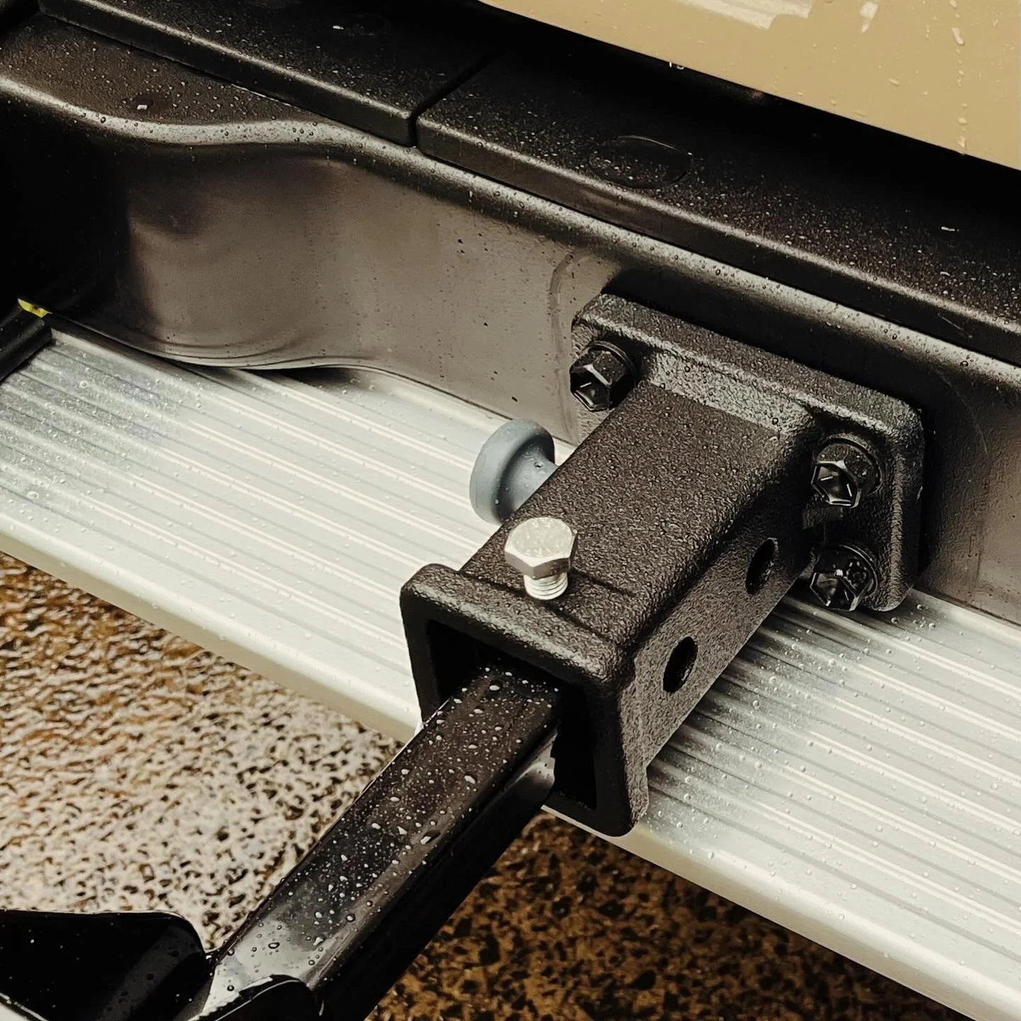

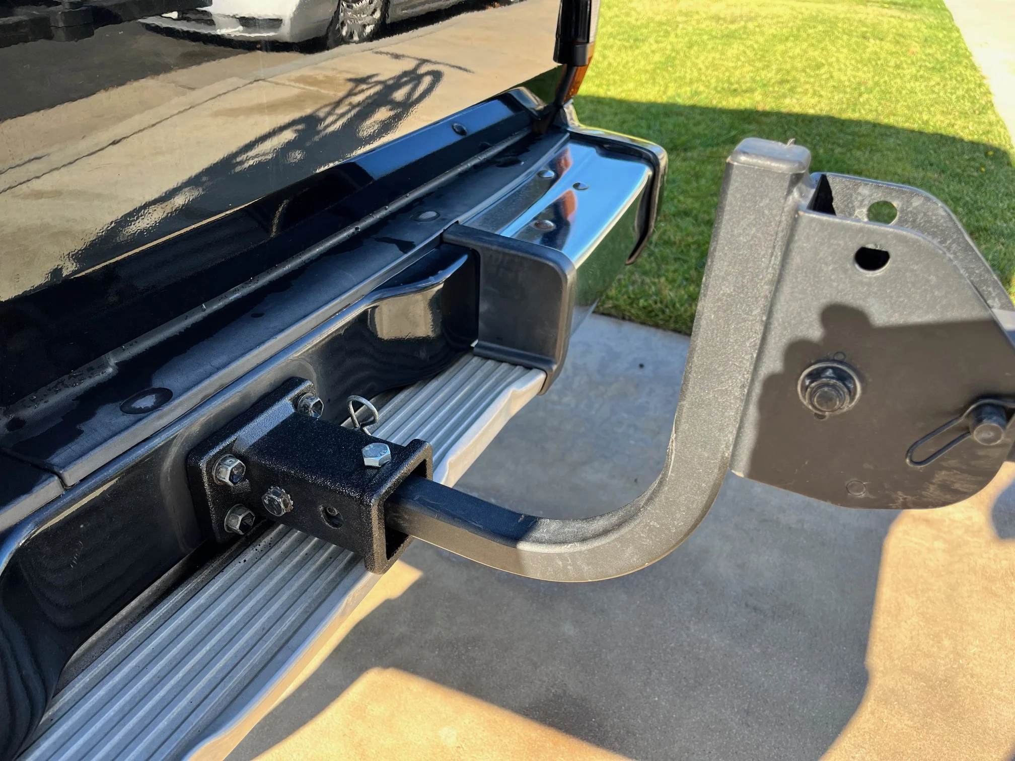

I got this one, I could only find it on amazon though. Best part is it doesn't require any cutting or drops lower. I use it for my single bike carrier, I can still open the left side door when it's on - The 30 year old bolts were a nightmare to get off!
hitch
View attachment 3916188View attachment 3916190

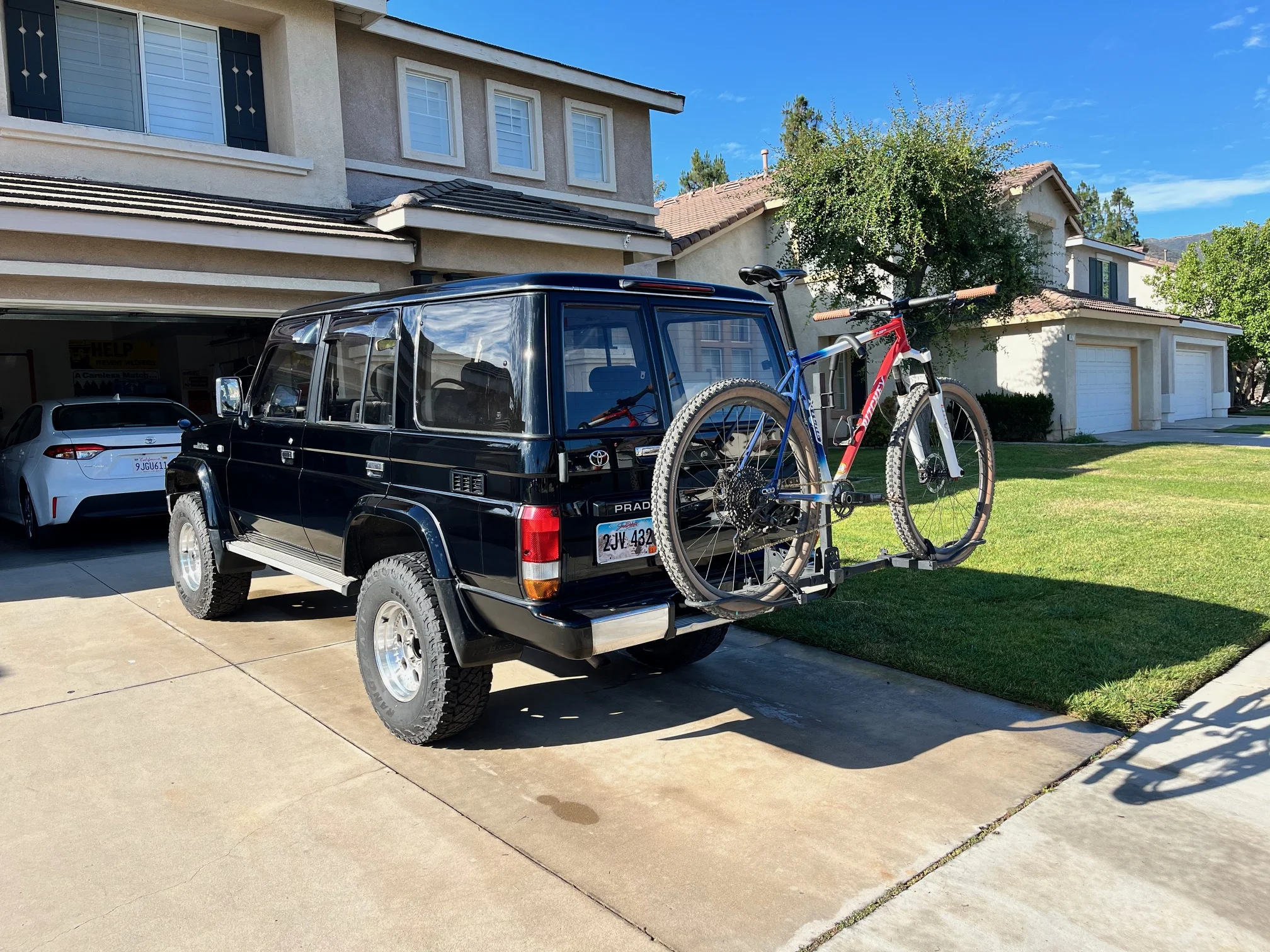

I'm using the exact same one as well, works great. Note you will want 4x bolts from Toyota to mount it easily (which was used here as well) see part number below:
91612-61045

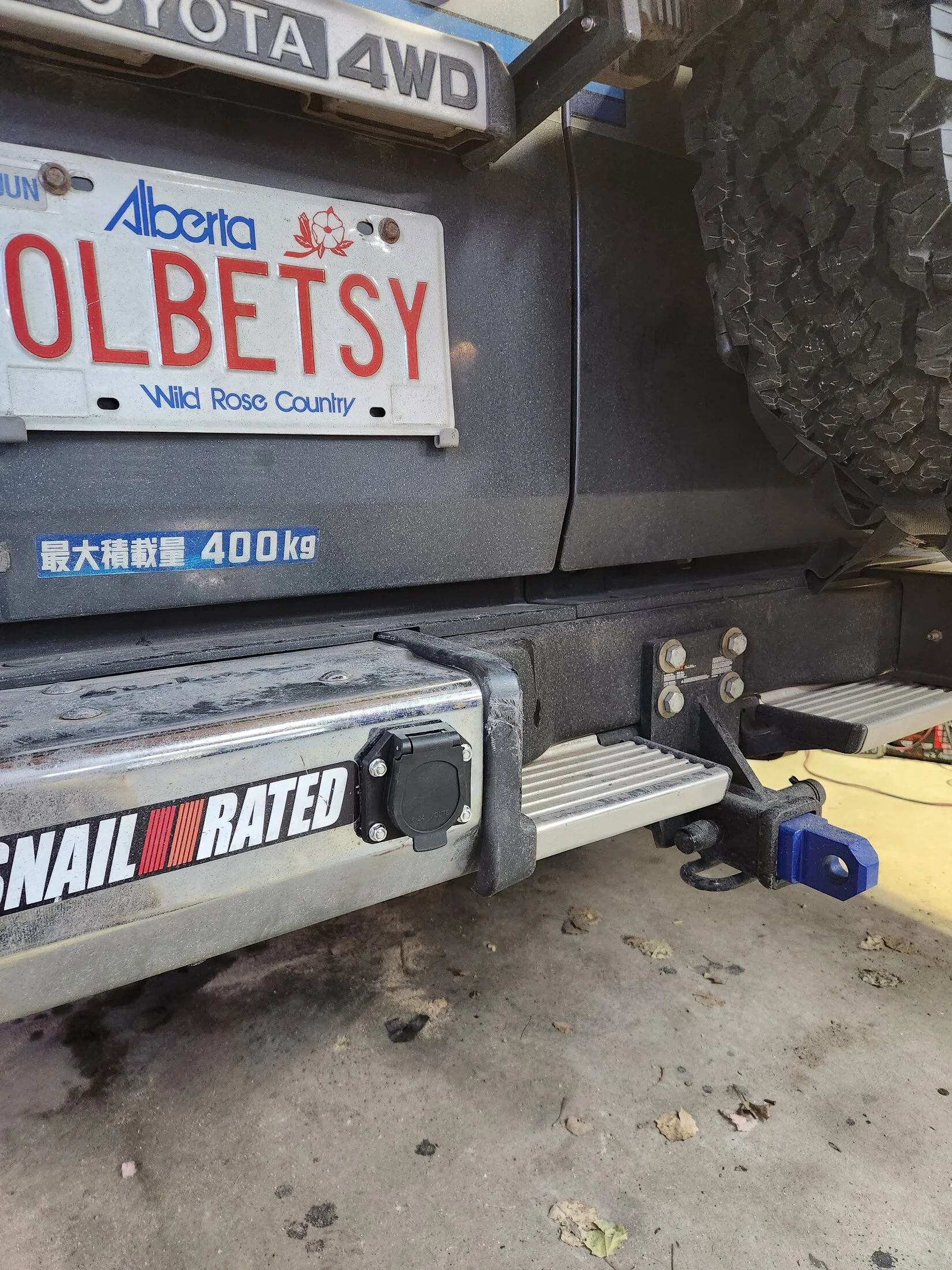

Has anyone put some serious weight on these hitch receivers? I'm debating on putting my dirt bike rack and xr600 on the back. the bike alone weighs around 275 pounds. can the rear crossmember handle that much vertical weight? I see an actual tow hitch purchase in my near future.
Dusting off this thread again,
I don't think I'd trust mine (pictured above in this thread) with that much weight. There is a tremendous amount of leverage in a concentrated spot. Even if the hitch could manage it, I'm not sure the cross member would be loving life...?
100 pounds of tongue weight has been perfectly fine over the roughest terrain, but that's as much as I'd want to test it.
