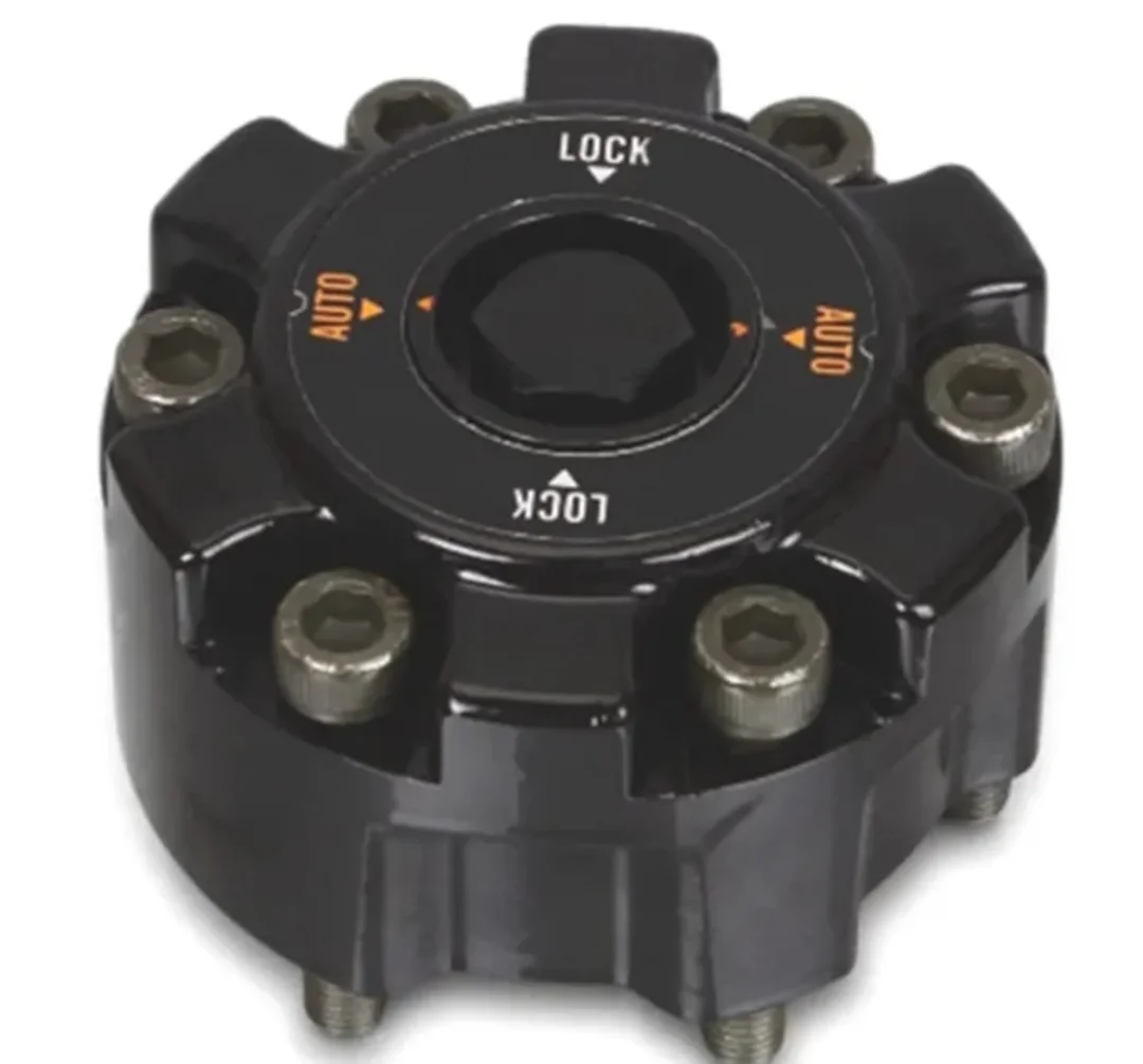

Hi guys,
Need a help. I need to upgrade my old hublock to new this typo hublock unit. Any advice.
I'm curious why you want that style hub rather than a manual hub? I have no experience with that kind of auto hub, is there something particularly desirable about it? I recently replaced my original electric hubs with manual Aisin hubs, the conversion was very straightforward with an older donor axle from a 1984-1985 Toyota Pickup. Just needed the hubs, spindles and locking hub assembly.

These hubs come with post 1999 trucks. They may not fit older models.
Manual locking hubs may be better for your application.
What is your truck's model year?

I'll add, they will NOT fit the earlier wheel hub, wrong pattern. The effort to modify them to fit the KZJ7x would be monumental compared to just running a quality AISIN hub. While the DMALH hubs are neat, I wouldn't spend much to run them :D
