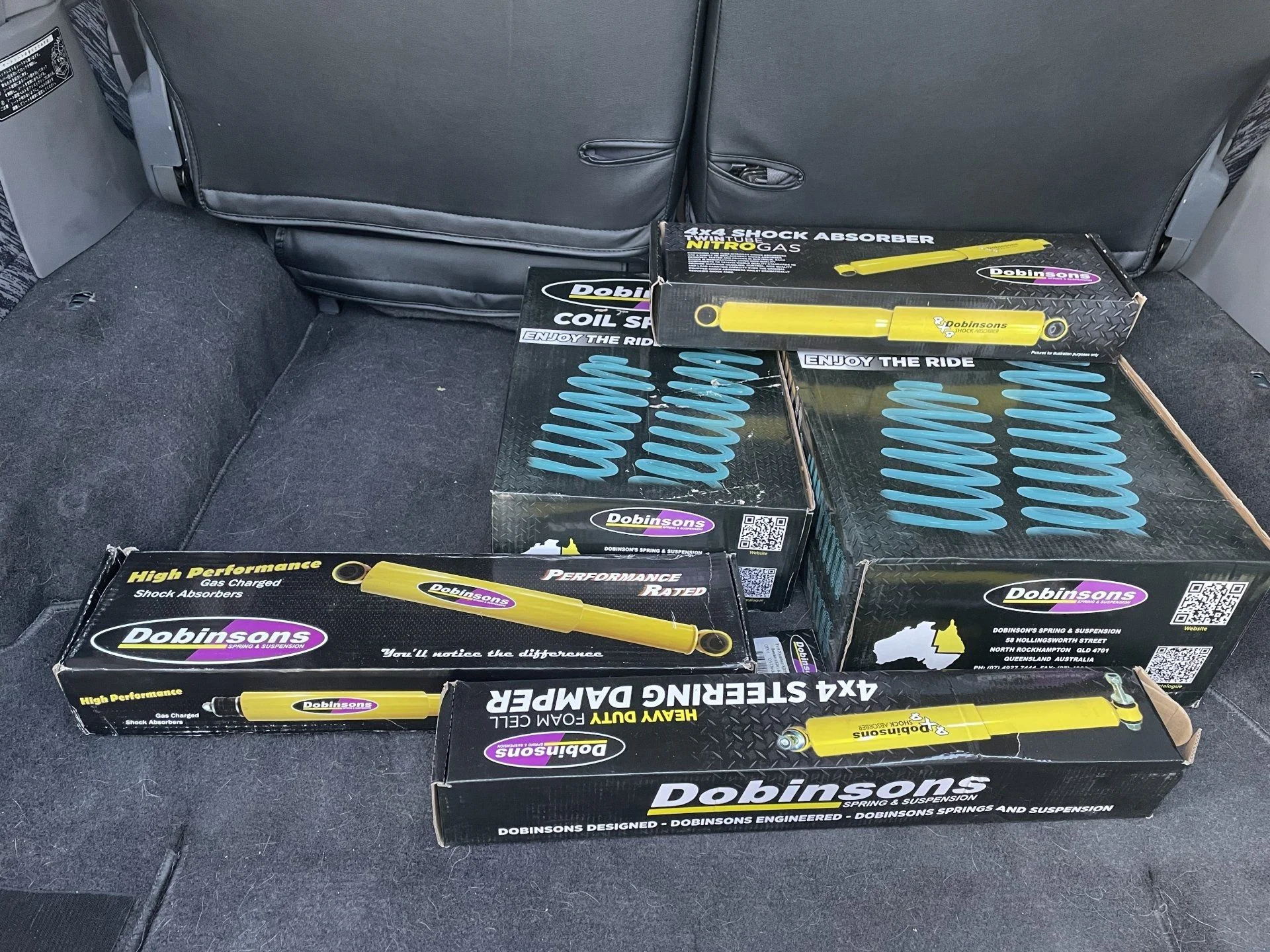

Hey guys! My KZJ78 is in need of a suspension upgrade since I still have the old shocks and springs from when I bought it in Japan. I ordered the 2” lift kit from Dobinsons and I have been going around to different shops in my area to see about getting the kit installed. The problem is that since it’s a Japanese import, all three shops are not willing to work on the vehicle. They claim that if they work on my truck and it needs replacement bolts, bushings, etc, they won’t be able to order it. Another shop said something similar to the first shop but they added that they don’t know the specs anything has to be set to since there’s nothing in their sources on how to work on my rig. The other shops don’t install equipment not bought from them or they say they are 3-4 weeks booked.
I think I have to do this myself. Is there a complete step-by-step on how to install the kit myself? Anything in particular I should watch out for if I want to tackle this myself?

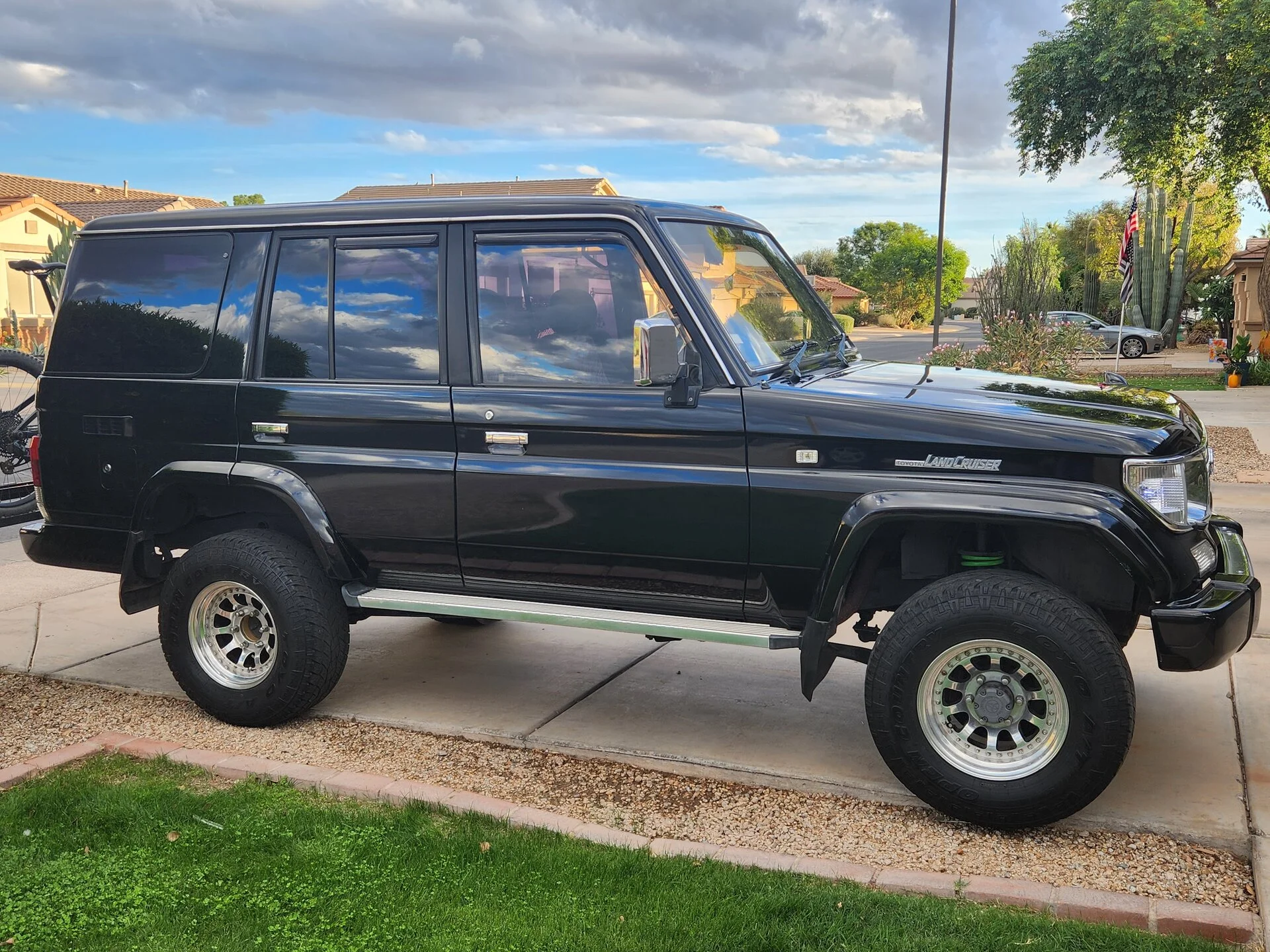

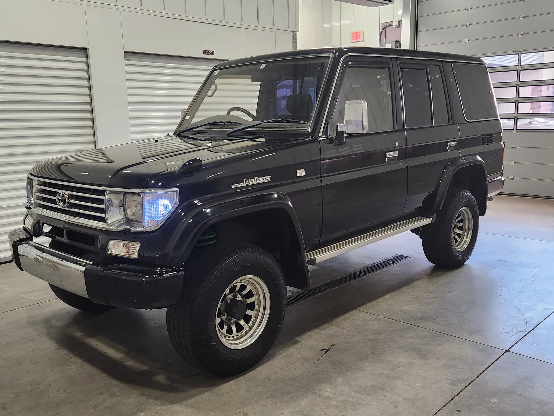

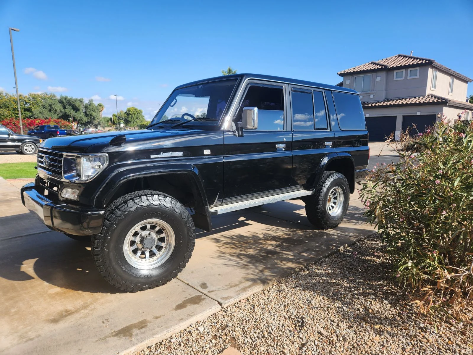

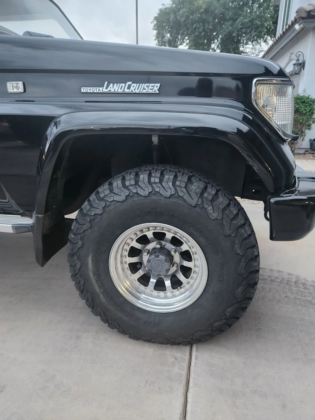

Here is a before and after picture of mine. This is my second KZJ78 and my first post here. IronMan4x4 2" kit, that I hand carried from Australia 2-weeks ago (visiting family) for $599 AUD ($394 US) for four spring, four gas shocks and one steering stabilizer. Installed the kit this morning, took 2hr.45. Rides fantastic. Measured height change after driving all day, 3" on both fronts and 3.5 on the rears, so there was an inch (plus) of sag over the 30 years. 1993.
Before 2" Lift (Stock)
After 2" Lift
