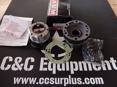

If your hub lock light flashes constantly now, then you may want to look into the AVM 463 hubs. These are a ''bolt on'' manual hub conversion for these trucks.
I bought these and did the ''resistor'' mod so now my hub lock dash light stays off, and only turns on when i press the hub lock button (which is useless now) some say the avm hubs arent as robust as a legit aisin hub conversion but I have found they work good for what i do.
LINK TO EBAY AVM HUBS
