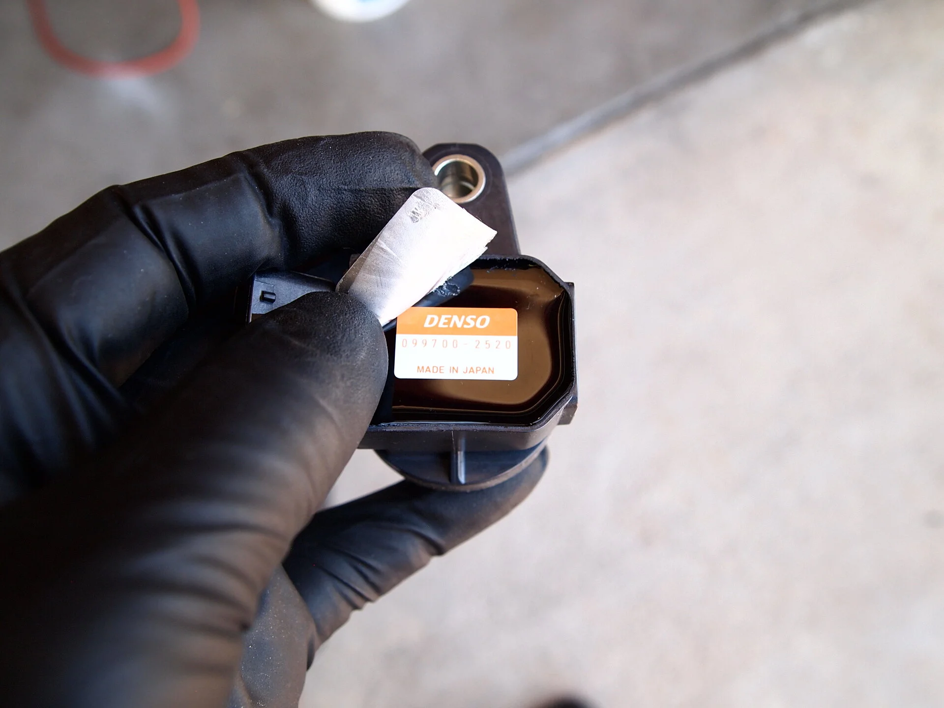

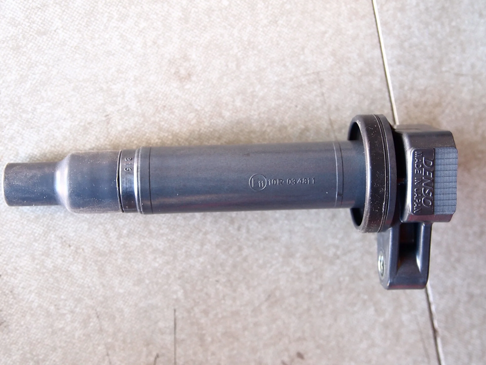

Real Denso
We don't know why the Denso (real deal) has a stick over stick, but they all do.

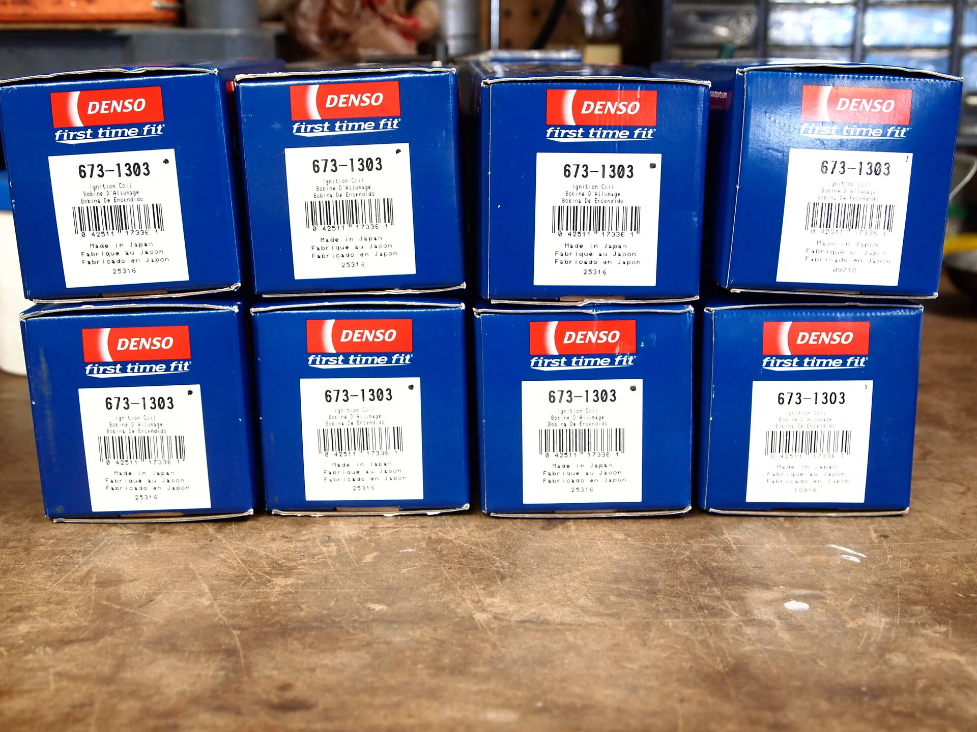

How much are you paying on average for the Denso coils? The cheapest I'm seeing them for through a Denso authorized seller is $58/ea.
I've not check or bough in 2023, but sound right. Plus shipping, tax and fee for Paypal.
