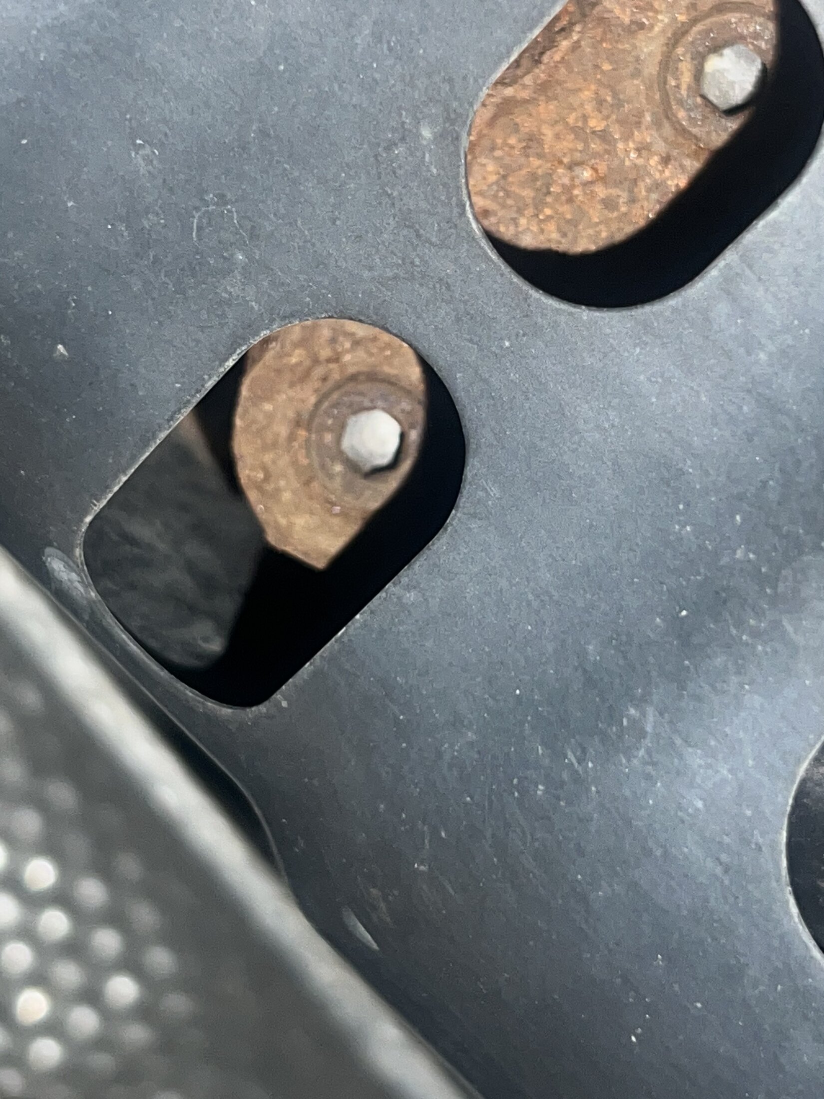

After installing my sliders I noticed mine were kinda crusty. I took the cover off (again) and gave them a squirt of penetrating oil. Fortunately, I was able to loosen both without much difficulty with an Allen wrench. After tightening them back down I slathered them with marine grease.
