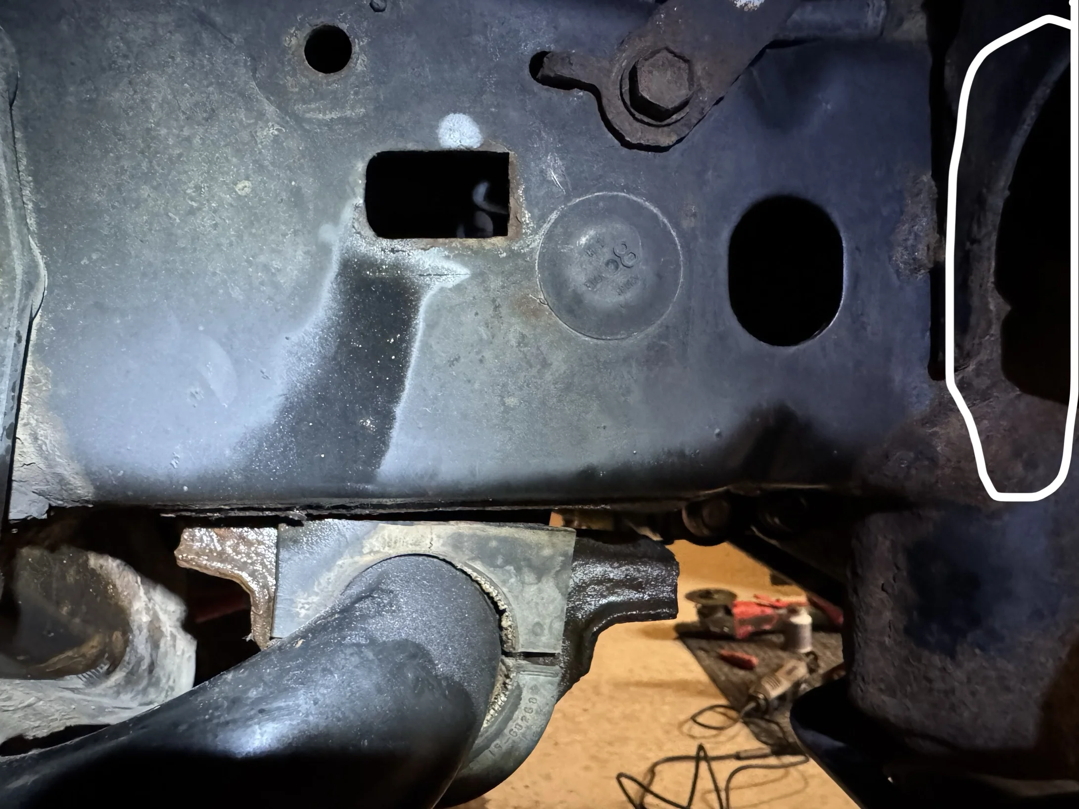

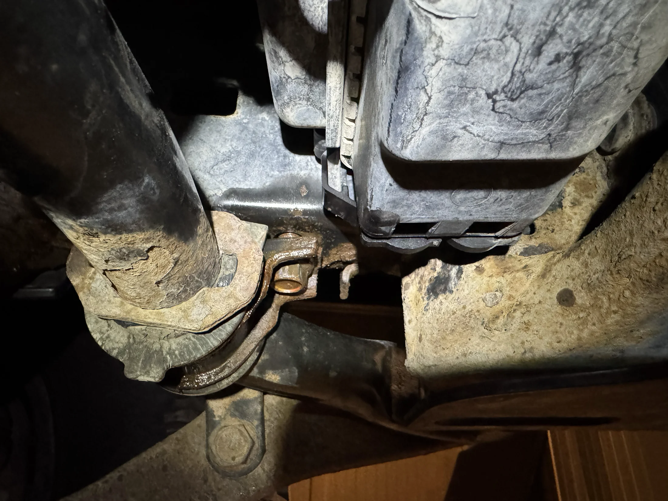

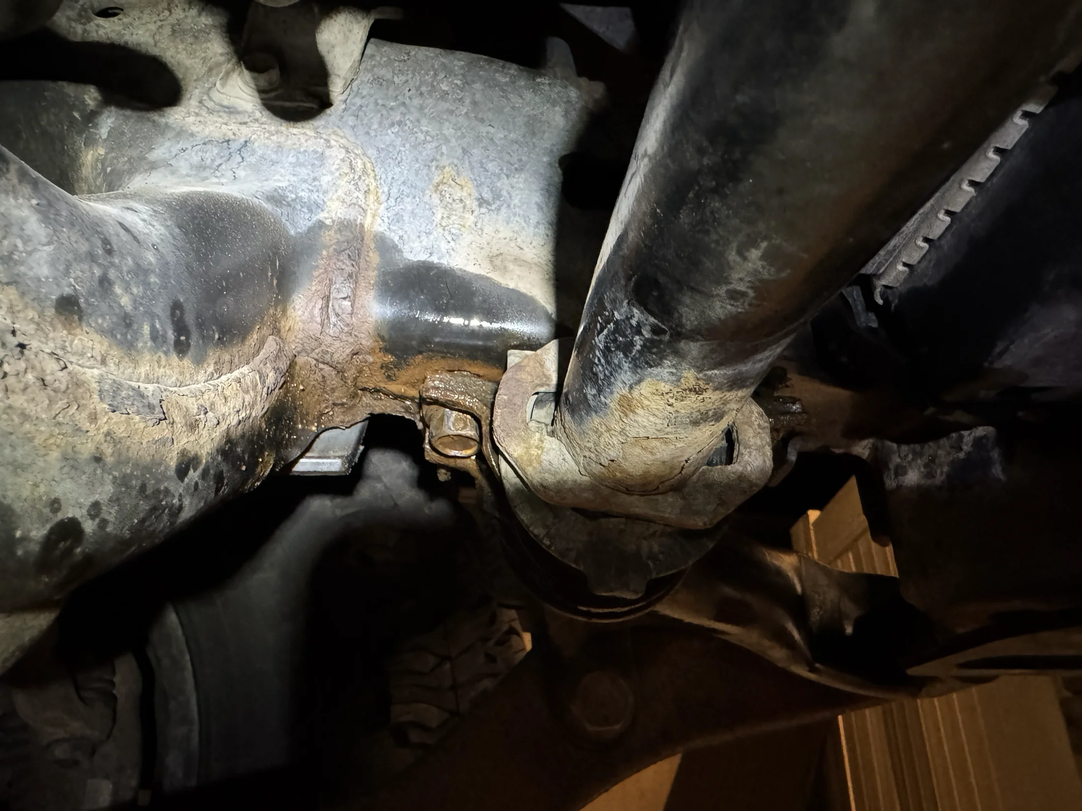

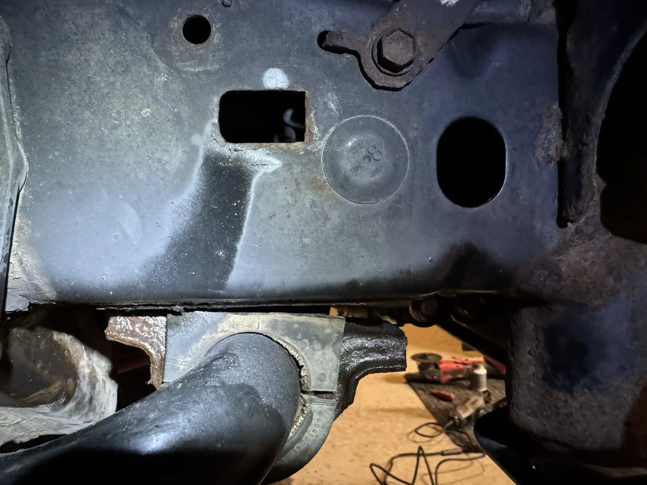

So I am ignoring the shutter valves, and just started tackling the Anderson Max KDSS Relocation Brackets which moves the sway bar forward 1.5" rather than the common 1". This of course also requires you to move the end links to the outside of the LCA. Well tonight 3 of my 4 saw bar bracket bolts decided to just spin. My new Milwaukee impact broke the welds free on the inside of the frame. So now the question is, do I cut 3 small rectangles in my frame in order to get a wrench on the nuts inside? Or do I use a sawsall and cut the bolts in half, and try rivnuts? (But then are those strong enough) Or is there a better option that can be accomplished on a Sunday so I can still drive to Cruisers on the Rockies Monday morning. I hope I am missing options...
Is there any combination of socket/flexjoint/extension/weird setup that would allow you to grab the nut through existing holes? But the nut may have enough weld material on it to keep a socket from grabbing it anyway. Do you have a borescope that would allow to see what’s in there?
Borescope is a great idea. Maybe I'll see if any of my buddies around have one. Looks like even at Harbor Freight they're $80+ and I've already spend hundreds on tools in the last week. I'll also check once more if there's any chance to get anything in there. I really don't think so, but now that I've gotten a few hours of sleep, things could change. :D:(
I guess I could also try tapping the frame.

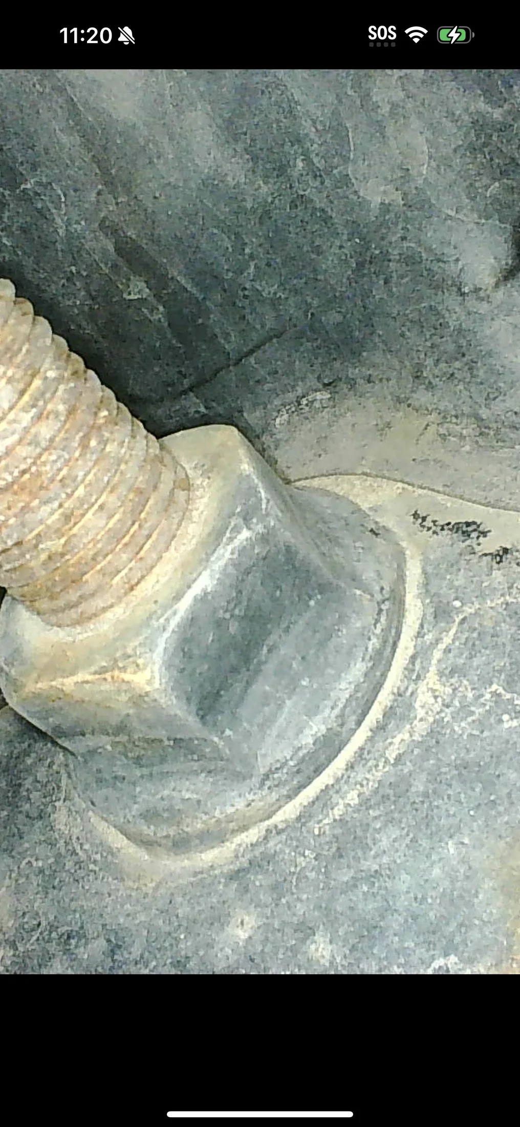

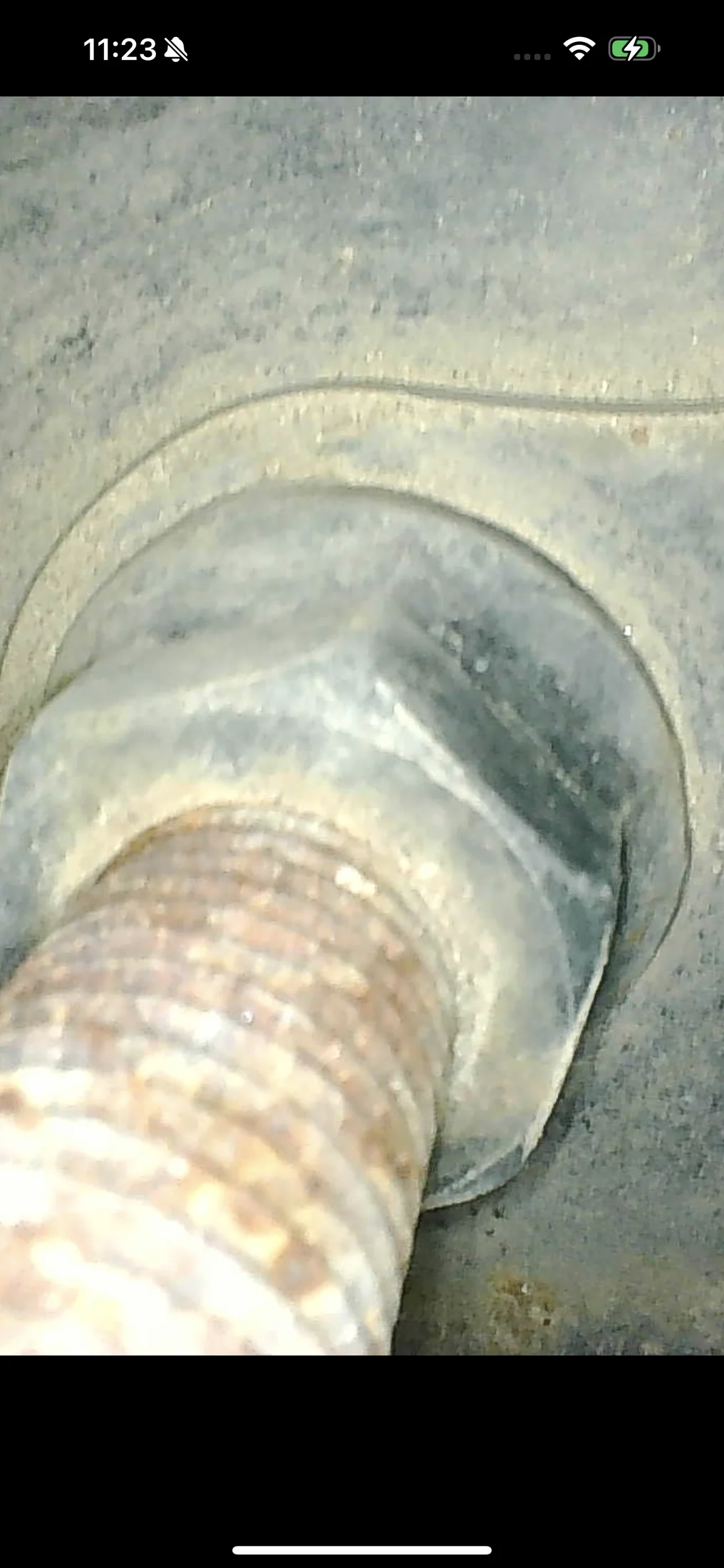

I'll get a borescope picture of the area in the next few hours.
I don’t see any welds, unlike when I got pics of the front recovery point nuts. The nuts seem to be bonded to a flat plate that is lying in there. Not sure how they are affixed.
I will say the bolt protrusion through the nut is significant. You’ll definitely need a deep socket. It does seem with the small rectangular access points some combination of tools could fit in there. I can say I wouldn’t want to have to do it more than once though.

@TXSunDevil just dropped his borescope off to me on his way to COTR. But now… wow. 🤔
Thanks for that @bloc.
I broke this bolt a long time ago and just cut a hole in, put a nut in place and drove it like that for a while. Eventually I took it to a fabricator and he plasma cut a bigger hole to fix it right and then welded a plate back over it.
