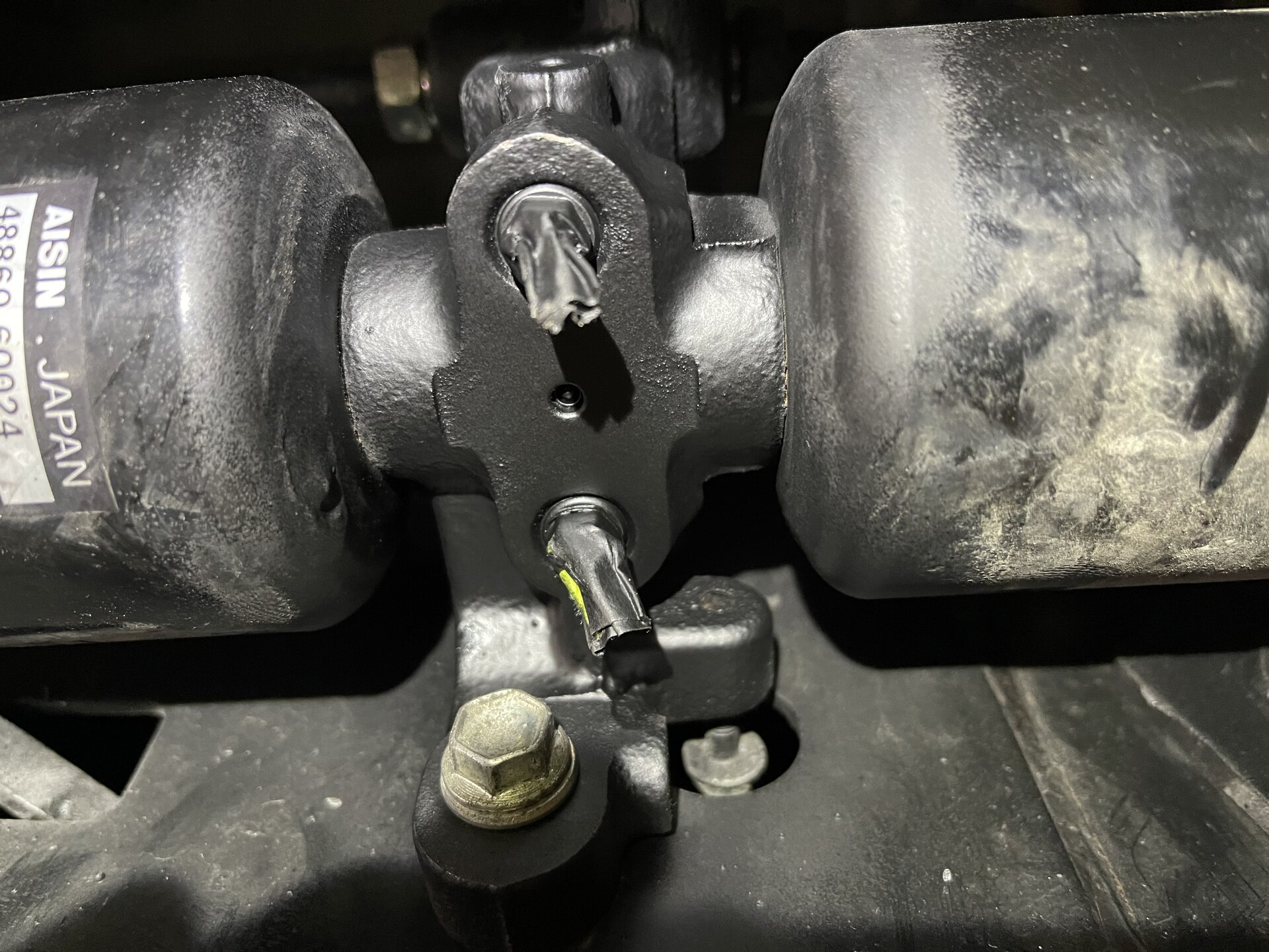

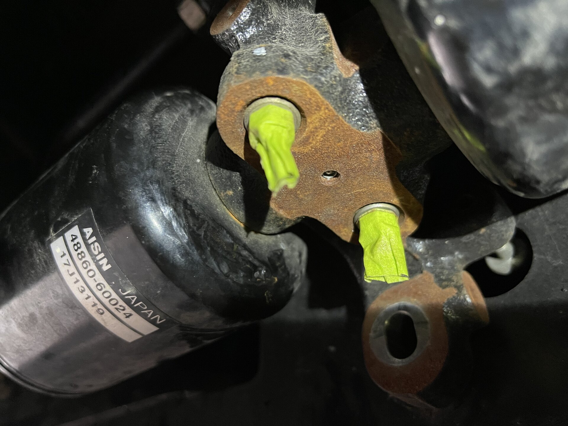

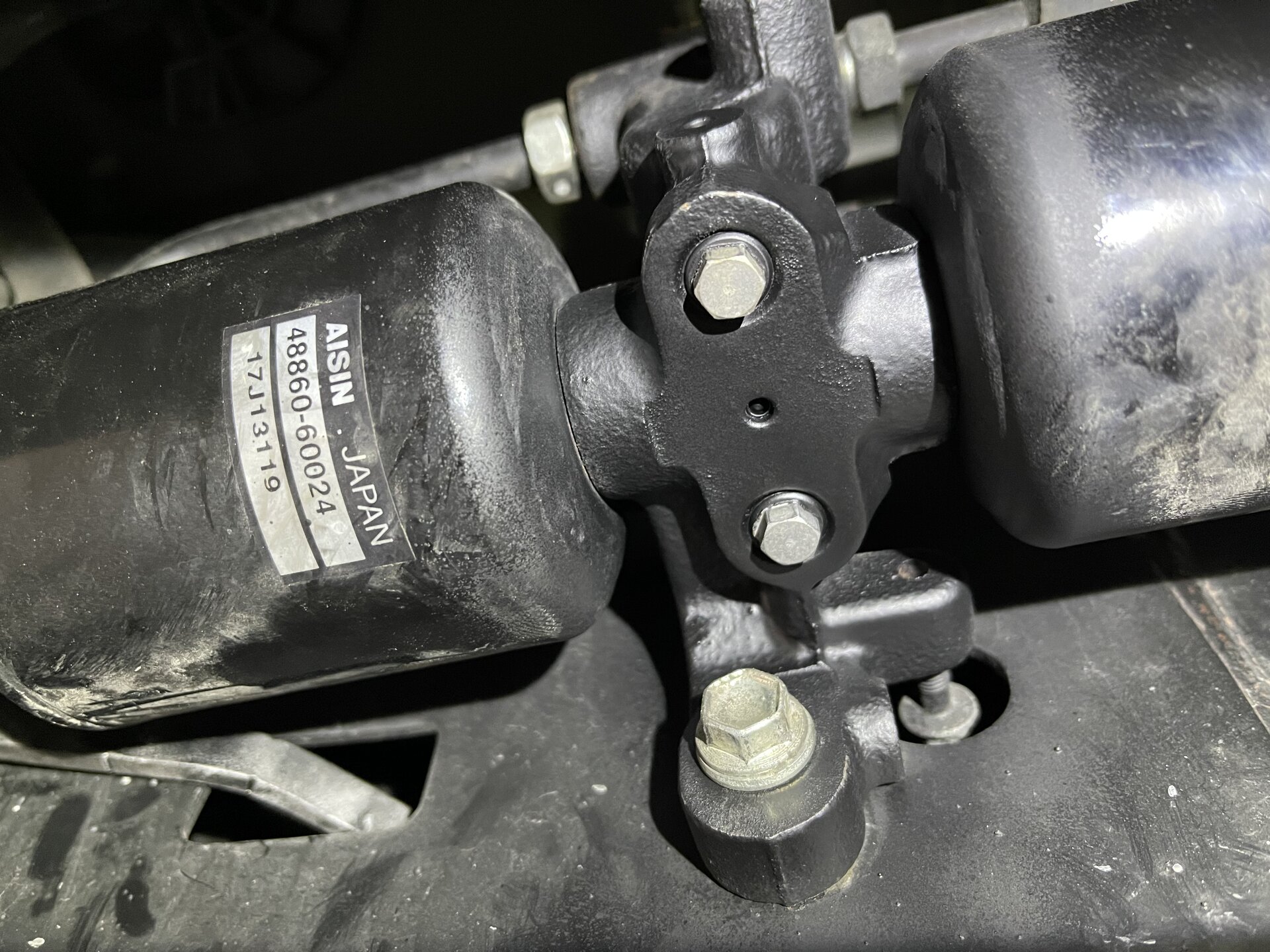

Every 200 I work on gets my little fix for it. I just can’t let a cruiser leave knowing that it will one day, mess with someone.
I tape off the set screws and enamel the housing. After that is dry, I open the screws the normal three revolutions, apply anti-seize to the exposed threads and screw them back in.
No yearly under coating, they simple stay movable for the long haul. Side note, really any on the stuff people spray under their truck for rust, just doesn’t work. There’s still rust, and now it’s so much harder to clean up the rust, and paint.
View attachment 3185446View attachment 3185447View attachment 3185448
