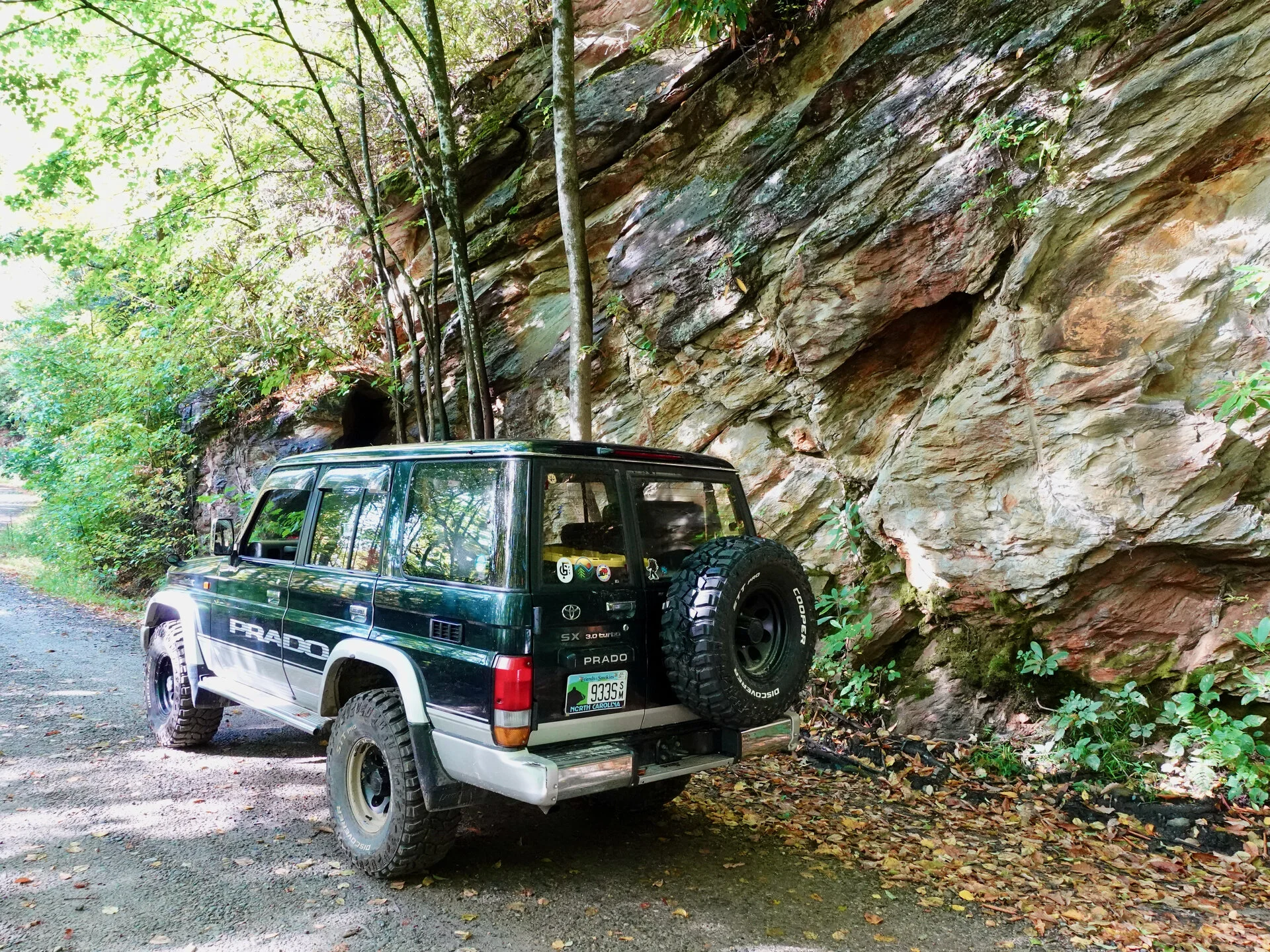

Current Picture
Here are some more pictures from Day 1 in Phoenix, I will be posting pictures here from my journey back to North Carolina as I go. I will be spending several days in Western Colorado as well.
I am not really a fan of WO lettering but it looks great on that KZJ78 with the wheels being black along with the "PRADO" side graphics.

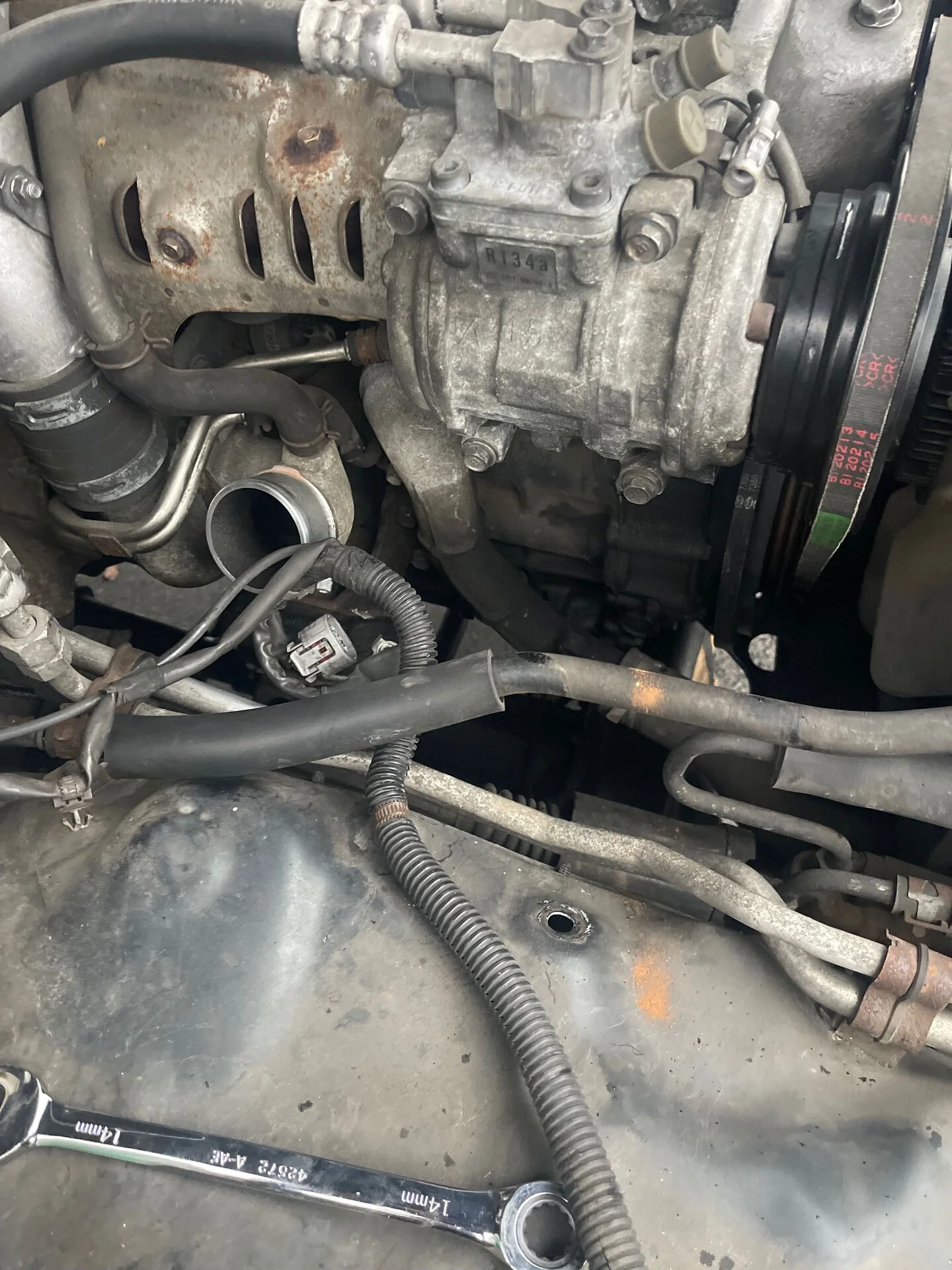

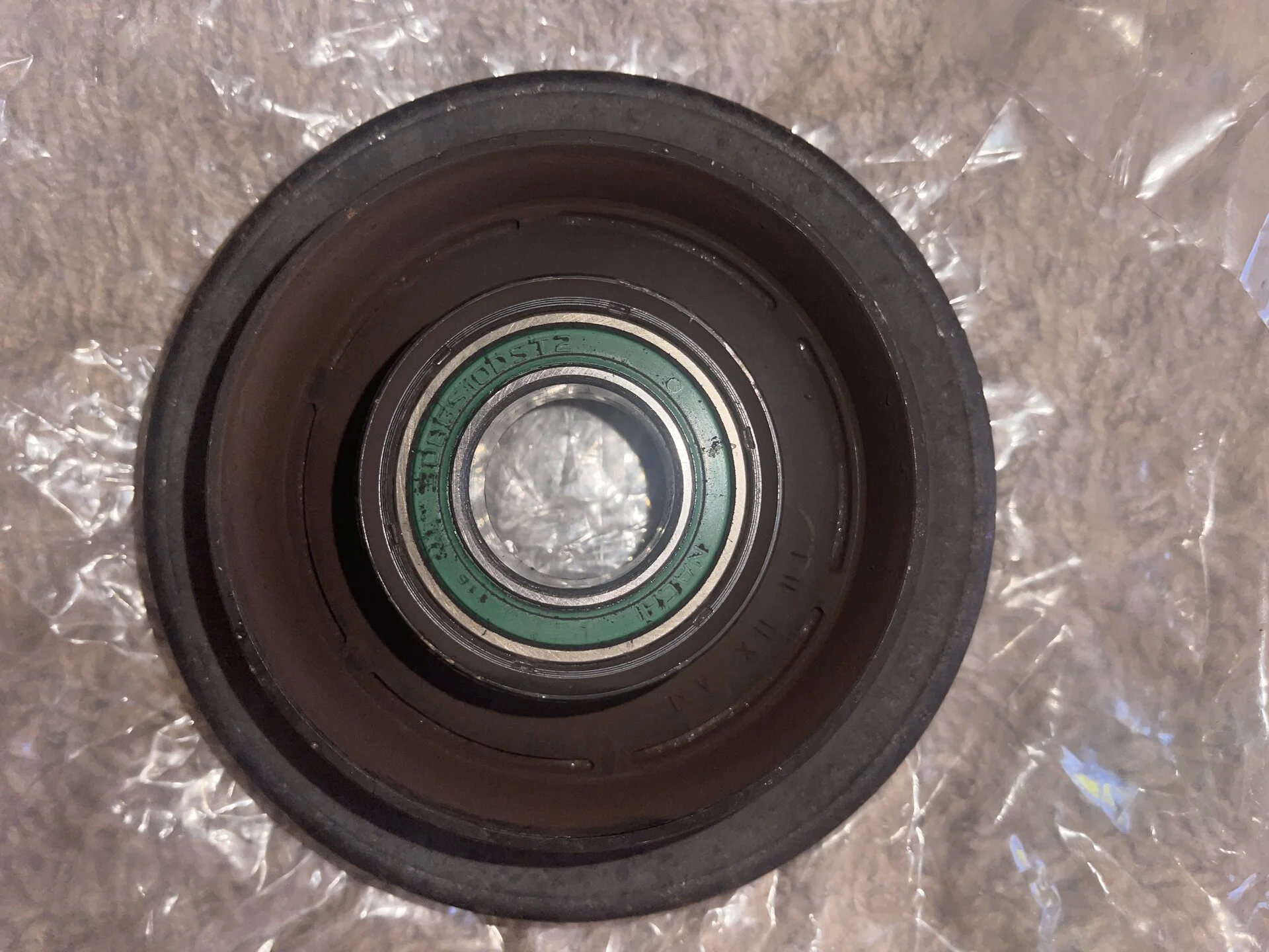

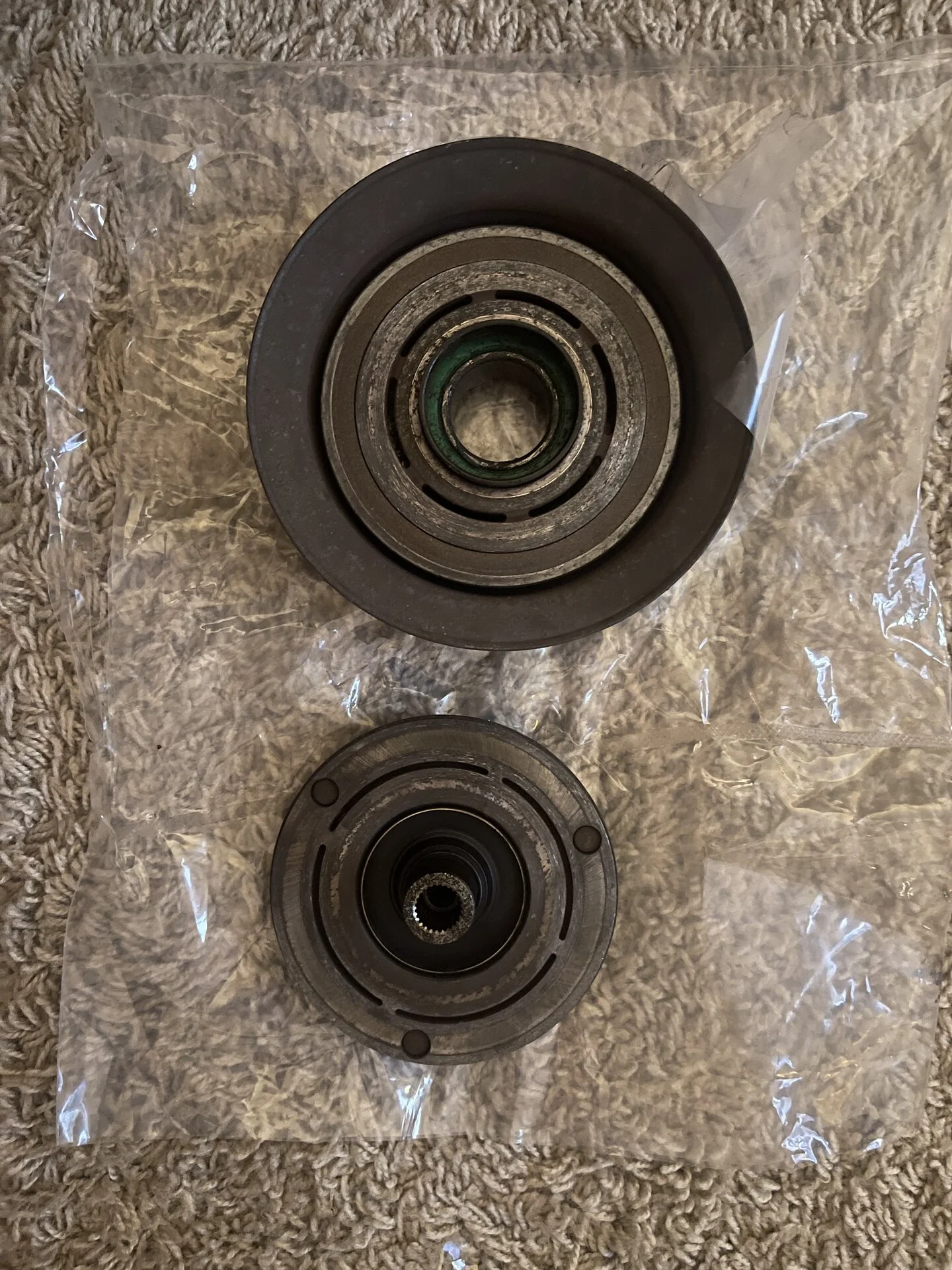

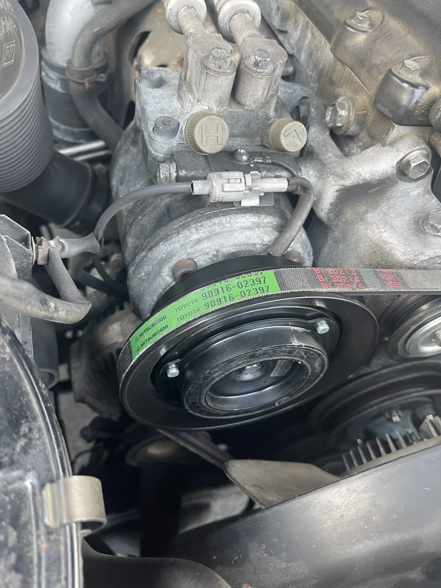

I’ll add more pics in the am but changed out the AC V Belt, the AC compressor magnet, and the rotor tonight. The stator still looked good and I have a new one if need be but I also was tired of snap rings when I got to it lol.
The old magnet and rotor looked meh and believe it was combination of the belt and those causing the squeal I would hear intermittently. The old belt was not a factory one but all the replacement parts including the belt were Toyota parts.
Here are some pictures of the old magnet and rotor.

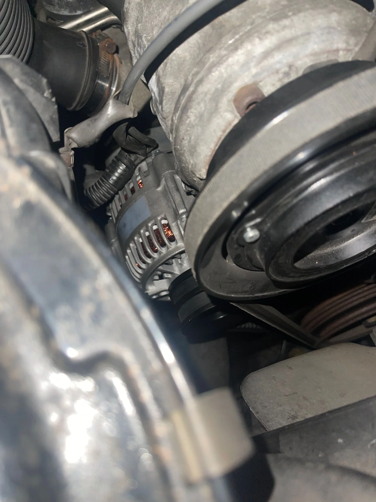

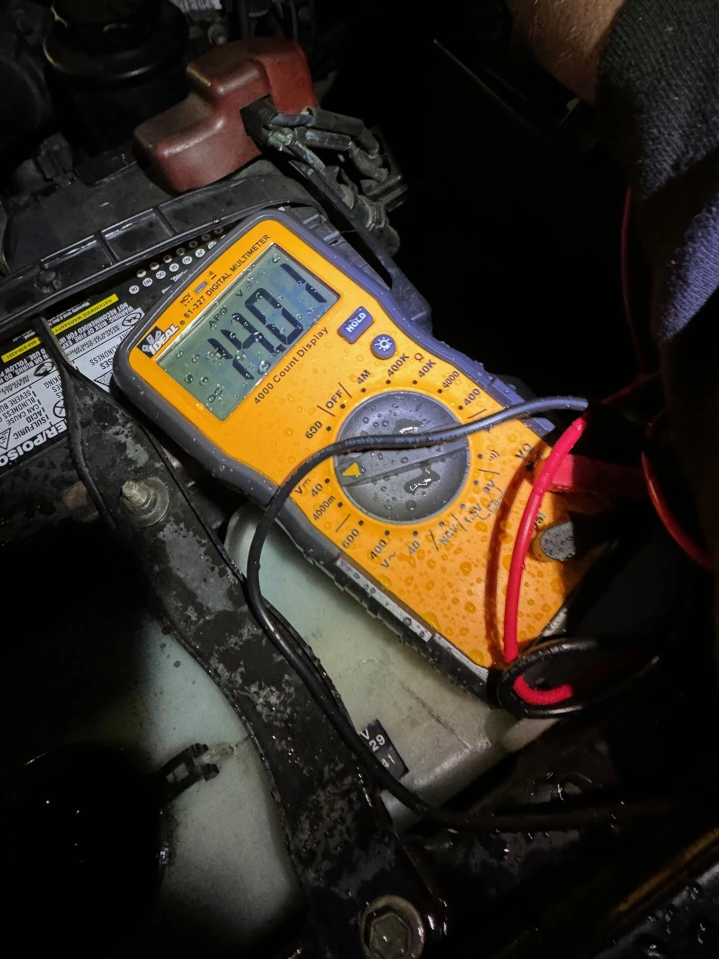

So I hadn't had any issues with the alternator after tightening the belts via the tension bar but when on a 4 hour trip on Saturday to look at car for my kid. In the afternoon on Sunday I was going to run some errands but before leaving did a quick inspection and saw the belts super loose and a broken bracket (FML).
Luckily I had already ordered a new alternator from Cruiser Parts and the bracket from Ebay, so then did an impromptu alternator install in the parking lot of my complex in the rain with some help from my wife who was a champ the whole time.

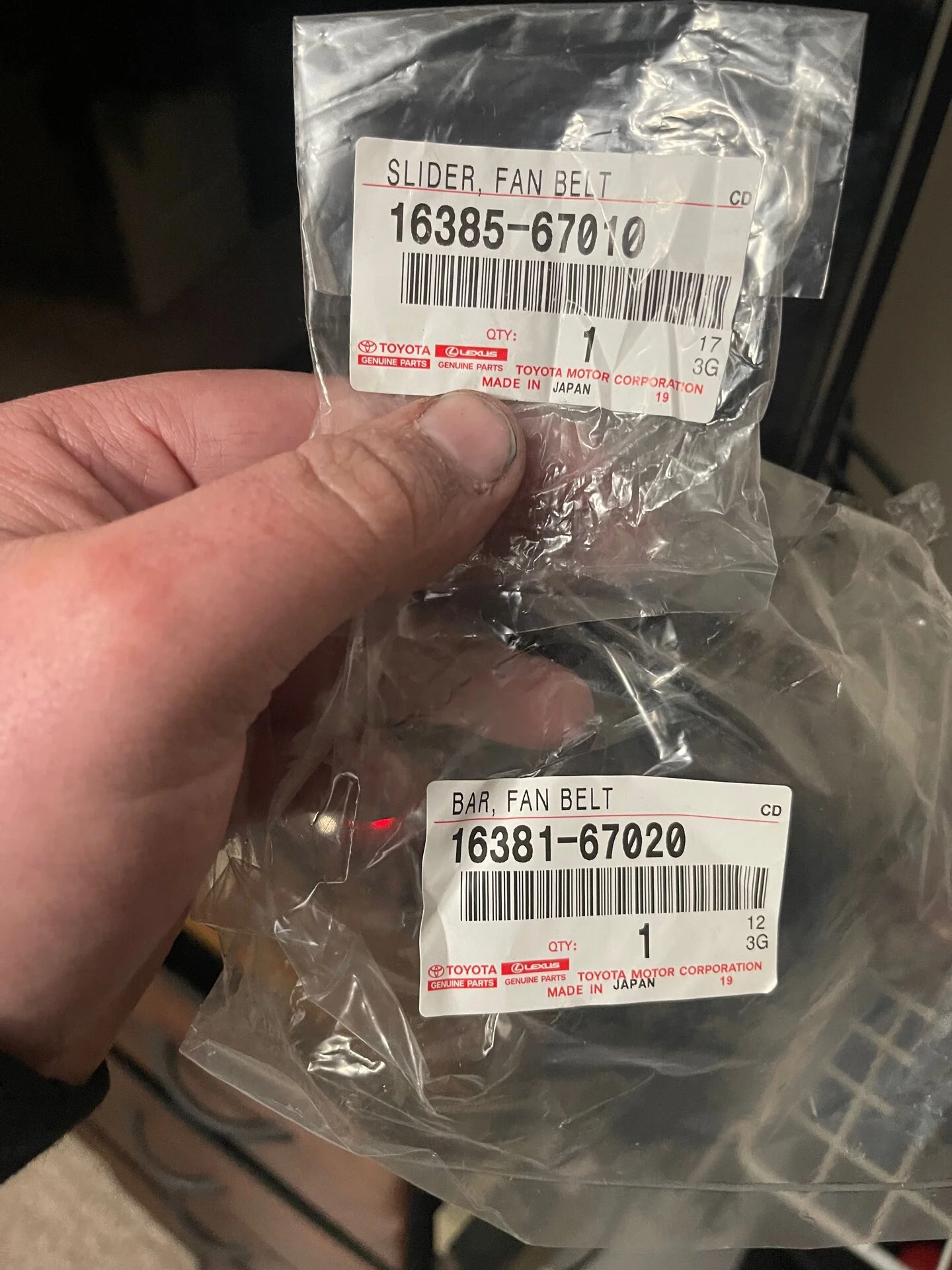

Everything is working as it should now and getting the proper high end of the voltage reading with the car running on the batteries. I added pictures of the bracket/tension bar part numbers.
