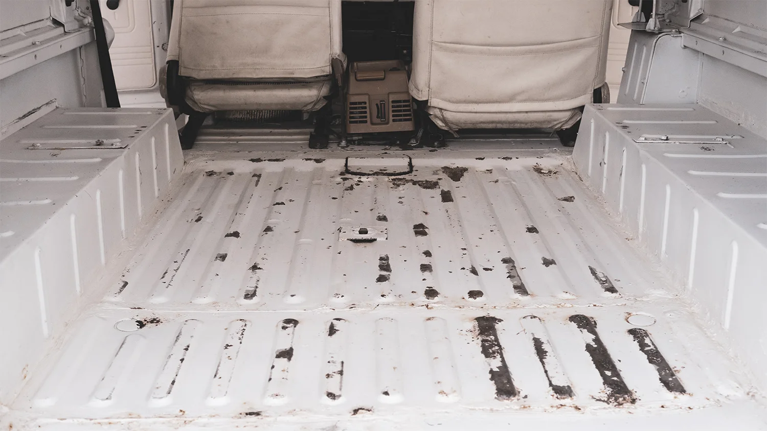

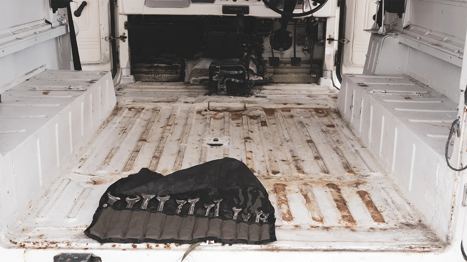

First order of business was getting the lay of the land. Had to find all of the rust and start to understand the things that didn't work. I removed all of the floor coverings and seats. Surprisingly most of the rust was surface rust minus a large hole under the driver side. I cleaned out a ton of fine black Japanese hair from the rear heater fan, and got it to work again. I then cleaned out the entire interior as well and found a few Japanese Yen as well, so that was cool.

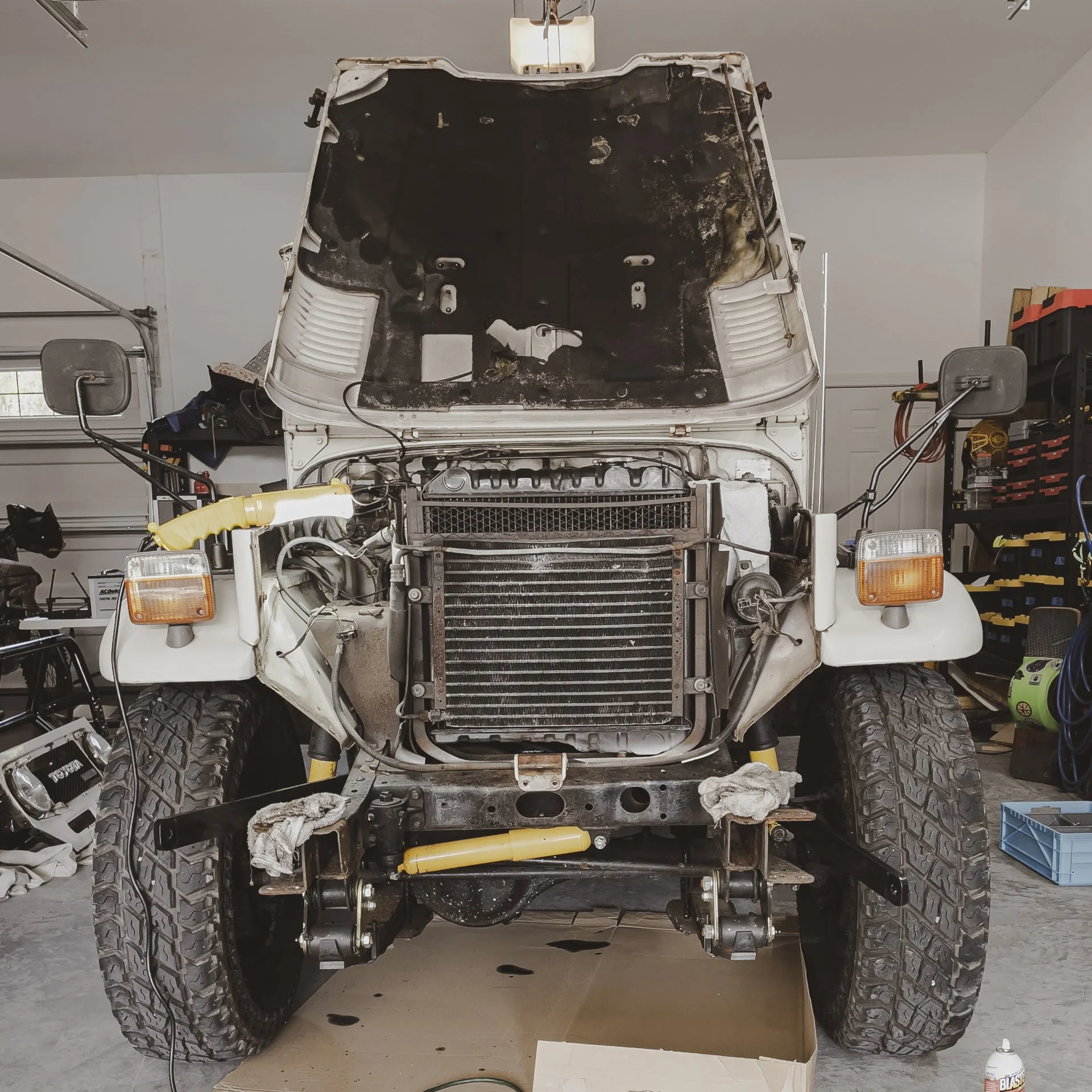

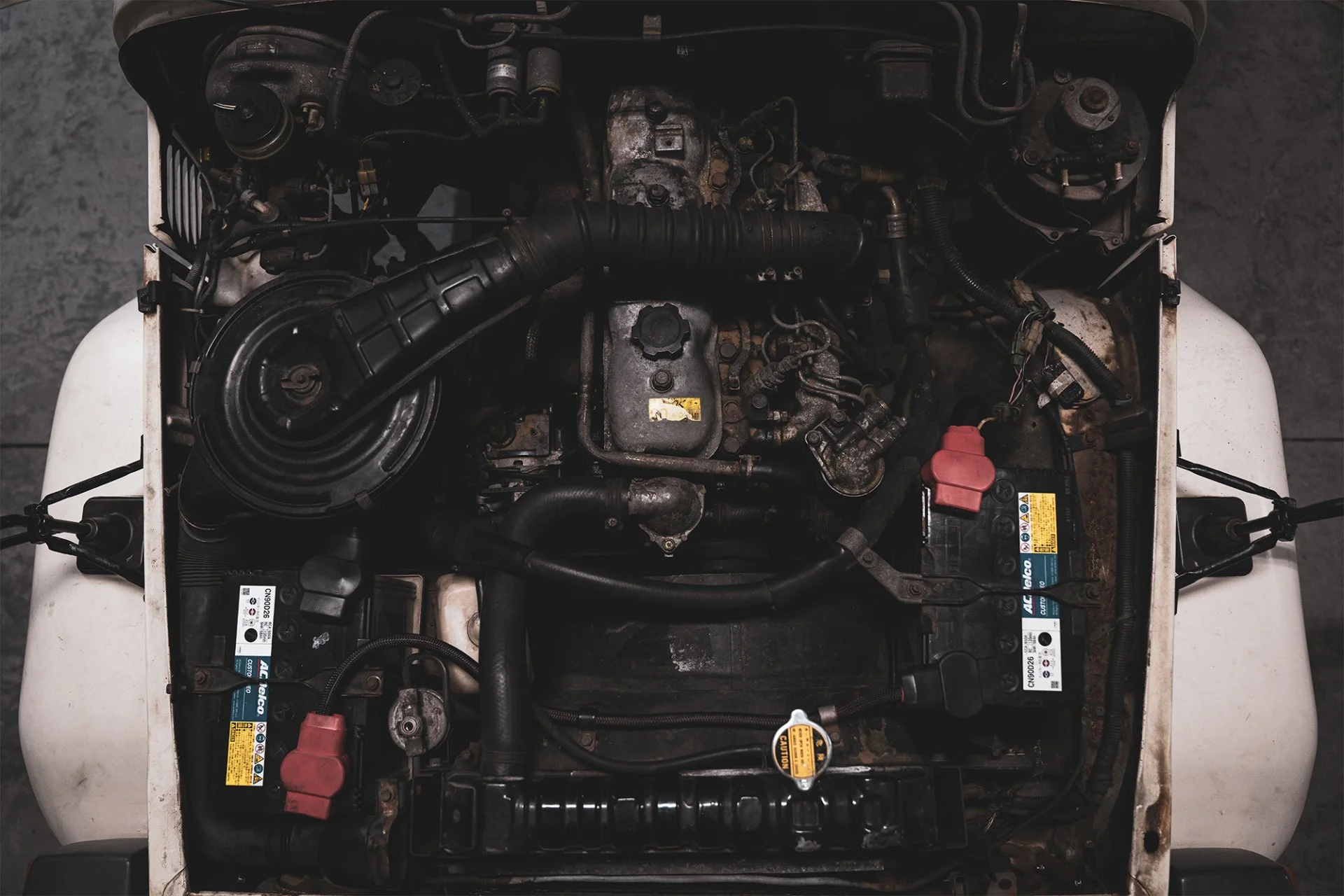

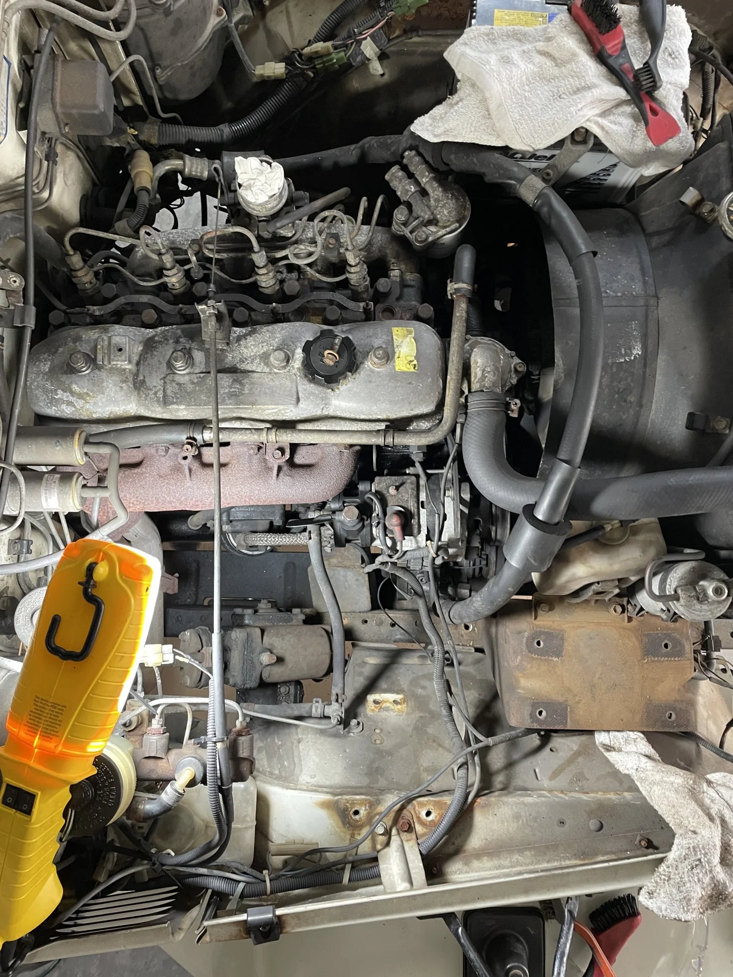

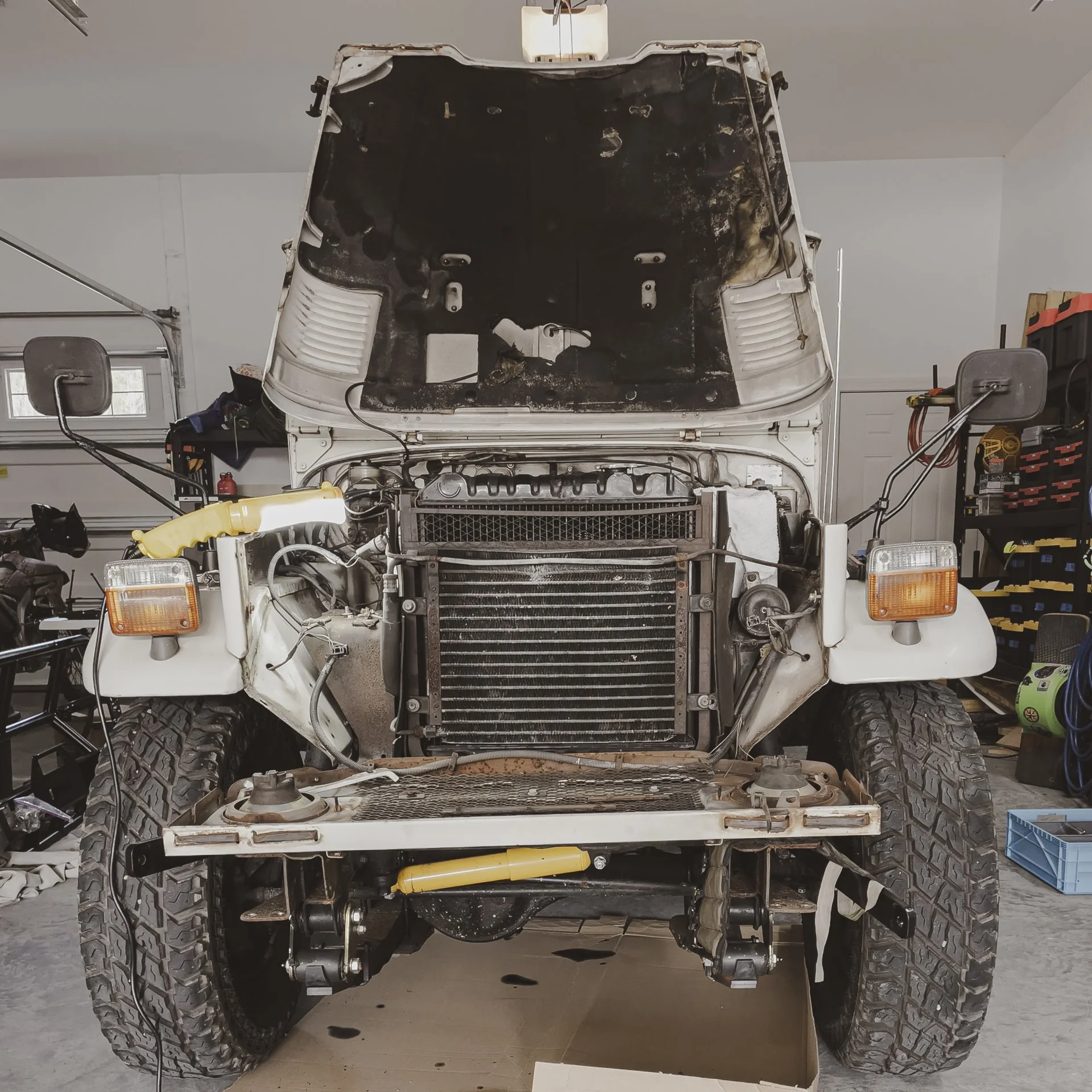

Digging into the front end.
Finding more and more rust as I go along.
The previous owner did me a solid with the suspension, but it is time to clean up some engine work.
Also trying to figure out the belts as it has AC but no power steering. If anyone has a lead on what the belts are, I would appreciate it.

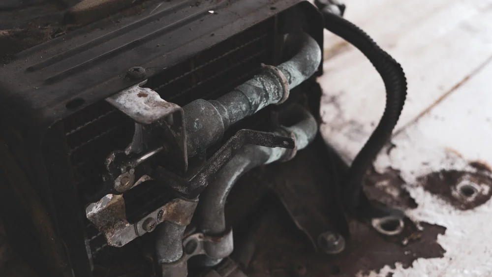

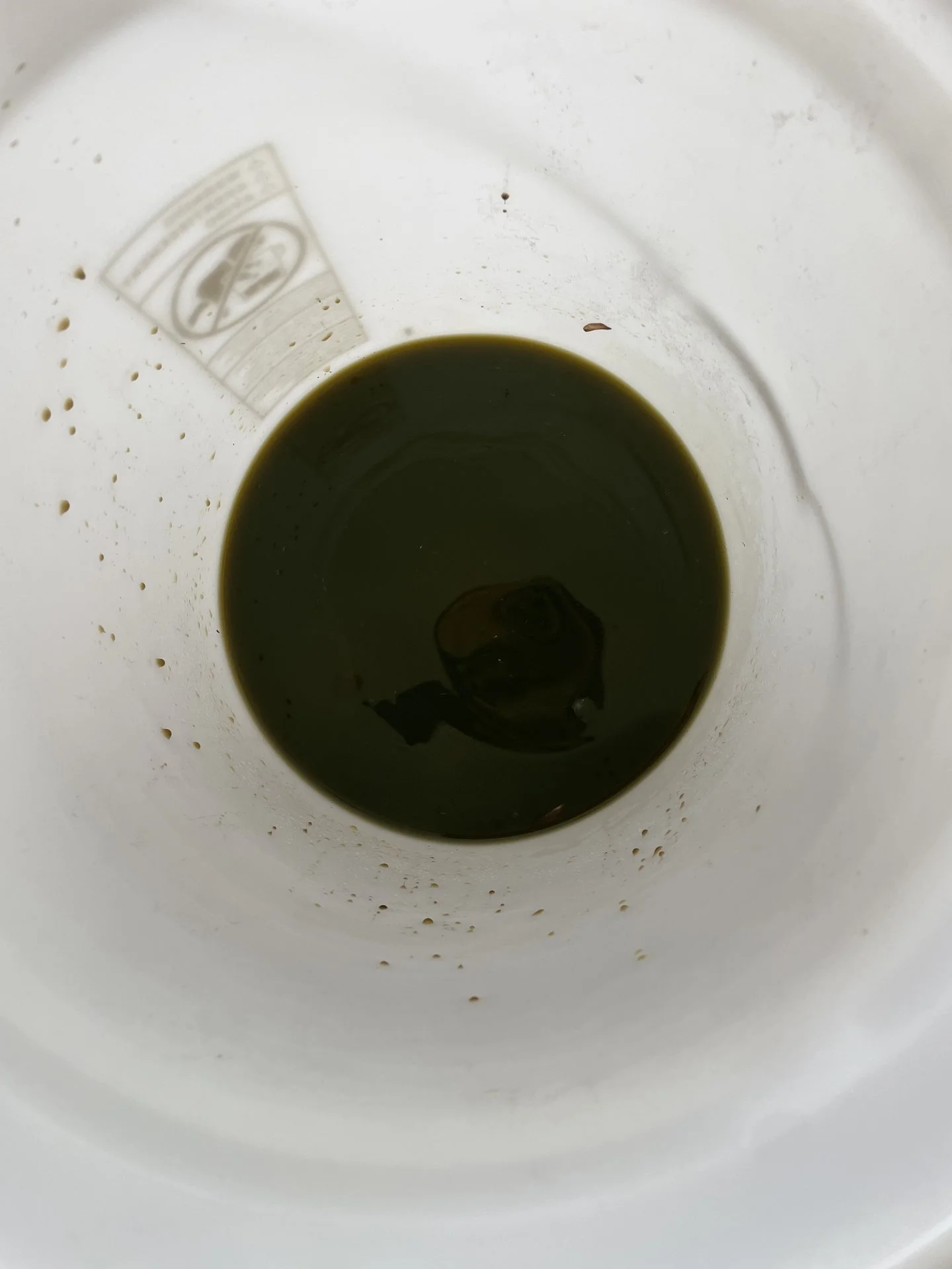

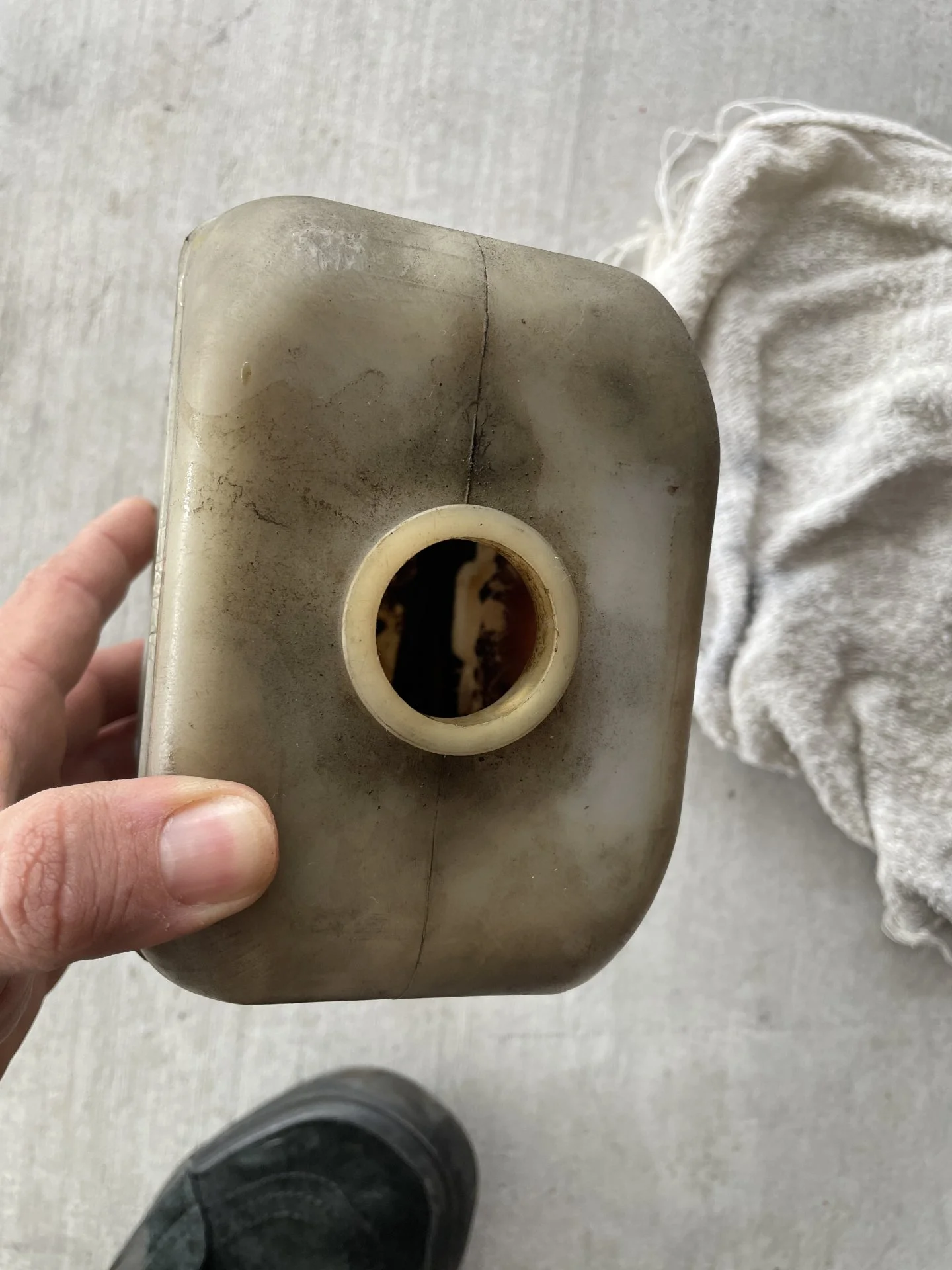

The radiator overflow looks like it has about 40 years of brown sludge in it. The fluid doesn't look terrible considering it has probably not been changed very often and I am certain the radiator is disgusting.
Part of this "tune up" is going to be flushing the cooling system.

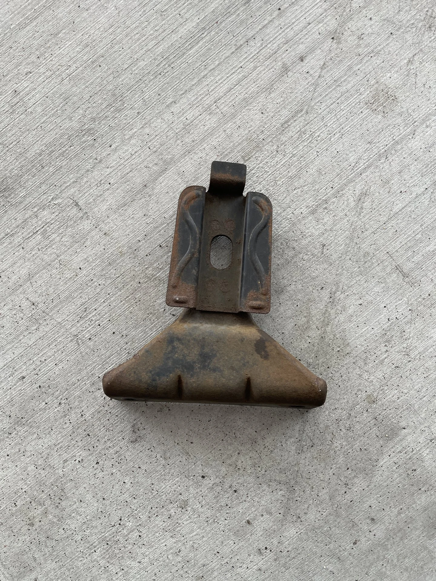

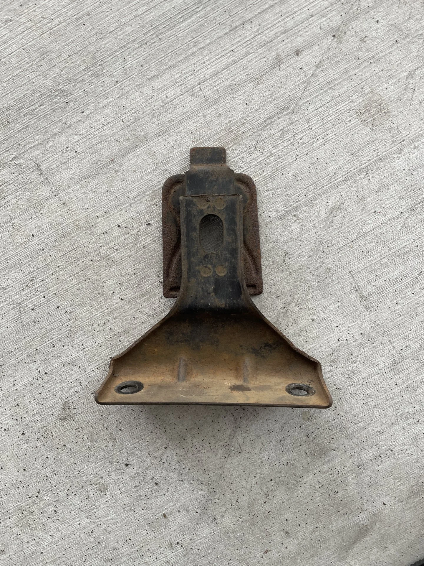

The bracket for the overflow tank.
I plan on stripping all of these parts off and getting them to a powder coater so they can be reclaimed and used.

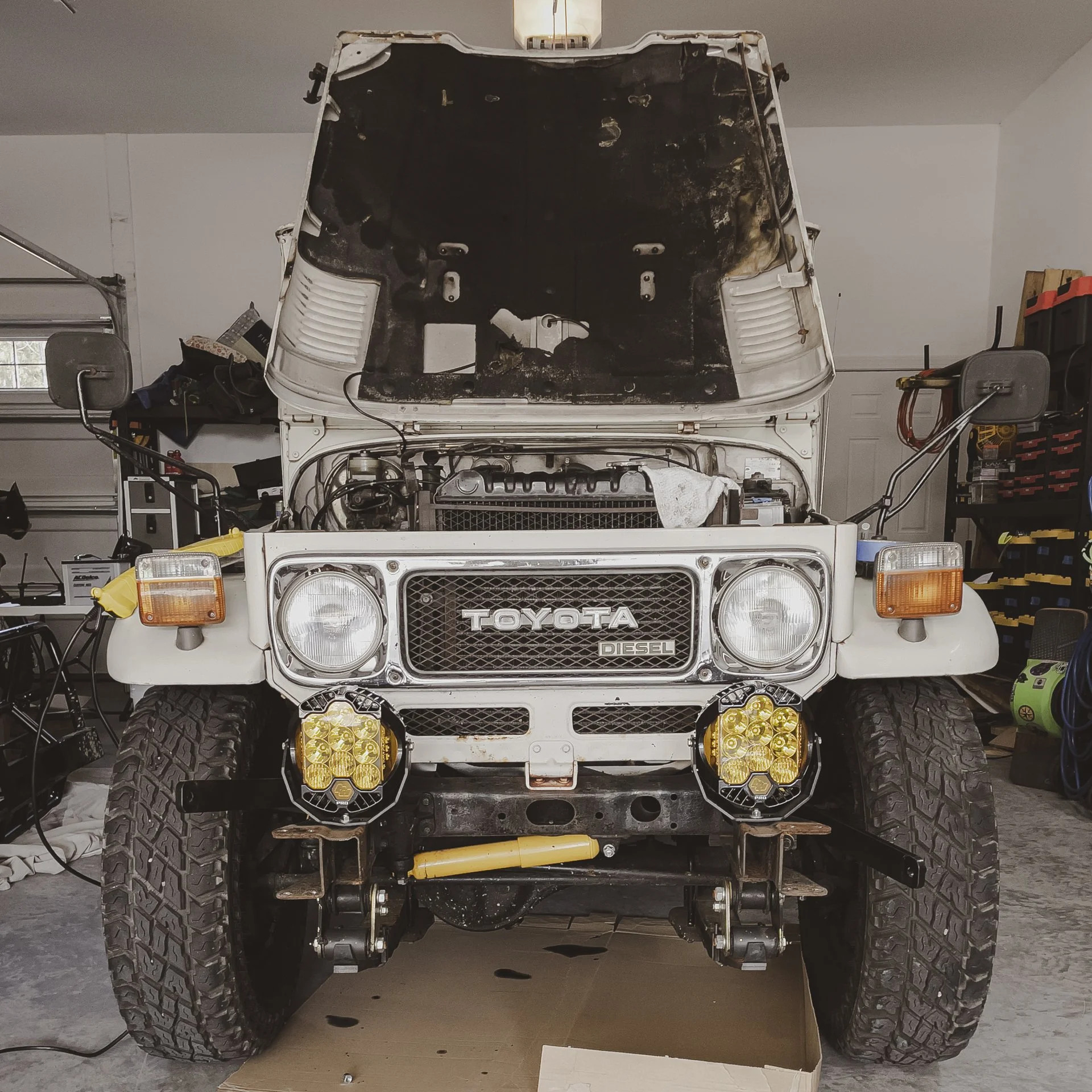

If anyone was wondering what the engine bay looks like....
Upcoming to do list.
-Flush cooling system.

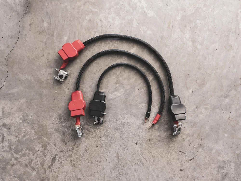

-Build Battery cables.
-Swap in new belts and thermostat.
-Check Charging System.
-Investigate AC.

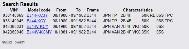

There isn't a lot of information out there about the BJ44V and it's 2B motor
Is it the original engine? I thought by 81 they were all 3B.
EDIT. But no, they kept using them till 82

Finally got a thermostat gasket in from a supplier which had been holding me up for a while. My local Toyota dealership is perhaps the worst dealer on the planet and is basically no help as well.
If you see the previous posts I had some issues to work through.

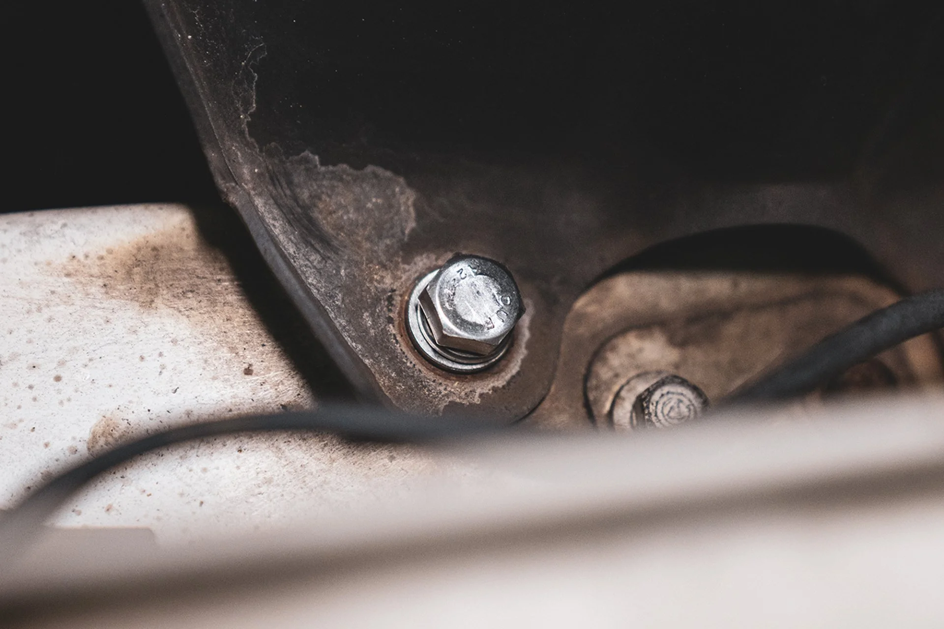

One of the biggest problems that I found was that the alternator bracket mounting bolt was missing, completely. That explains why my batteries have been charging intermittently.

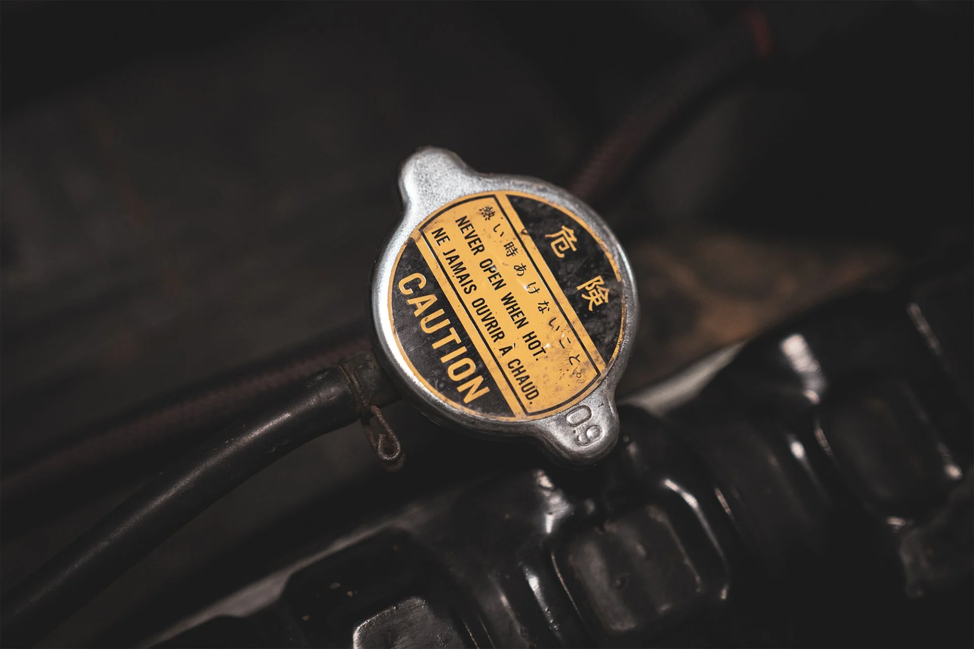

Couldn't find a new coolant reservoir, so I boiled the one that I have after letting some vinegar sit in there for a few hours. Actually turned out pretty good considering it had 40 years of sludge in there. Pretty certain I have a small amount of oil seeping into the cooling system at this point, but it is hard to tell if it is just 40 years of crud, or oil.
Hoses and belts were actually in pretty decent shape, so I held off on replacing those for a while. At least I have those spare parts on the shelf now.
Work completed.
- Complete radiator flush
- New thermostat and gasket
-New radiator fill cap
- Replaced alternator bracket mounting bolt
- Checked tension on belts and adjusted accordingly

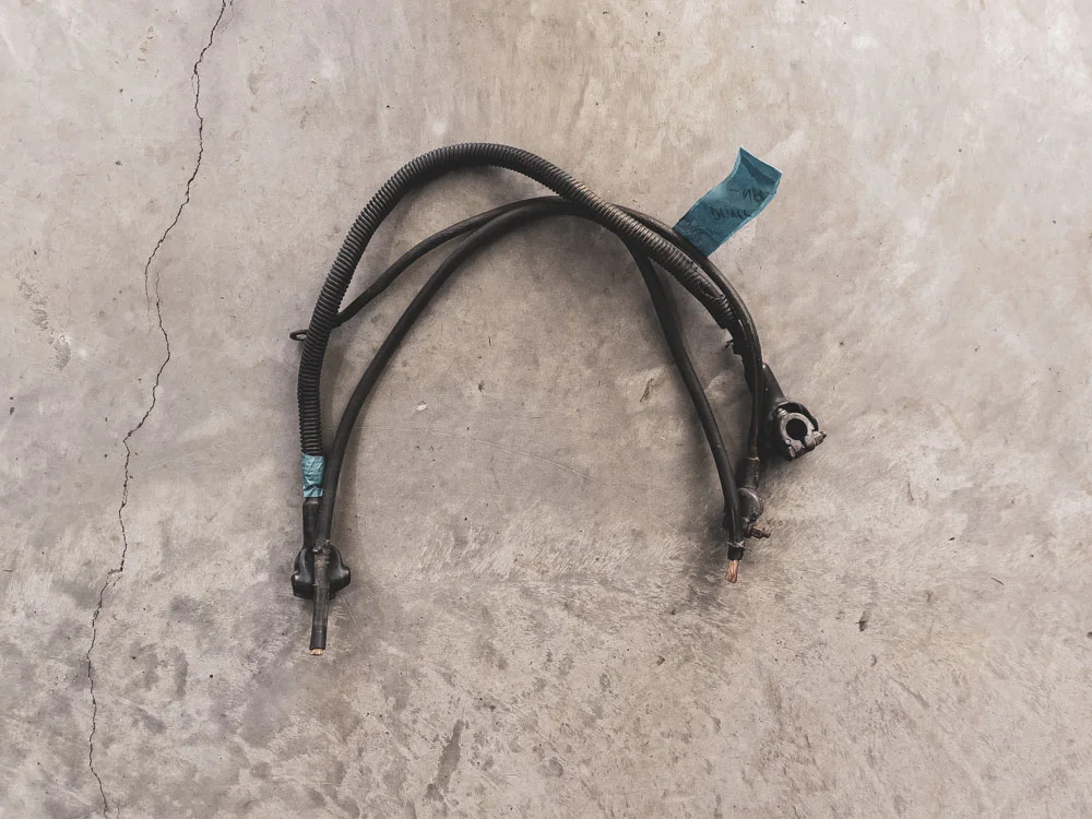

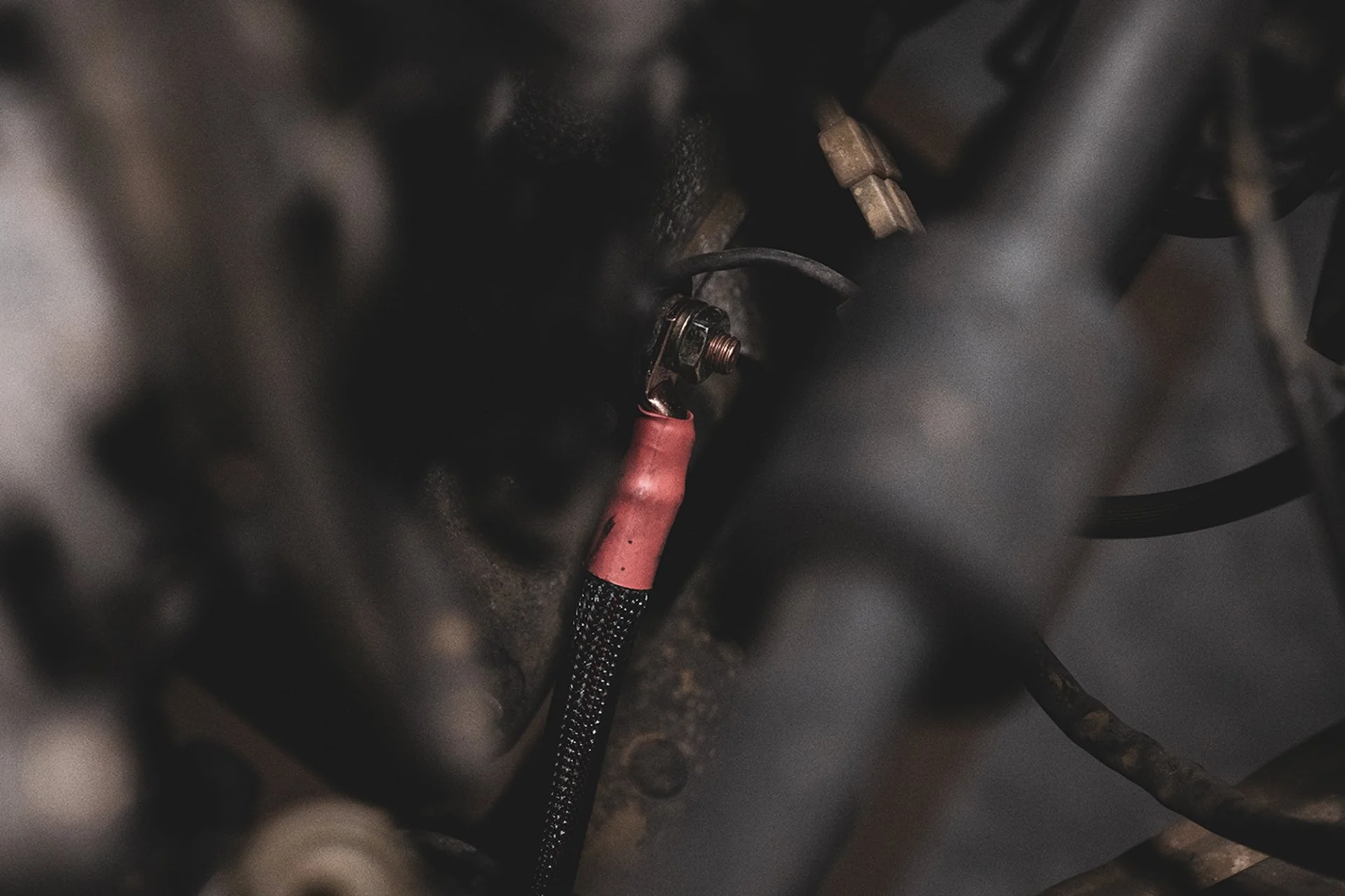

- Replaced all battery cables
- Replaced all hardware as I went
- New Air filter

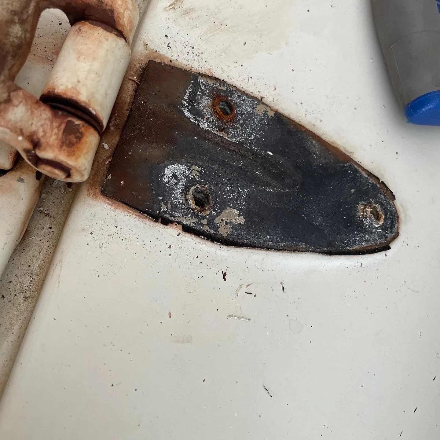

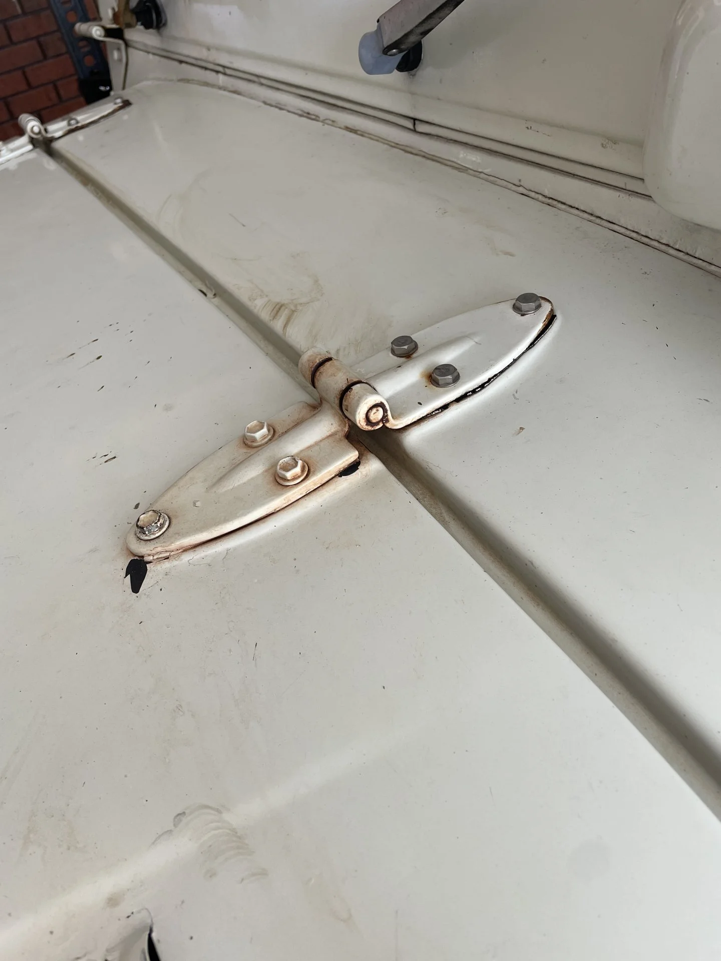

My door seals were garbage.
Taking them off revealed how badly the doors are rusted, and how badly they have been worked on before.
Got them cleaned up enough to be decent, but they are 100% not perfect. Just trying to keep her on the road.
Couple of days without the doors while the glue sets wont kill me.

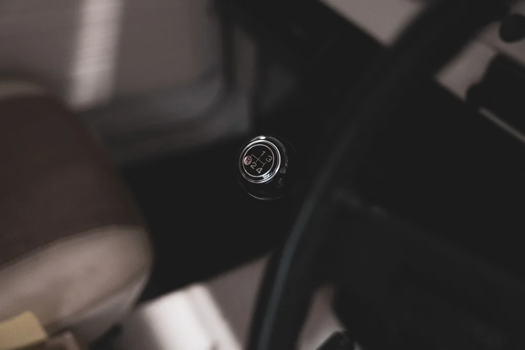

Also replaced the shift knob with a new OEM. + 10 perception...

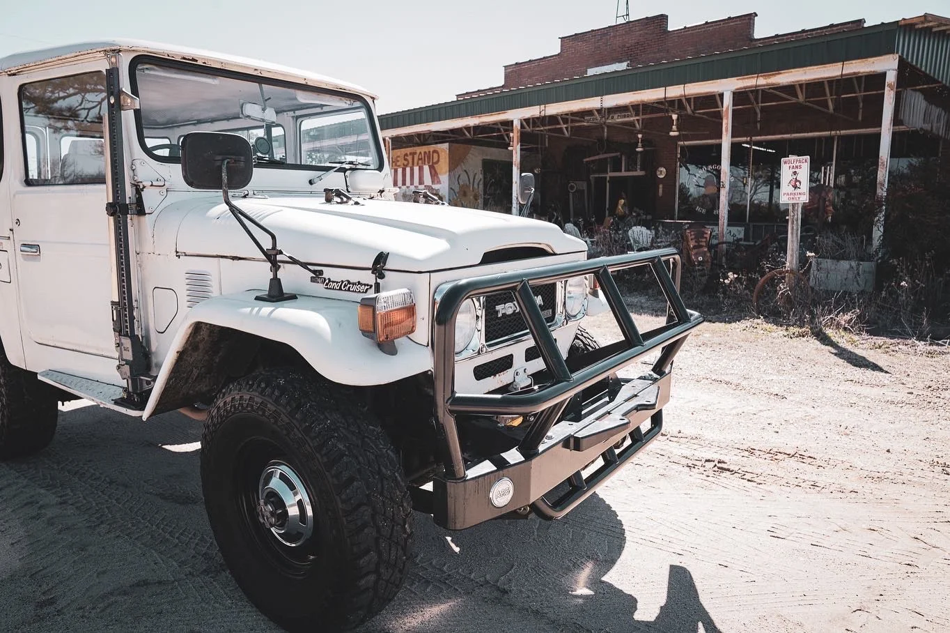

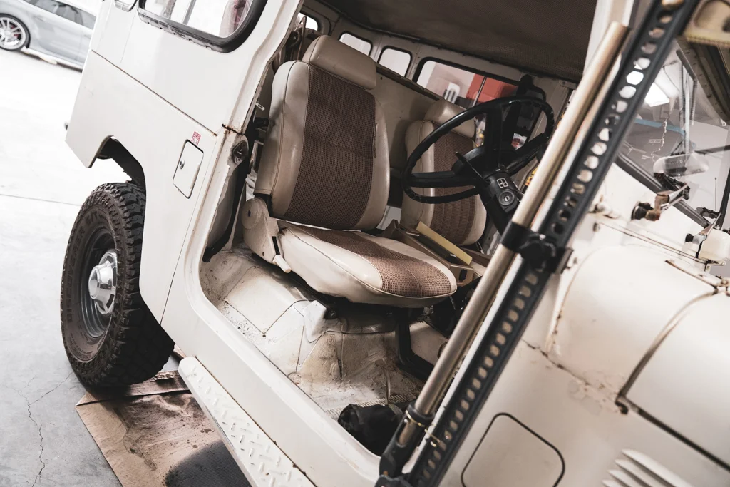

Also added this jack mount. Am I overlanding?
Interesting idea for the hi-lift. I've been trying to figure where to put it. Hate the front bumper and don't like the extra weight on the rear door. I just replaced the seals on mine last week and it made a huge difference on the sound of the coffee can full of nuts and bolts that are continuously present while driving.
Thanks! Mounting the jack to the front bumper is super dangerous. I don't want to eat that in a collision.

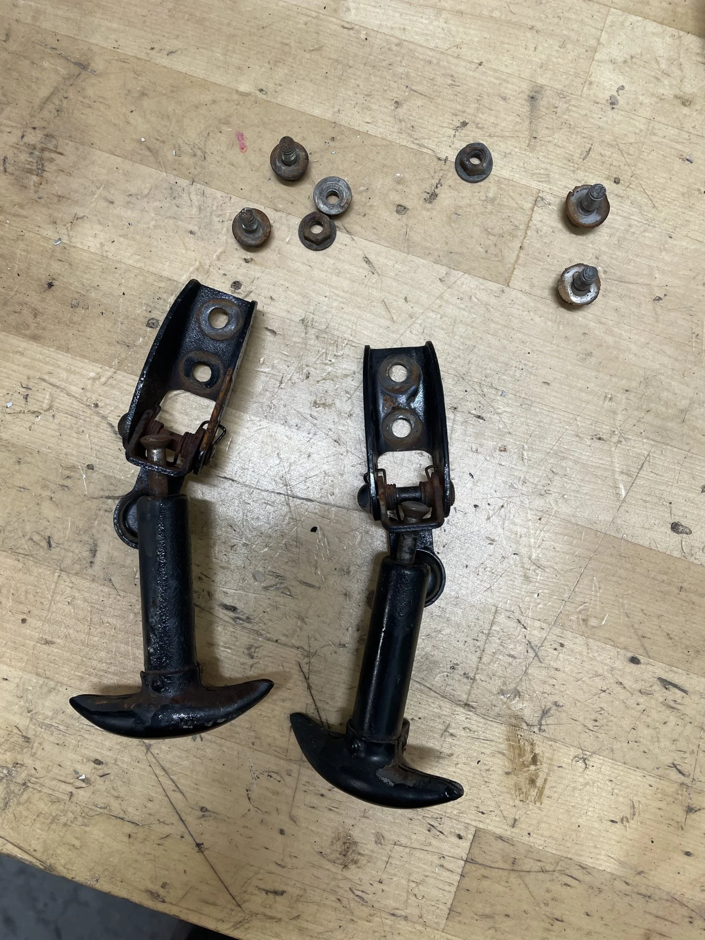

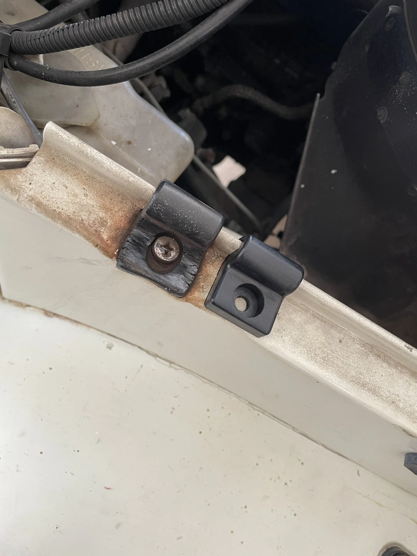

Door seals were such a pain, but man were they worth it. So much quieter. I also replaced the hood pads and hood latches, all well worth it.

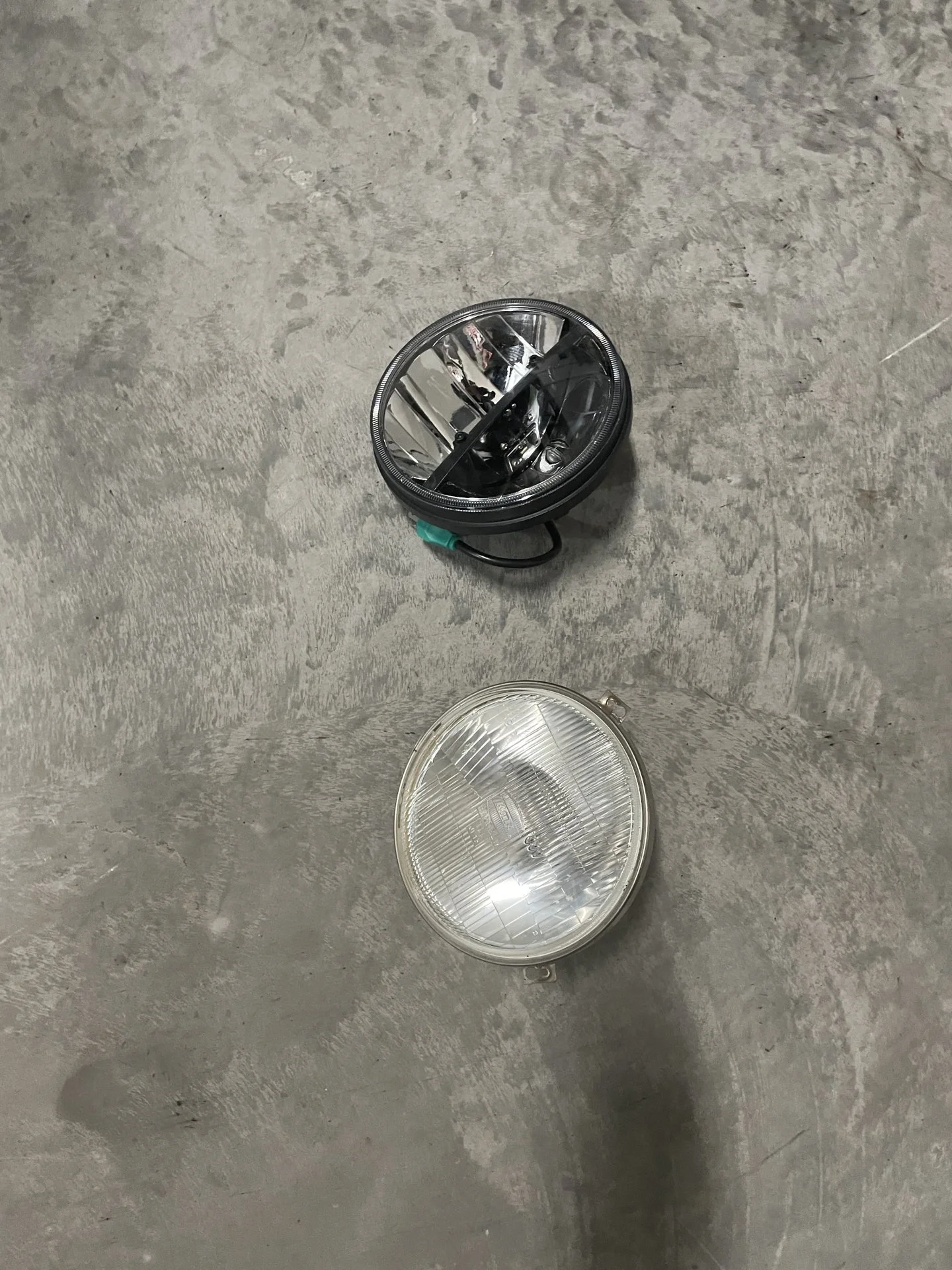

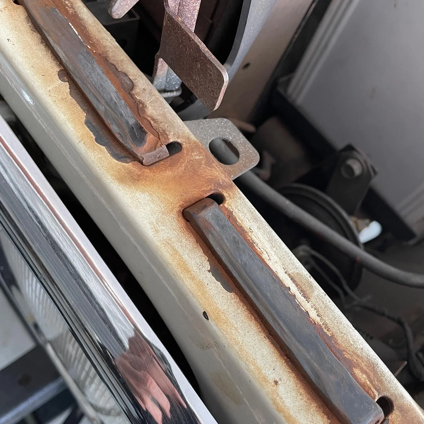

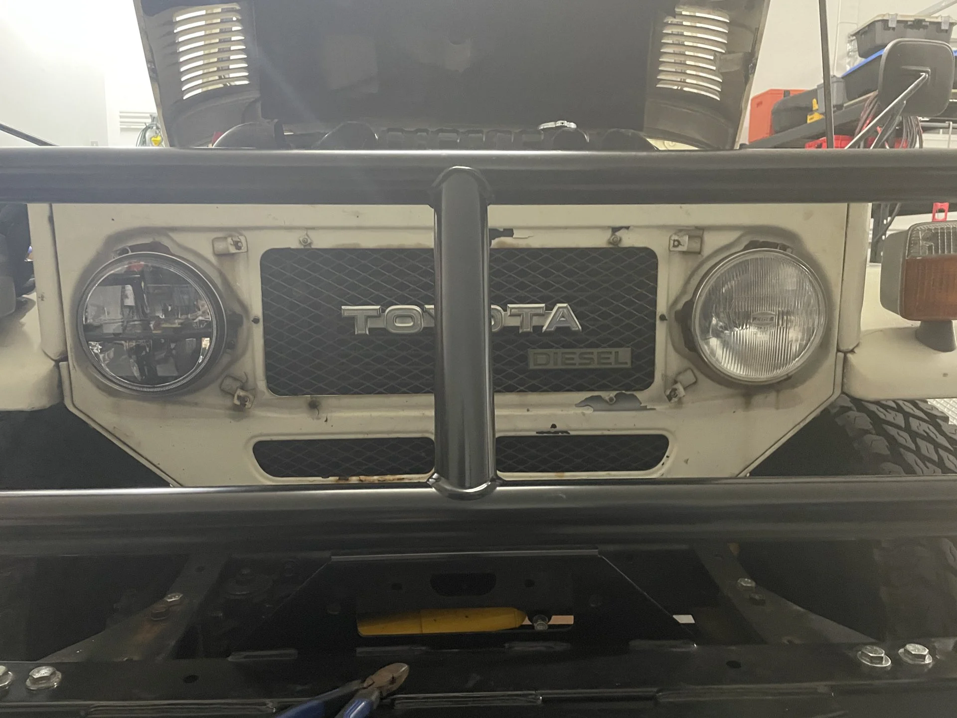

Got in some new headlights from City Racer. Thought I was going to enjoy a nice simple modification on a Tuesday night. I was wrong.
My headlight buckets and bezels are pretty beat up and all of the mounting hardware was completely seized/rusted.
The bezels themselves are falling a part so it looks like I am going to just have to replace them!
Good news is that the lights are significantly brighter, although I am not certain that I like the look as much.
Hmmmm....guess it depends, what's your goal on the overall look? You going to keep the patina or are you going to fully restore and do more of a restomod vibe. If it's the latter then those are cool.
