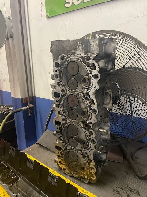

Well late December I started having an issue with white smoke at start up and eventually losing coolant. Being the 1KZ-TE, I figured minimum a blown head gasket or worse a cracked head.
I had the car shipped to H&H in Charlotte after calling around, looking for some shops and seeing he was recommended here and by TLC at the end of January because I was otherwise engaged with work and could not coordinate it. CS & R Transport did the transport for me and was great to deal with, he also delivered my kids 4Runner we bought from AP Vintage in Statesville.

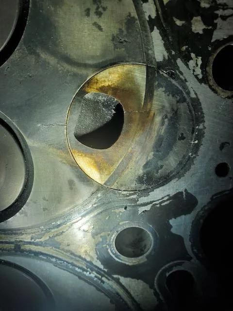

Once Dean and crew at H&H were able to look at the motor, they confirmed it was the head that had cracks, one major one and then all precombustion caps which is common but the one with coolant leaking in the combustion chamber was obviously not good lol.
I had already provided H&H with a new gasket, water pump, head bolts, timing belt, etc. Just not a head as I was sure it was a head-related issue. On a Thursday afternoon I called Kiwi Cylinder Heads in New Zeeland and ordered a complete 1KZ-TE head with the correct valves etc. and it was delivered by the following Monday.

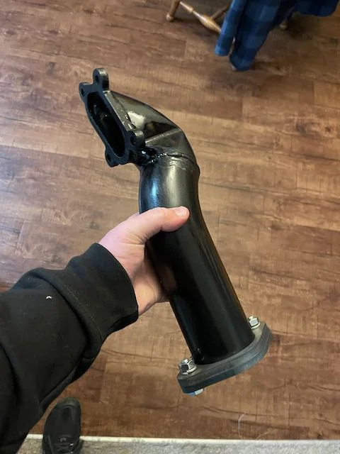

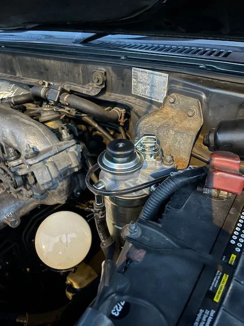

After I got it back, I added a new Fuel Filter assembly with a new heater etc. Otherwise, the next plans are a full exhaust I have a 3” dump pipe from KRAE and will build it from that, looking to have Henrys muffler do it since they are closer to me.

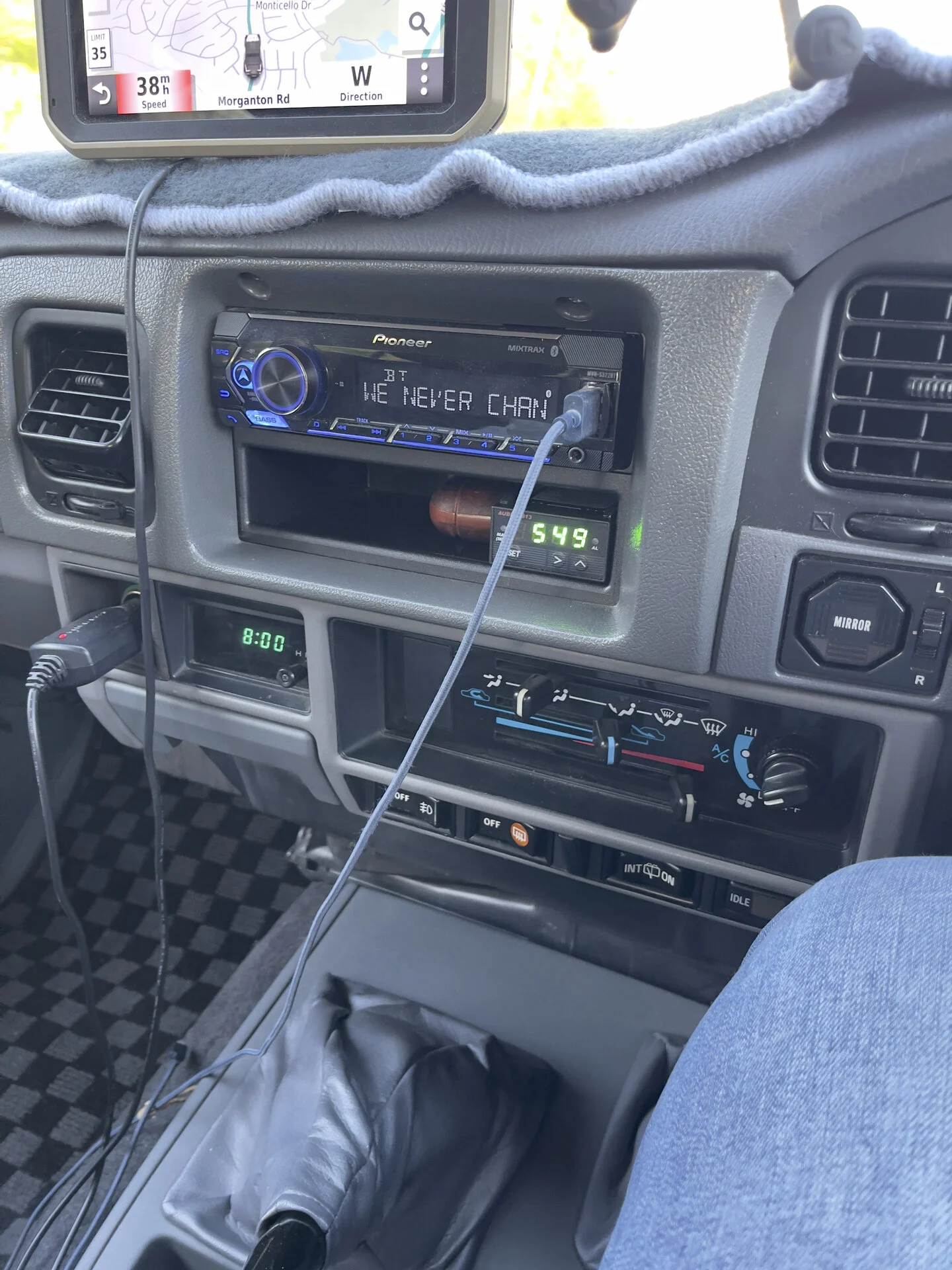

Do you have any pictures of where you installed the probe?
Also do you mind sharing how you went about your wiring. I am in the collecting of parts stage of this project and I am just trying to see how others have gone about it.
So I got an EGR delete kit with the gauge from Fit Garage (www.thefitgarage.com) and the probe goes through the blocking plate at the exhaust port for the EGR system.
The thermo wiring is just run in through the fire wall and up toward the stereo din and I spliced into the accesoriy power and ground for my stero for power for the gauge.
I just removed the trim and pulled out the radio and din mount and then drilled a hole for the wires in back of the din cubby and then took double sided tap on the bottom of the gauge to keep it in place.
I can't remember, is yours a manual or automatic? If you've got an auto then there is a nice port in the firewall where the clutch cylinder would go, it is a great spot to run wiring. In my first LJ78 I pulled power from the clinometer light circuit, but you could easily tap into any of the IG power circuits in the dash or run a wire from the underhood aux power box. If you're using an Auber gauge they have pretty good instructions available on their website for wiring and programming the unit.
That truck is an automatic. I need to pop the hood, but I am pretty I know where you are talking about to pass power through. I like the idea of using the aux power box and power everything from that. Thanks for the recommendation.

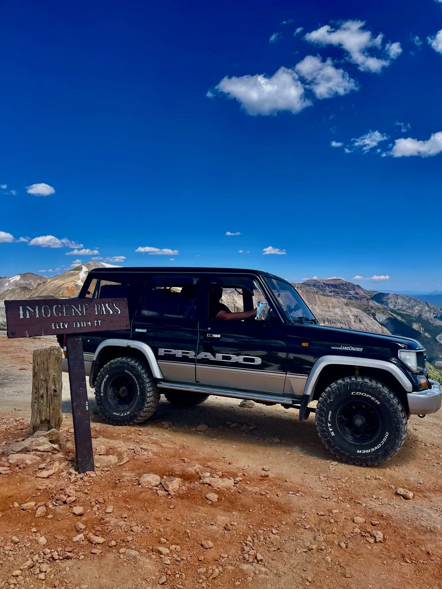

Any way the KZJ78 has just been chugging along. We made the drive from Phoenix to Telluride. Did Imogene pass from Telluride to Ouray and it did great. More highway milage pushing to Denver.

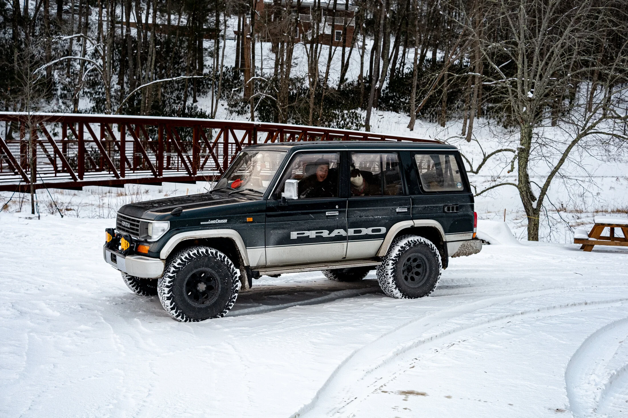

Here is a pic from when we went up too Boone to see the snow since it skipped us in Southern Pines.
