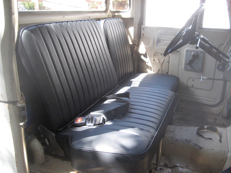

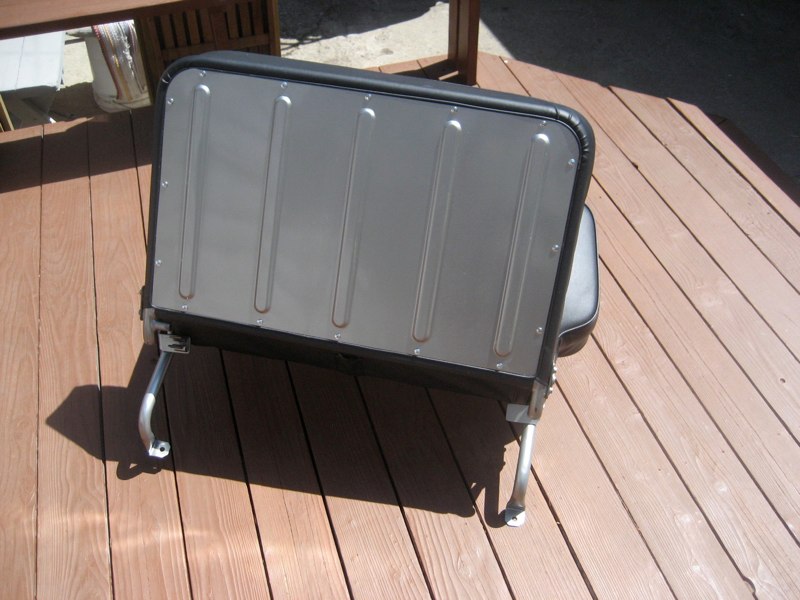

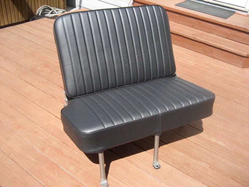

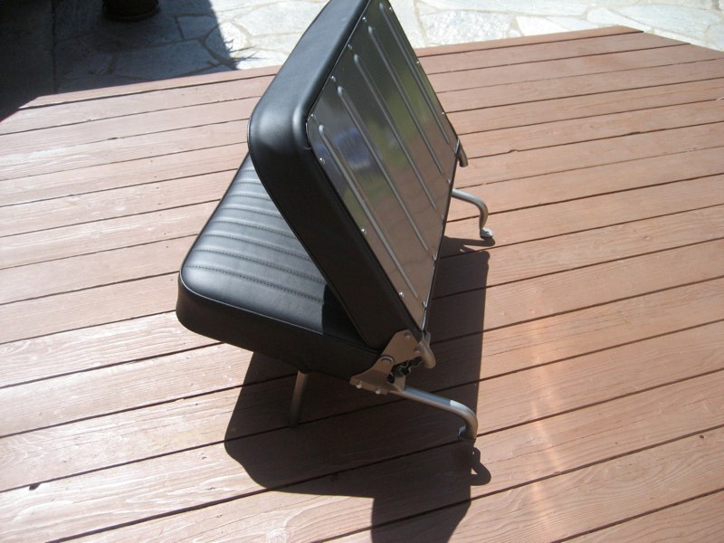

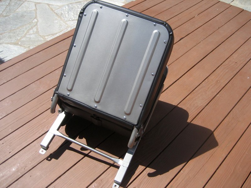

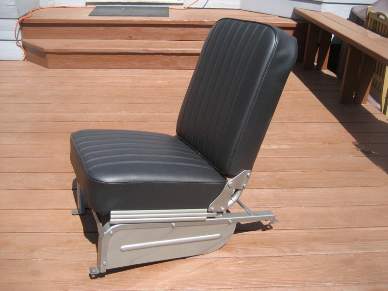

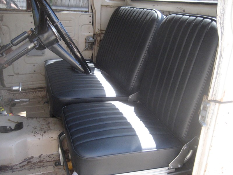

Well after a long wait for my seats they are finally finished. I dropped them off before I left for South Africa and a month later they still weren't quite done. Luckily for me I've become a little more patient as I age. :grinpimp:
I was getting tired of pulling the truck in and out of the garage with the temporary seat... :o
The original plan was to buy the SOR stuff and have my upholstery guy install the foam and covers. But after talking with him he convinced me that he could do it all for a reasonable price and he assured me I'd be happy. Besides I'm trying to support my local businesses as much as possible and I was very pleased with how the 40 seats he did turned out. I could just pull them out of the truck and drop them off.
Here's what we decided on:
-The seats would be completely taken apart and all the springs would be reconstructed.
-The seat assemblies would be sandblasted and returned to me for painting. (I changed my mind on this and provided them with the CCOT paint so they could do it).
-They would custom make the seat covers from measurements and photos I provided of Mike Piper's 45 seats that had the SOR stuff in it.
-They would replace all the foam with new high quality stuff.
-They would install seat heaters in the driver and passenger's seat (but not in the center of the bench).
-After paint they would reassemble everything and I would pick em up and install them myself and wire the heaters.
Here's what they started with...
After a few minor hiccups with the painting (ok they had to re-sandblast, re-primer, and re-paint). :doh: The seats turned out great!
The only things left to do are wire up a switched power wire from the fuse block for the seat heaters and source some type of push-in rubber grommet for the bottom of the passenger seat post that doesn't bolt to the floor.
Most importantly the 45 is back on the road!!!!
:grinpimp:
Very nice work! I've looked locally, but not much luck finding a guy to make some new skins for mine...in original coral...so I keep looking, or since I can, I'll probably end up making them myself.
And nice write up on the fan...I'll be doing the same.
Holy crap those are purdy! Very nice work.:cool:
Those turned out very nice Dom. You need to stop on the way home one of these days, I want to see those seat heaters and get you the parts you are looking for to get this thing closer to finished.
