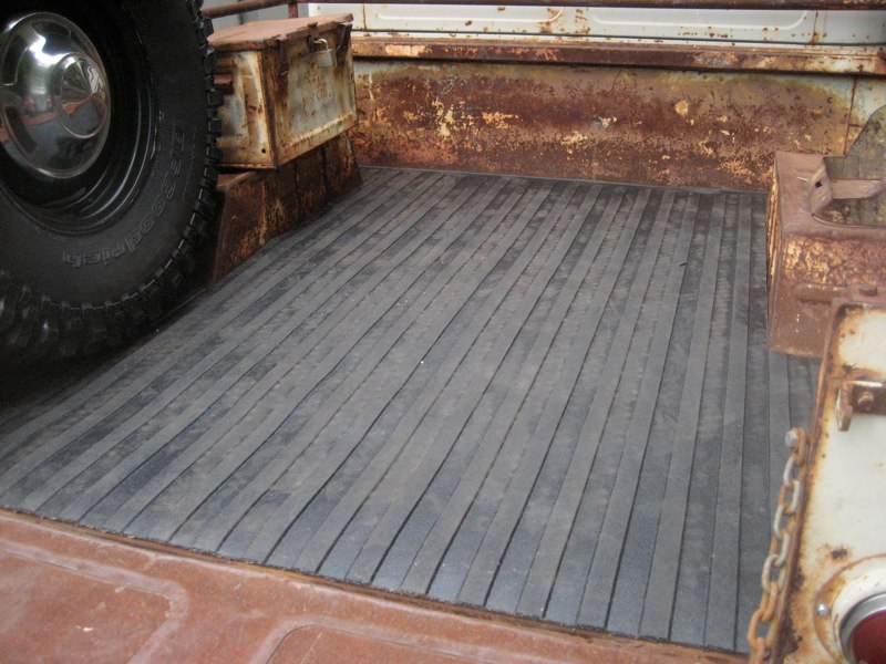

Bed Mat Install...

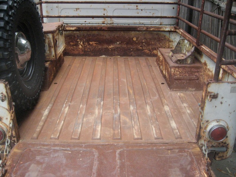

After the drive to Mammoth and a few trips to work with a few bags in the bed I decided I needed to find some kind of liner to keep the surface rust from getting all over my stuff. I used a large piece of cardboard on the trip snowboarding but that was a soggy mess by the time I got home. First I measured the inside of the bed (about 68" long and 63 3/4" wide) then looked online and wasn't sure the quality would be what I wanted. Then I dropped by the local auto parts places (Manny Mo and Jack, etc.) so I could put my hands on some of them. I couldn't find a universal fit so I thought I might buy a custom fit one for a Tundra that I could cut to fit but that seemed like a big if.

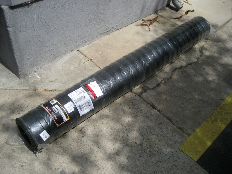

I finally settled on a universal bed mat that was 3/8" thick and seemed of high quality that I found online:
It's made by Rugged Mats and the part # is 400.RL and is listed as a 72"x98" Utility Mat (and Made In The USA!) I paid $70 with free shipping from Tri-State Enterprises but their site is something different and I can't remember it. :frown:
EDIT: HERE"S THE LINK: TRUCK MAT
So it arrived and I went to work...
Here's what I started with:

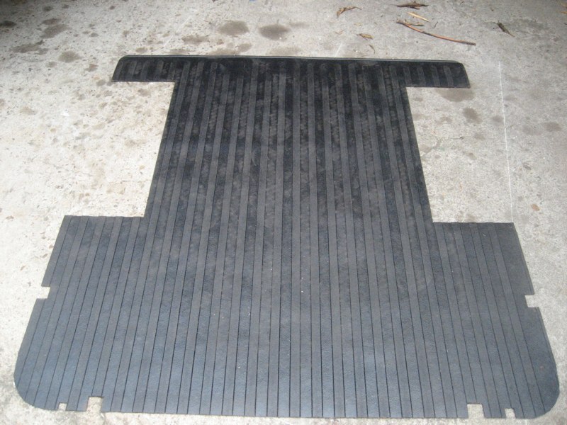

First I measured out the bad and made the first cut...

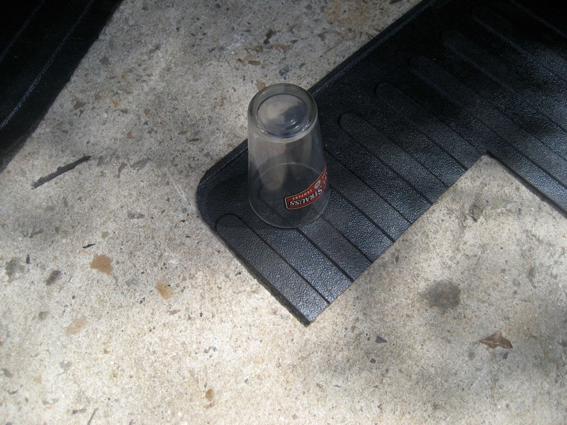

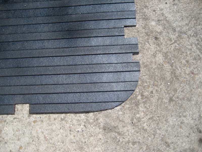

The edges are all finished so I knew I'd be losing two sides of that but the stuff is quite thick so I had no hesitation. I used simple tools including a razor cutter, tape measure, pen, a couple of straight edges, a square, some cups, cardboard, and trauma shears from work. I really took my time and made one cutout at a time and then fit that part to be sure it was right. Every cut was double checked before I moved on. In the front corners I used a glass that matched the curve as a template...
The trauma shears worked a little better on the corners than the razor. In the rear corners the curves were much bigger and I couldn't find anything that matched so I made a cardboard template...
I made small cutouts on the edges for the braces on the inside of the rear and also made cutouts for the rear tailgate braces and below the tail lights where the wiring drops down into the bed...

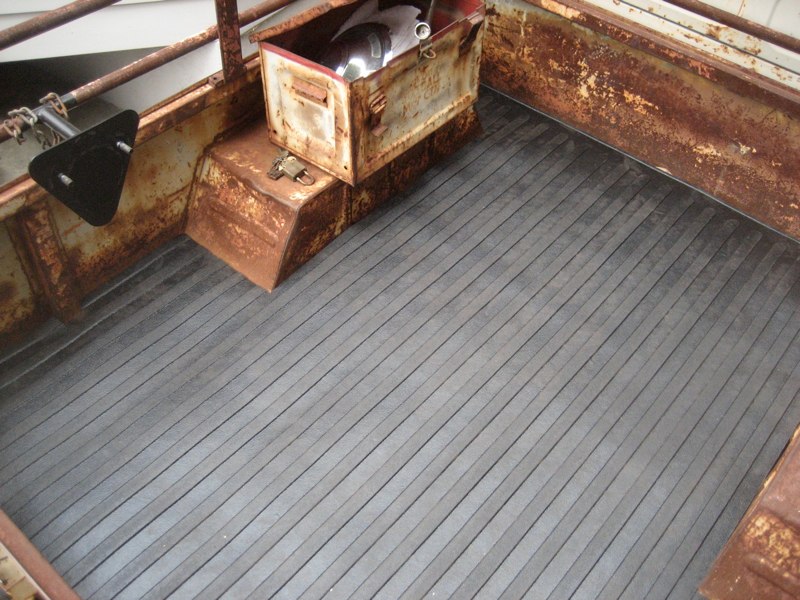

Here's the final product (If you look closely you can see the edging on the top and right side but not on the bottom or left side as it was cut off):
Here's how it fits:
The spare tire was a bit hard to get back on since I had welded the bracket with little room for play and the 3/8" thick mat actually did have an effect on the positioning of the tire. It's fine for now but may need some attention for ease of use in the future. All in all I'm very pleased with the results and for $70 and some manual labor it was well worth it.
Oh yeah, and get a lot of razors. I used 2 and switched them around so a total of four cutting edges. They dull quickly on the concrete and it would have been nice not to make the later cuts with a dull blade.
:beer:
