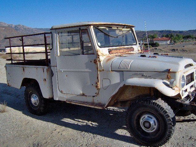

Well, after 18 years of owning Cruisers I've finally brought home my first 45. It's a 65 SWB removable top I found about 30 miles from home. I'm pretty certain I may have paid more than market value but I have to be honest with you...
I'm not losing any sleep over it! :grinpimp:
It's 95% original (paint included, i believe) and a pretty solid start. I plan on having this for a long time (have had my current 40 for 14 years) and I'm stoked to have found what I'm looking for so close to home...
Now my 40 has a new friend and garage roommate...

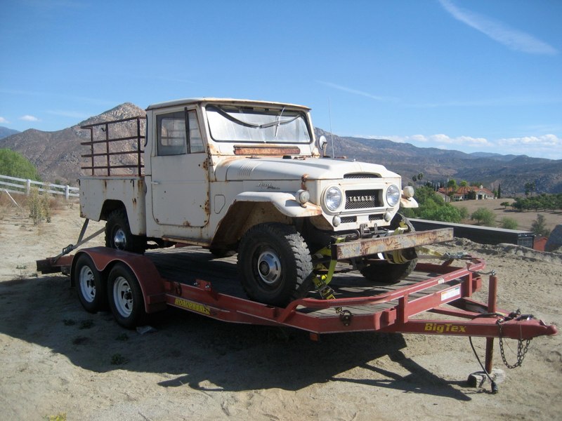

Picking her up...
PO was kind enough to trailer her home for me!...

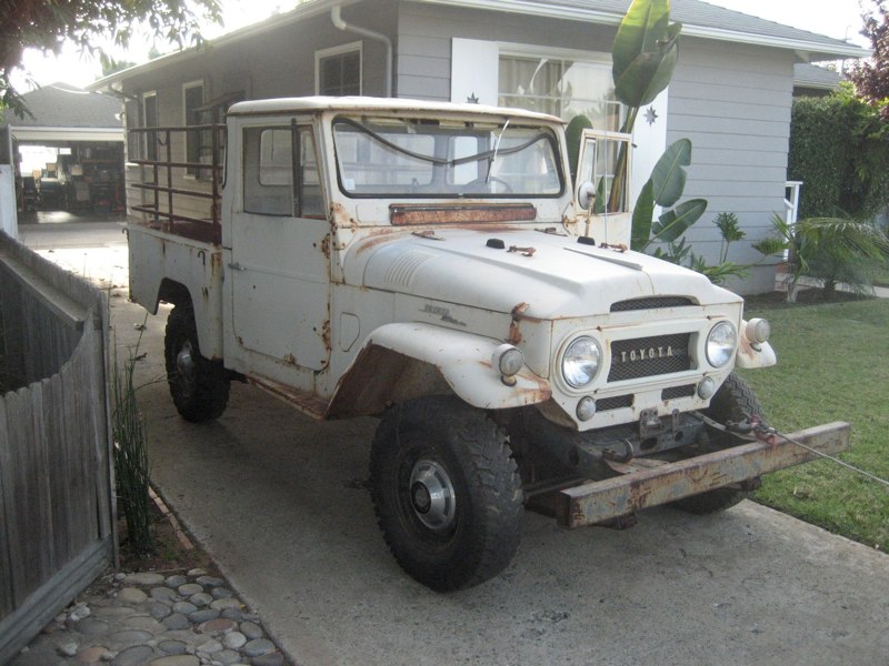

At home by the beach...

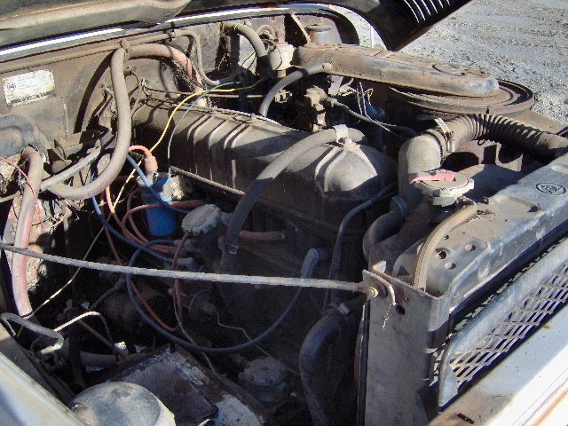

Engine...

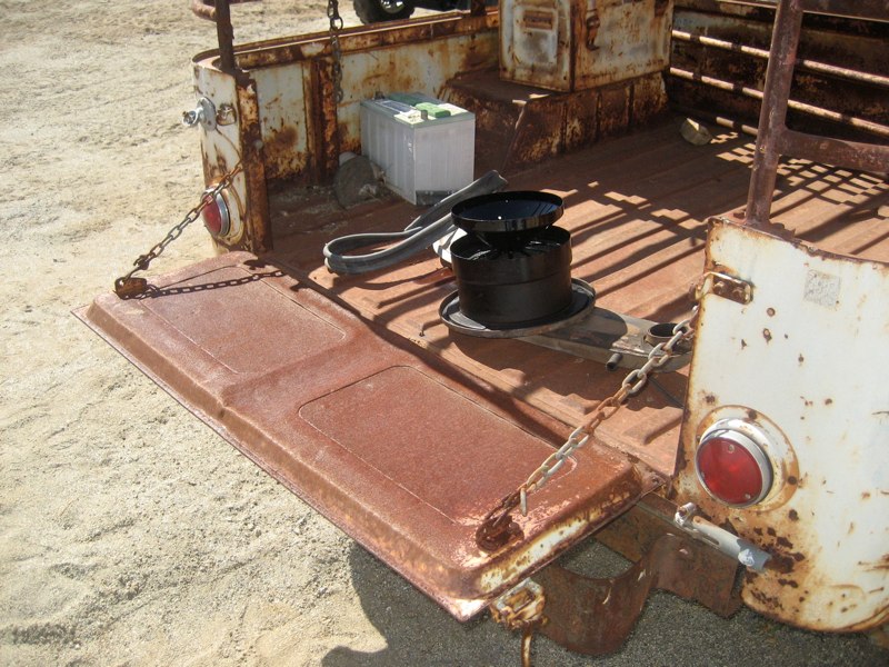

Bed is covered in surface rust but no serious cancer to speak of except the rear sill...

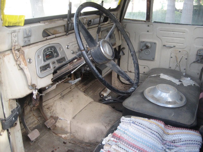

Interior seems like a time capsule to me...

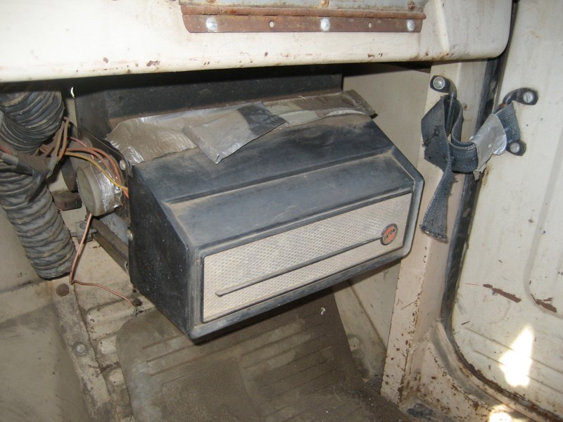

Eaton Heater...

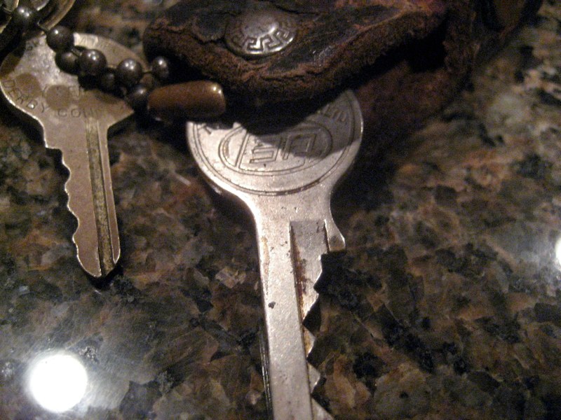

TEQ key?...

1. The engine is covered in decades of dust and dirt. What's the best way to clean it without destroying any decals or scratching the hell out of everything with rags? Maybe soak it with___________ and rinse? Any suggestions are appreciated. Just looking to make it a little more serviceable not pristine.

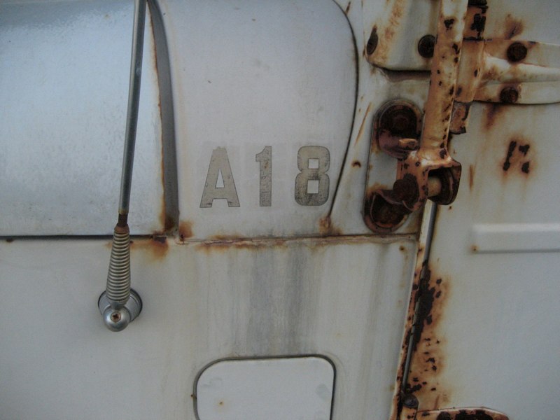

2. I'm also curious about this ID on the side of the rig. Anyone have a clue? Government truck?

They were used on the early trucks it is factory----but most people upgrade as they tend to pee with age. m

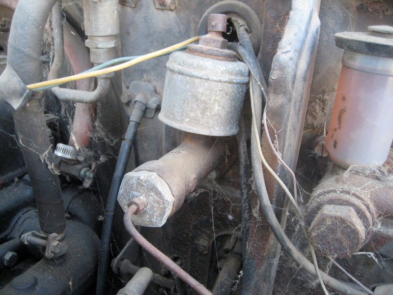

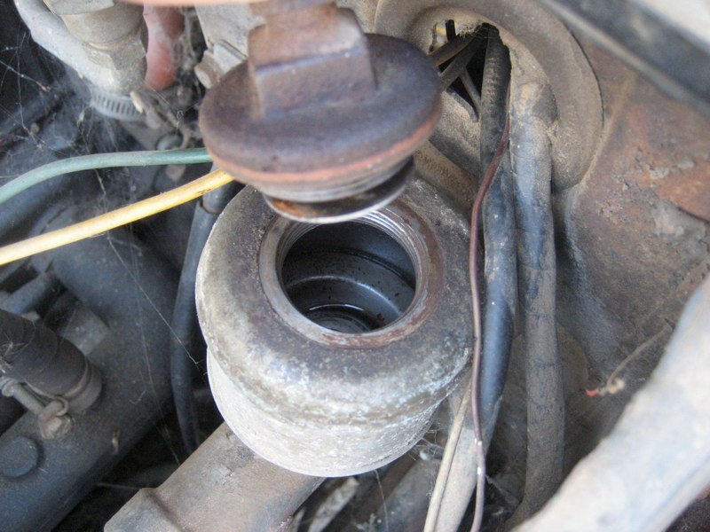

Thanks Bikerso. Pedal goes to the floor and it's bone dry. Surprise surprise. I was really afraid of trying to unscrew it for fear of breakage but it came right off...
I filled it up so we'll see what it looks like in the morning. I need to get a second person here so I can bleed the system. Which brake master are most upgrading too? (I know, I know... search!)

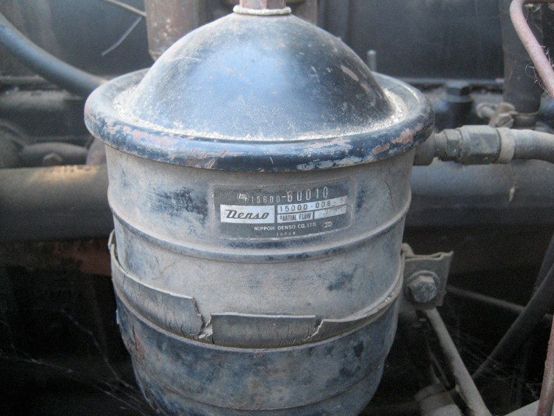

I also removed the oil filter (canister type) and cleaned it all up. The seals look to be in really good shape but now that it's back together it's leaking out of the bottom. :mad:
Filled up the radiator with some coolant to look for leaks and there is some dripping from the water pump area while it's just sitting. I'm going to try to take a closer look to see what exactly is leaking, but I have to admit it's been more than a decade since I worked on an F motor... so I suppose a pump and gasket is in order as well. I'm thinking of just driving to SOR monday to get a few things but we'll see.

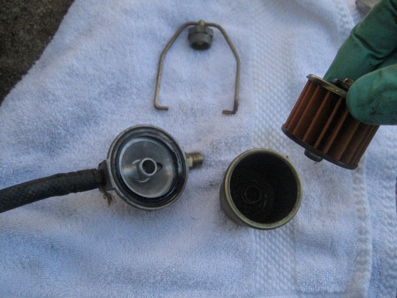

I also removed the fuel filter and cleaned it all up. Local dealer said it's no longer available but I have to say they are not very helpful. I'll probably check with CDan soon...

I removed the fuel pump as it didn't seem to be working. The rig will fire up immediately if you pour gas in the carb but stalls after it's gone. I have a spare pump in the parts bin from many moons ago but after taking this one off I could see the spring had popped off and was jammed in the pump. I pulled it out and reset it and bolted it back on. The PO thought that was the problem too so I was hopeful. Turned the rig over with the fuel line disconnected and it pumps like a charm. After hooking it all back up it still won't run on it's own however. I cracked the line at the carb inlet and it poured out. I think the pump is good, so on to the carb which I am totally clueless about. It's another Carter YF so I suppose I could rebuild it? Or maybe try to get a hold of an Aisin?

Check the FJ25 part number thread for the fuel filter part number. Its still available. Send the master cylinder to Whitepost restoration for them to work their magic on em. That clutch master isnt original. Find one and sent that for a restoration also.
Ditch that carter carb also and try to find an original Aisin large sight glass carb :D
Also, every Toyota canister oil filter cartridge comes with all new gaskets for the canister. That should fix your leaks. There is also a drain plug on the bottom of the canister itself that may need to be tightened or needs some thread tape to seal it.

For the brake master cylinder I would strongly recommend a dual master cylinder---I now its not original---but better to be able to stop your truck than wreck an original. Check with Mark from Mark's Offroad.
