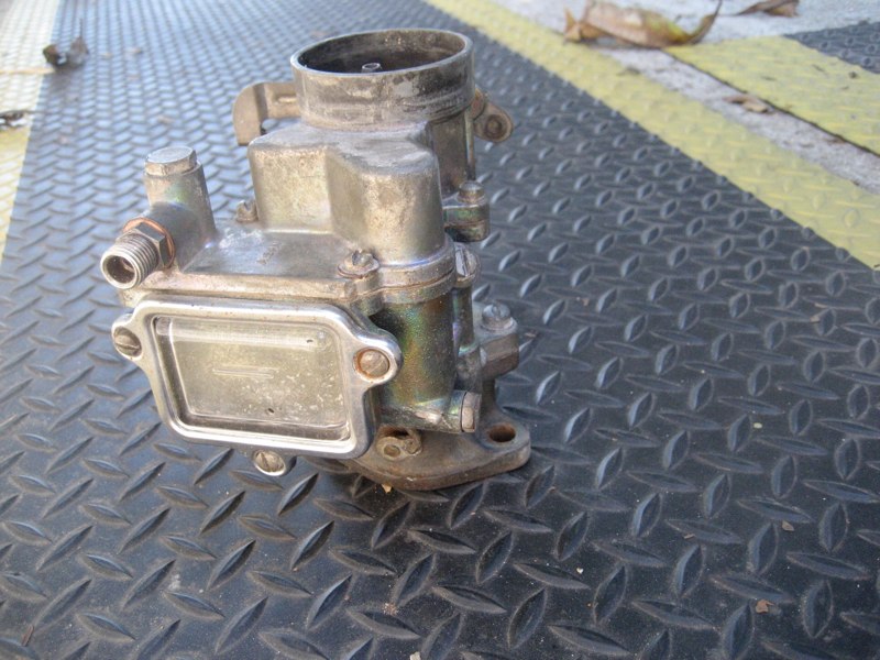

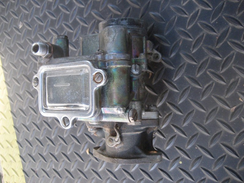

So someone responded to my want ad (Thanks Roy!) for a big window and it arrived a few days ago. Came out of a 65 and was running prior to being pulled and stored in the early 80's...

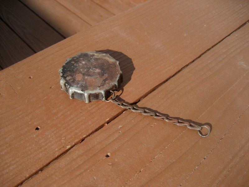

He also threw in an old oil cap as mine had one catch and sat caddywompus...

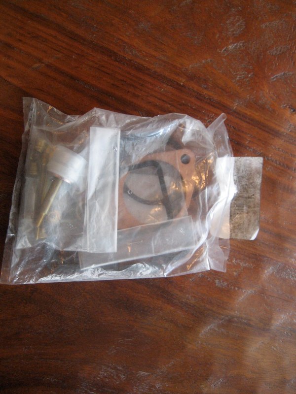

I got a carb kit for it today and will tackle this in the next few weeks...

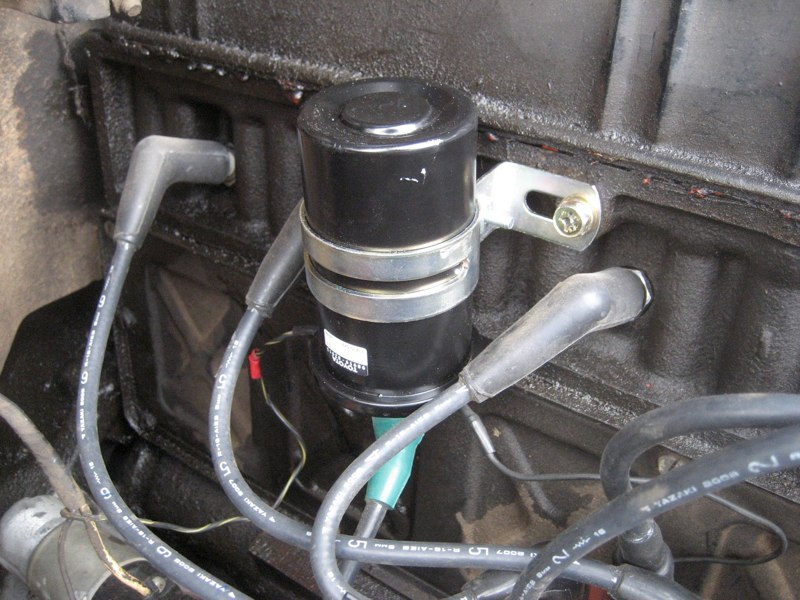

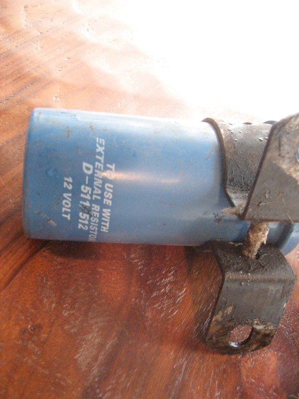

I also added a new Toyota coil/points/condenser since the P.O. had an aftermarket on there that was burning up points. I can't imagine why!!??? (This was on the back side mounted towards the block)...
So no external resistor was killing these points. I was actually pretty surprised how well it ran considering the points were all smoked within a few miles. :mad:
Here's the new Toyota setup (internal resistor):
