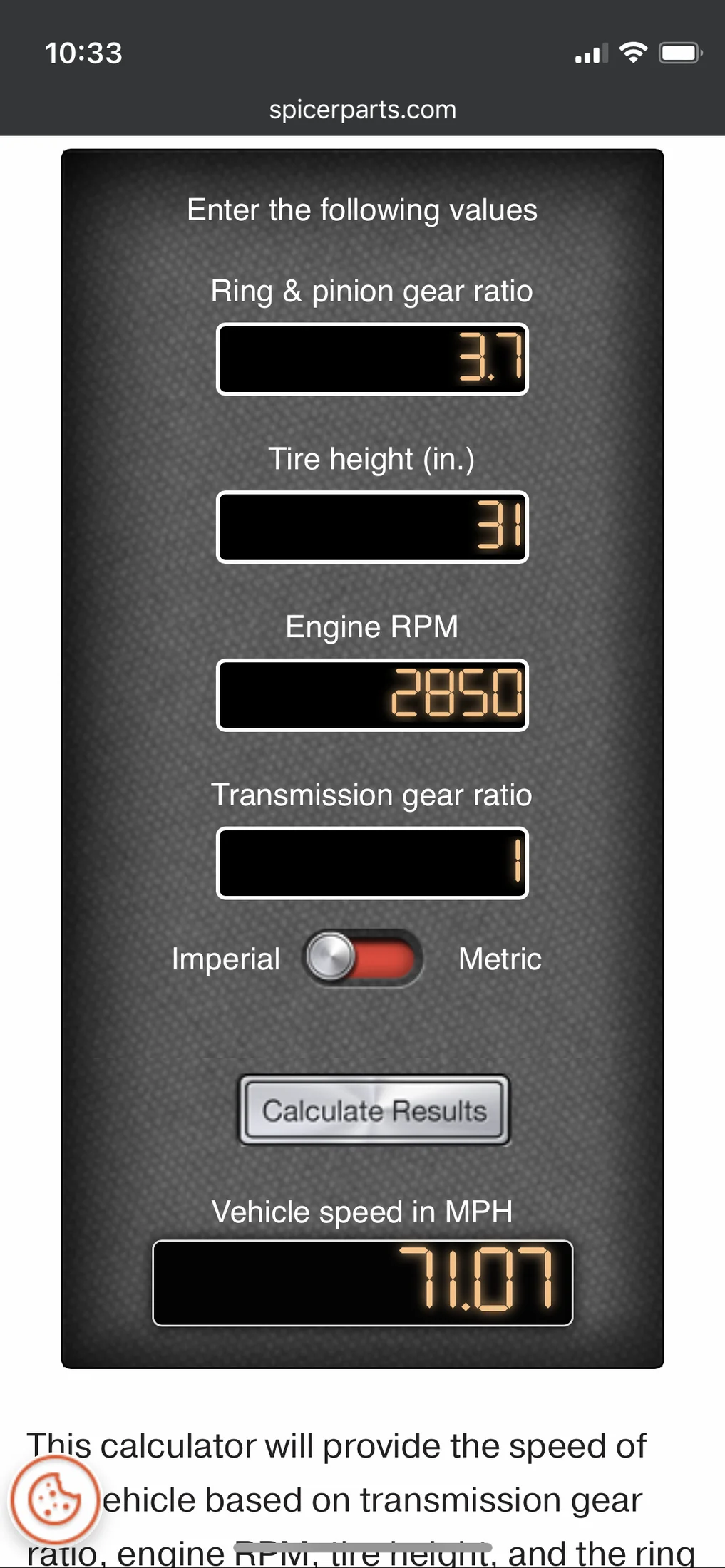

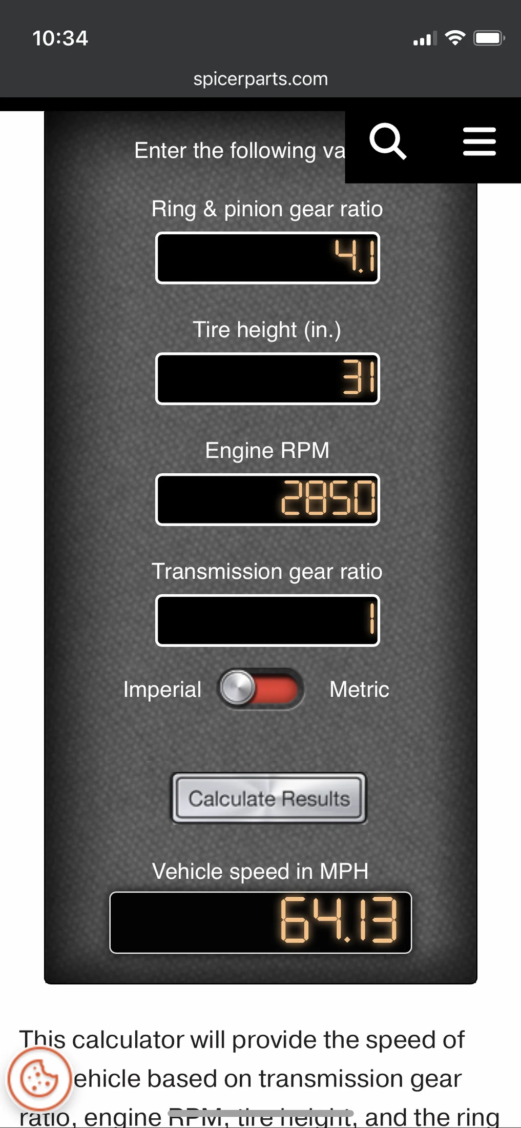

Those tires look to be around 31”, not sure what axles gears you have but they’re either 4.11 or 3.70
do a good baseline of your cooling system
And you can run at 3000-3200rpm all day.

View attachment 3903057View attachment 3903058
Thanks I appreciate it! Yes, it appears there are roughly 31s. They stand about 30 inches tall. I’ll definitely go through the cooling system and get it baselined. The radiator that’s in. It seems to be decent condition and doesn’t have any leaks so I may just keep that and flush it.

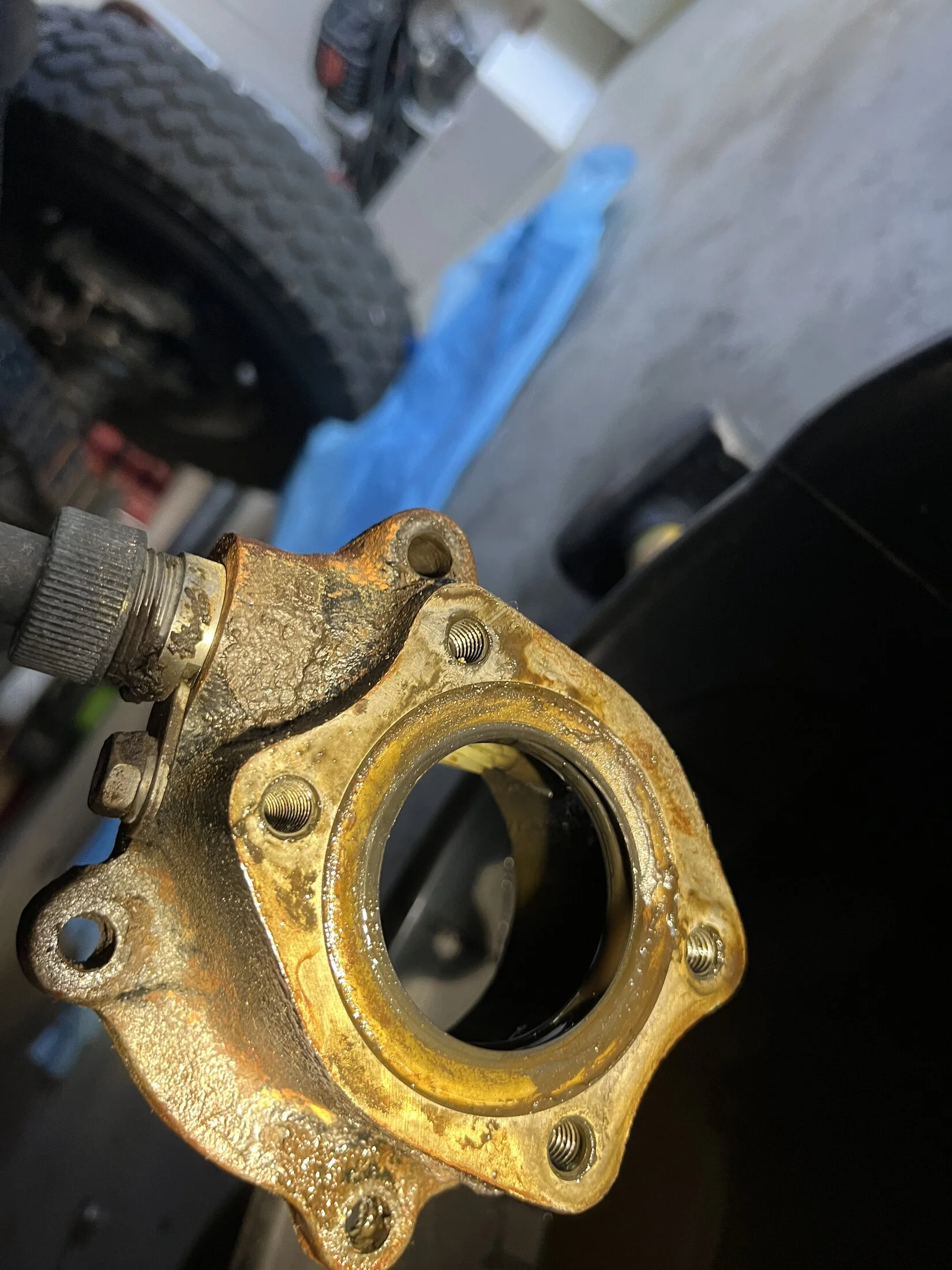

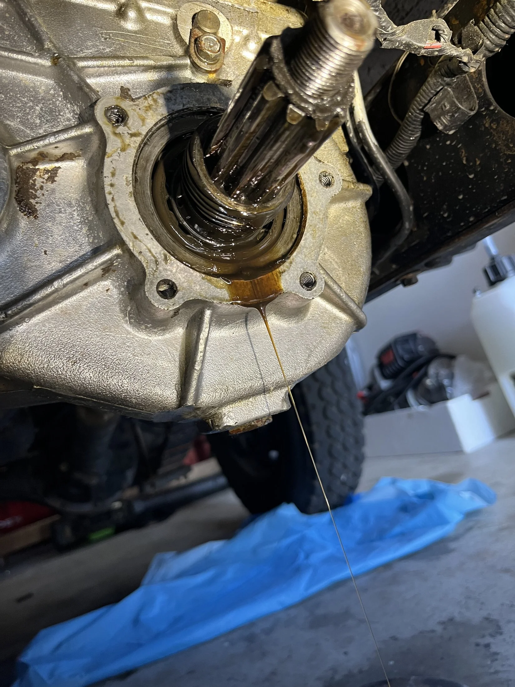

It looks like this transfer case is new or rebuilt unit. However, it looks like they just took off the speedometer housing and slapped it on and didn’t replace the output shaft seal in the speedometer housing as it feels old and crusty. So I think that’s where it’s been leaking. There also wasn’t a seal between the speedometer housing and the transfer case but I haven’t looked at the parts diagram to see if there is a seal there. I’ll add the output shaft seal to the Cruiser outfitters order.

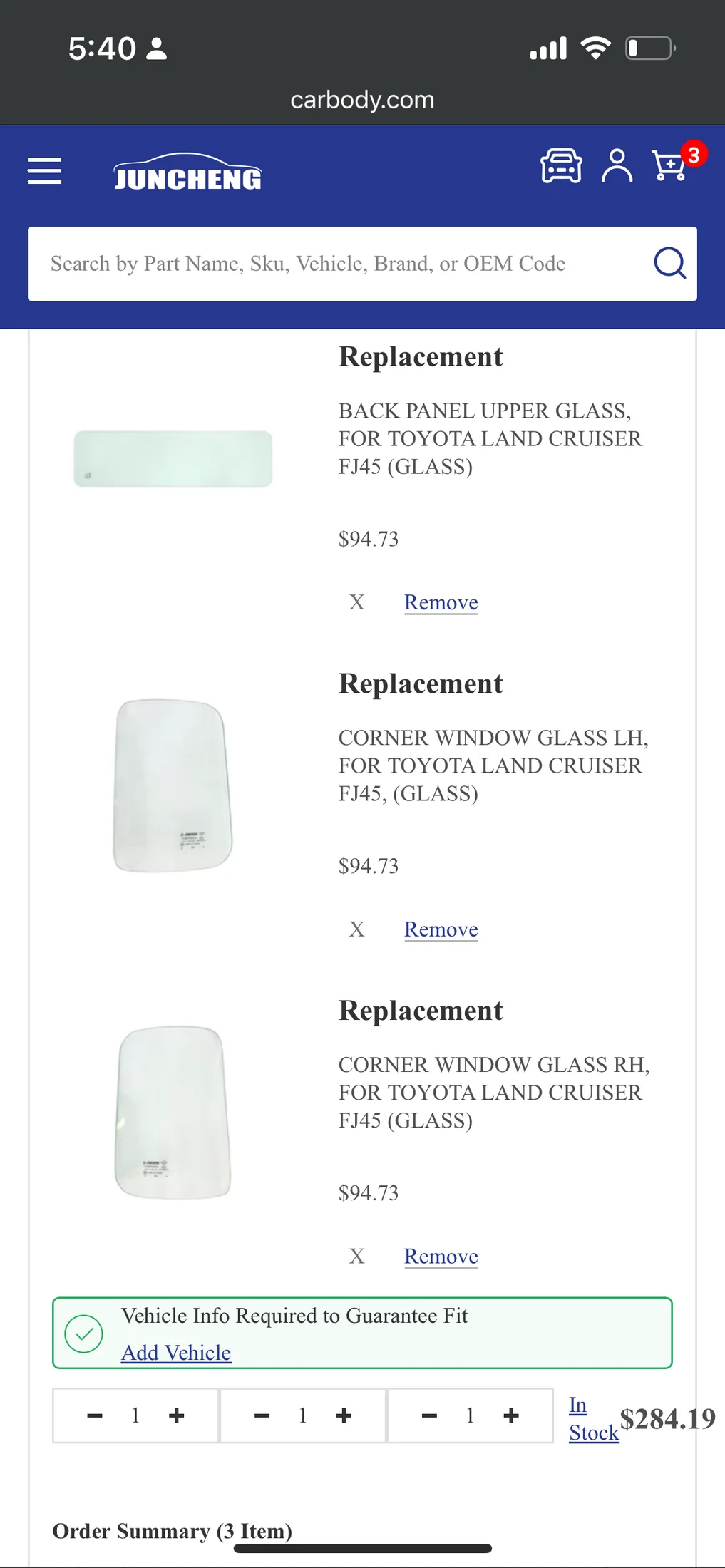

Has anybody had any luck, sourcing rear corner glass or rear panel glass? Seems to be unobtainable now. I’m not sure what the reproduction aqualu 45s are using but it seems like nobody in the states stocks the rear glass.
I found some out of China for a reasonable price of $300 for the three pieces but they want $1700 to ship it.
I wouldn’t trust anything from China these days. The center glass is flat and can be locally sourced from any glass shop, using your existing unit as a pattern. Look to the Middle East for the corner pieces.
post a wanted in the 45 classifieds, there are some used ones around.
they are 45 specific and left and right sided
x2 on rear glass, any decent auto glass shop can cut the flat glass
they have free shipping from their US based wesbite. Showing sold out right now. I am curious how well their corner glass fits.
I have to look up their US based website and check it out. I’d be curious to try for the price.
