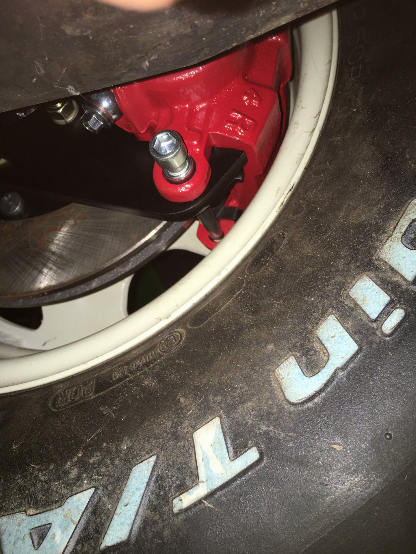

The 40 is finally is finally back on its own weight.

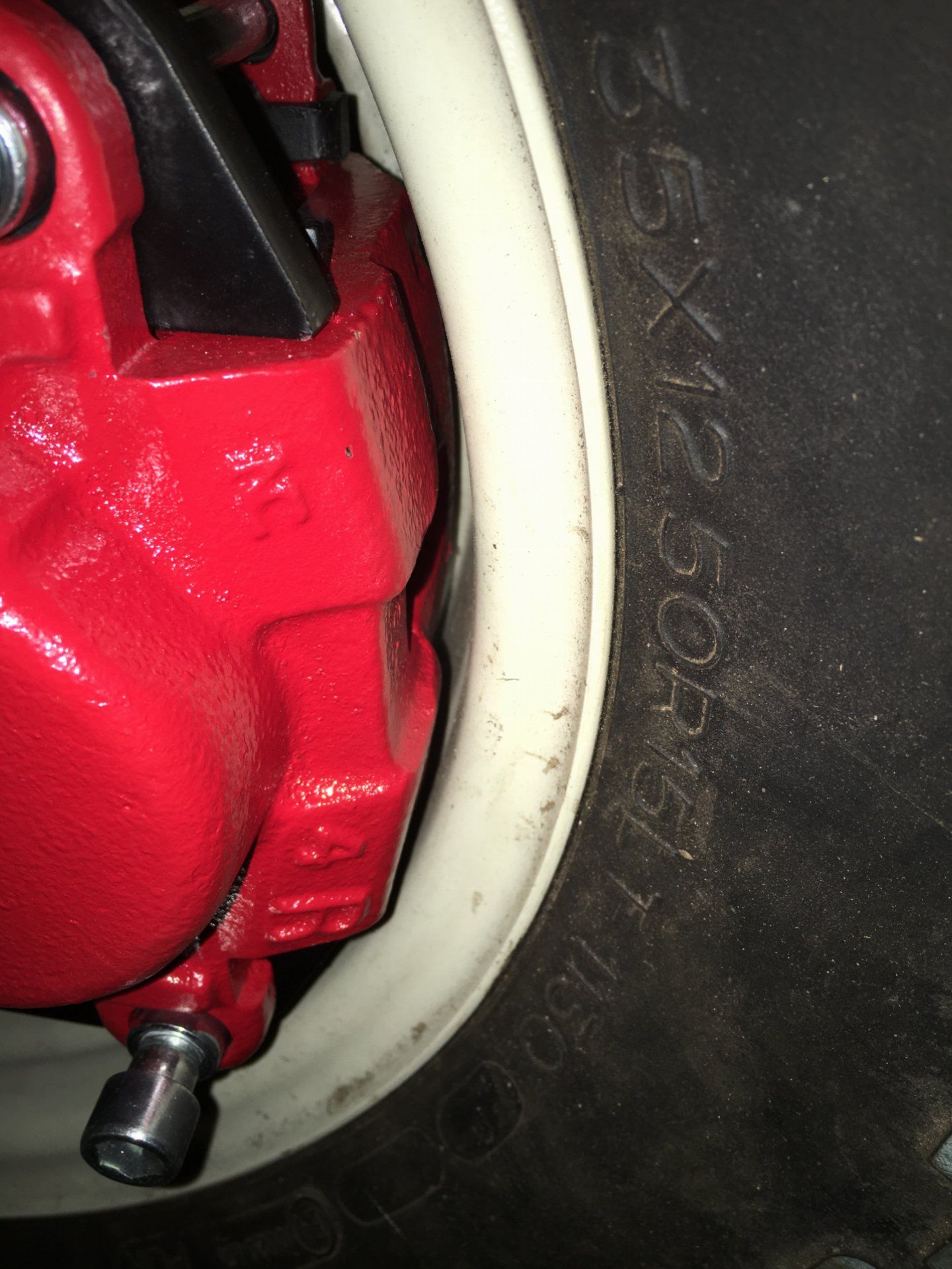

For those wondering the clearance of widened steelies and the calipers. Let's just say it's tight!!! But everything fits fine.
I'm also glad I went ahead and changed out the wheel studs for longer ones. Plenty of thread for the lug nuts.

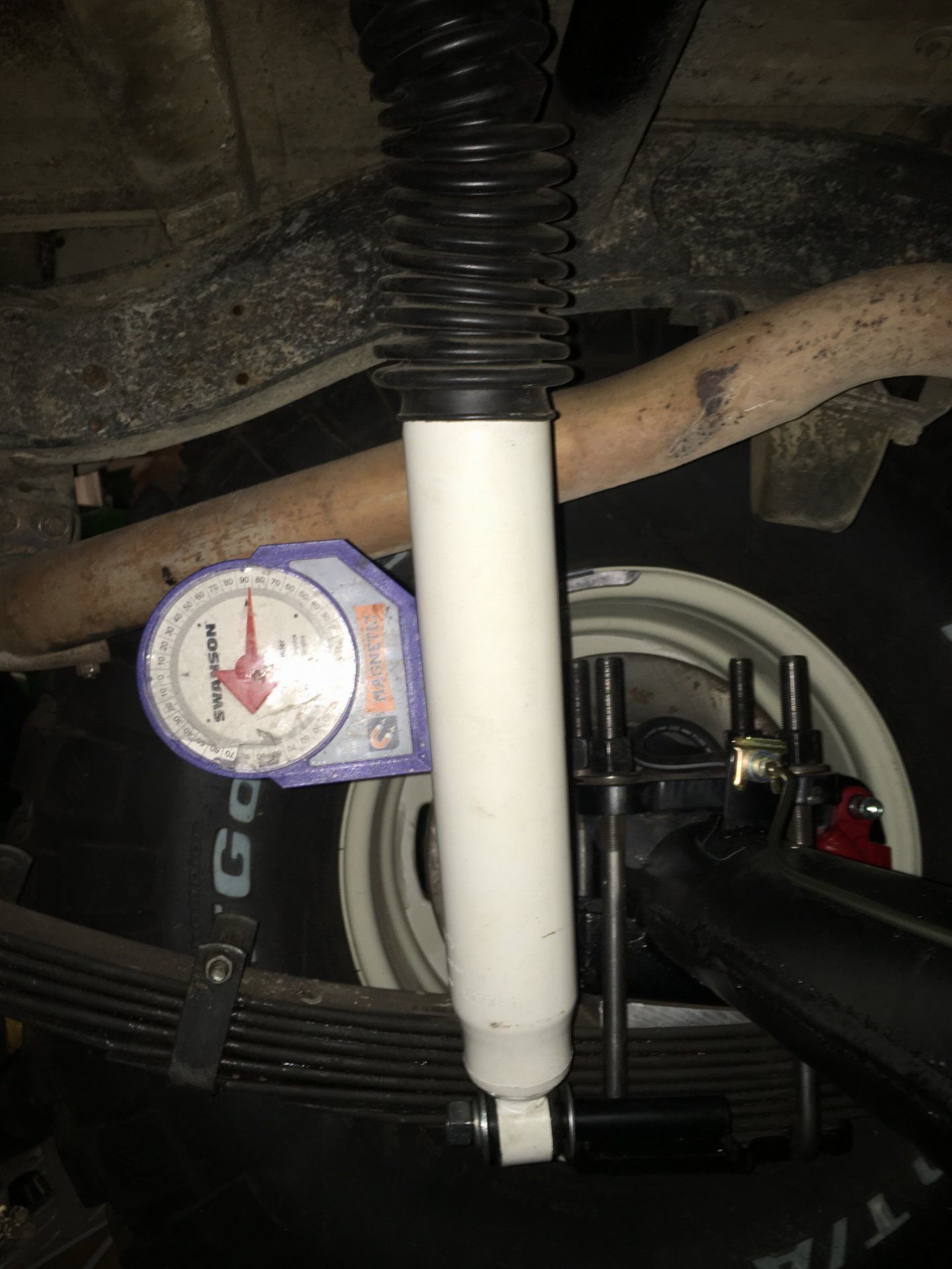

I'm also pretty happy with the shock position and have to say the Low-range off-road shock mounts worked perfectly for those wanting to do a spring flip. The shock sits about 2-3 degrees from 90 and after lubing the bushings they slide easily on and off.

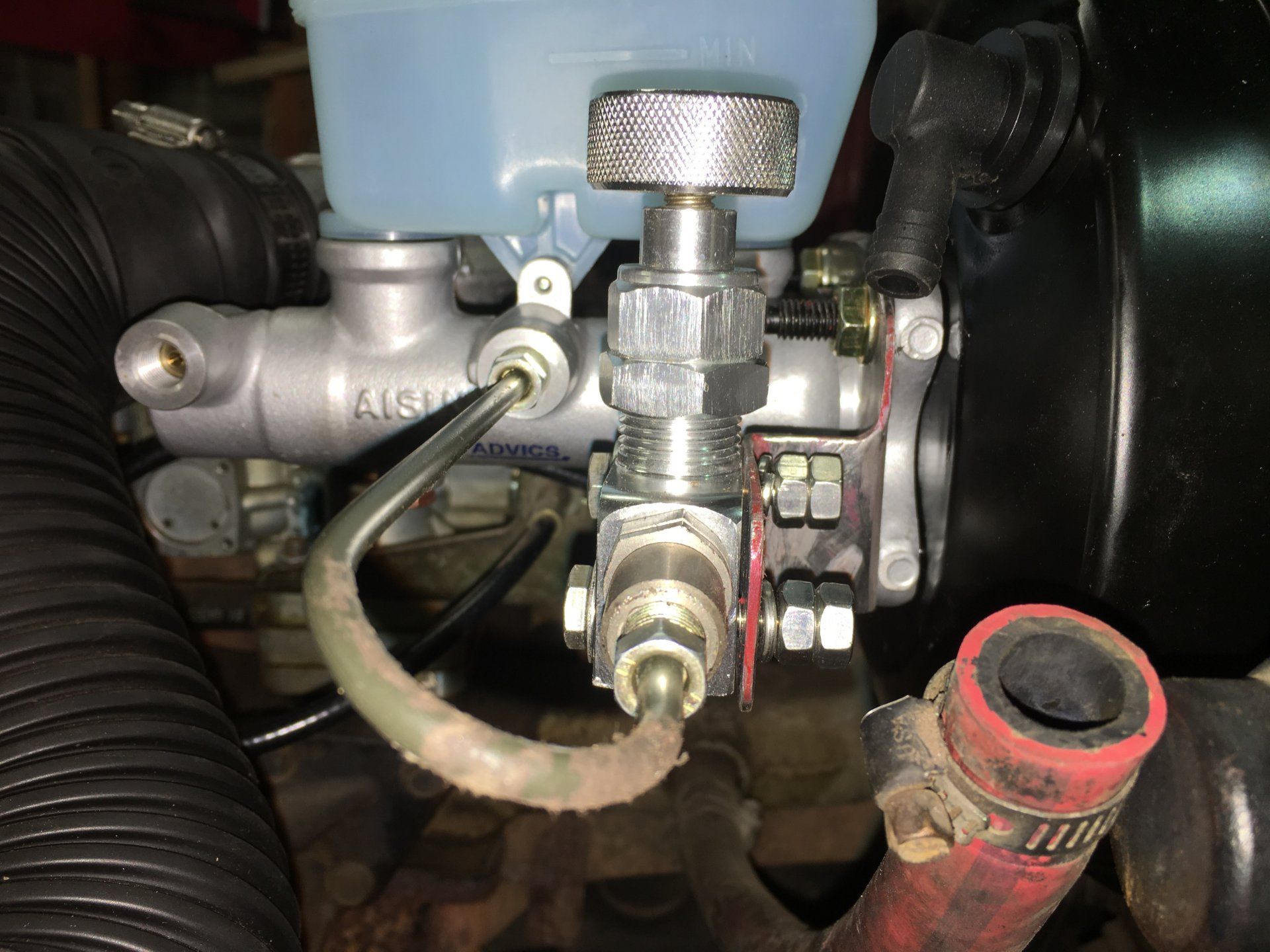

Started on some low tech bracket making today for my proportioning valve. Old vice on a stump, hammer, and some map gas.
Next to clean it up and paint it and then started plumbing the master.

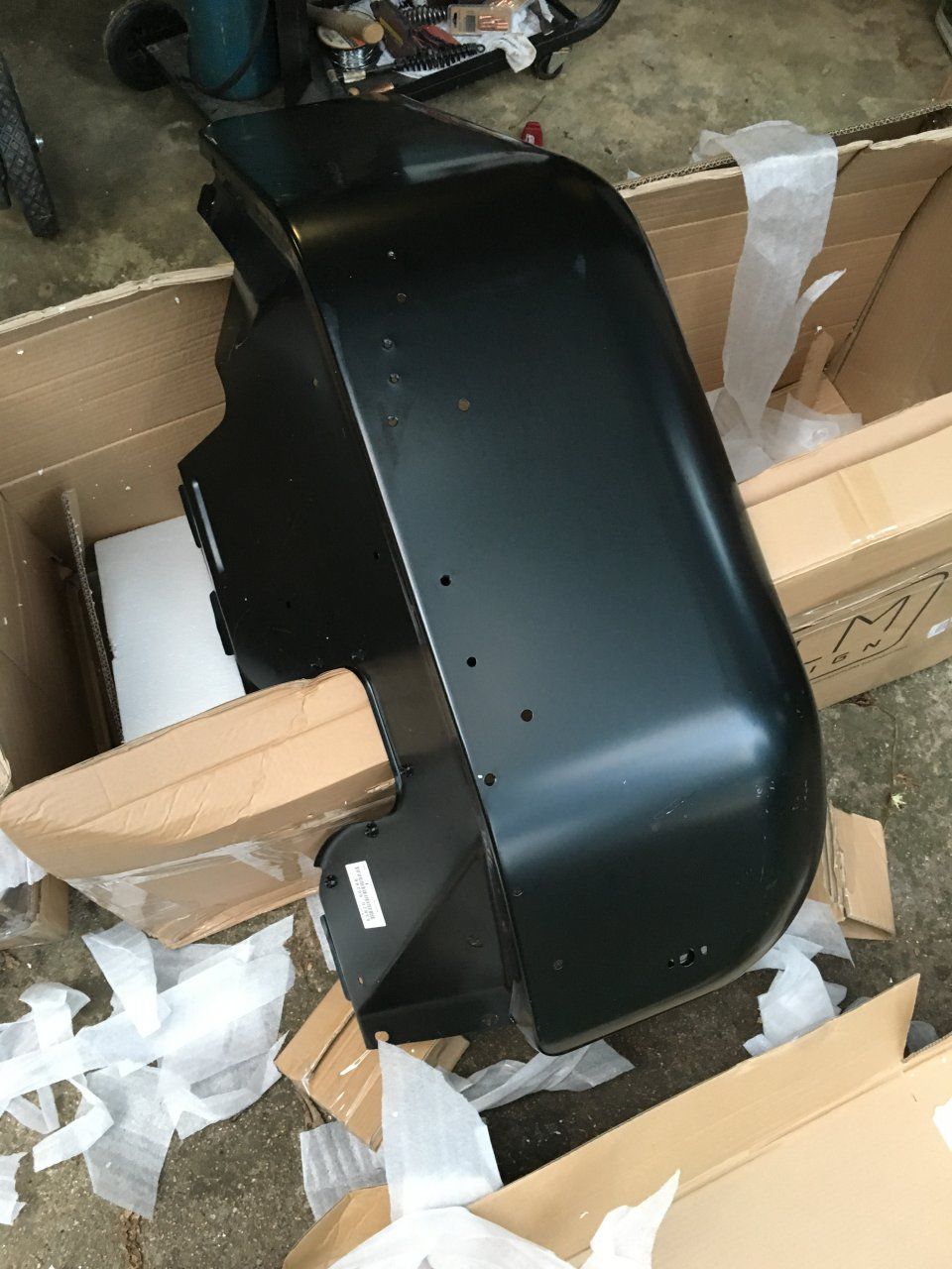

So I decided to hold off moving the fronts. I did enough to decide I like the way it looks so next up will be modifying the new replacement quarters and replacing my rear sill. Might as well spend the time on the final product that something I'm going to replace quickly.
Oh wow. Have u considered bud built quarters? You can order them with custom cuts or not cut at all for the fender opening. I know you already have quarters but if you could send those back it might make things a little easier for you. Just an idea throwing out there
@White Stripe - I'll have to check again, but I think I passed on them before as they don't have the factory rolled lip along the bottom of the fender and I was trying to keep that look.

Let's just say I didn't take the nuts off that hold the master to the booster and miss the fact that a relief would need to be cut around the raised part of the master for it to sit flush.
Let's just say the paint didn't agree with cutting and grinding the relief in. I get to repaint tomorrow, but decided I'd finished mocking everything up.
I think they are 3/16" thick to keep from getting dented easily, but no they don't have a lip. You could weld a lip on. But u already have quarters you seem to like so that's cool
80 series non abs master? And what booster?
You've got a standing invite to come down and plumb my 40 anytime! Great job!
Thanks! Let's just hope it's not a leaking mess come tomorrow when I bleed the brakes.
Booster is the dual diaphragm booster that City Racer sells. I'd recommend his products all day long. Same with the prop valve.
