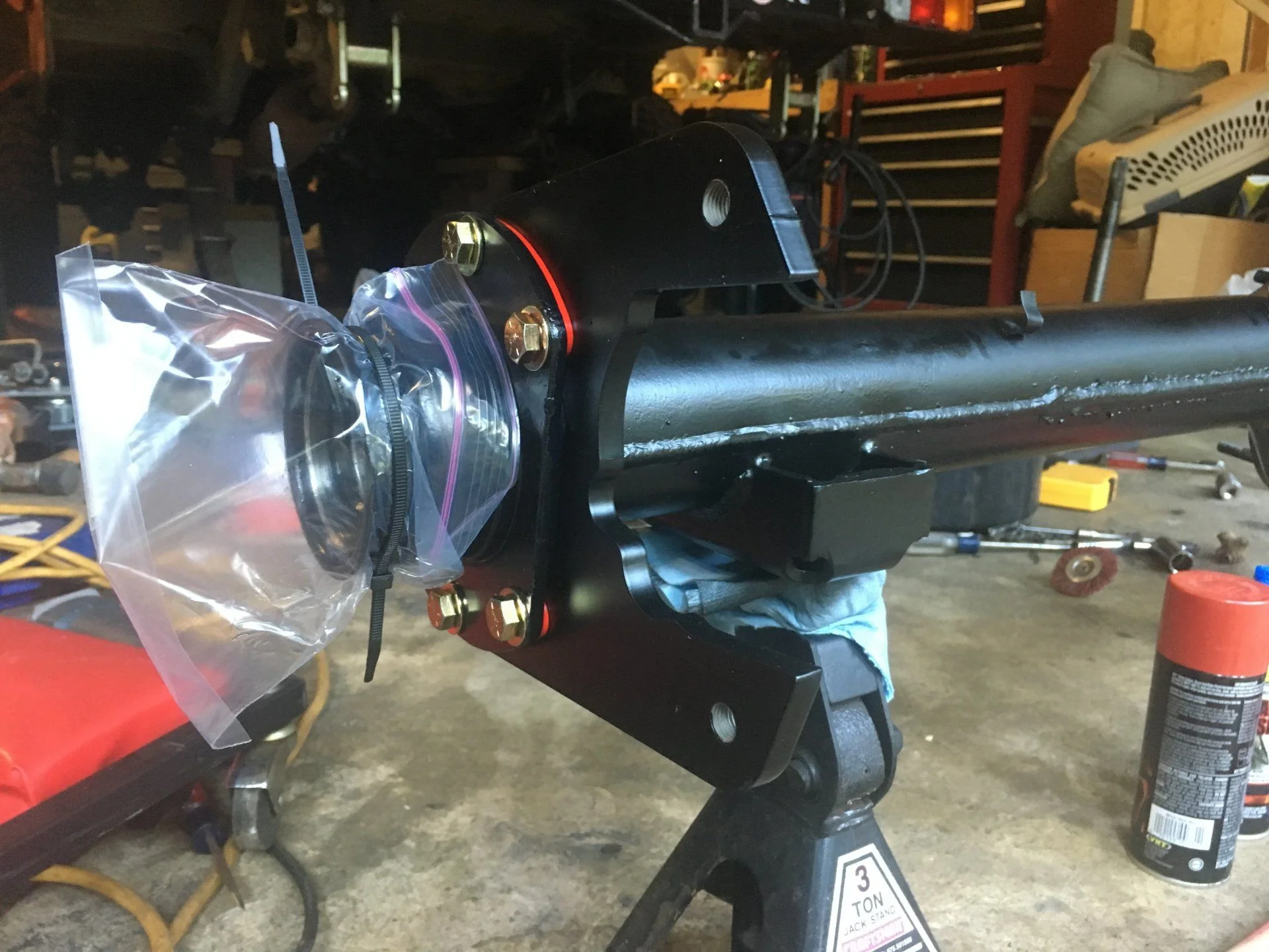

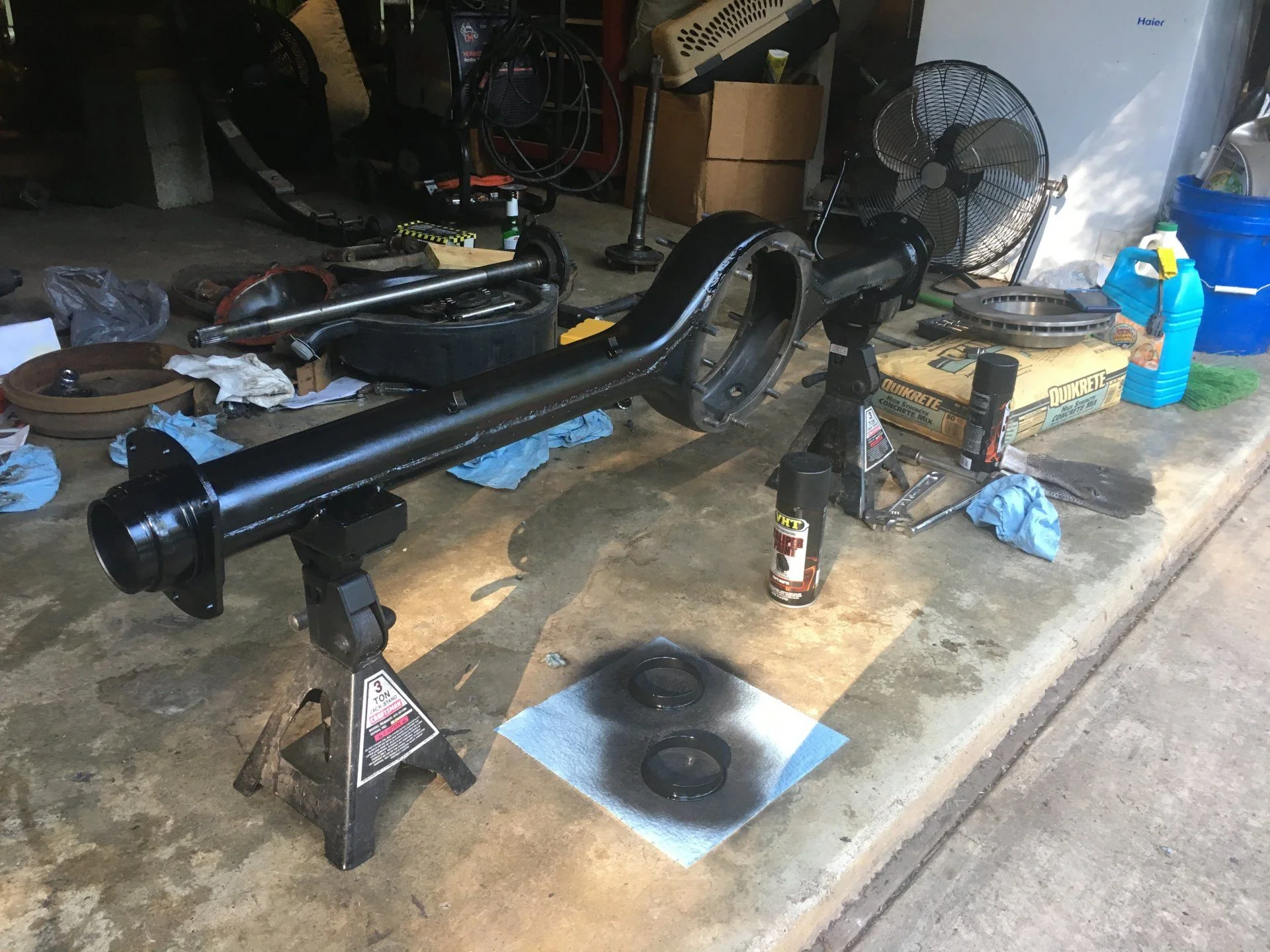

More cleaning and painting to get the axles looking good.
Also painting the dust shields that sandwhich to the back of the axle.
