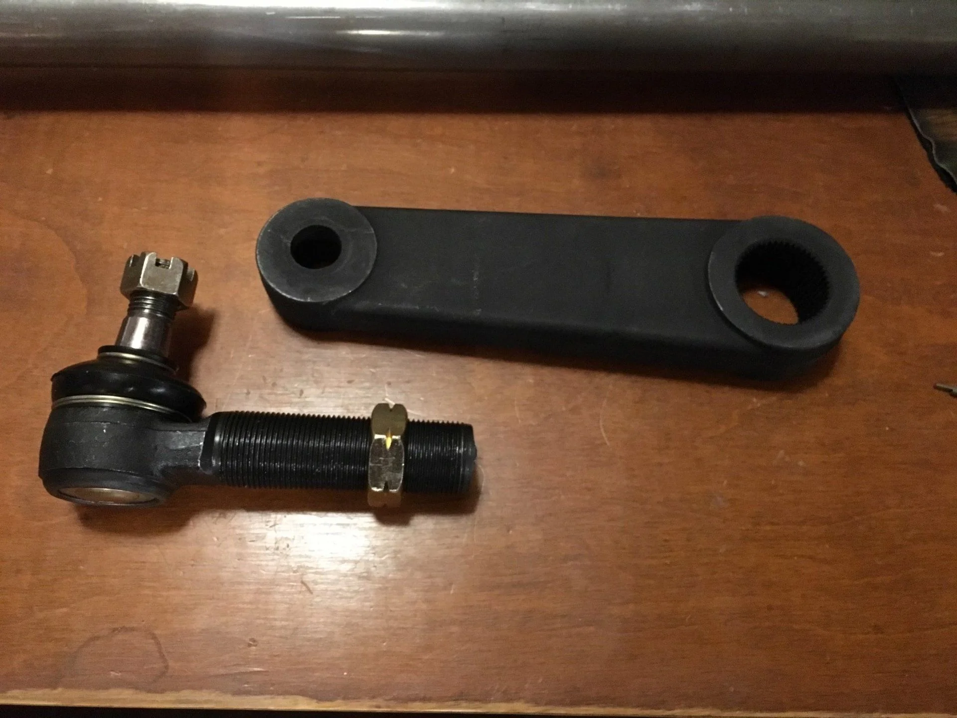

Also received the flat pitman arm and 80 TRE today.
Confirmed that the drag link rod I received is tapped backwards on both ends as this is LH threaded and didn't work either.

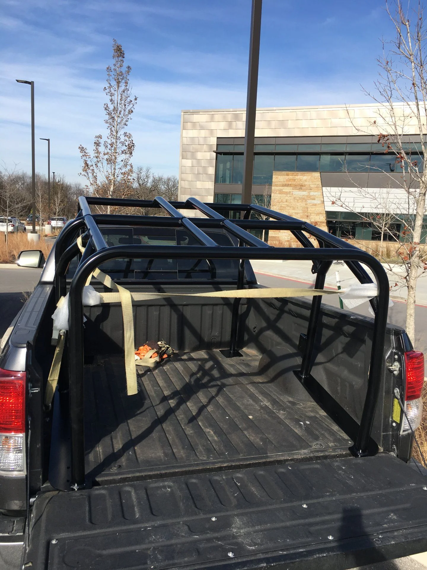

Picked up the MT cage at lunch today from the powder coater. Chatted with the owner for half an hour and I’ll definitely be taking my frame and maybe even the body here at some point. I thought it was pretty reasonable as he charged $200 to sand blast and powder the cage and it looks fantastic.
Almost too nice for my 40.

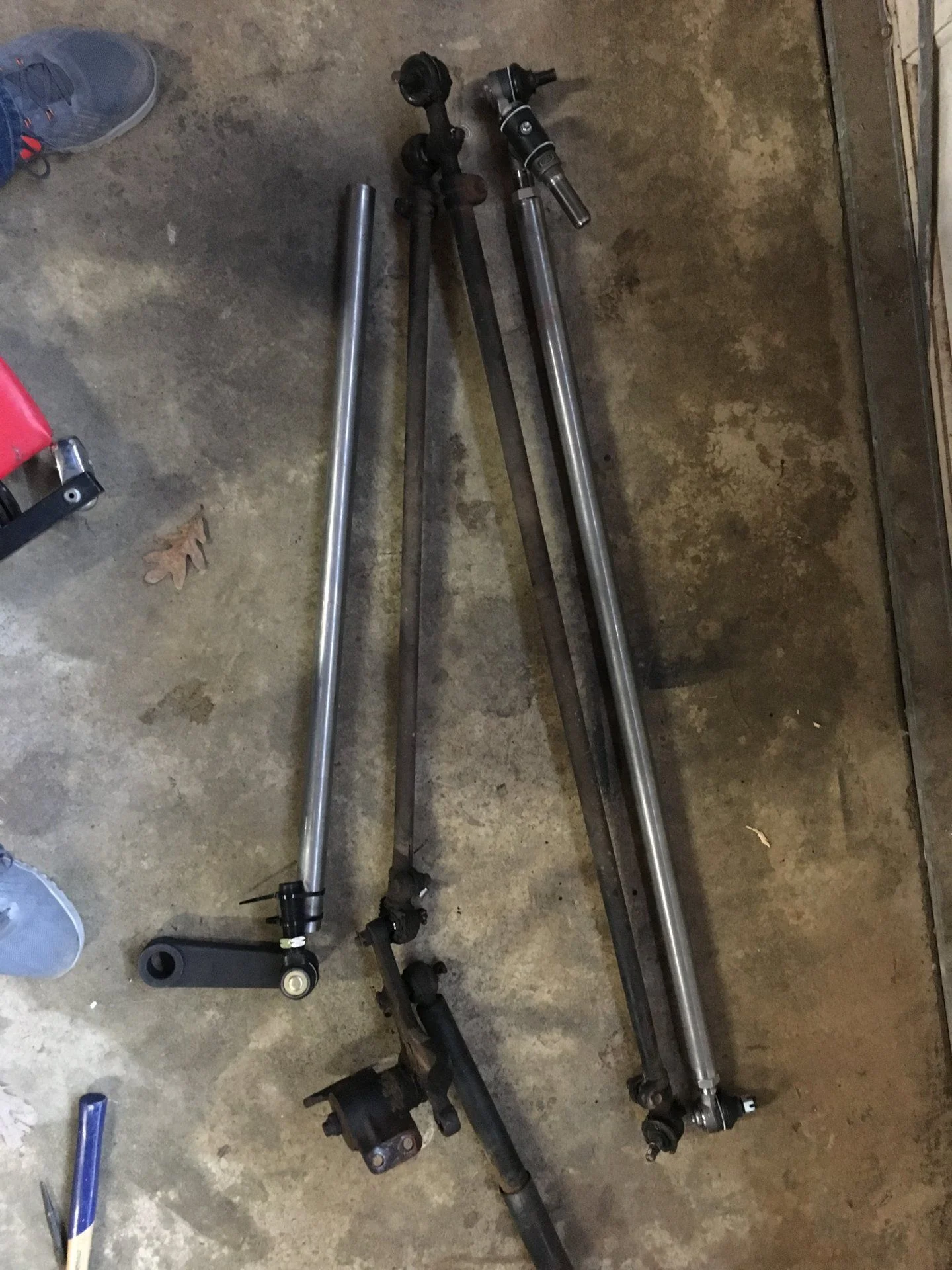

Started busting out the old stuff...and it fought back.

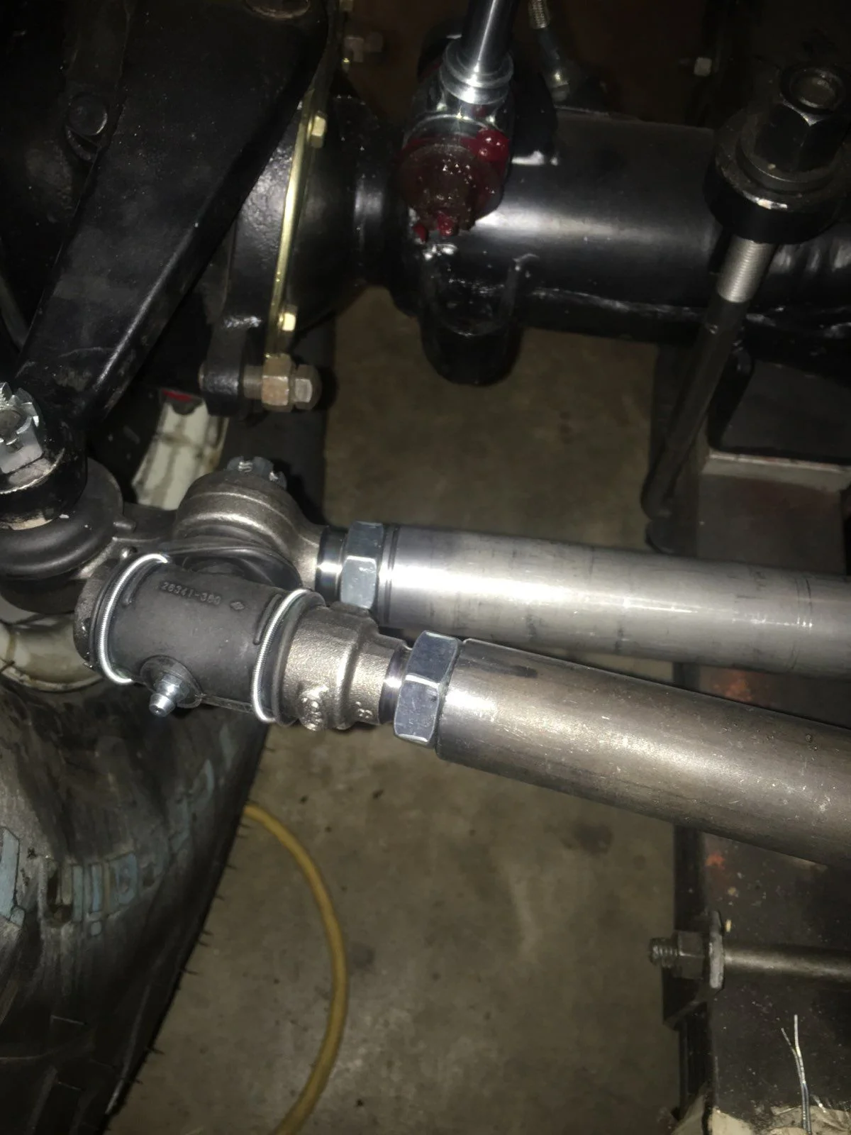

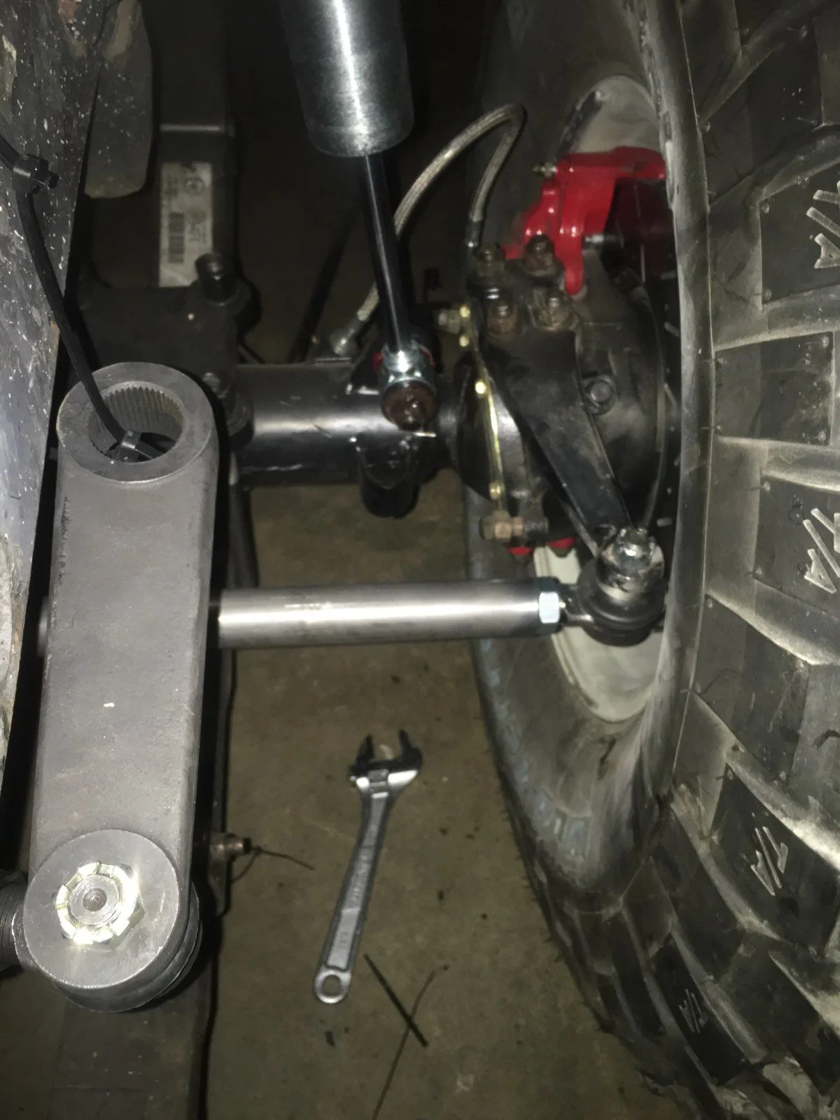

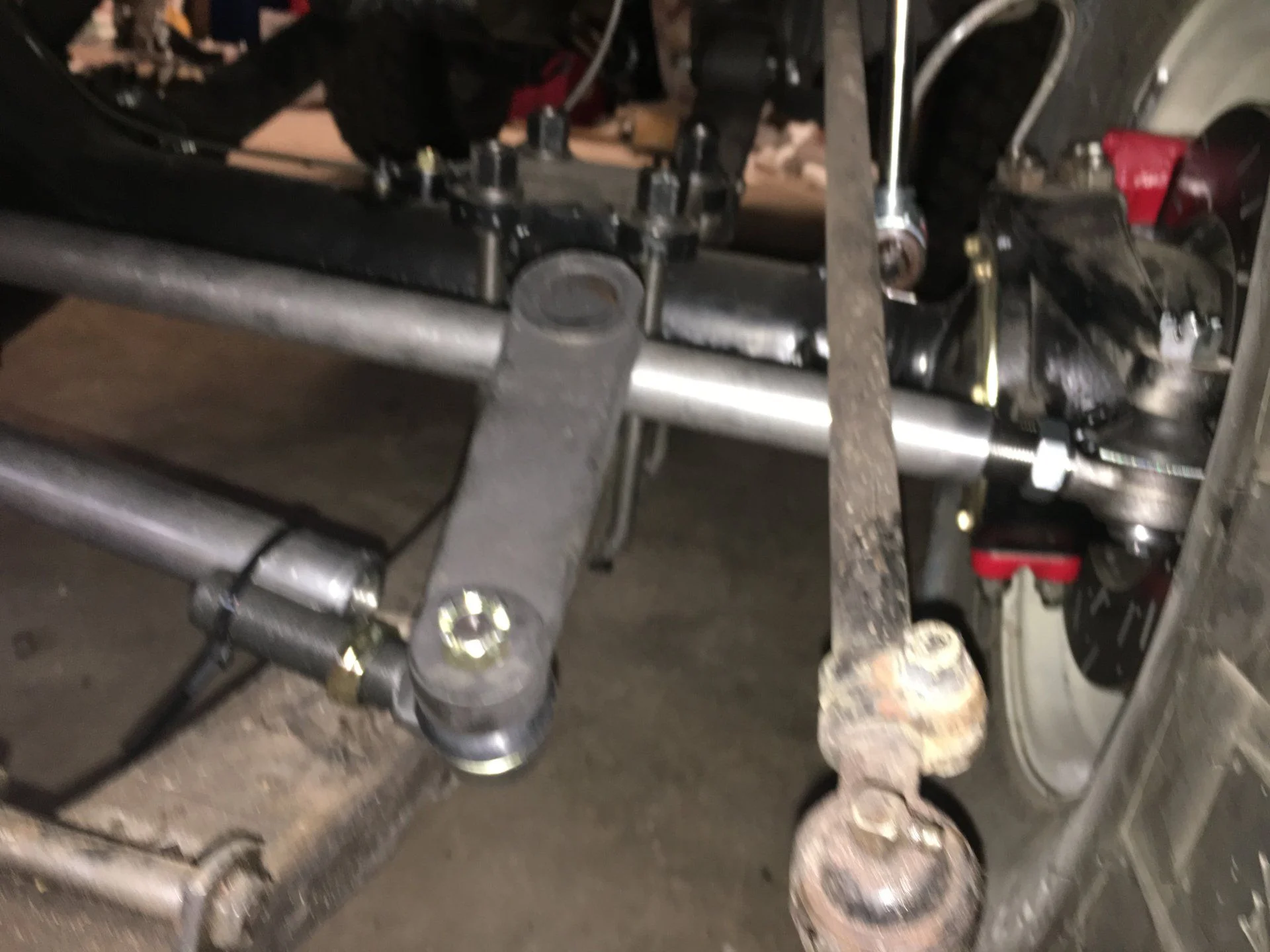

New rods are way beefier than the old set. Got the center arm off, but ended up cutting the steering shock off.

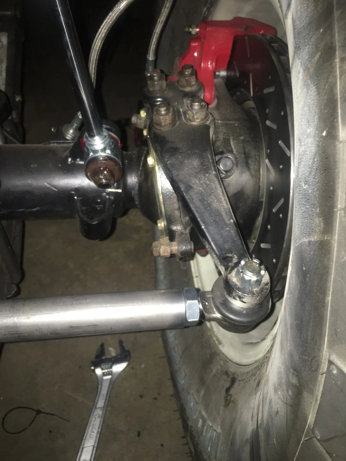

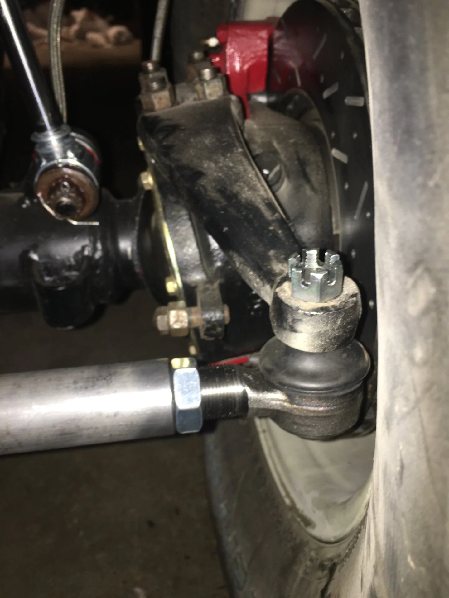

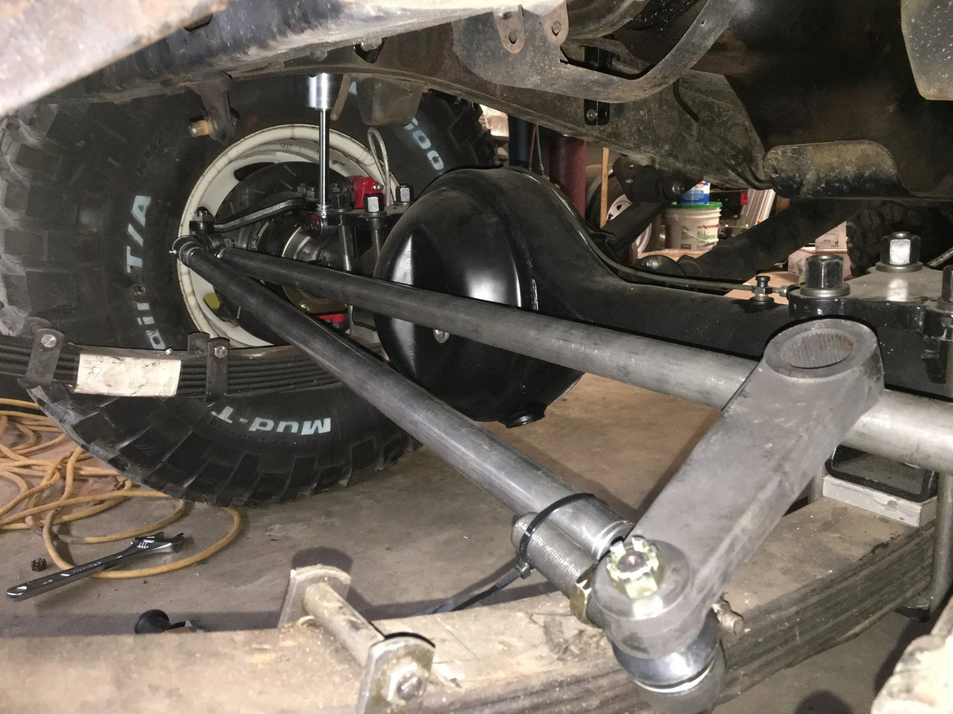

Got the bushings driven out of the steering arms and the new 60 TREs mocked up.
Unfortunately I’m not getting enough thread engagement (at least to my liking; less than 7/8”) with the tie rod. I’m going to ask IPOR for one that is 1” longer that’ll give me another 1/2” engagement on each side. Toe in was also checked and was roughly where it needs to be.
Next up I’ll be pulling my mini truck box and side drag link out and getting the new steering shafts in place.

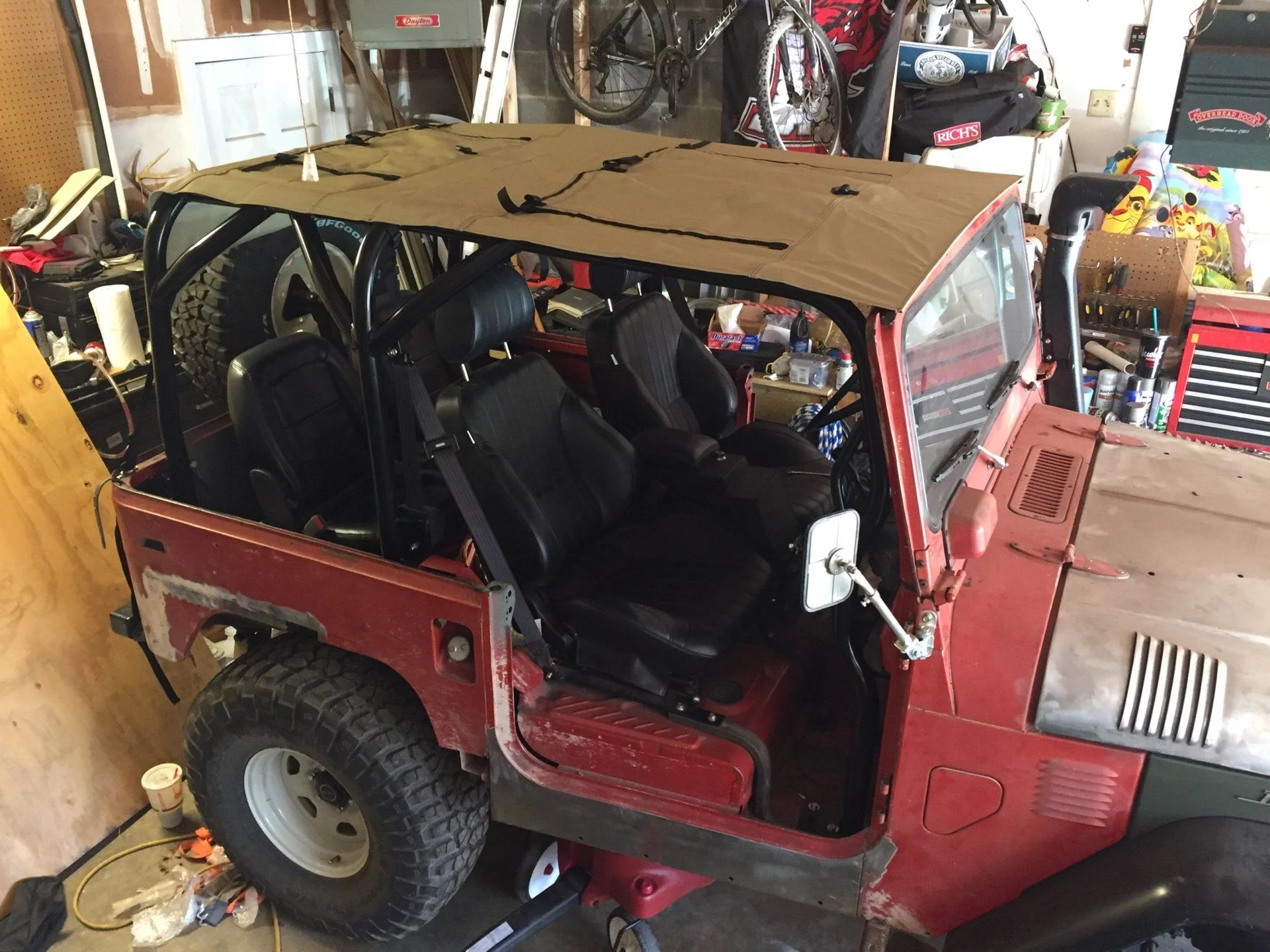

Question on your rear seats. What are they and any plans to run 3 point belts for your kids? Im trying to find a good option for shoulder belts.
@Varty Yo - Not sure if you saw the link I posted in the other thread, but more details here:
Pictures of your front seats on your FJ40
As for seatbelt options. At this point my boys are 3 and 1 so I plan on welding some anchor points to strap in car seats. I haven’t put too much thought into rear 3-pt belts yet.
Yes i saw that. My 1 girl is almost 3 and the other isnt born yet haha. Planning ahead i guess. I think the best bet is a anchor point to roll bar even though i dont really trust it. Cage might be best bet in the future
Big shout out to Lance at IPOR. I have to say I’m more than impressed with their customer service. They not only fixed the drag link with the backwards threads, but also sent me a longer tie rod after I shared my concern with thread engagement. Always amazed at how helpful the cruiser community is, especially all of the vendors.
Way better thread engagement now with the tie rod.
Now that I can thread all of the linkages together I started to mock up placement.

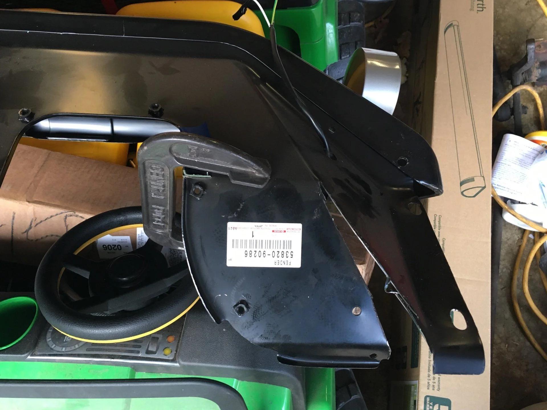

Now I know what Cheryl Crow was singing about. That first cut was painful to make on the NOS fender. I clamped a piece of flat stock to bender the flap out.
Once I get the box mounted I plan to weld some metal in the front and use the flap to cover the gearbox.

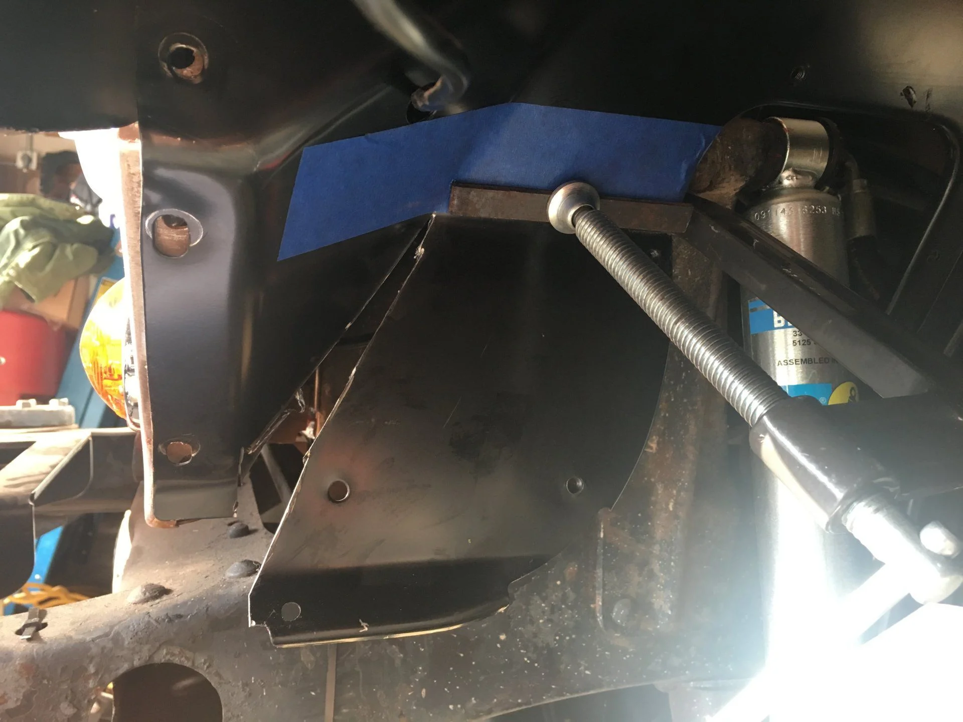

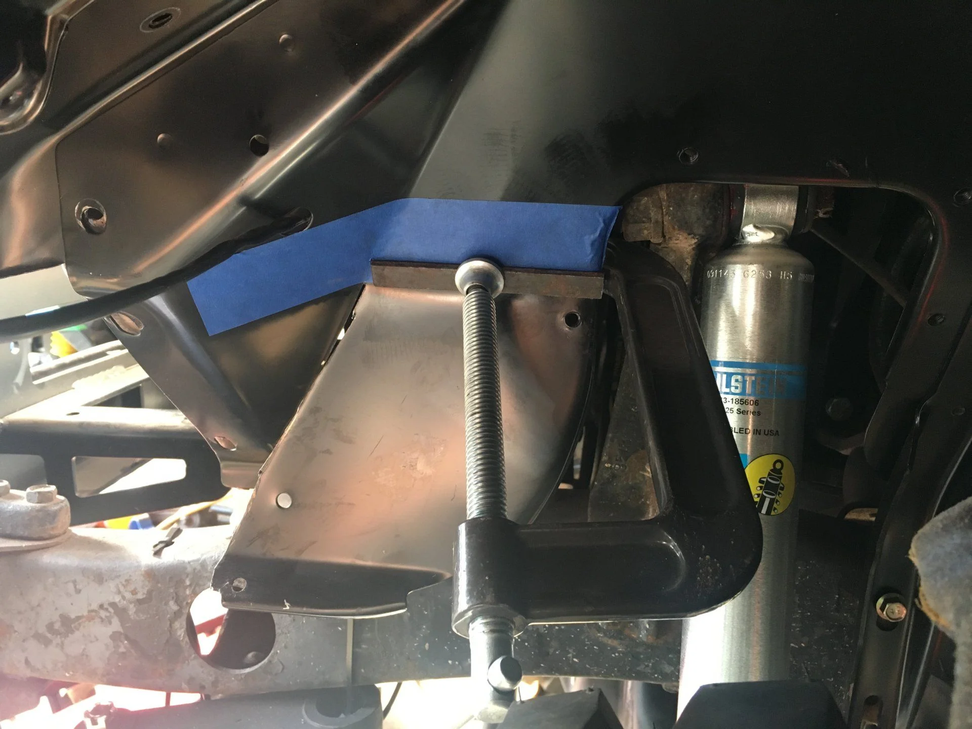

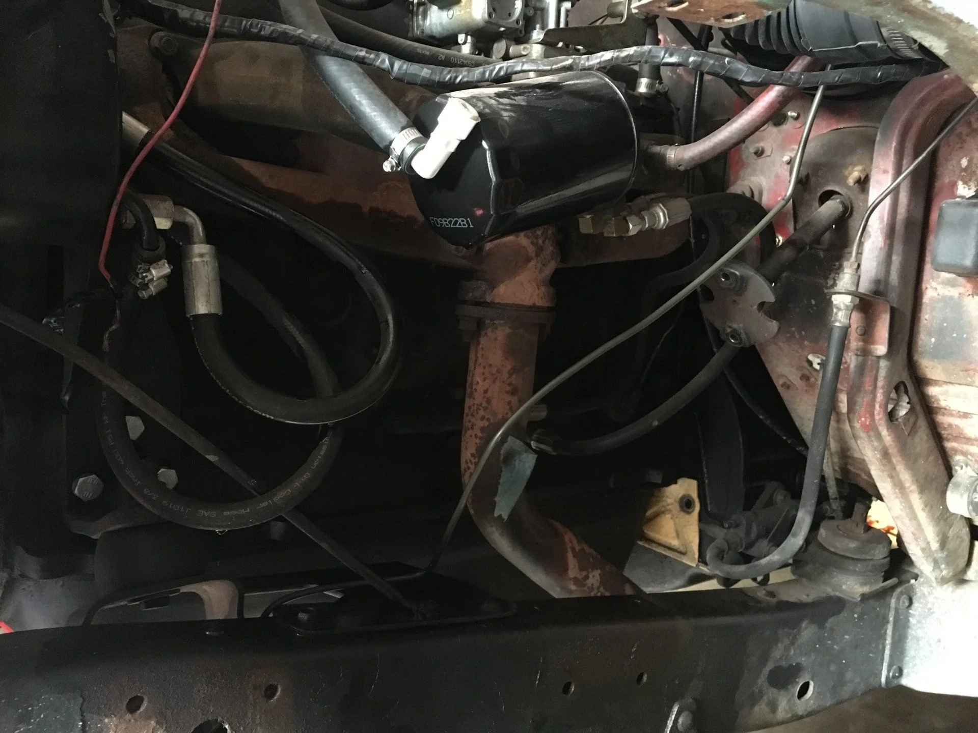

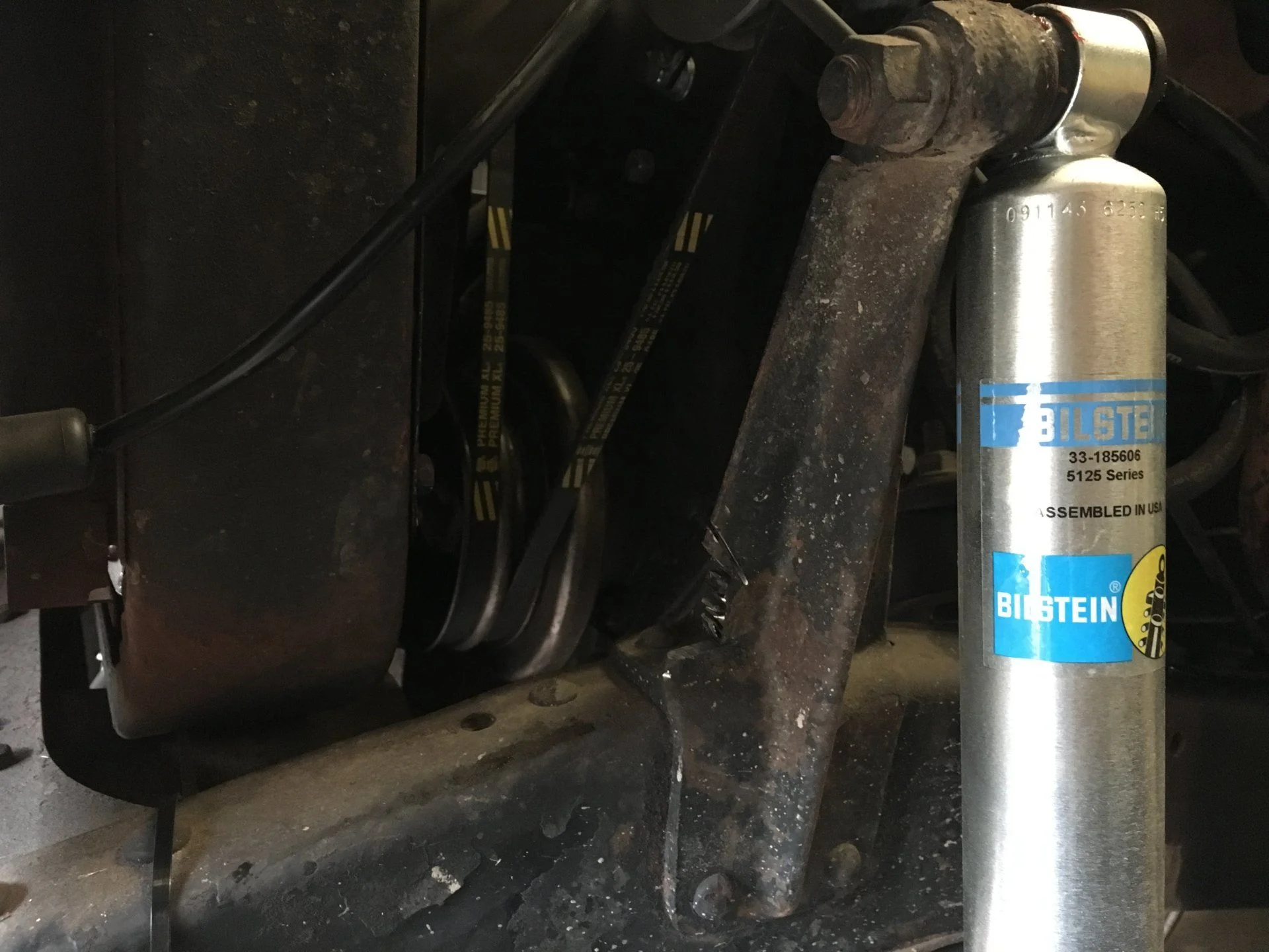

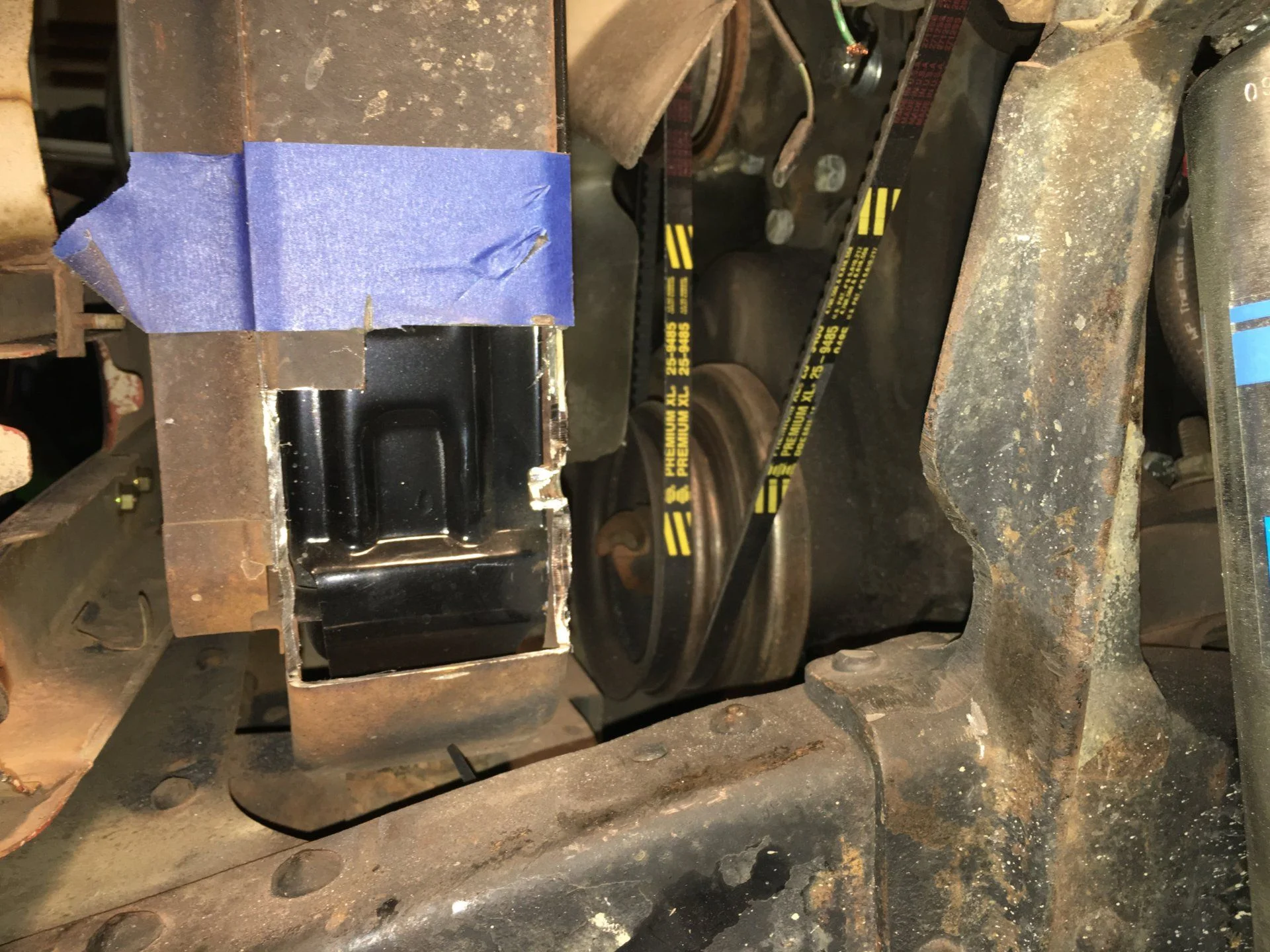

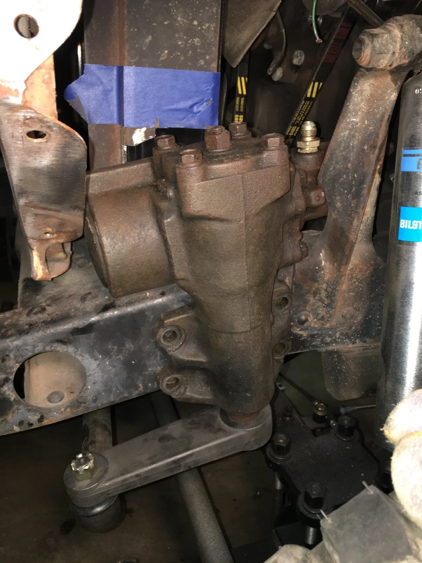

I started clearancing the shock tower and also the radiator frame. Once I get everything in place I’ll box in the radiator frame.

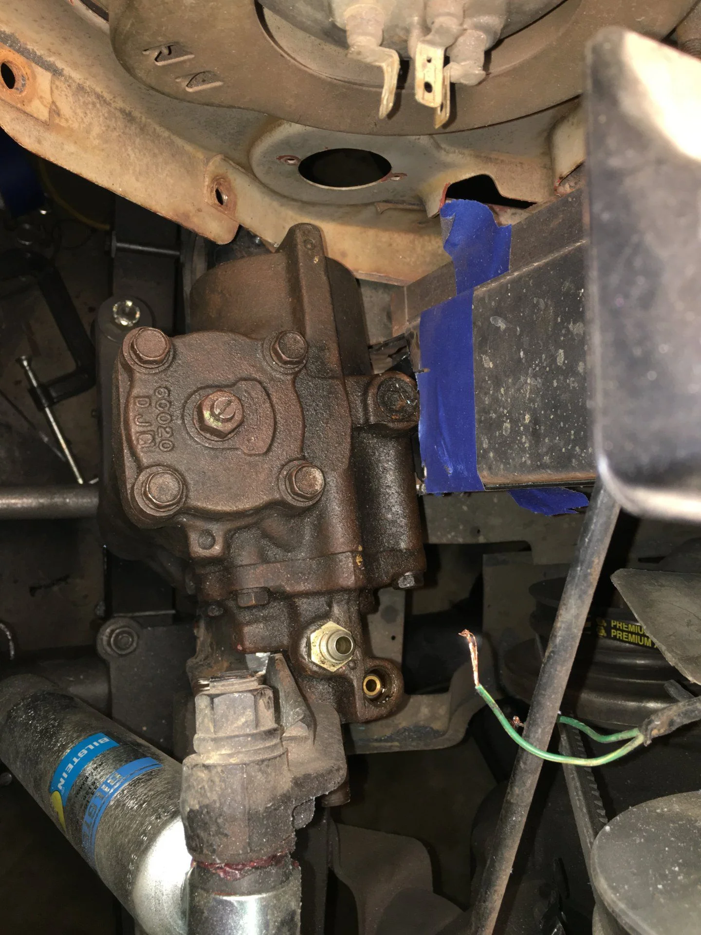

Almost have the box in place.
Tomorrow I’ll see if I can find anywhere open that has 1/4” plate so I can make a scab plate between the box and the frame.

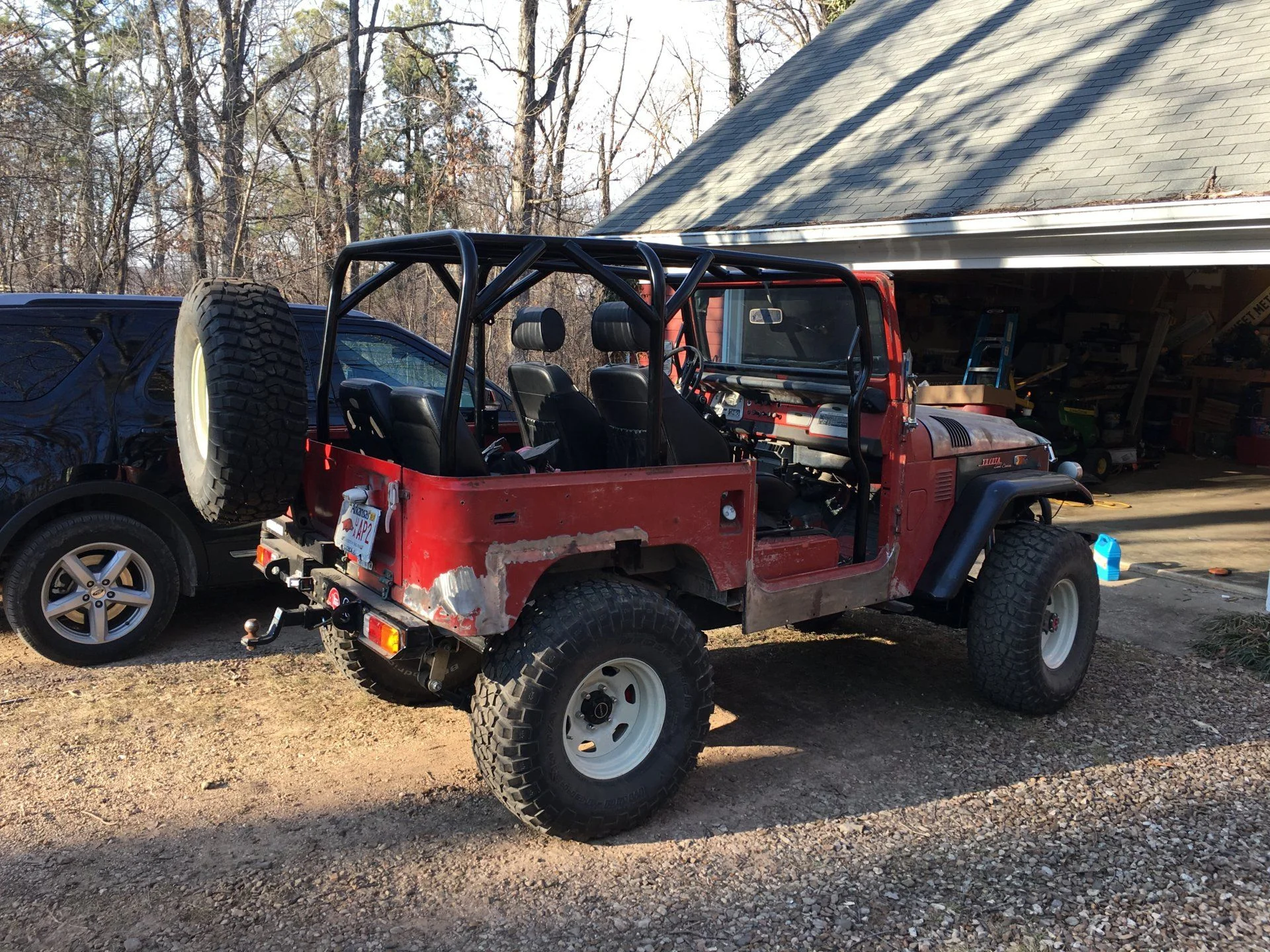

Also picked up a family bikini top to go over the new cage.

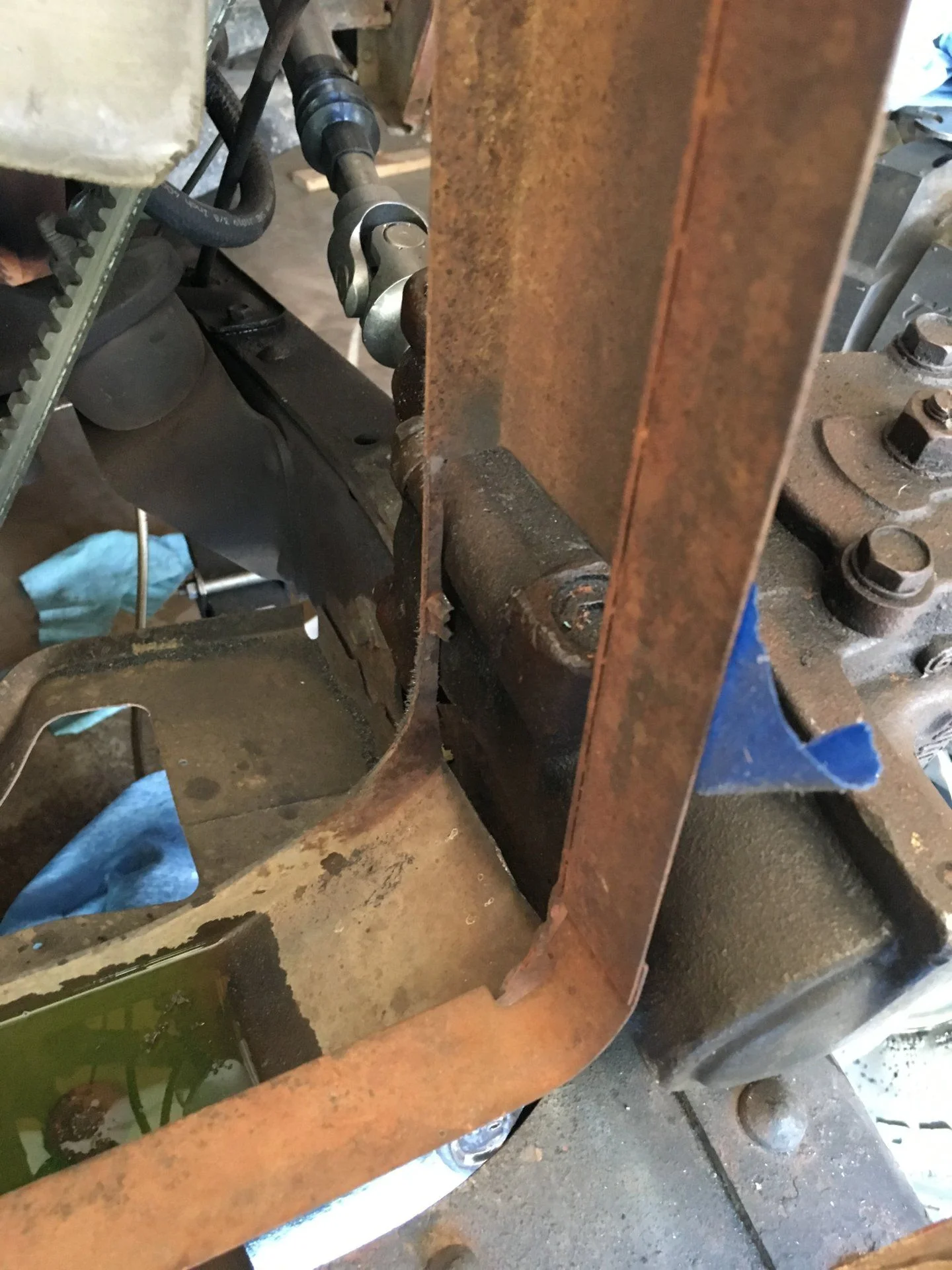

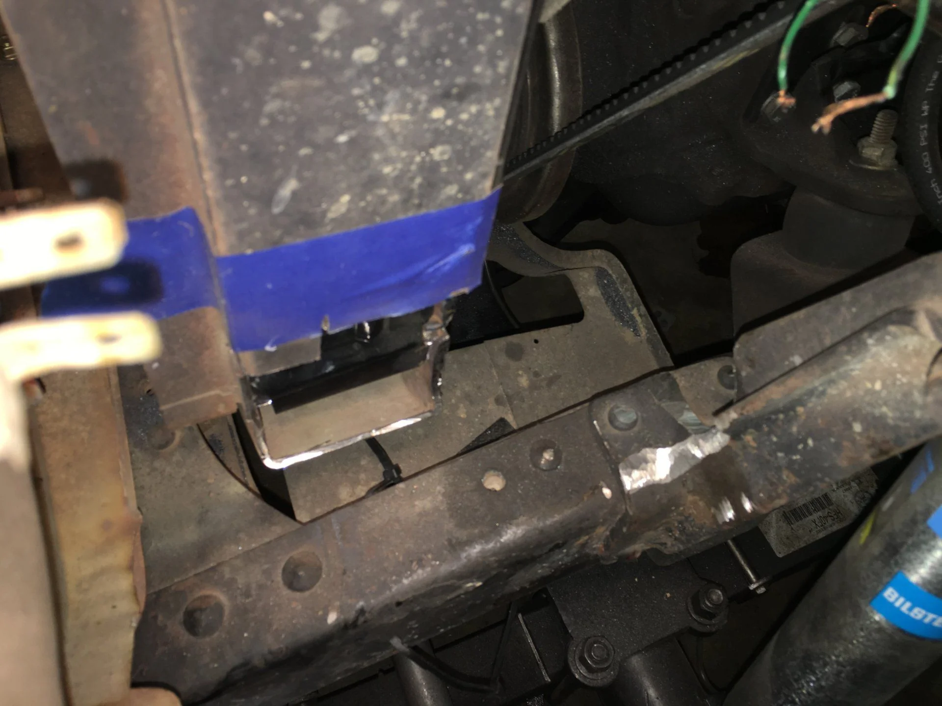

Did more grinding on the radiator housing. I’ll definitely need to weld more meat into the portion I cut out as there’s not much left after removing enough to get the box flush to the frame.

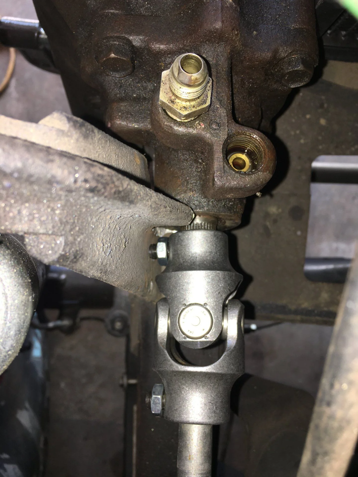

Test fit the steering shaft and U-joints. The set screw barely clears the shock tower.
Next up to drain the radiator and pull everything out so I can weld in the frame plate.
