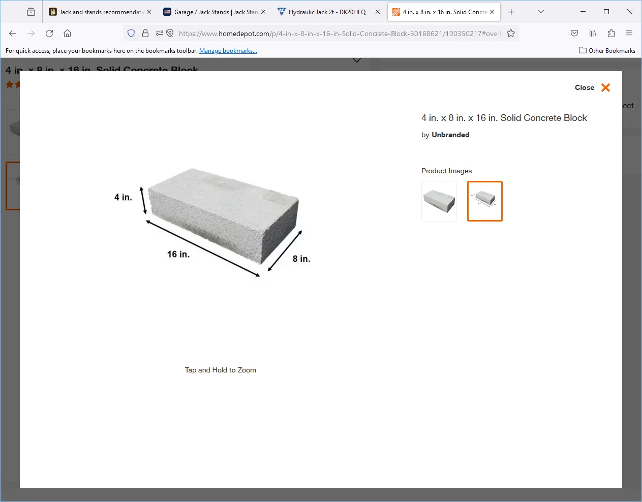

That was my idea as well and my friend said not to do that in case the wood splits apart
pressure treated 4x4 block has never given me any grief....sometimes i've slid a sold cement block under the jack

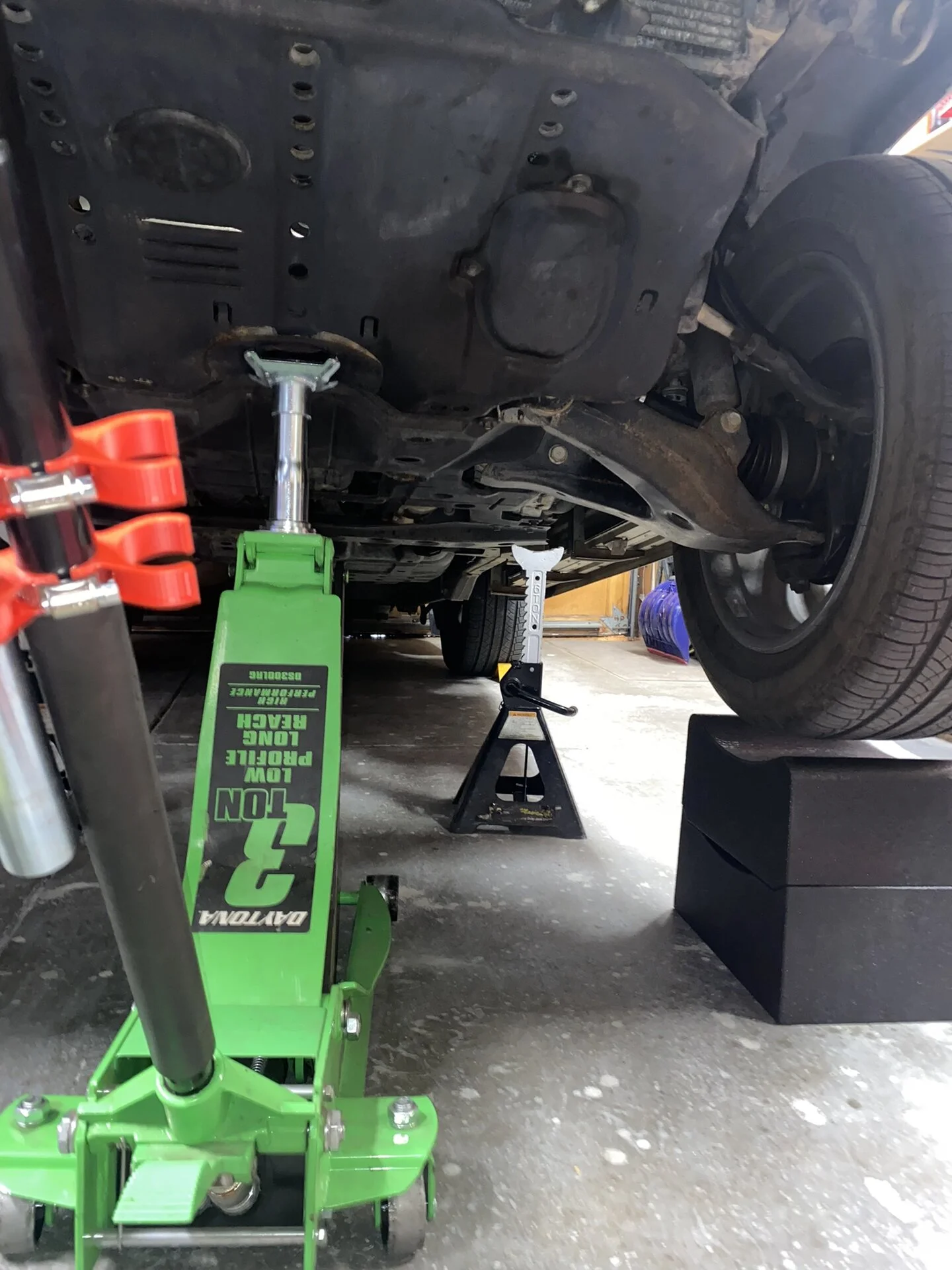

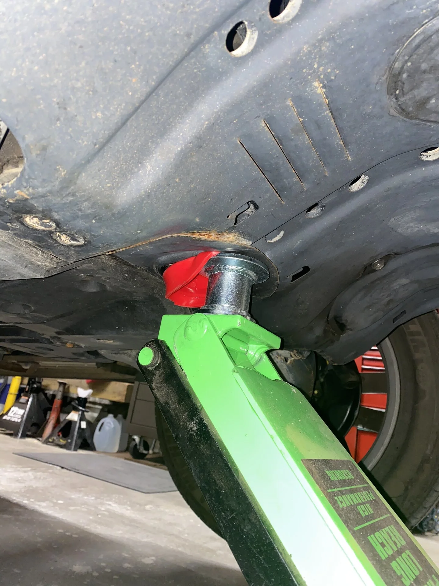

Today, I'm working on customizing my floor-jack. I'm adding a chunk of tire to a 8x10"jack saddle plate, I pick-up recently, form www.911motorsports.net

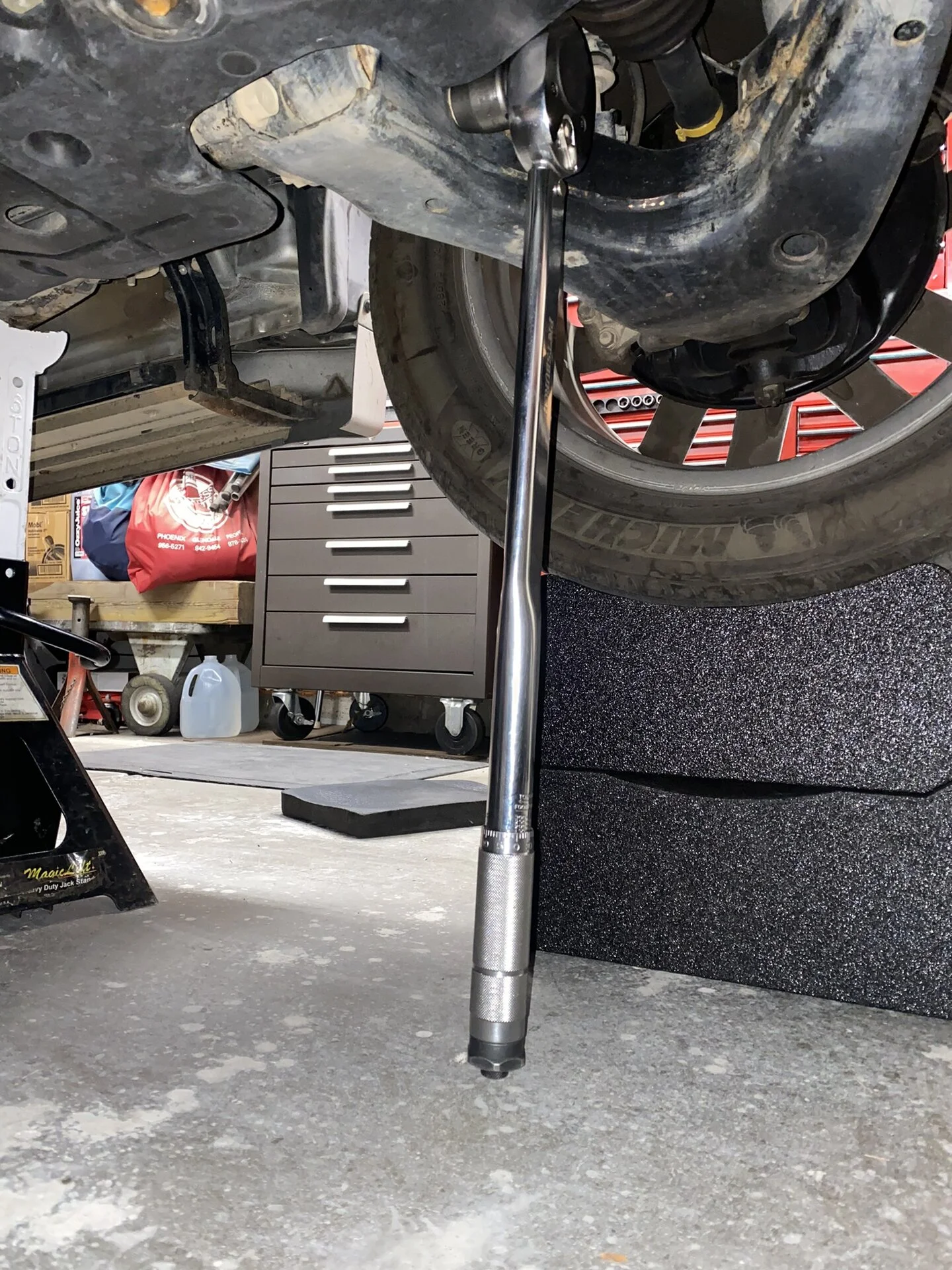

It used with the 911 floor jack extension pin, which replaces stock saddle. I was looking for extension to get front end high enough, to get tires more than 12" off the ground. So i can place RaceRamp under tires, for torqueing control arm bolts. I purchased an extension kit from 911 and a few accessories, last week. Which kit has a pin, square saddle, 6" extension and 11" extension. Accessories I pick-up are; a round saddle with 3 1/4" "Prothane" polyurethane pad, 8x10" saddle plate plus bracket to hold extension tubes on jack handle.

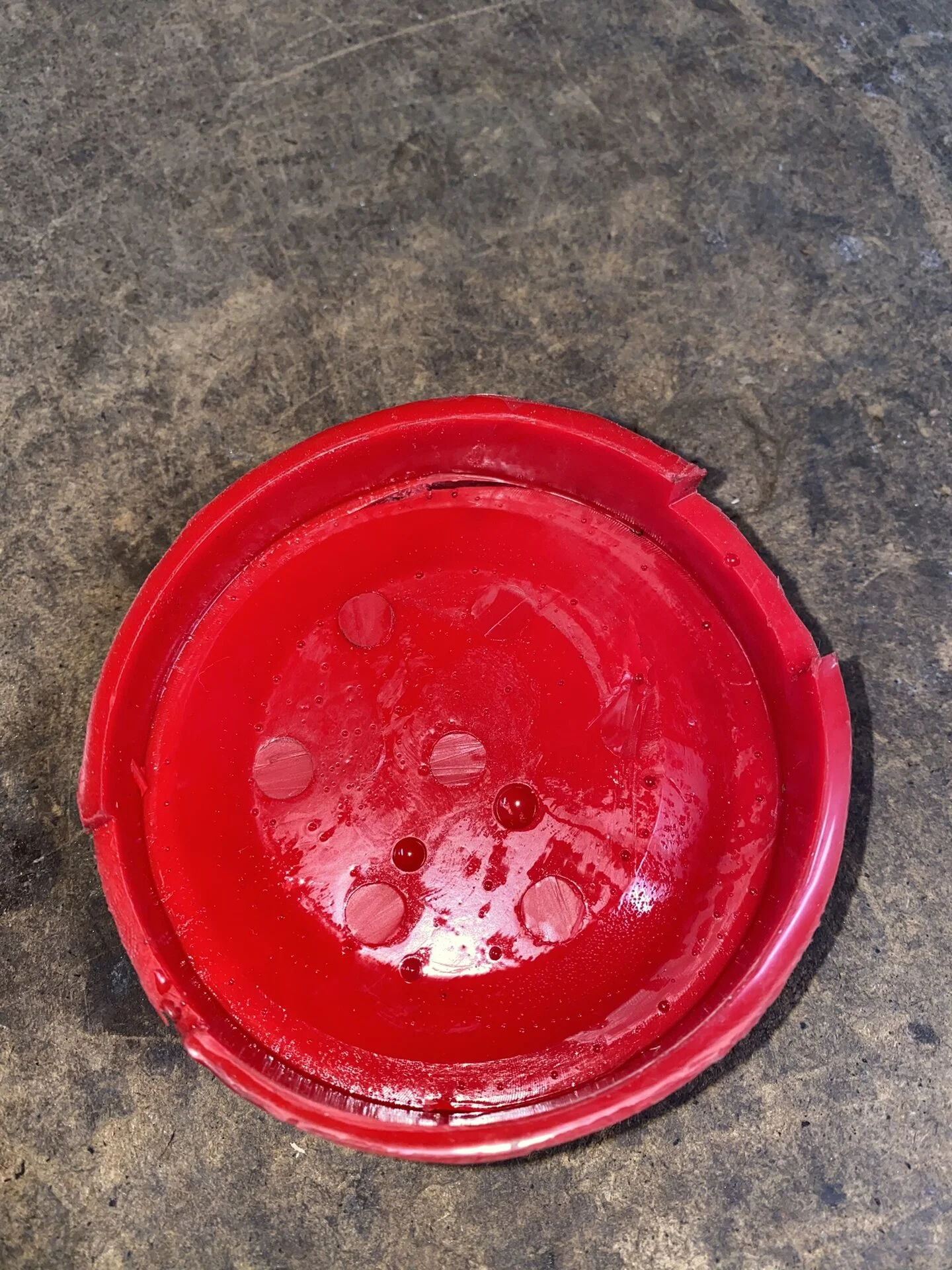

First use was with the round saddle w/pad under #1 skid. Prothane pad failed. Bummer! As we lift, vehicle needs wheels chocked, so vehicle does not roll. But as we lift vehicle angle changing, effectively pulls vehicle forward or jack backward. So it's important floor jack be parallel with vehicle and roll freely on concert floor.
A few words of caution. Any mod to jack even a block of wood, rubber pad or metal tube used to create extra lift. Increase the inherit risk associated with jacking up any vehicle. These implement can an do fail. Vehicle is more likely to slip of jack, when they're used. Also be very careful, to degrease any area used as a lift point. Also make sure to be on level ground.
With my new 6" extension on Dayton long reach. I was able to get my 12" of RaceRamps' under `31.5" tires, with skid on. I had only about 1.5" to spare. Each pump of the jacks handle to lift. I inspect jack, vehicle and extension for weakness or shifting. Higher we go, the more risk of a failure.
My jack 6" extension from 911, did the job. But the Prothane poly pad failed. As force of angle change, pulling at jack and vehicle during lifting. Rather than jack rolling back. Pad came off saddle, ripping it at its retaining cup of polyurethane. This damage the lift point of #1 skid, as weight shifted form centered of lift point, to front of skid lift point.
