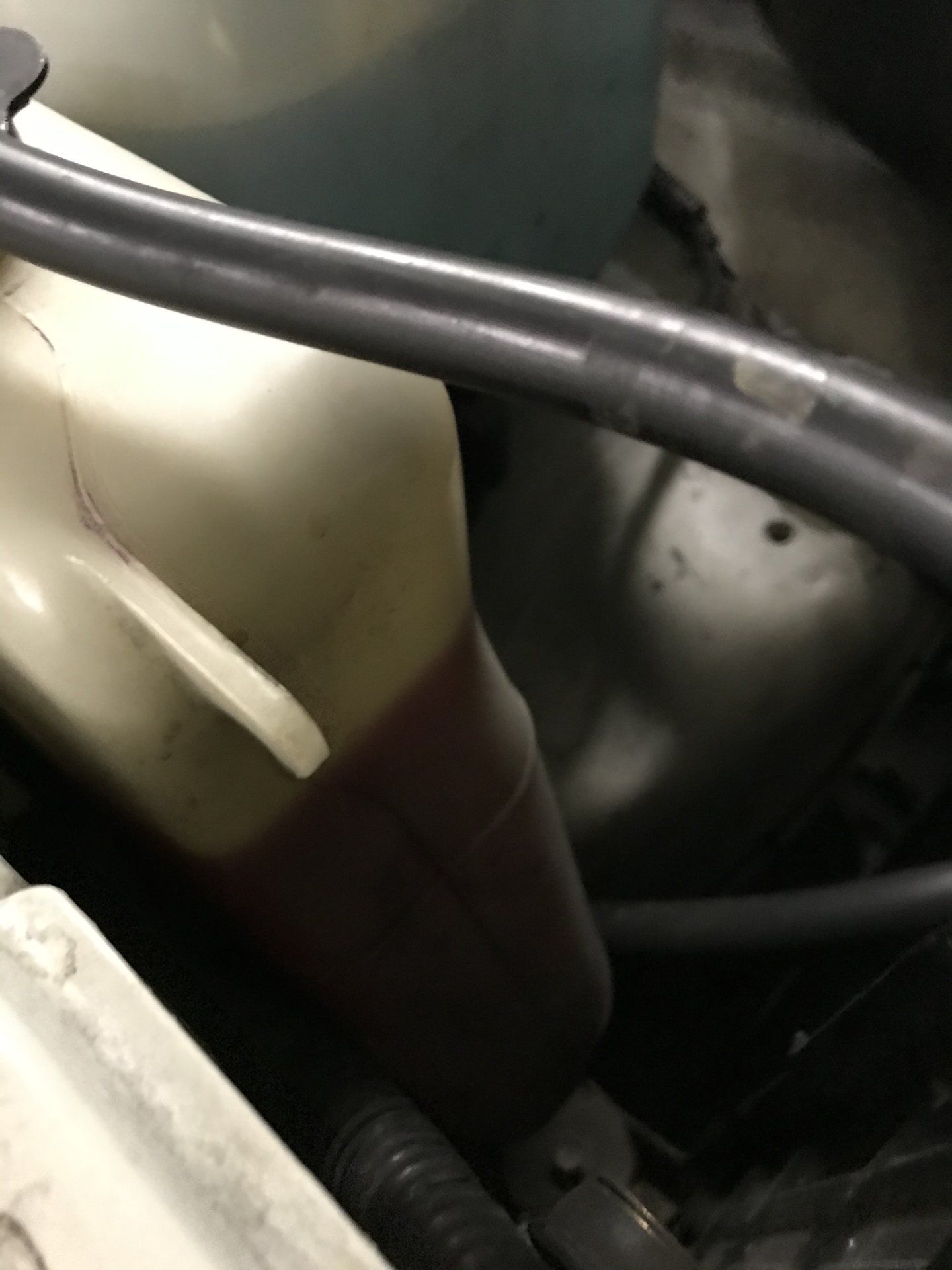

My coolant level when fully cold in the am is a couple inches above the low mark.
A couple of times this month I’ve found the cold level at a couple of inches above full. Random. Once I sucked out some coolant cold to get back to a bit above the low mark. Checked a few weeks later randomly in the am cold and it’s again back to well above max.
Any idea what’s going on?

Change your radiator cap and the hose from the filler neck to the overflow tank. Either the cap is not opening on the vacuum (cool) side or the hose is sucking clean air back in and not able to draw the coolant from the overflow tank back into the radiator.
Also check the orientation of the cap on your overflow tank. You may have the hoses reversed. The hose from the radiator MUST be on the same side as the hose that goes into the bottom of the overflow tank. If it is on the top vent side, then the radiator will push fluid out, but cannot suck it back in, thus resulting in a constantly "filling" overflow tank.
I'll bet if you check the actual level in your radiator you will find it low. When cold and off, it should be full right to the the bottom edge of the filler neck where the cap seats.
I'm having a hard time visualizing this. Can you please detail it out a bit further if it's not too much trouble?
Cap and rad are darn new OEM. IIRC, last time this happened, I checked under the cap and it was full to the brim. Will check again tomorrow AM.
Make sure your hoses are routed correctly.
Cap is definitely oriented correctly based on the writing on cap.
Looks like the hoses are all there except I am missing that vent tube for whatever reason.
My shop guy was kind enough to give me this cap, but I'm just going to order the whole setup new OEM.

When will I know the cap was the problem or not? I just put the new cap before driving out to grab dinner. Coolant level was topped off in radiator even with the tank well above high mark.
Checked just now parked / tank is still well above the high mark.
When the engine cools (to ambient temp) the radiator will create a slight vacuum that will draw some amount of coolant from the overflow/expansion bottle back into the radiator. You can use a black magic marker to make a mark on the coolant level in the overflow one morning before you start the vehicle.
Use that as a visual guide to confirm that you are seeing thermal expansion and cooling (meaning your radiator cap is working), but also insure that the cap on your overflow bottle is not obstructed (or the hose from the radiator to that cap).
