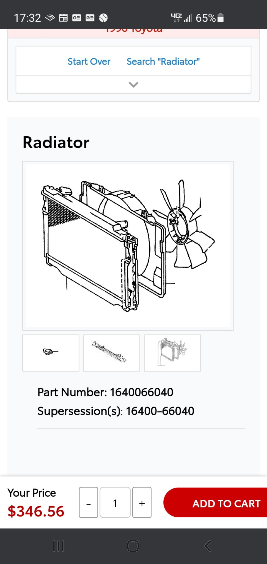

If that's part of the link you purchased from, it has the correct part numbers, and about the right price.
T-Rad is the OEM of these radiators and there should be a sticker on the top tank that shows that.

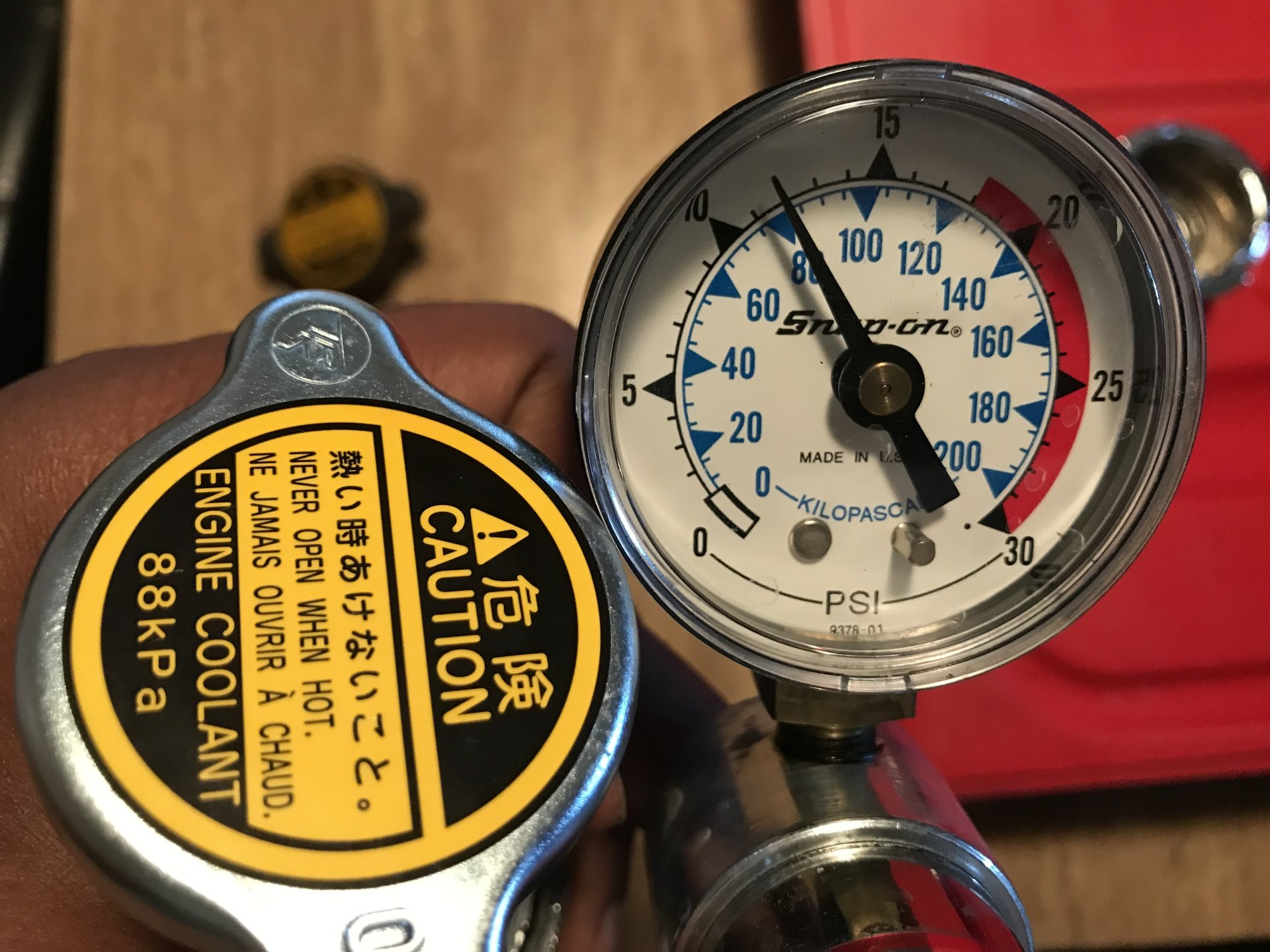

Correct cap:
Correct radiator with incorrect cap:
Looks like there are two part numbers for two rad caps that fit the 80?
16401-54750 (cheaper)
16401-15210
Does anyone know the difference between these two radiator caps?
Edit: I ordered both, took pictures (happy to post if there's any interest). It looks like the more expensive one has stainless steel construction. The presure ratings are the same. The cheaper one looks to be a plated steel, bluer color.
