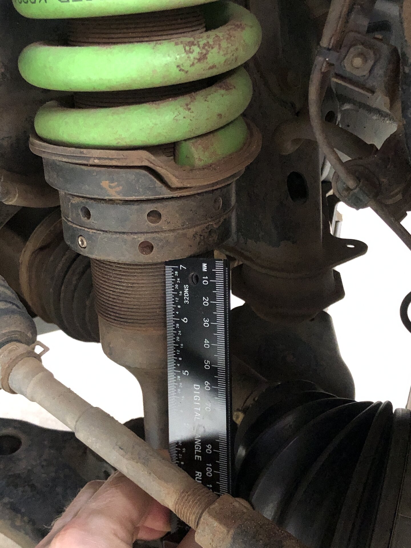

That's a good point. Looking at the pics more closely it looks like there's about 1/2" of threads below the bottom lock ring. But who knows what preload the pictured shock was set for? They might be shocks they assembled just for the pictures. If I ended up with 1.5" that'd be ok, I just want to stay well below 2".
I took your hint from the video and asked them if I can order it with the TOYO56A rear 1.5" rear springs (waiting for a reply). Thats still taller than I want now but maybe would be useful if I decide to go higher later. And not the 3+" you got. I'm not running much of a load in back and will have less when I remove the 3rd row seats.
If anyone wants to measure their FCPs available threads (with the 2.5" regular weight spring) I'd appreciate it.
