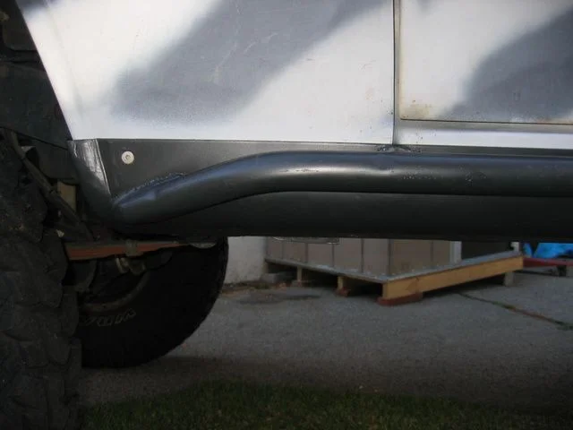

The Clay I am talking about owns several Toyota dealerships in the area. He isn't really big in the Landcruiser circles, but his 55 was built sparing no expense. Unfortunately Clay had picked up his 55 before I had a chance to get any photos. I dug through the old posts and found a bad shot of Evans 55. He took a very different approach when attaching the rocker reproductions. He just overlaid the 3/16" reproduction over his old rockers and then ran runners back to the frame.
attachment.php
This wasn't the way they were intended to be used, but it turned out very nice.

so from the pics it looks like this is a somewhat different than what is there stock? Do the rockers ipor sells have the lip front and back for the fender flare. I am really trying to do a restore so a modified rocker I am not interested in. Does anyone have pics of the bare rocker they sell as it sits out of the box? I would want something that looks stock that I can but weld in there and grind smooth so it ends up being stock looking. I also need to do some more digging into my truck to see if the rockers are necessary BUT for the price and if they are truly a stock look, I will buy a pair. Anybody with pics would be appreciated.
is this what they look like out of the box, with the lips all done, or is that needed to be done by the end user?

The IPOR rockers don't come with a front or back flare. They look like stock when fitted up but we cut the flare off the removed part of the fenders and welded it to the rockers to make it look stock.

They will not have nerf bars, the only part that is included here is the actual rocker piece that you see on the outside. The inside is NOT included and neither are any nerf bars.
Lance explained the install to me and basically (as far as I understand without seeing them) you use box tube across the two sides that are towards the inside of the truck, then weld these to the exposed edges and close up the ends with sheet. Effectively taking square tube and making 2 sides into one curve that mimics the stock rocker.

Mine came already closed up and we just cut and welded the nerf bars on after the rockers were installed. One trick, When you cut off the old rockers, try to save the mounting tabs which are attached to the frame. They'll help ou line up the new rockers.
IPOR sliders
My mistake, the tabs are attached to the floorboards--not the frame. Sorry
