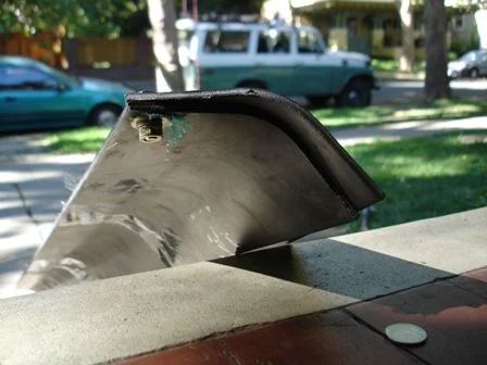

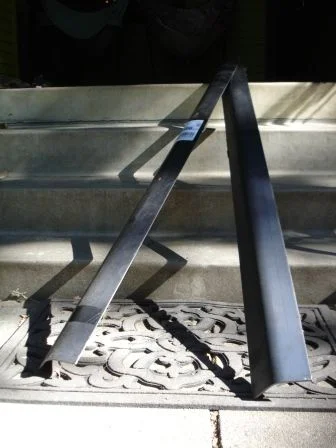

Okay how about a pic of what they look like?
Here's a couple:

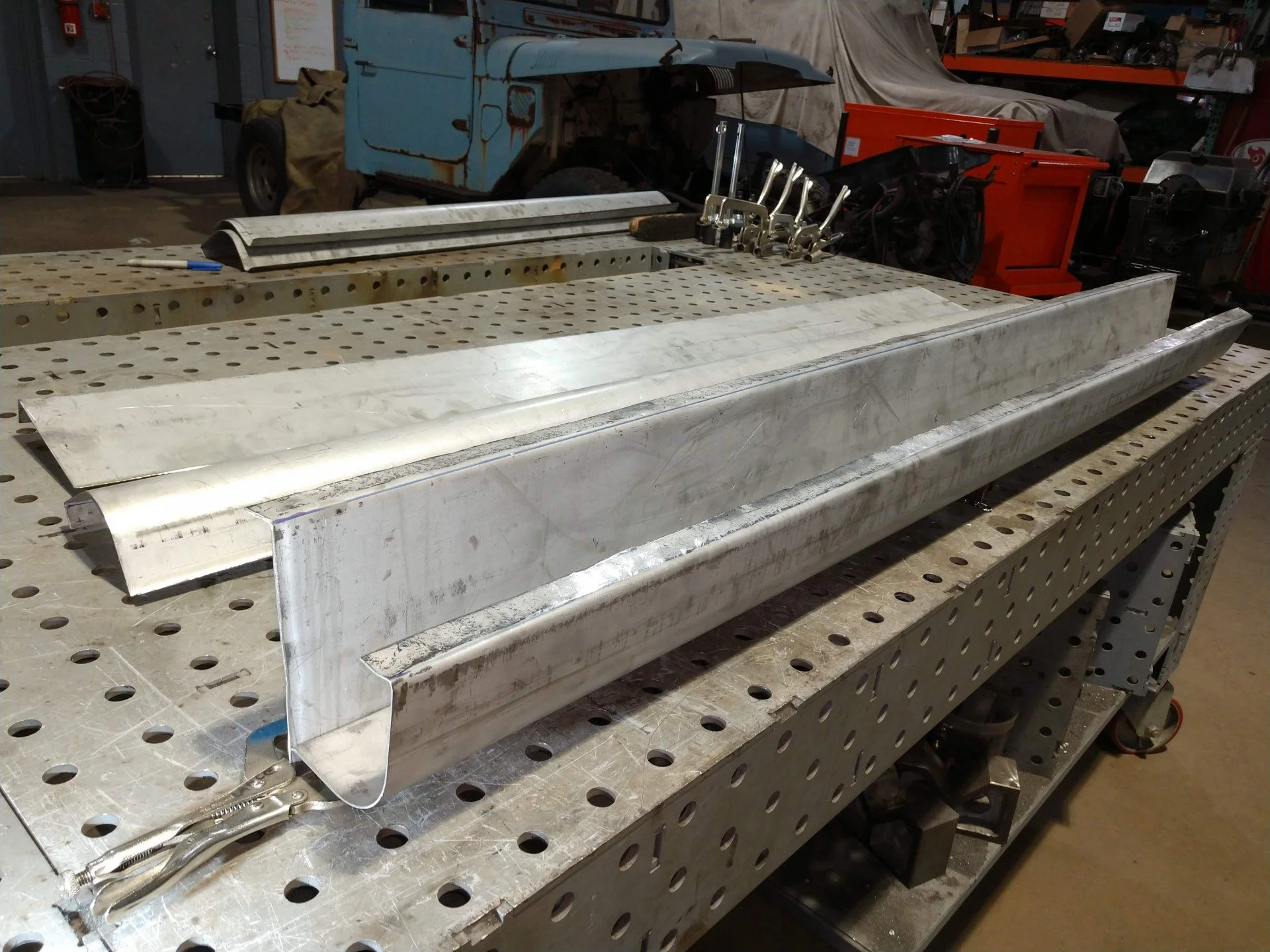

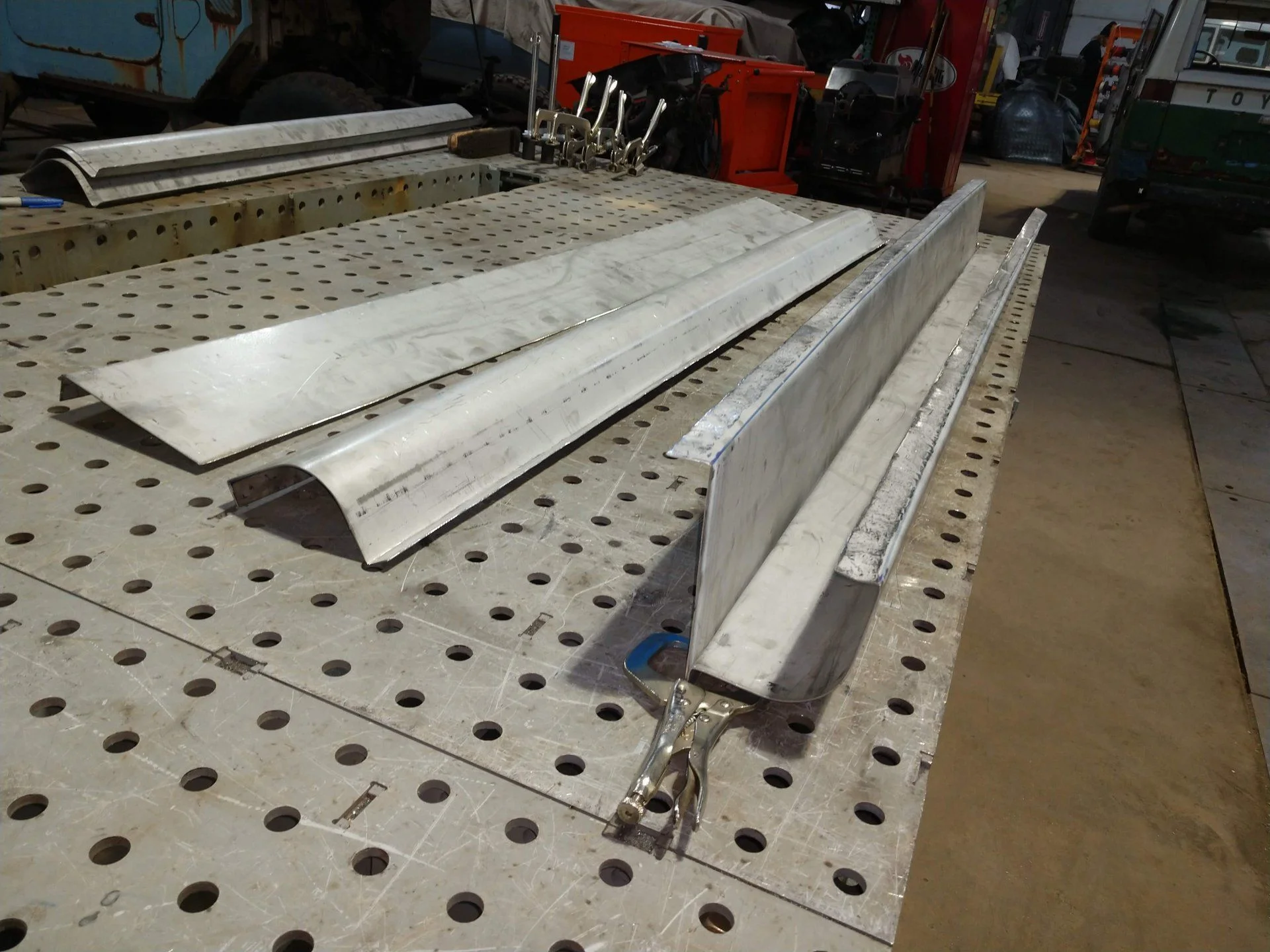

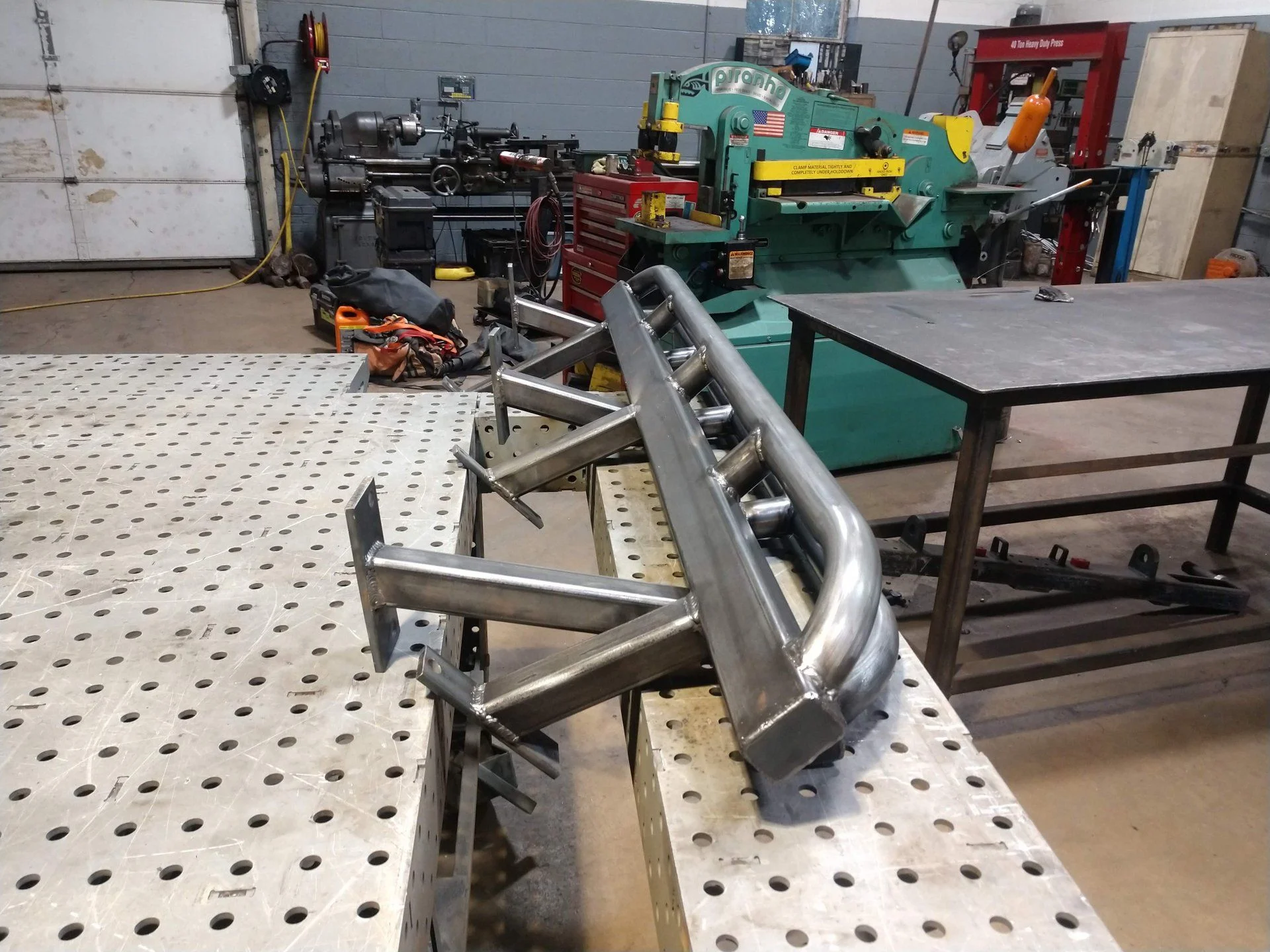

I don't have any more of the 3/16" outer rocker panels left but I just built a die to stamp out Galvannealed 16 gauge rockers.

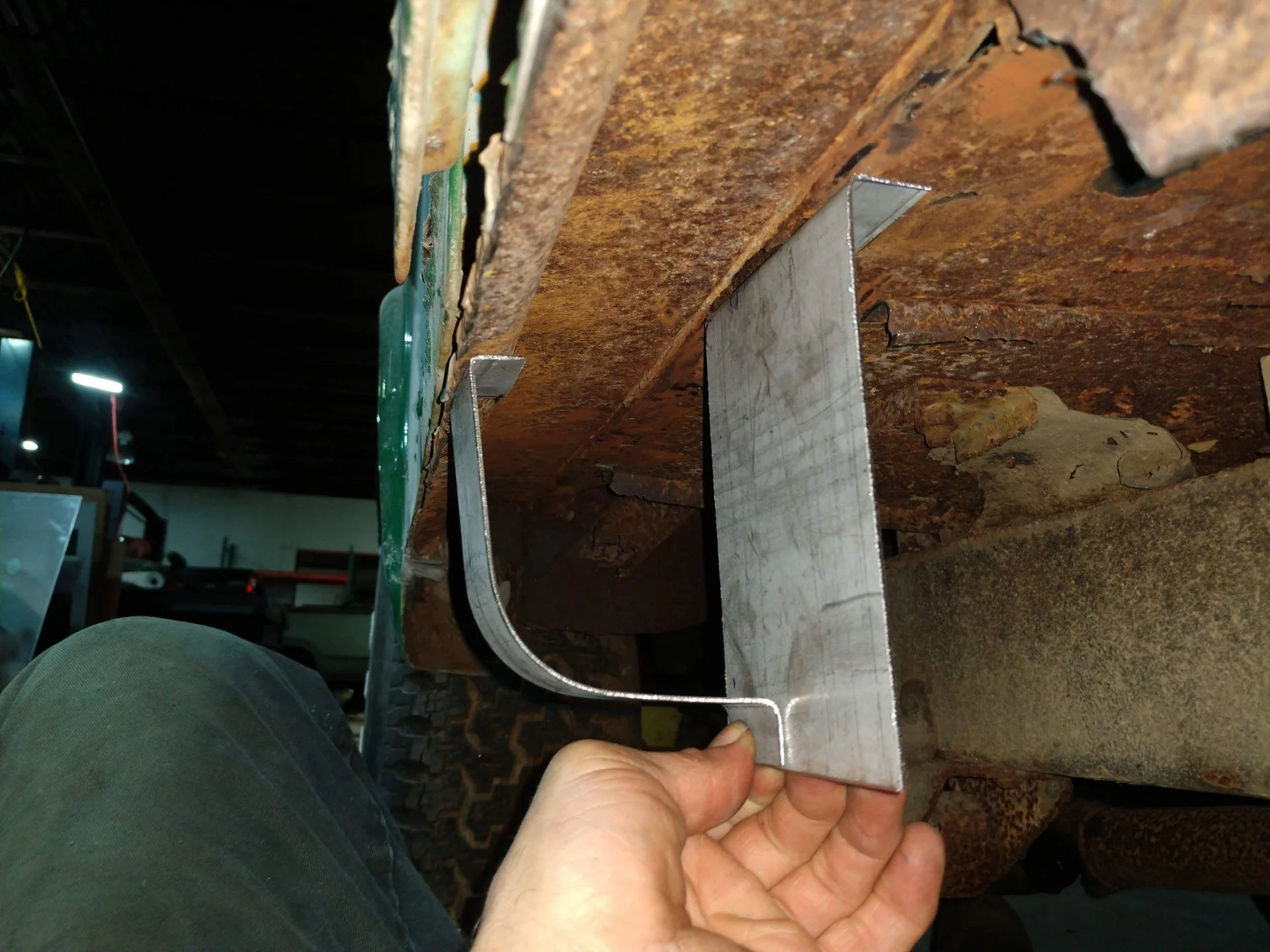

Here's a cut away showing how the pieces go together.

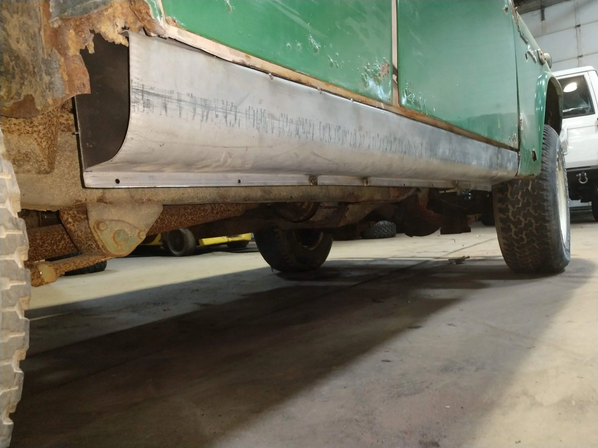

And a rocker tacked into place. Obviously most 55's need some additional sheet metal work like our project truck.
LOL. Yeah, Iron Pigs are still my favorite. I wish we saw more of them. I sold my favorite 55 a couple years ago and all I have are these rough beaters that I keep around for mock up and things. I have one set of rockers on hand and one set of rock sliders - just made some for a customer so I made an extra set just to have them around but I can make more - PM me or email us info@ironpigoffroad.com. I'm busy working so I may not catch a PM right away but I'll see it eventually. :pig:
