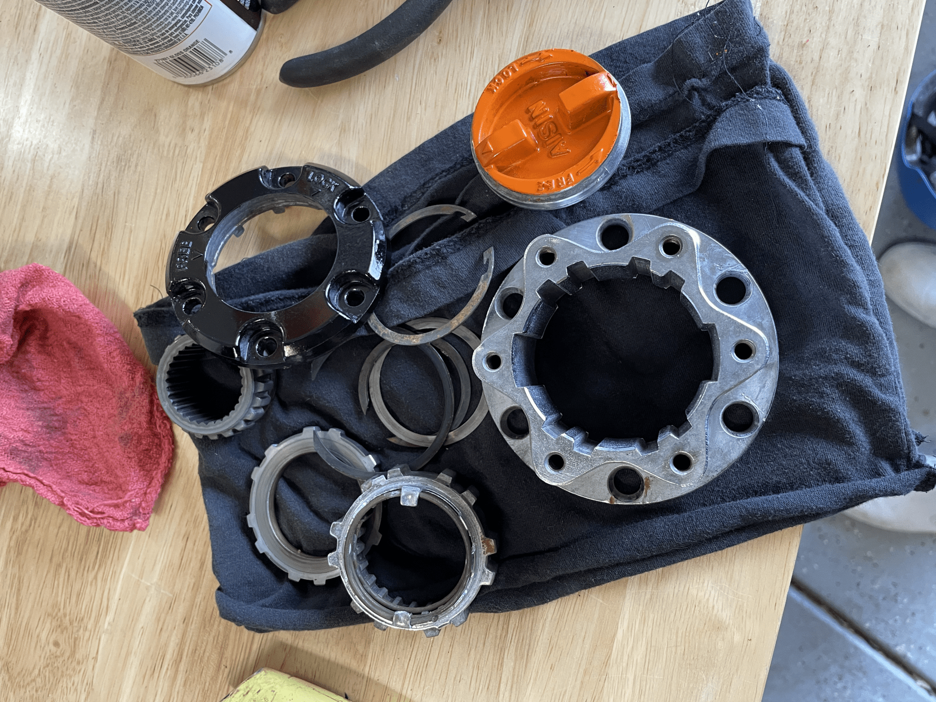

Next, my one of my freewheel hubs would not turn, so I rebuilt both of those. That was a fun little project.

I’m about to refresh my hubs too.
What color paint did you use for the free/lock selector?
That’s just a rust oleum gloss orange that I found at autozone. The cap looked closer to the original color on the hub, but it turned out much brighter. It’s ok I kind of like it.
