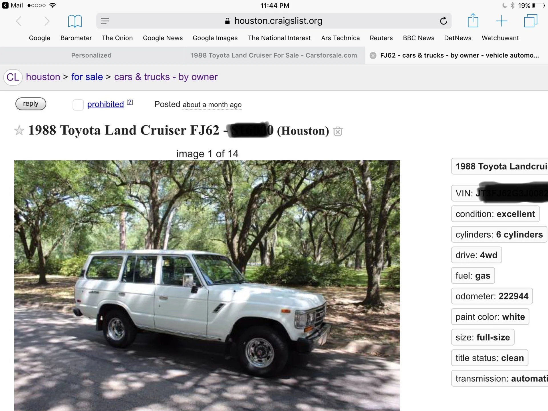

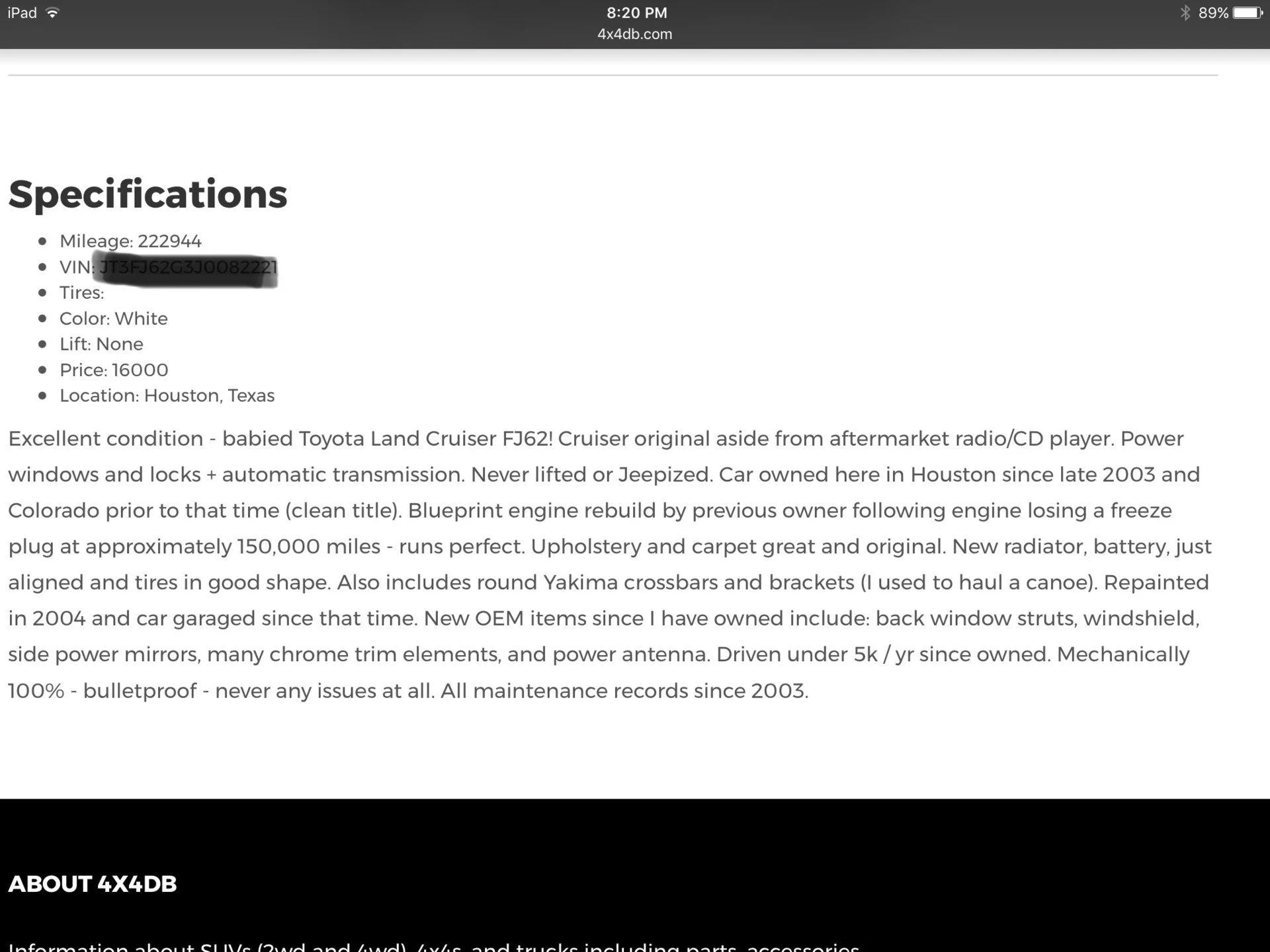

The find:

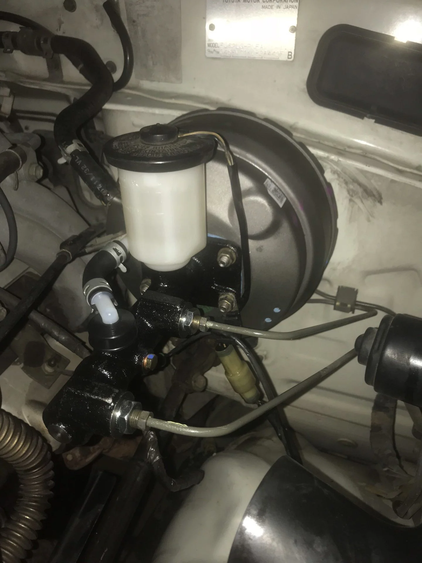

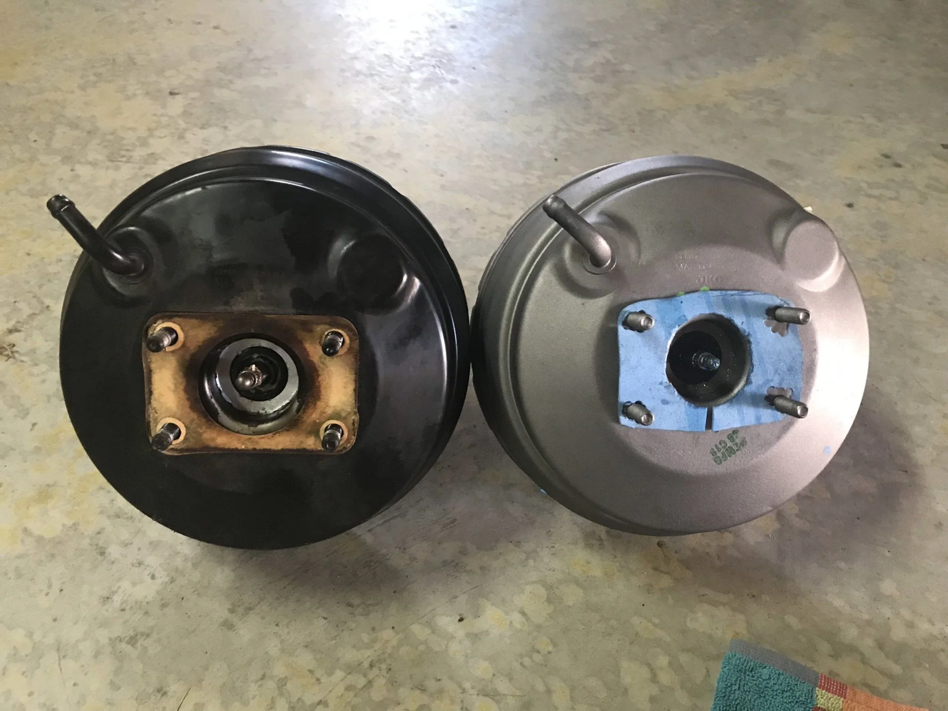

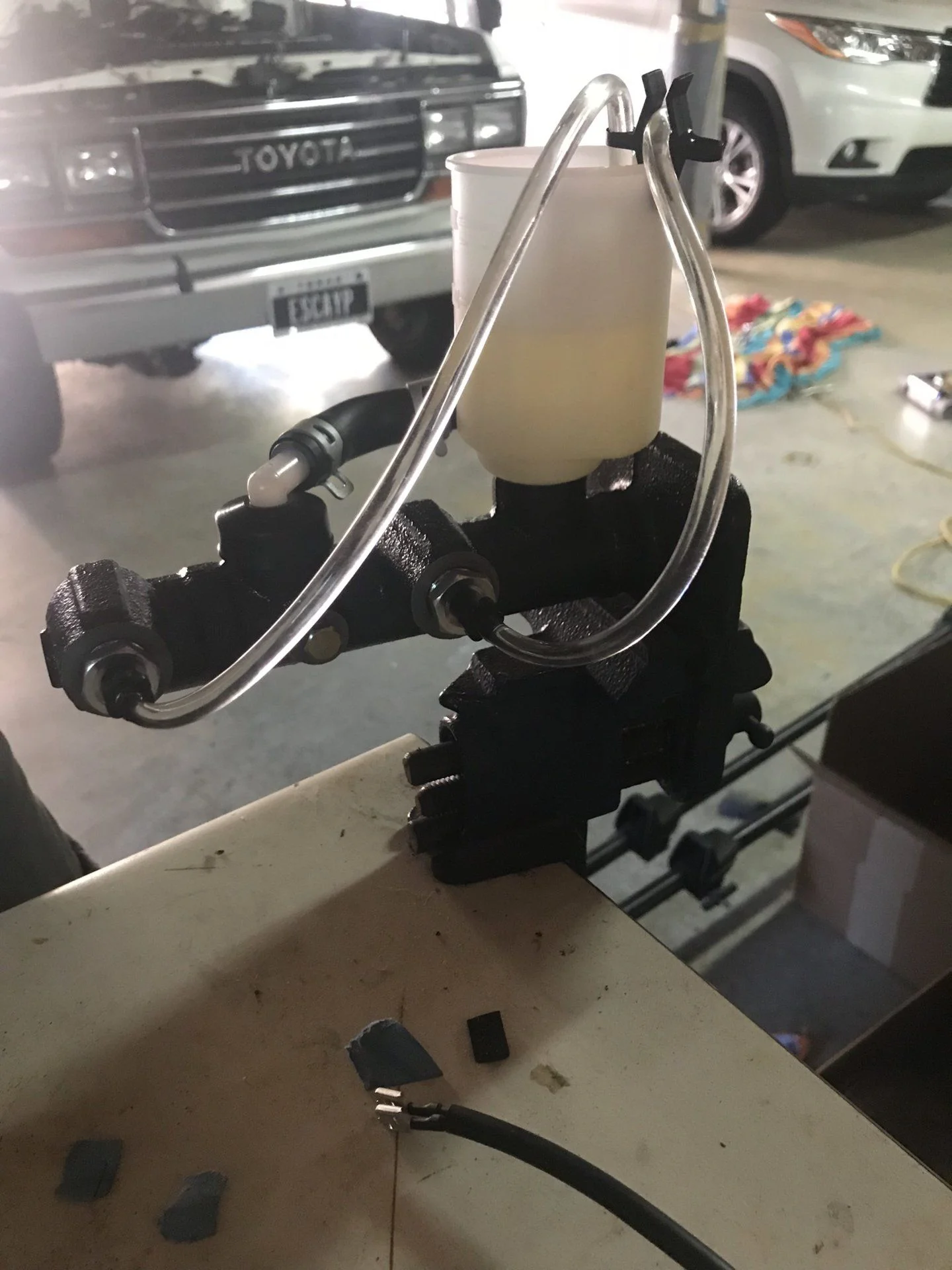

Brake booster was bad so braking was an adventure.

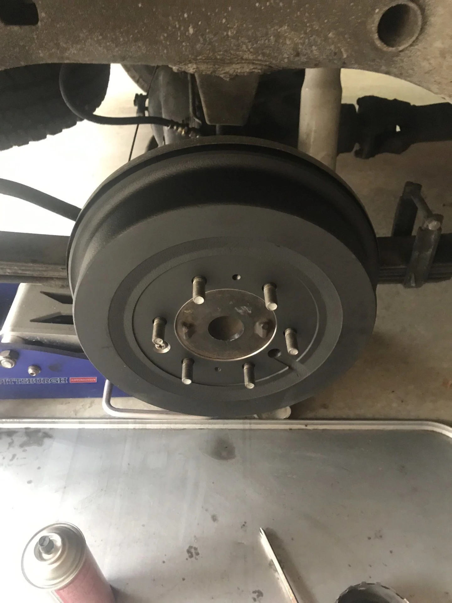

Replaced the booster, master, drum cylinders

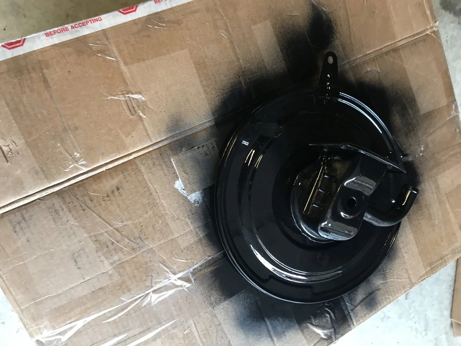

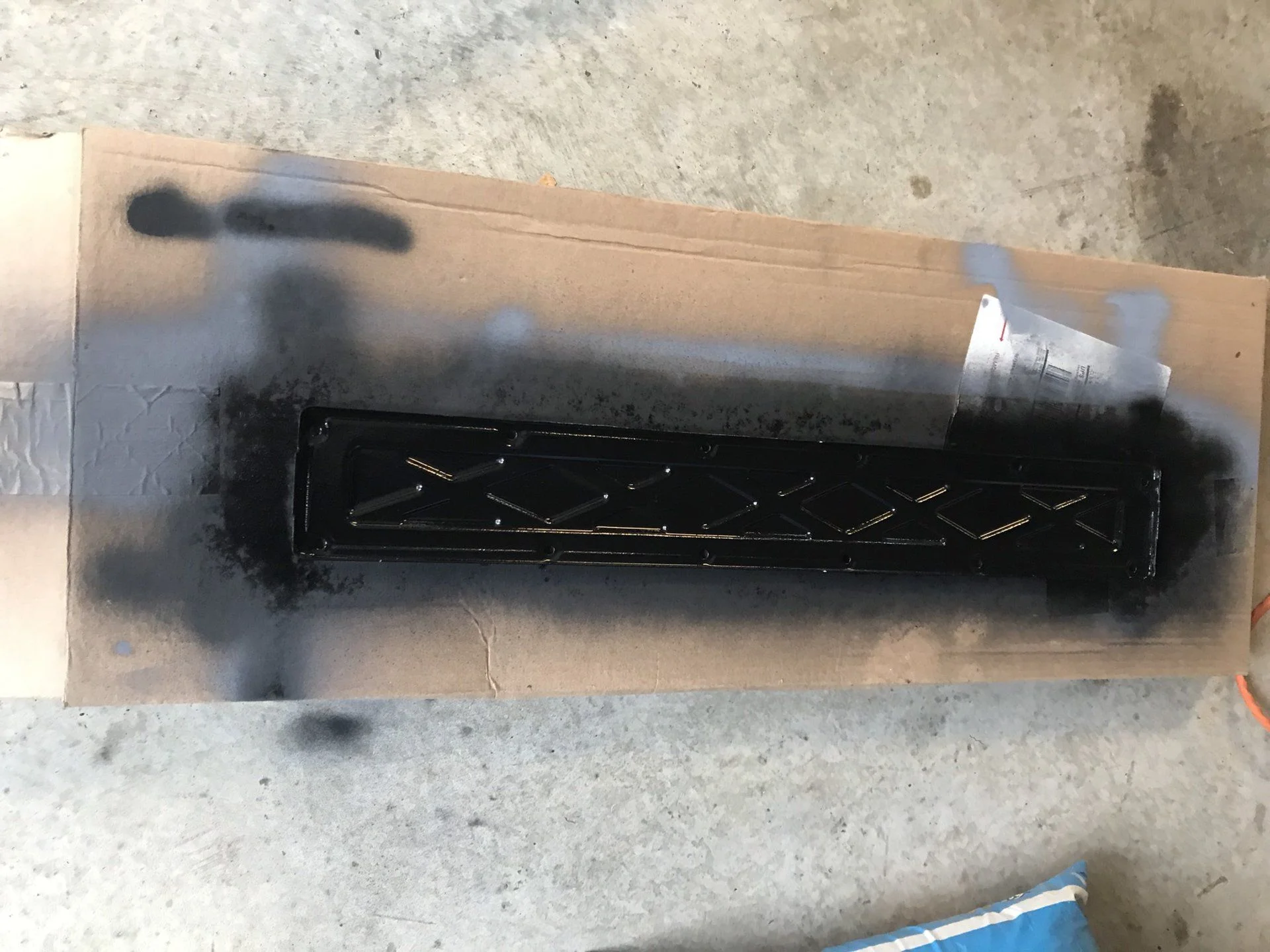

I did pull it after installation when I realized I forgot to paint the booster.
Put in new OEM brake drums and pads

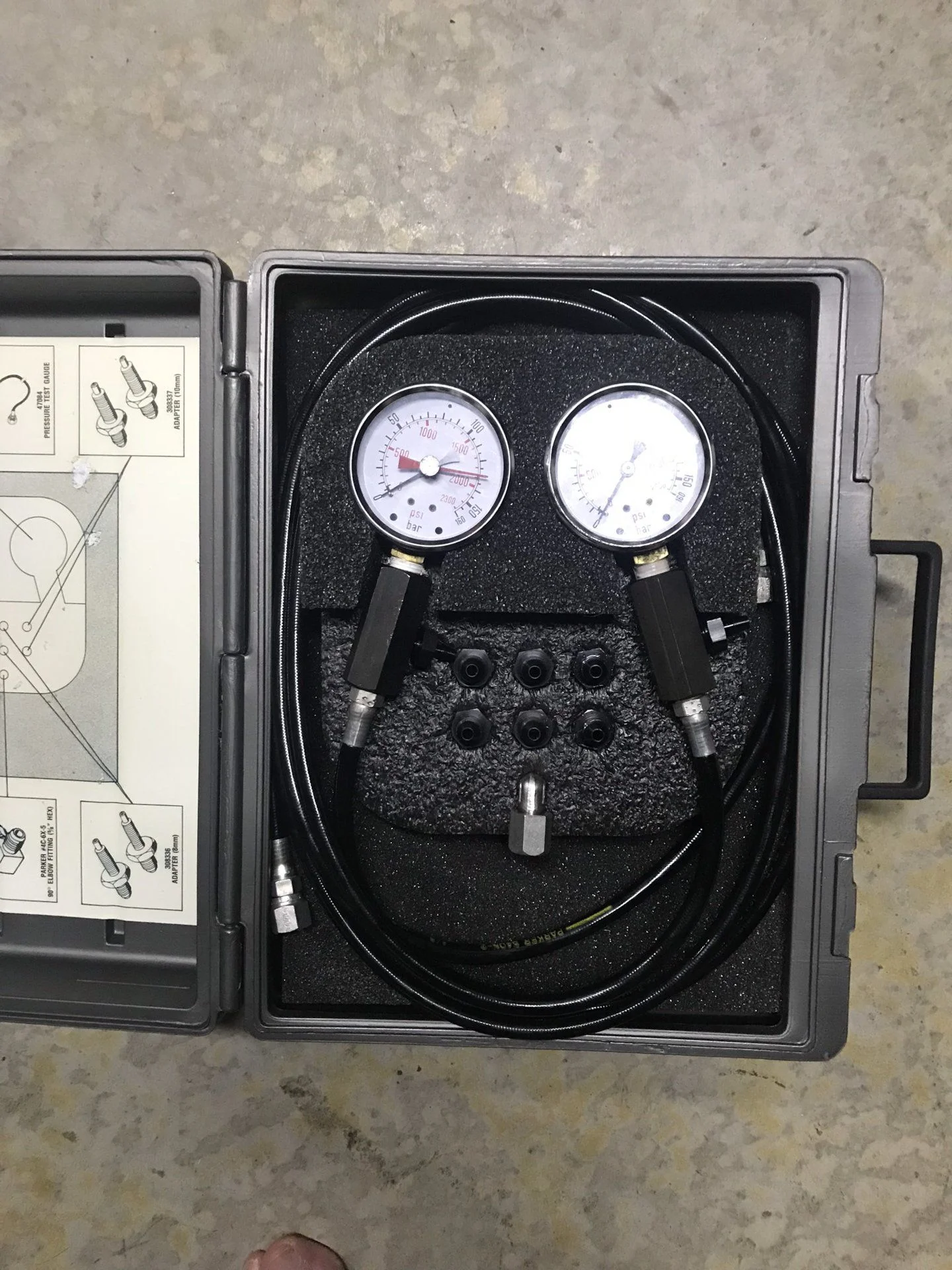

Used an SST to rebalance the load sensing proportional valve.

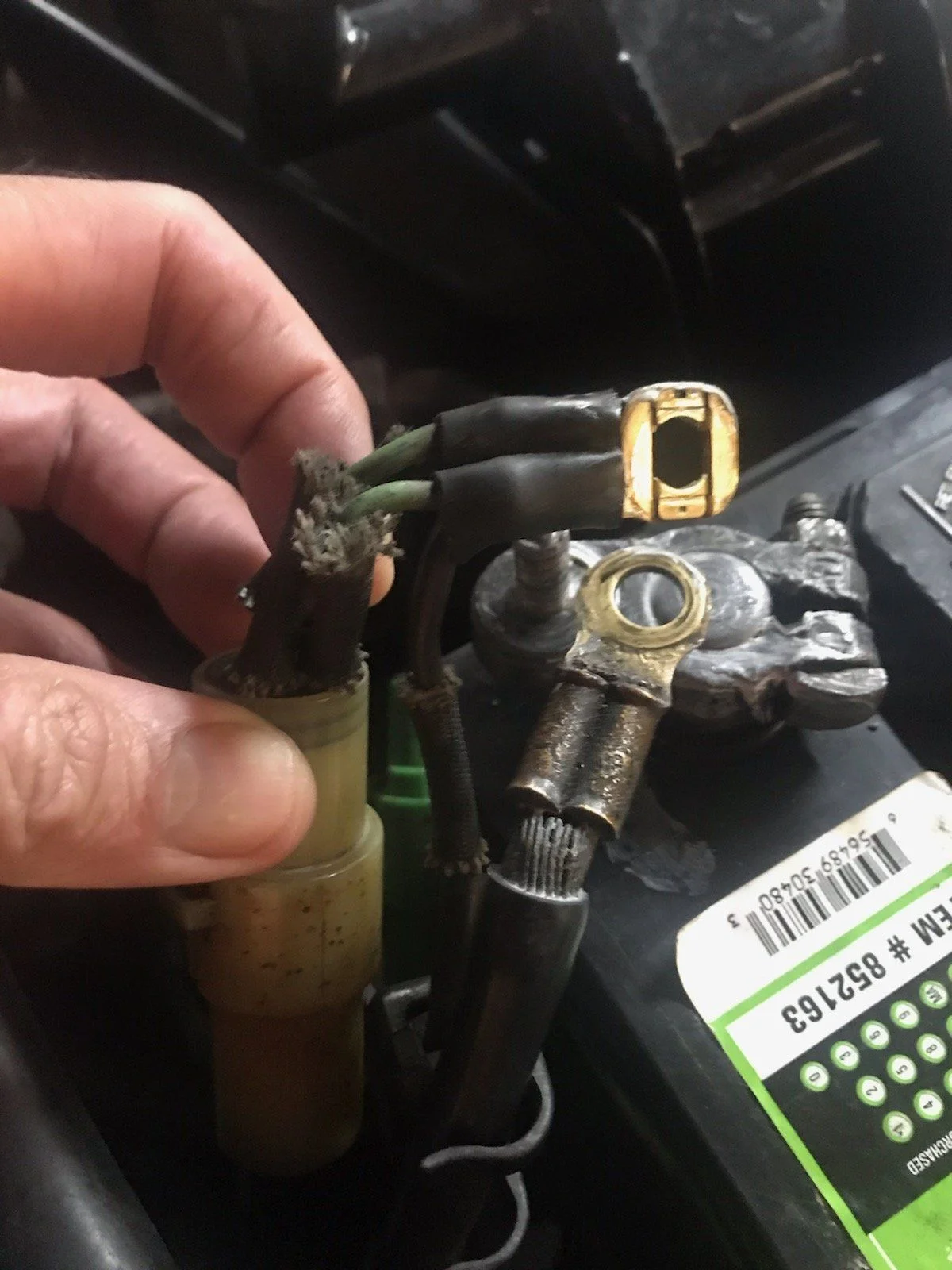

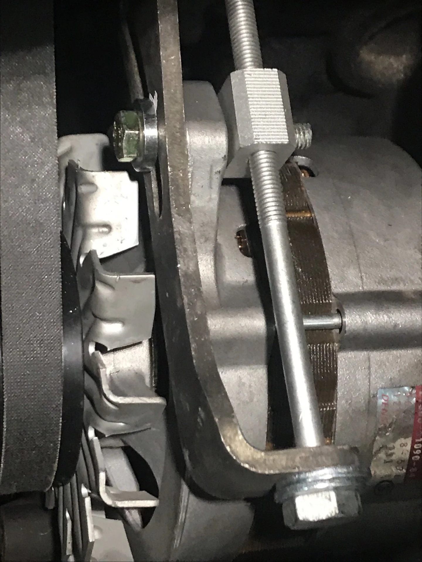

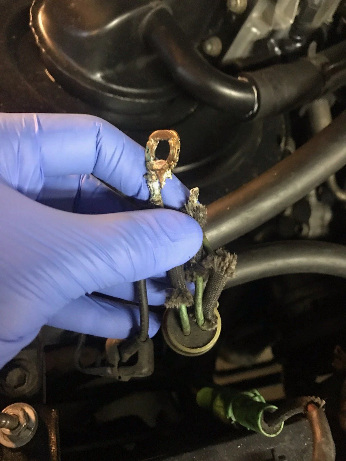

The reason, I think, that the alternator went wonky was corrosion on the fusible link.
This situation expressed itself when I was driving down the road and all power went out. Car still ran.
Found a replacement from cruiser parts.net

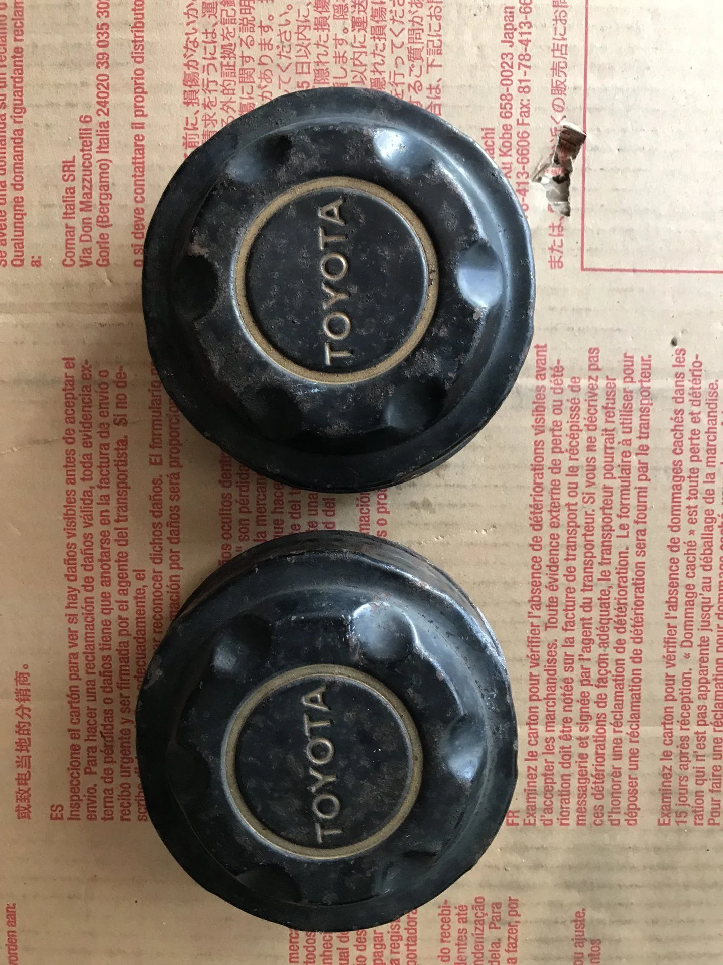

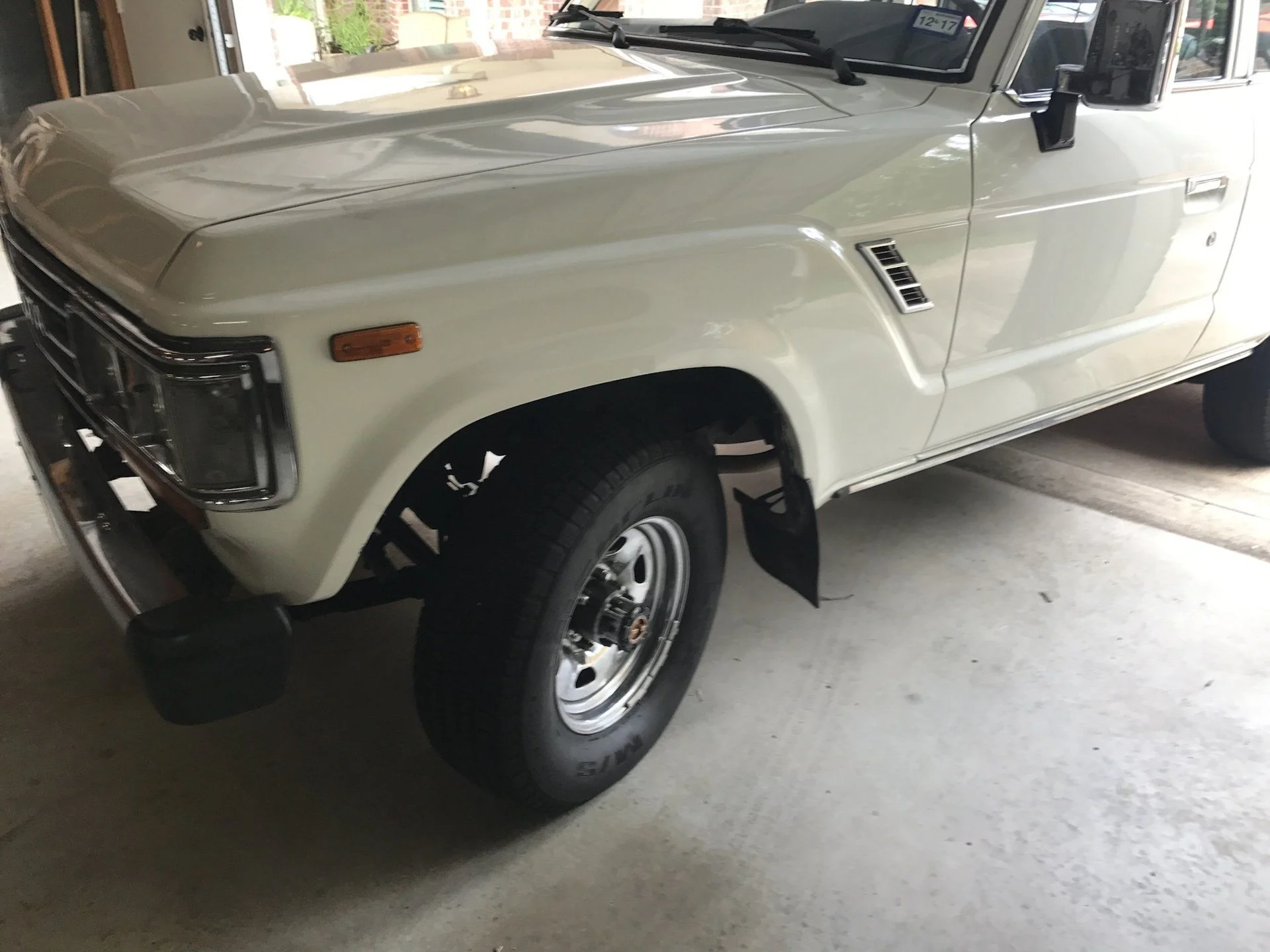

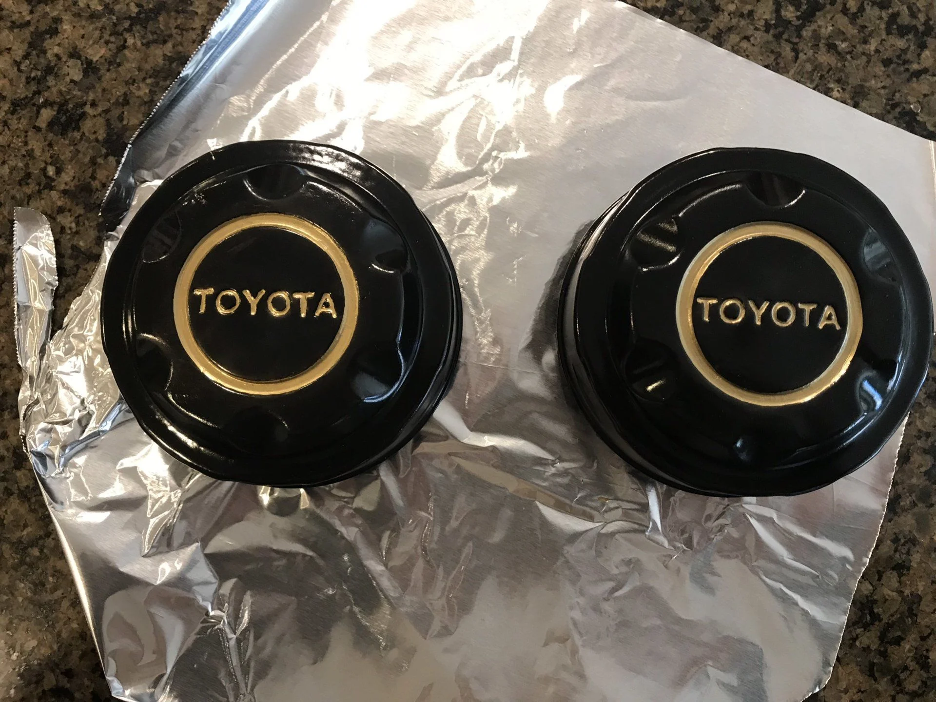

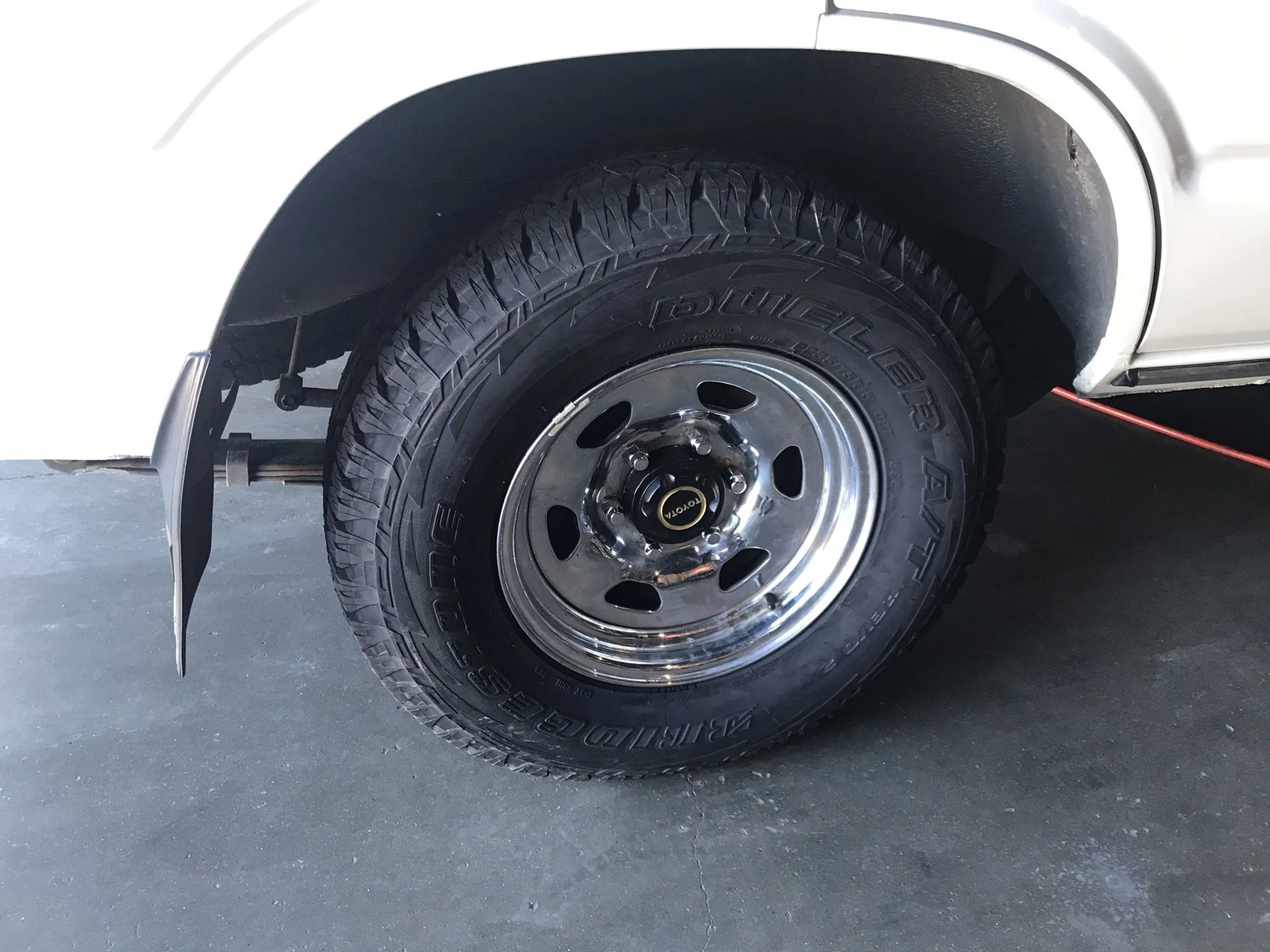

Tires were over 10 years old and the center caps in back were rusty and the ones up front were missing.
Found new front garnishes, rehabbed the rears and put some Bridgestone Dueler ATs on. They have enough tread for where I’m going and don’t beat you up on the freeway.

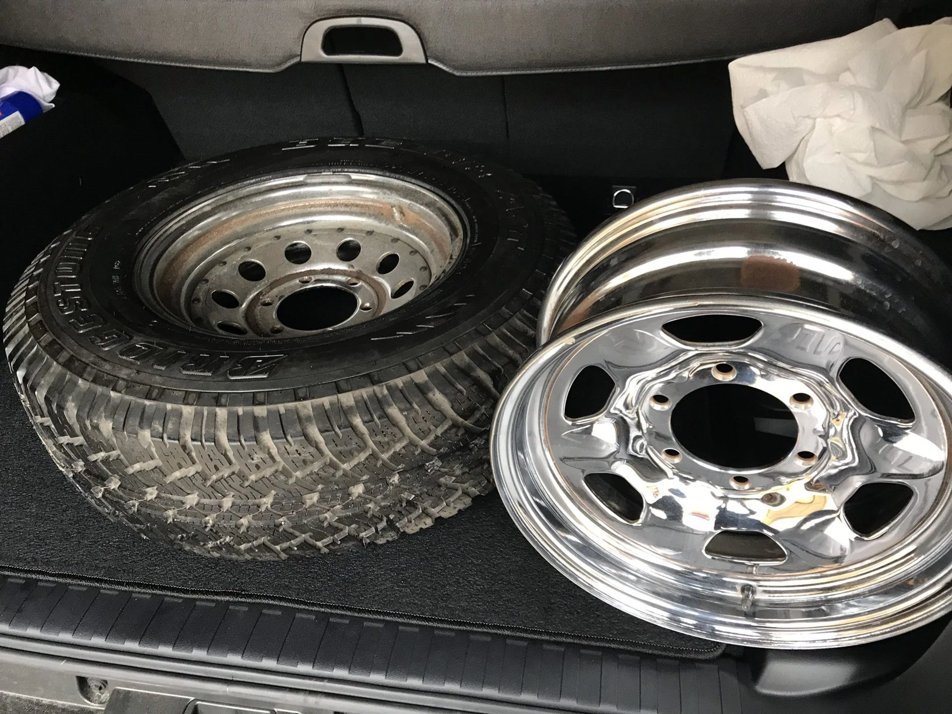

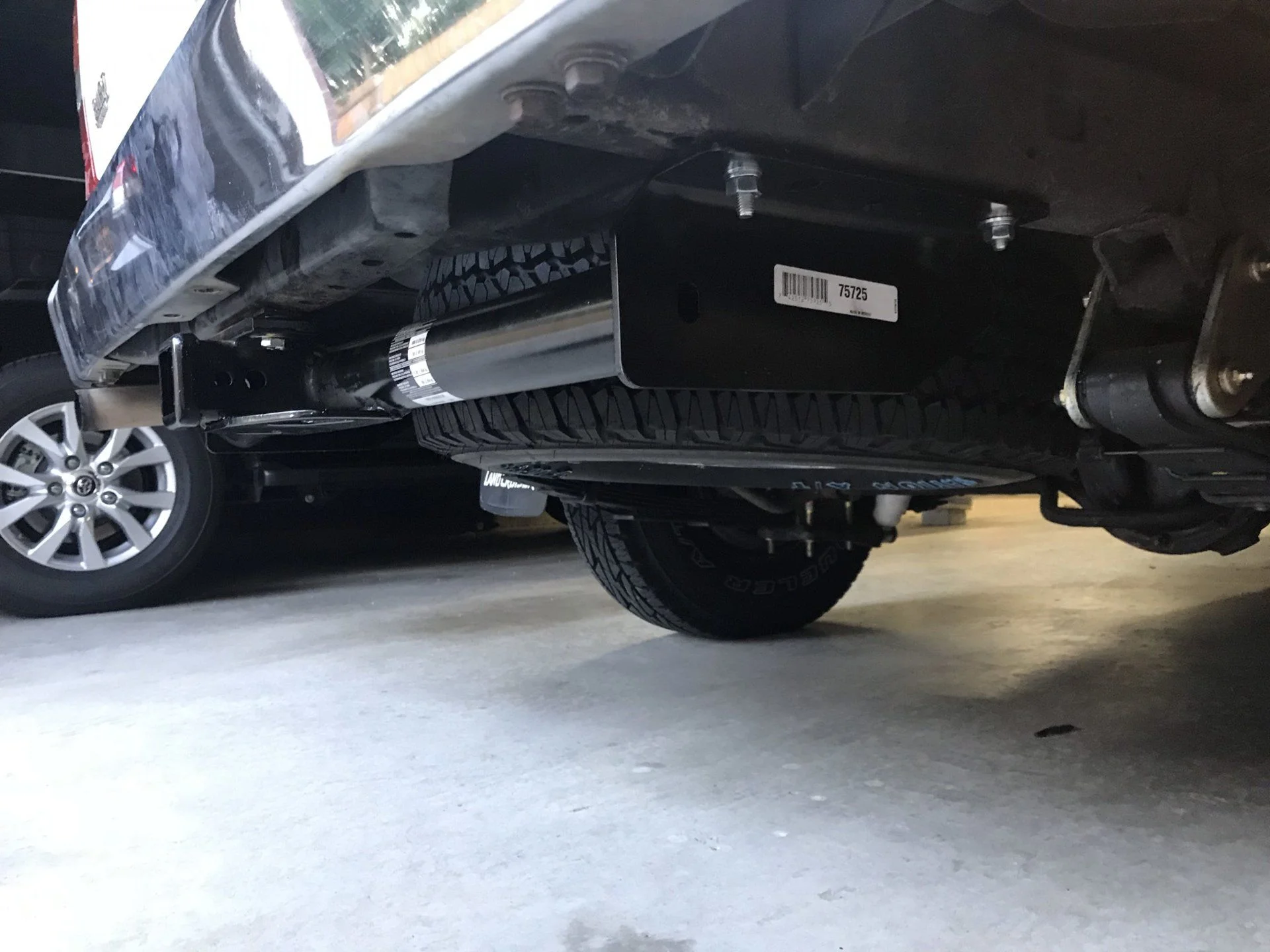

Being OCDish, It drove me crazy that my spare tire had a non-OEM rim. Found one at a reasonable price at a hub cap shop up in Dallas.

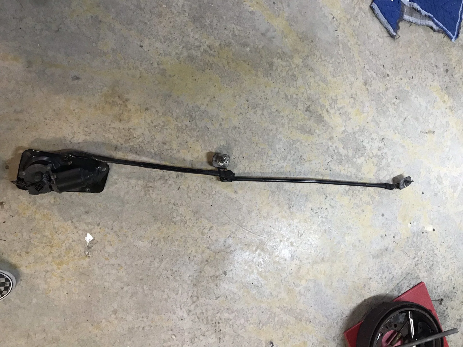

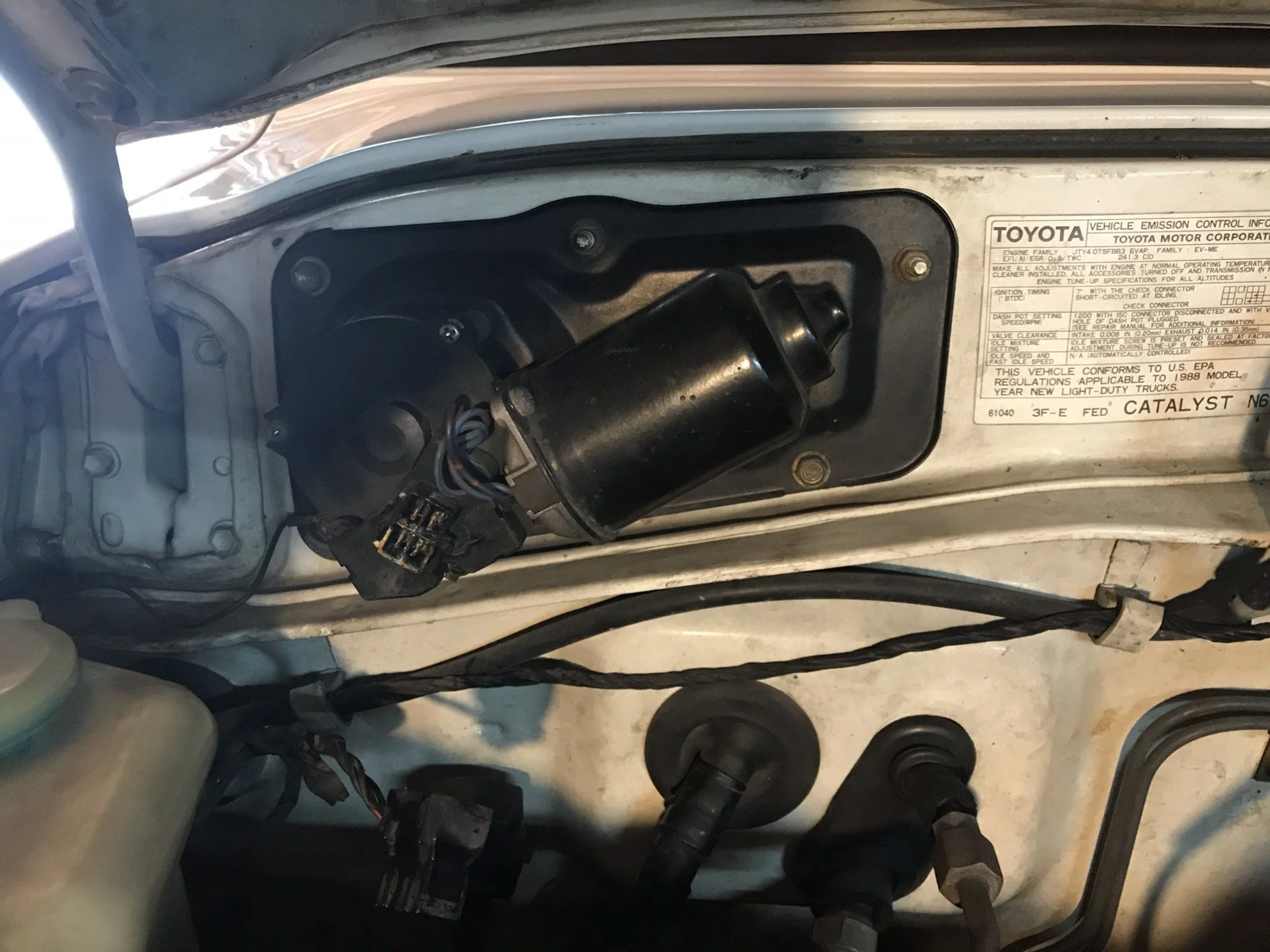

The windshield wipers worked but did not operate in Intermittent Mode and they did not return to rest position when you turned them off.
Reading threads on this forum I found that my likely issue was a bad wiper motor.
Replaced it and all is well.

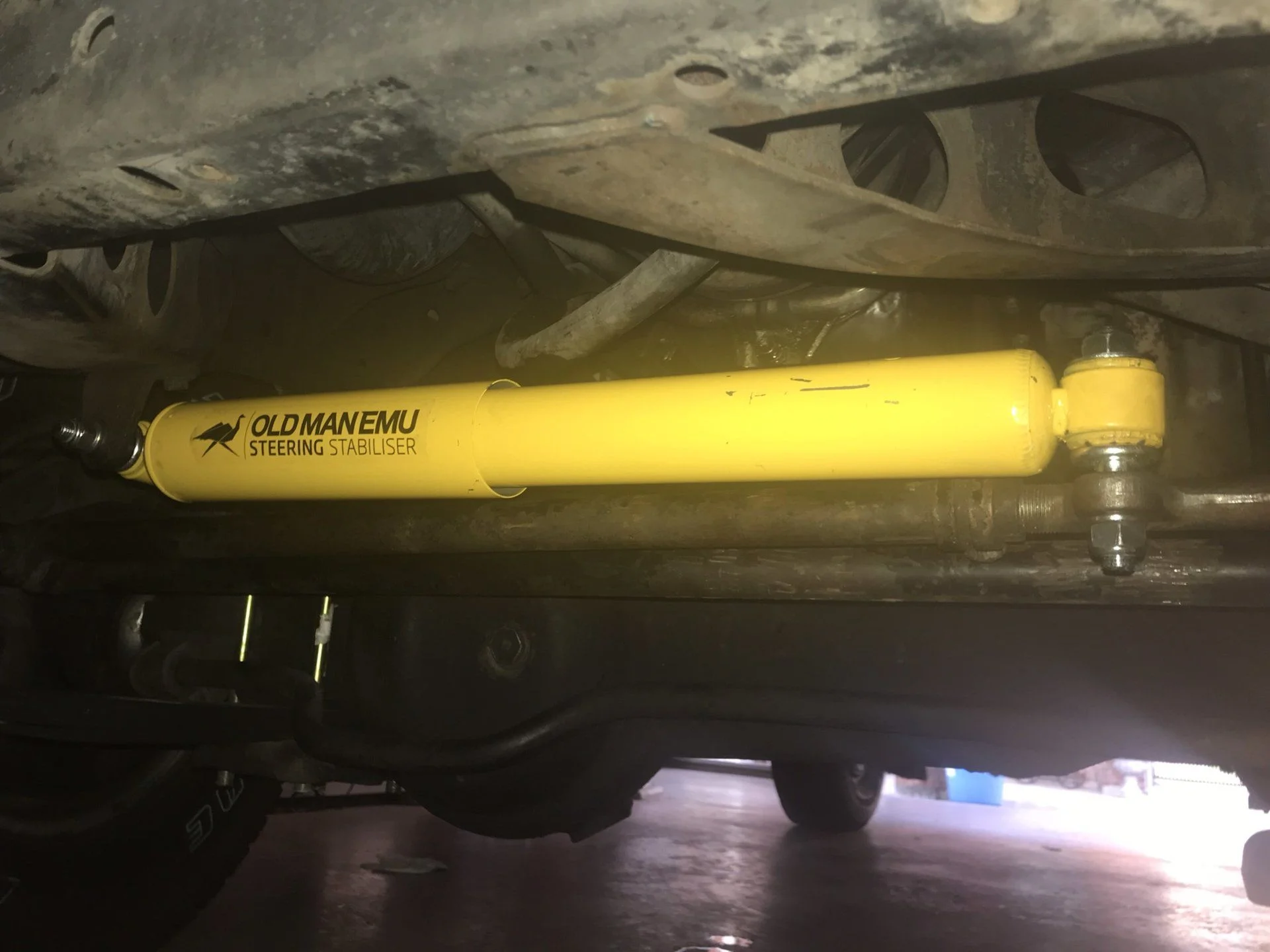

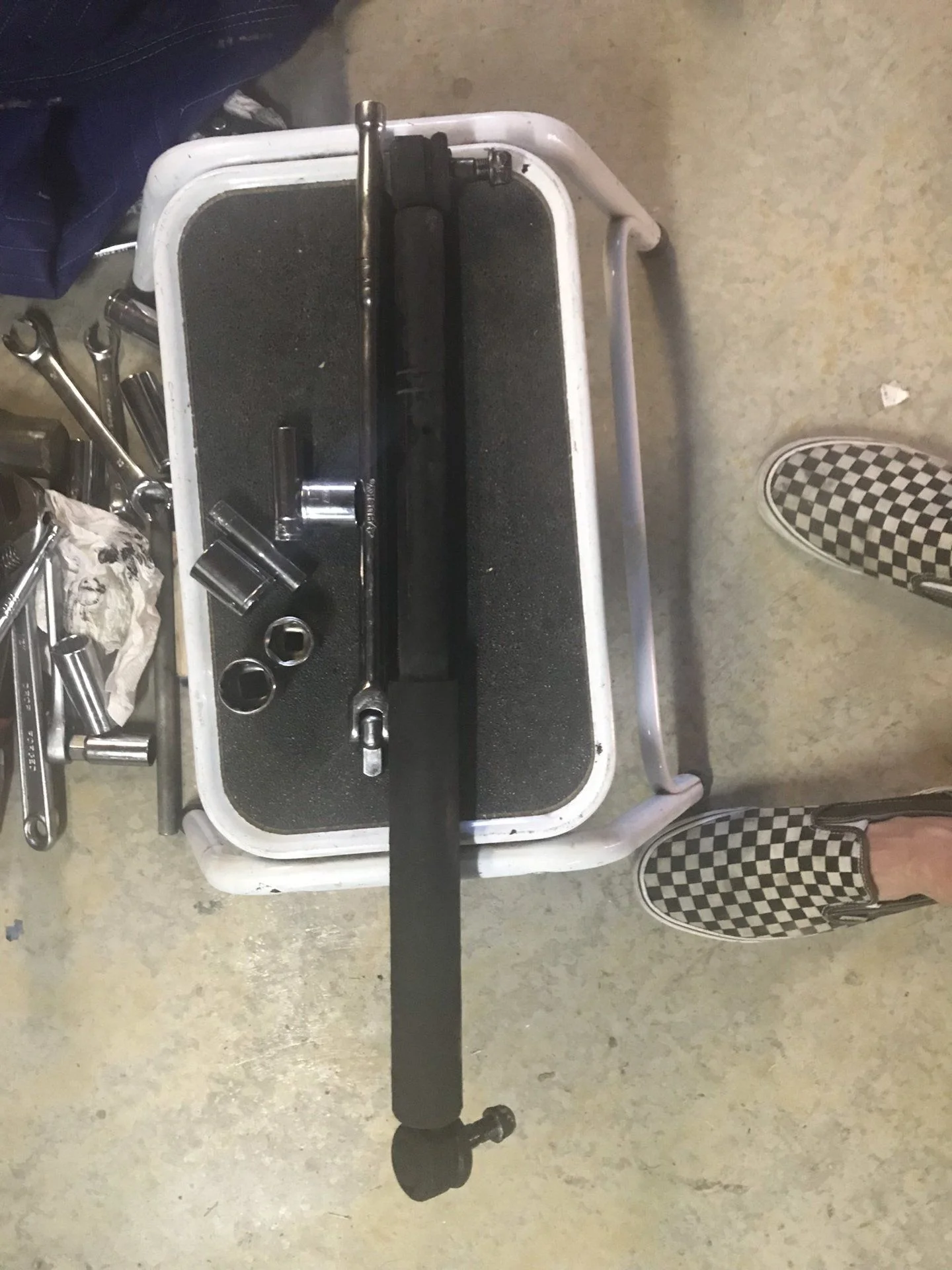

Steering was sloppy.
Replaced the tie rod ends and out in an OME steering g stabilizer.
Also adjusted the screw on the top of the steering g box, just a little is all it took.
Tracks straight and true now.

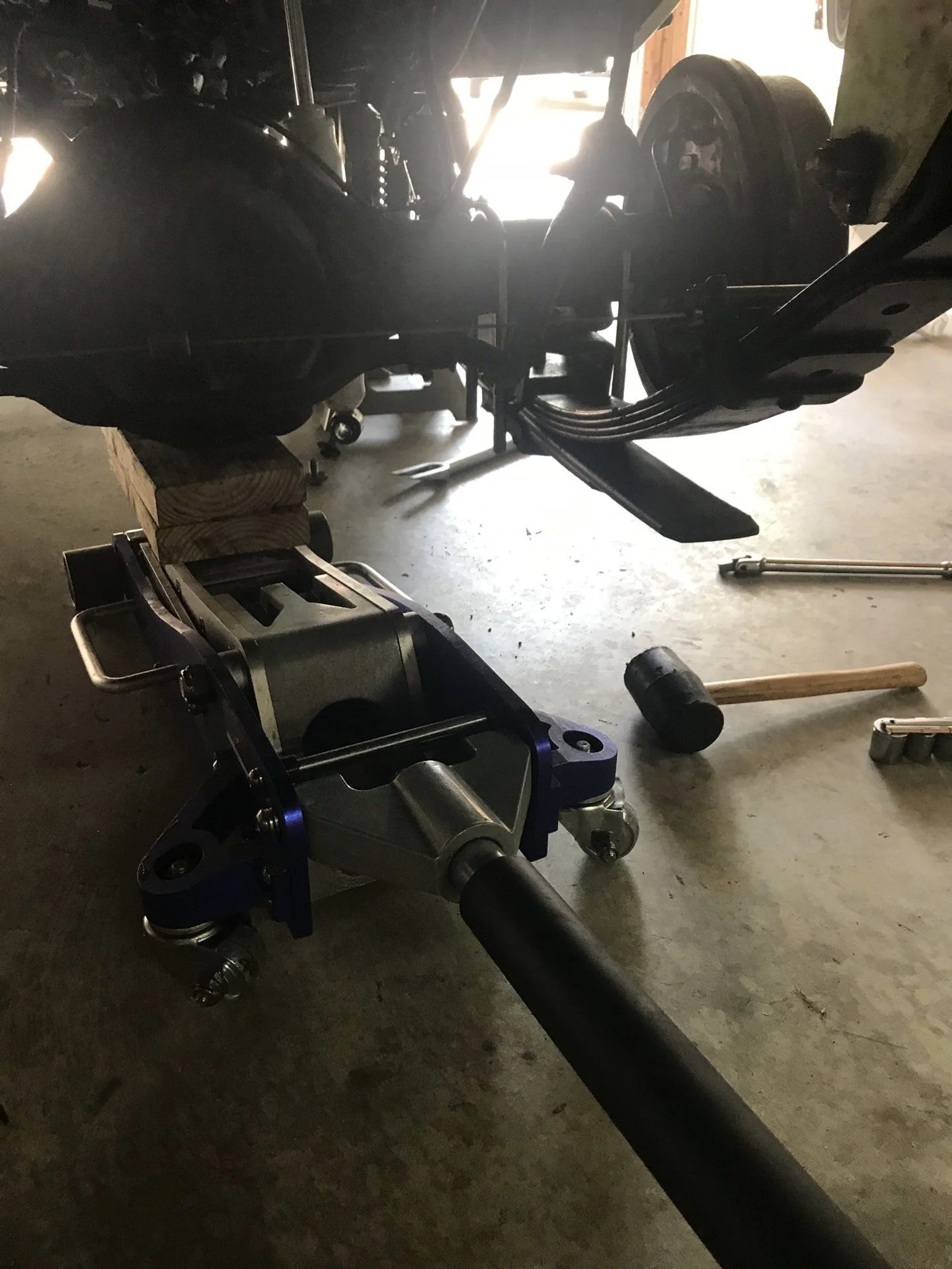

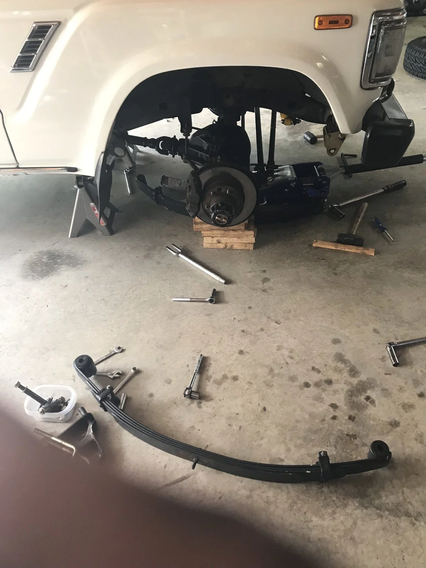

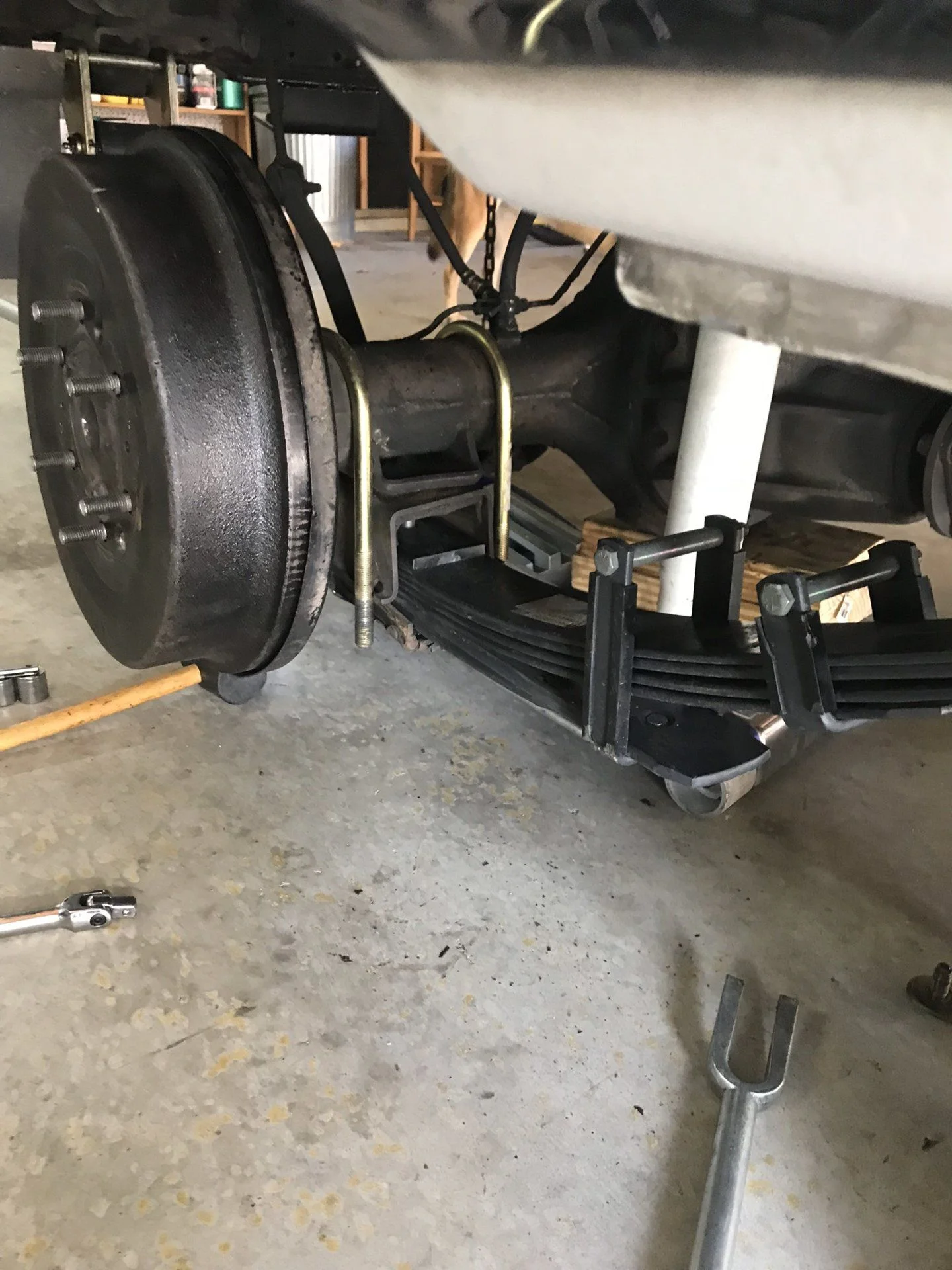

Saying that my rig rode like a jackhammer would be an insult to jackhammers.
Wanted to keep stock height so I put in an OME based SOR “Grocery Getter” leaf spring kit and shocks.
Made a HUGE difference.
As with many lifts, I had a lean afterward. Swapped the springs left to right and it made it better but not perfect.
Put a 1/2 inch spacer in one of my rear packs and it sits dead level now.

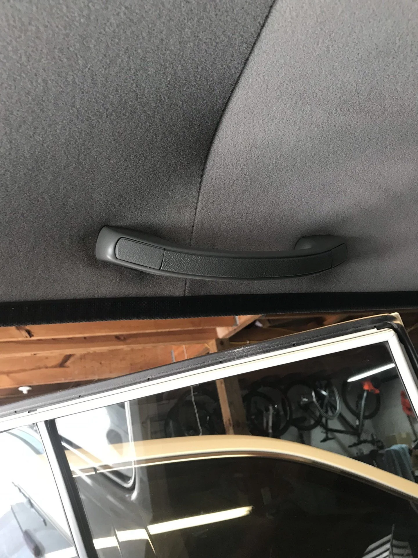

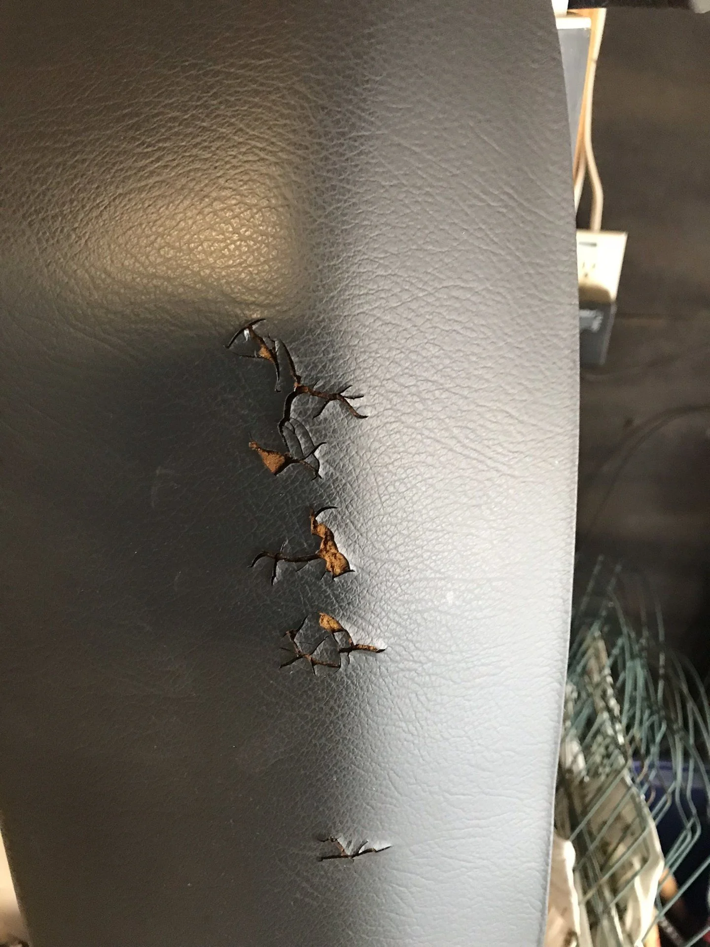

Grab handles were aged, resprayed them to match the other vinyl in the truck vs the lighter color they were originally.
It’ll hide the dirt better

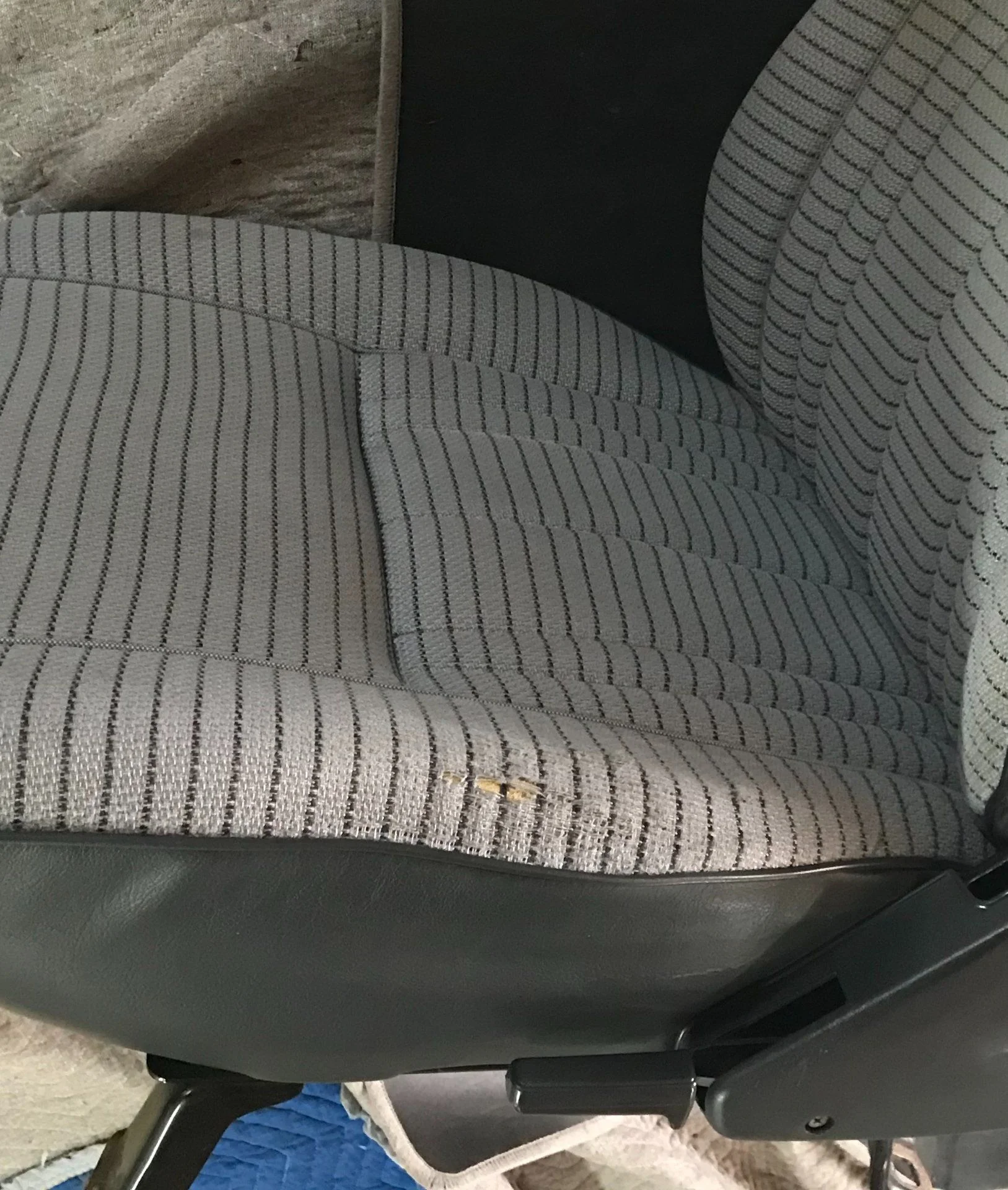

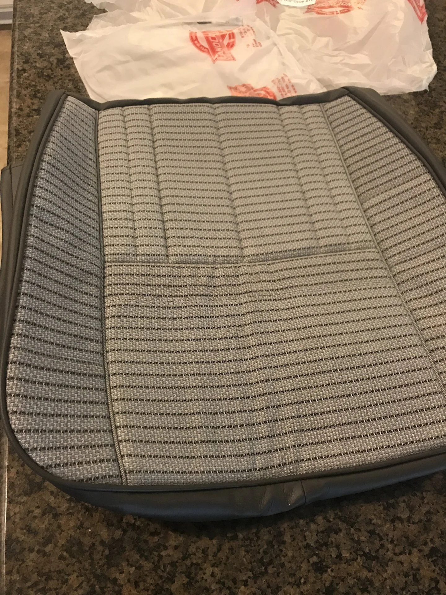

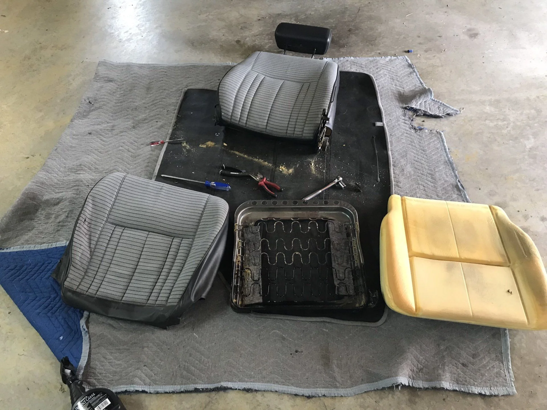

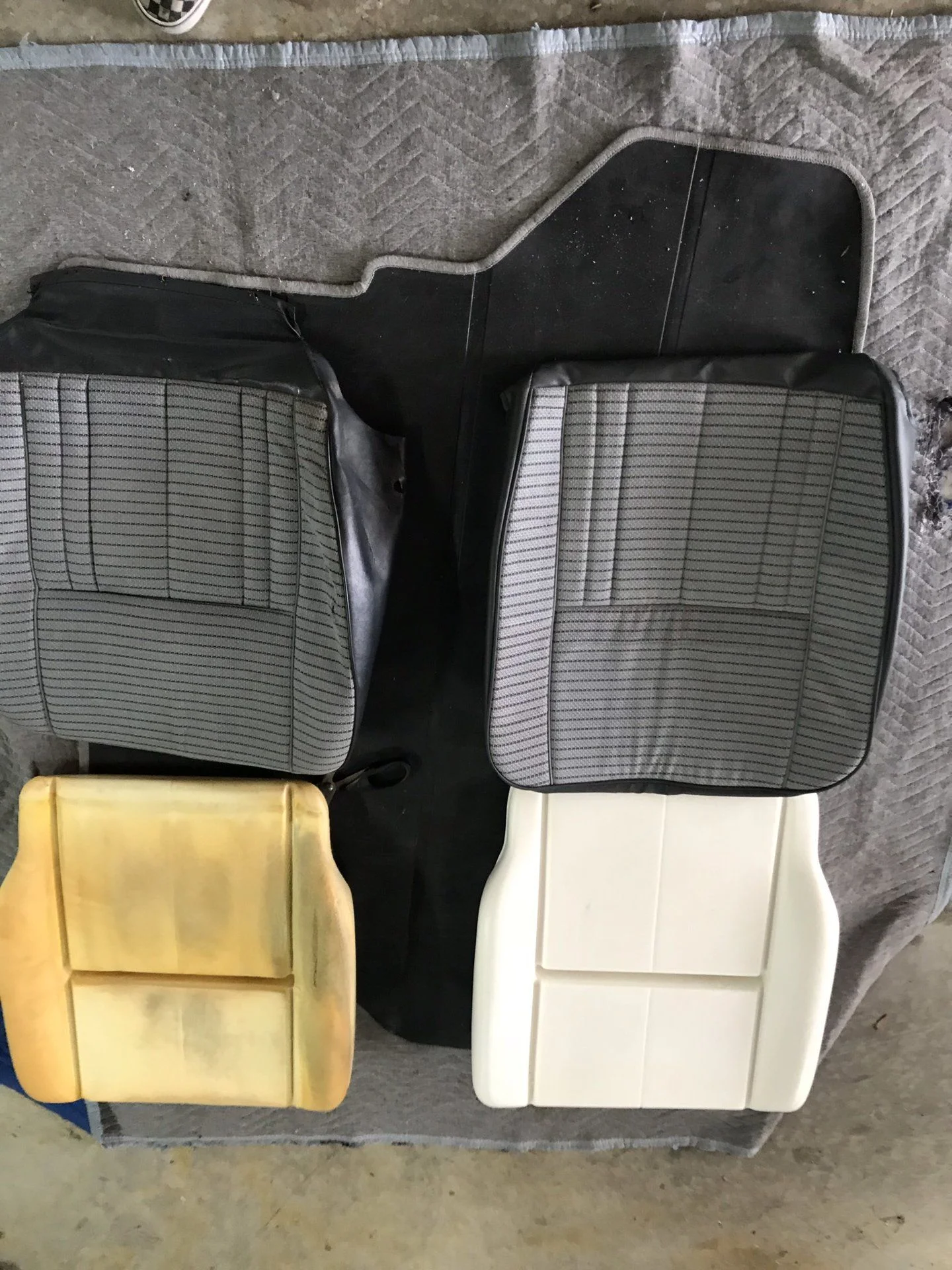

Drivers seat was wearing through.
Found an OEM fabric cover and replacement cushion at SOR
Hog ring pliers used for upholstery are an adventure.
Plus I put one of the darn rings through my finger and bled all over the place. At least it didn’t get on the new seat cover.
