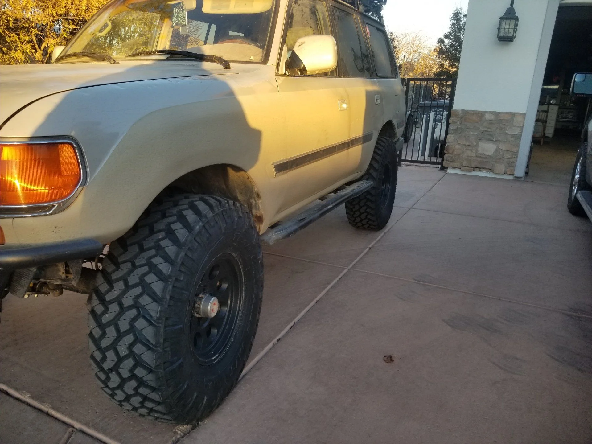

I have not done anything yet and need to get my numbers to see where it is. My "before" was probably lowered an inch from factory and therefore the caster was likely more laid back than factory settings which I noticed as a high steering effort. I have not driven the vehicle much since fitting the lift so I can't say how it drives, only what it looks like.
It does have a little nervousness on uneven pavement but that may be the tires to fault. My 100 has 275/75-18 (33") and of course it has IFS so it's pretty civil on the road. It's fine on the highway where it's level and flat (I'm in KS, I know flat. ;) )

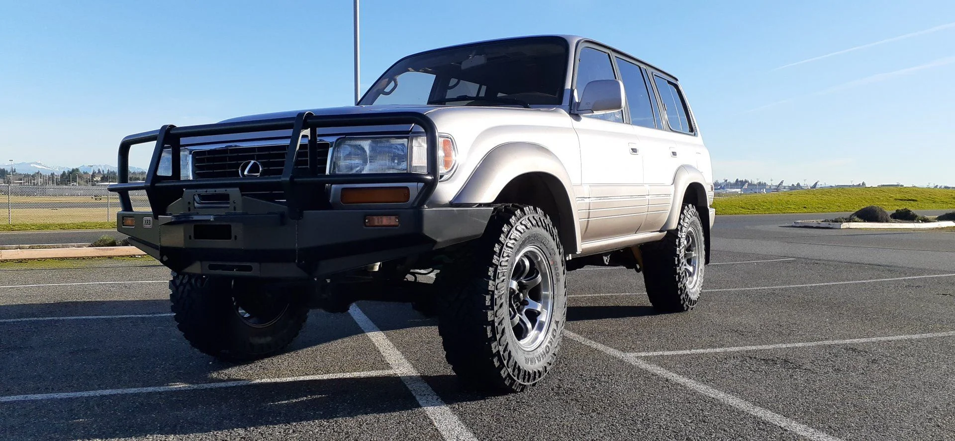

This sounds like a great set up. I bet with deleted fender flares, mud flaps, and running boards, along with some hammer action that one could run 315's with the right wheels using this set up.
Or you could keep the flares and skip the hammer and run 315’s. ;)
Really, I'm currently running a 2" ironman lift with deleted and trimmed fenders(at least in the rear). Not to mention the hammering and deleted flaps and such. I am running 315's and I still rub every now and then. Even after the hammer treatment.
That being said it could be as simple as the wrong wheels. I am not really sure what wheels I have other than they are 16"... but everytime I have rubbed I was probably going to fast and really smacking some big bumps. Hasn't ever rubbed doing slow articulation stuff. I bet different wheels would fix it for me. The PO of my rig was running 37"s at one point with a 6" slee and he still had to trim the fenders to avoid rubbing.
