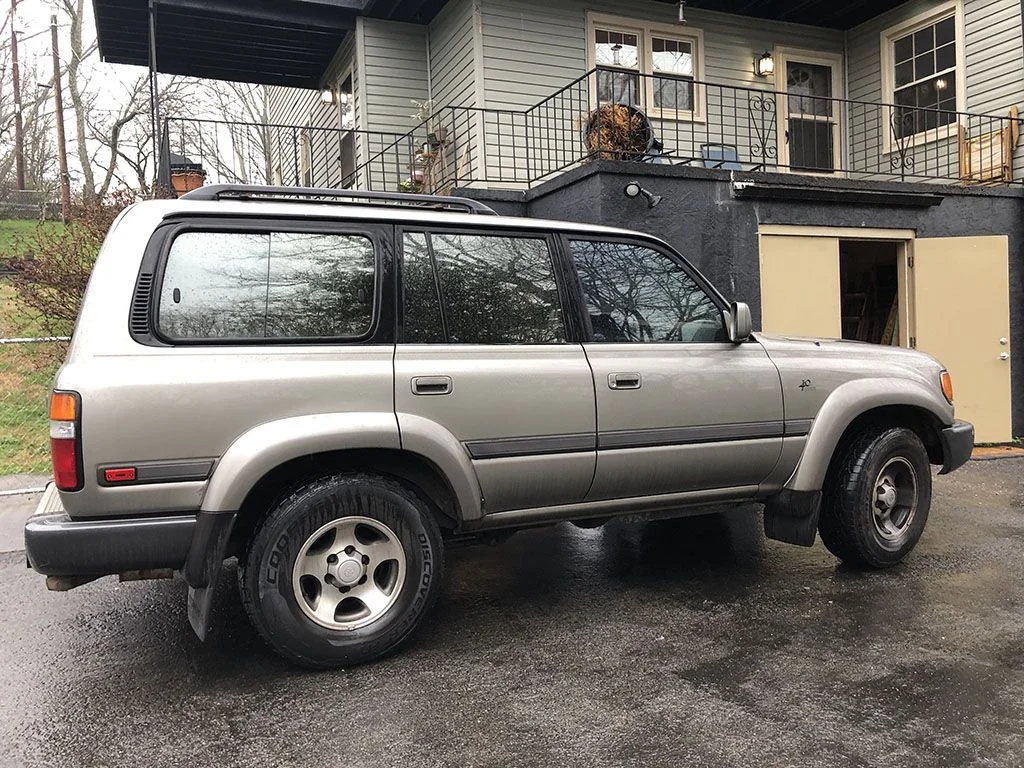

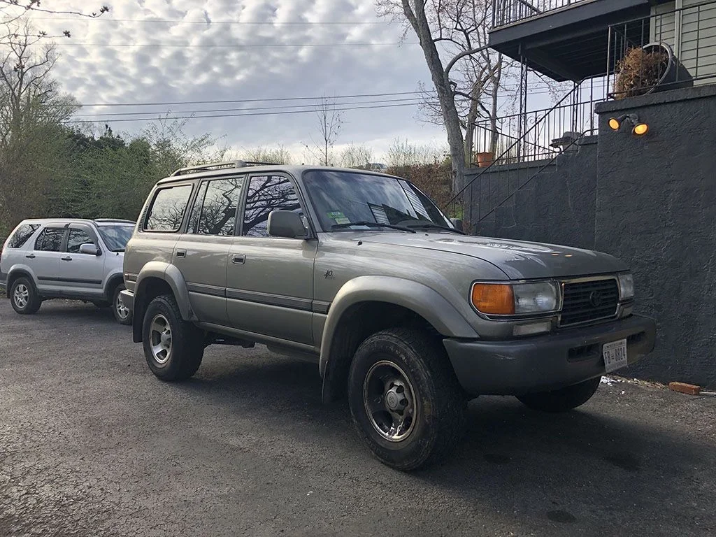

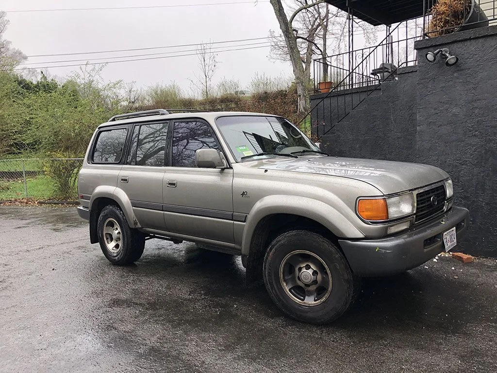

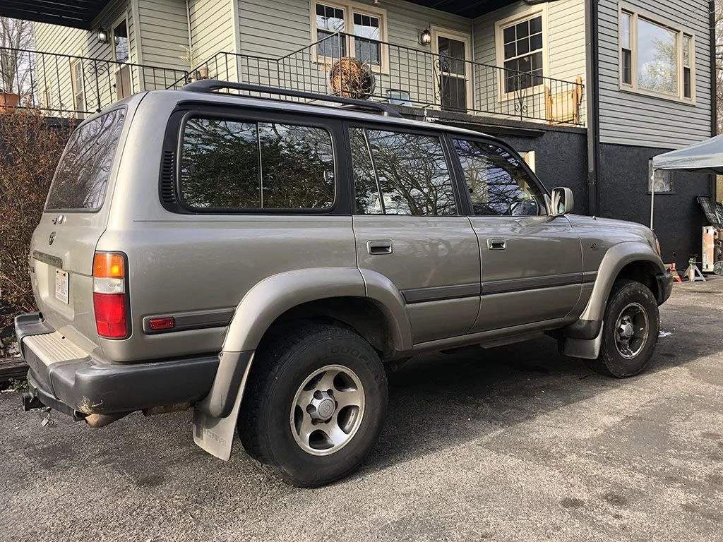

While doing research for my suspension upgrade recently I couldn't find any reviews or photos of this particular set up, so I wanted to post in case someone else is looking. It's no 4 inch lift with miles of travel, but some of us like our cruisers on the refined side.
I've only had it on 3 days so far, but the difference is incredible. I can't believe I waited this long to upgrade the suspension. It drives better than it ever has since I owned it, and maybe better than from the factory. They ride is super responsive and firm, but comfortable. No rolling around corners or getting slammed by potholes. It really gave it whole new life. And the steering dampener is a huge improvement over stock. It really tightened up a lot of the play I was experiencing at the wheel.
The amount of lift is exactly what I wanted. For the longest time I was just going to to do a stock height kit, but after speaking with the folks at Dobinson's I decided to go with the variable springs since I'll be running more weight in the future (bumpers, sliders, rack) but for now am bone stock. I wanted something that felt good loaded and unloaded. Since the stock height kit only comes with linear springs, I went for the 1.75 inch lift. It sits a little higher, but not so much that it looks super lifted or makes it feel like It can't still be a very comfortable daily driver. The dog can still jump in the back, which is crucial. If you're on the fence between a 2.5 kit and stock height, this is perfect compromise.
I took some very rudimentary and non-scientific measurements from the top of the tire to the wheel well. These measurements were taken on an uneven driveway in the rain with unevenly worn tires so they're not super accurate, but show a pretty clear 2-2.25 inches of overall lift from the worn out stock springs.
Before
FR: 4"
FL: 4.25"
RR: 4.75"
RL: 4.25"
After
FR: 6.25"
FL: 6.5"
RR: 6.75"
RL: 6.25"
Need new tires now.

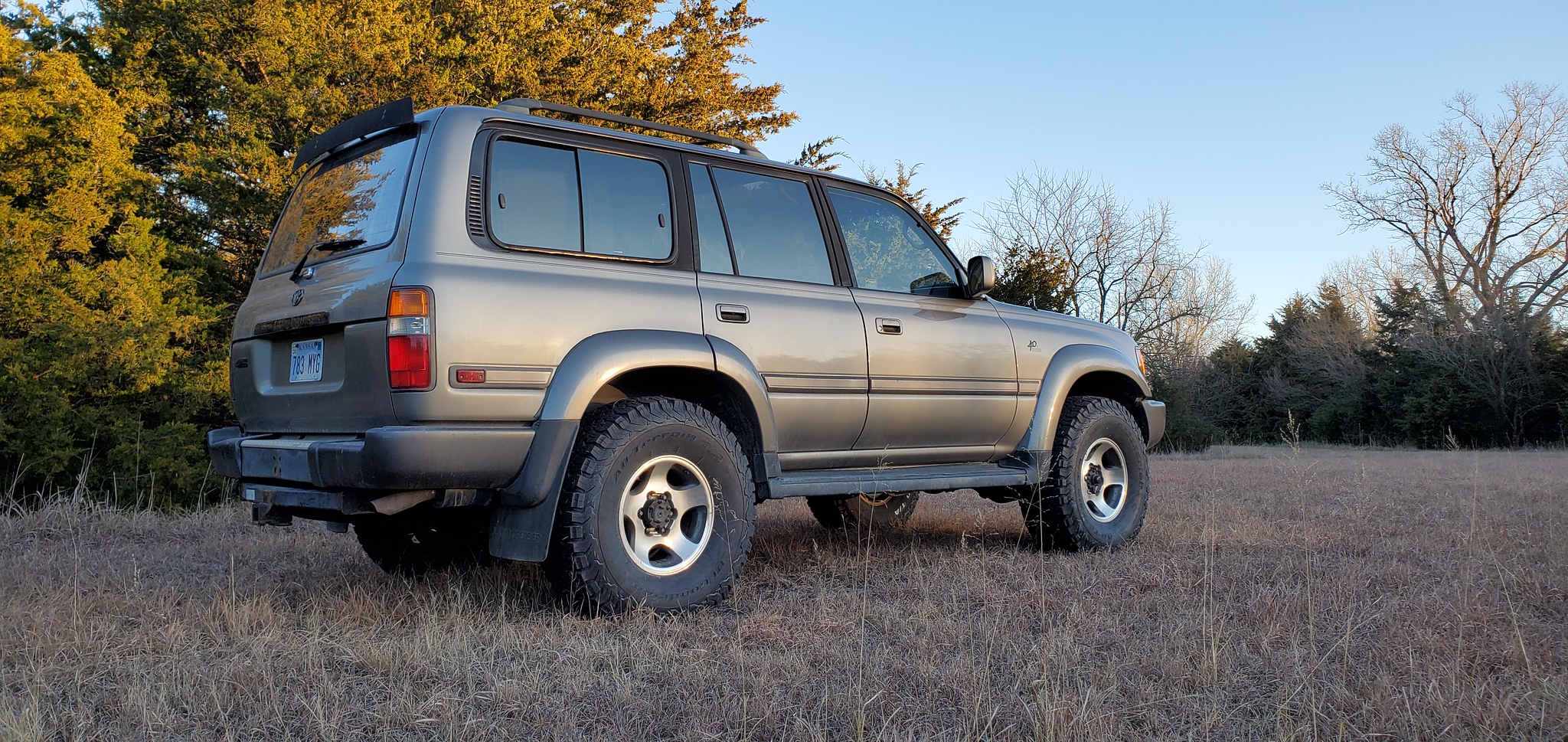

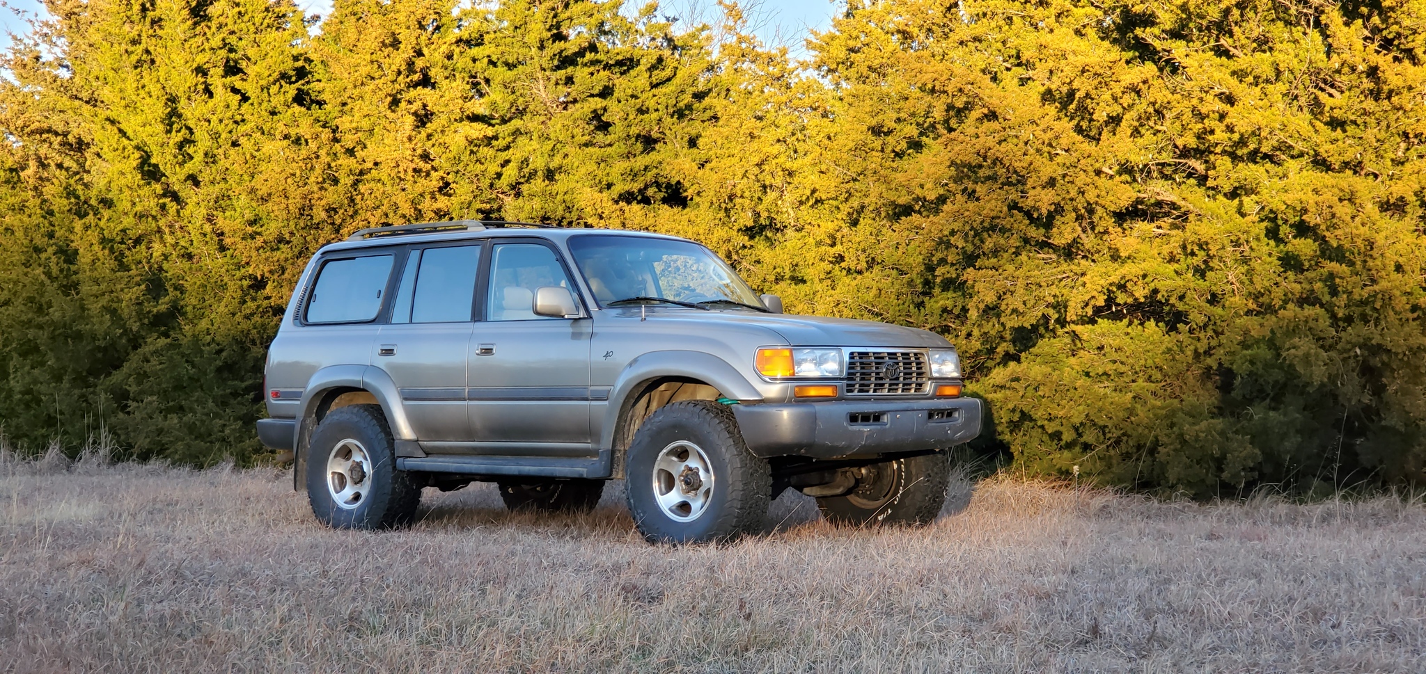

Based on this thread I bought 222v/223v springs and installed them on my 80.
Instead of posting a new thread for this info I figured I'd put it here.
My measurements were (center hub to flare lower edge):
LF22.5RF22.25
LR22RR22
For my vehicle this represents a 2.75" lift from before. She has 250K on the clock and was on stock springs and shocks.
These are 315/75-16 BFGoodrich KO2s.
