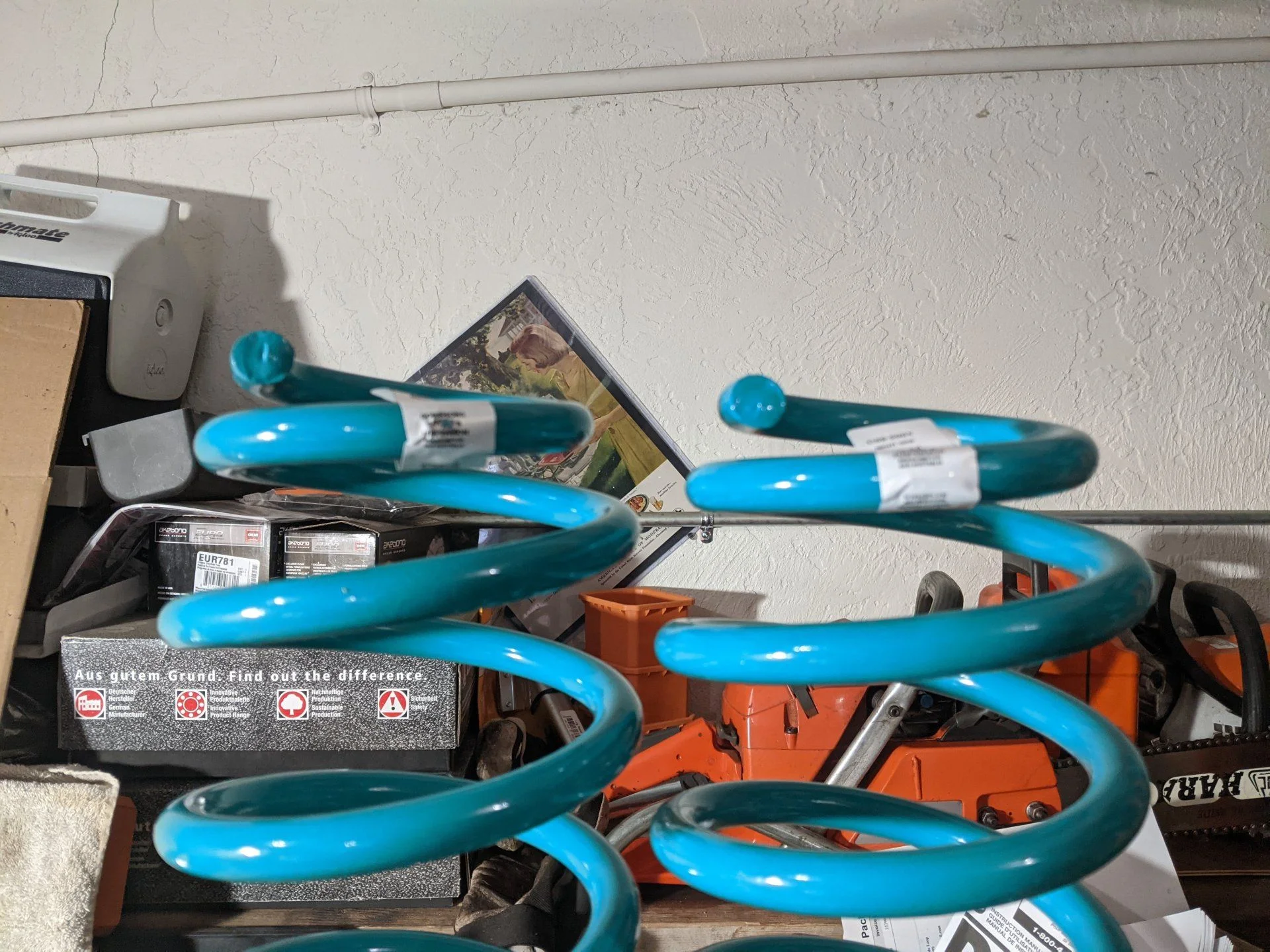

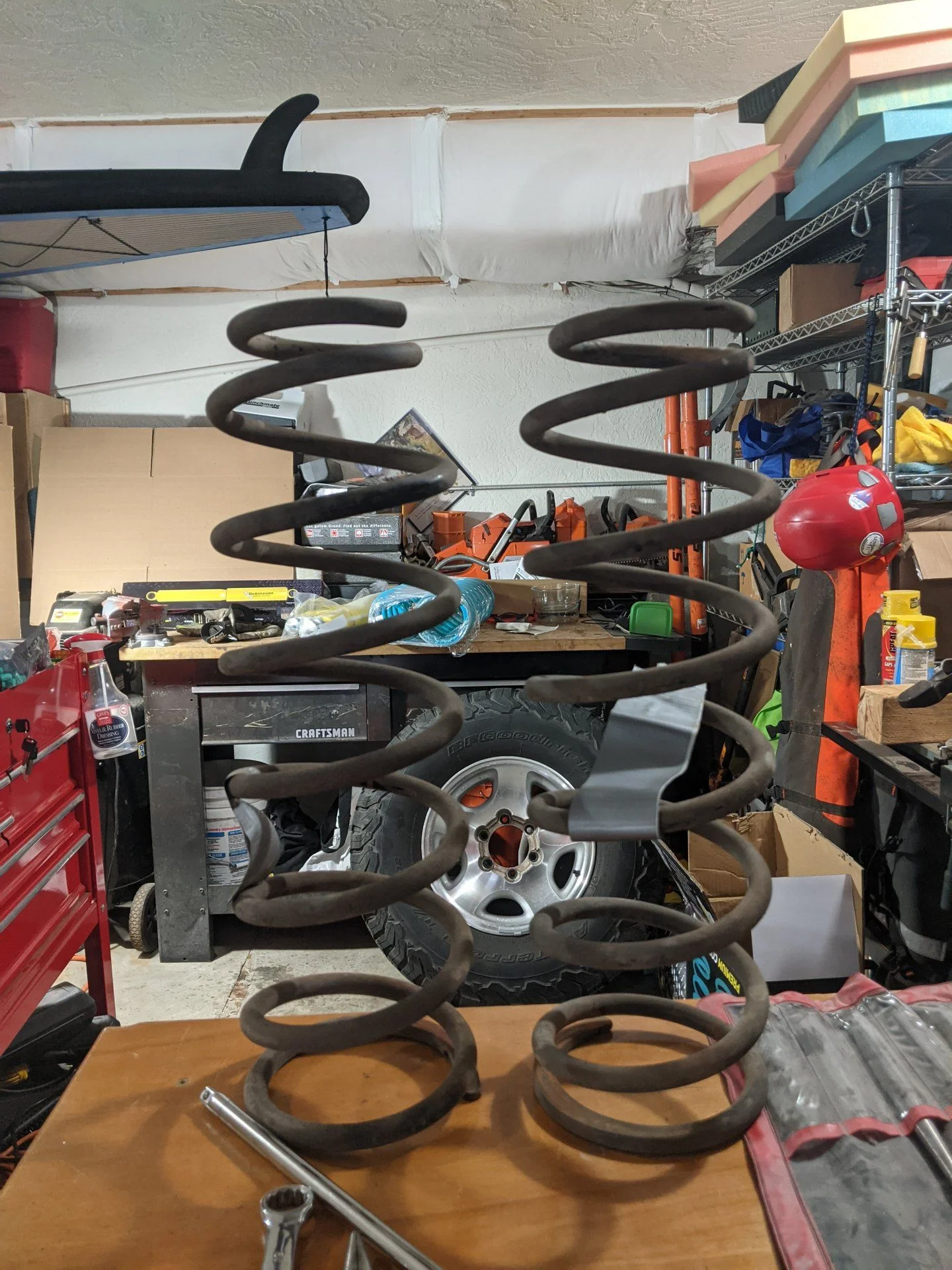

I just received my C59-222V and C59-223V springs from Dobinsons today. I see they are marked left and right on the springs and I was wondering if that is how you guys installed yours? I know sometimes Australian companies setup for RHD so I’m unsure if I should install them opposite? Thanks for the reviews and information as I was undecided about springs for a few months.
Take the old springs out and see which one is taller to confirm. In my case the left side springs were slightly taller, which matched the left label on the dobinsons springs.

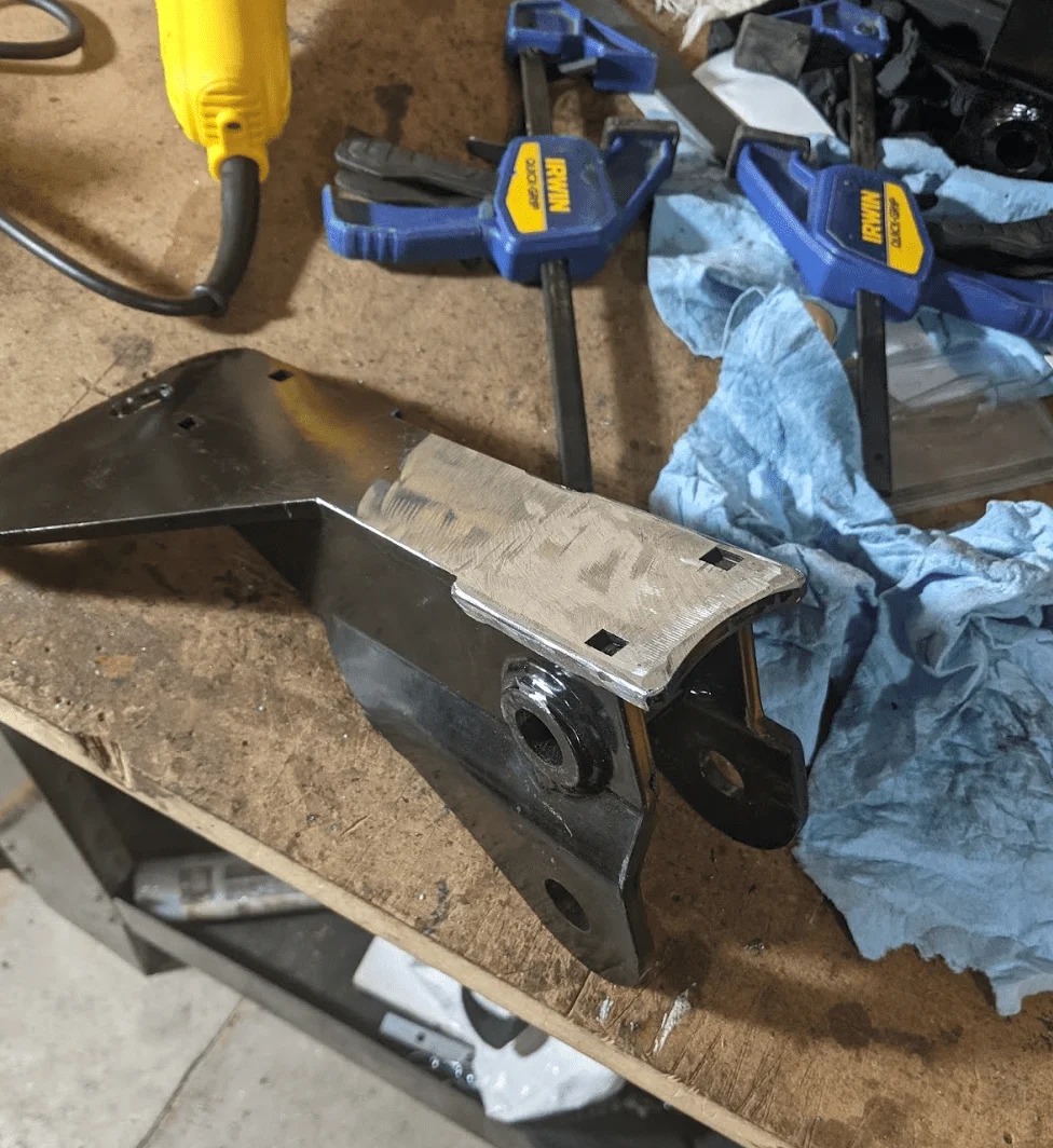

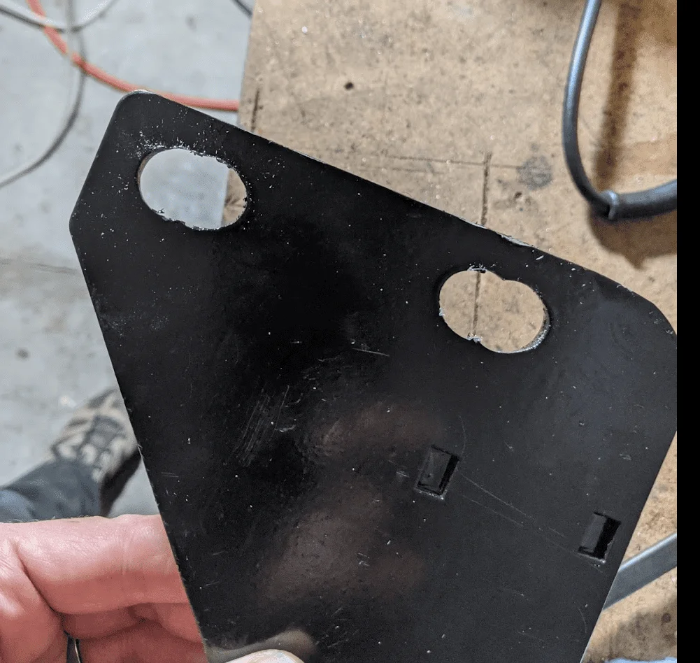

For caster correction I went with the MAF drop brackets for the following reasons:
- My usage does not include hard core rock crawling where clearance would be an issue
- I thought they would be easy to install (they were actually the hardest part of the whole installation since grinding + drilling was required to make them fit)
- My control arm bushings do need replacement (age not obvious damage) but they are in ok shape and I didn't want to tear into those just yet
- I didn't want to mess with caster bushings (no press easily available, plus reliability concerns) or caster drop brackets (no welder easily available)
As for the outcome I've been very pleased. The cruiser drives great on the highway, great on the trails, no vibrations, no twitchy handling, etc.. The only downer is that my older dog can't make the jump into the back on her own anymore (she tried but cased the landing pretty hard). Now I'm shopping for a dog ramp.🐶

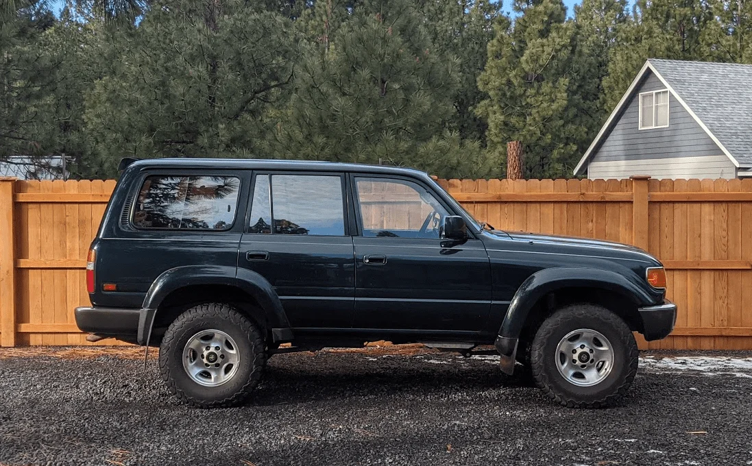

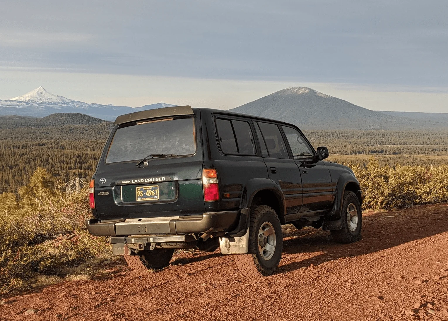

After the lift the center of the hub to the flare is 21" in the front and 22" in the rear (with about 150lbs of gear in the back). I'm running BFG AT KO2's, 285/75/16 with about 50k miles on them. I did not take caster measurements before or after the lift but it drives great down the highway with no vibrations (I usually don't go faster than 65/70mph).
With the IMS kit, 285/75s, 2" delta arms, on an empty gas tank and empty load I went from:
220V RIGHT FRONT 20" > 22"
223V RIGHT REAR 21.5" > 23.125"
220V LEFT FRONT 19.25" > 22.25"
223V LEFT REAR 21" > 23.25"
I don't have before and after caster measurements yet....(later this week after new rubber get installed).
Guessing this will level out just fine once loaded. As it is, I'm not gonna fret about an inch of sink bug :)
I had no idea had so much stink bug before the lift either, especially since when it was loaded out the rear measurement was about 17"
Ride is fantastic, as well mannered as before the lift, ride is firm, but not harsh or slamming, but more confident in turns, steering is tighter, drives like new. there's a 1/4 mile dirt loop behind the airport nearby, feels great on that bump and thump fest too. Really excited to try loaded out.

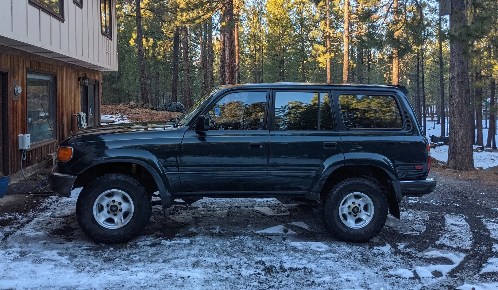

I am extremely happy with the springs in combination with oem tokico shocks. It rides very smoothly with little jarring over potholes and feels controlled. The stance is slightly raked up to the rear which is fine as it will be level with some weight. It’s just enough lift you can run 315 or 285 tires comfortably.
I had a Ironman 2” lift previously that rode rough although the shocks probably had another 1” of travel vs oem Toyota.
I will post some pictures when I’m back home from work.
