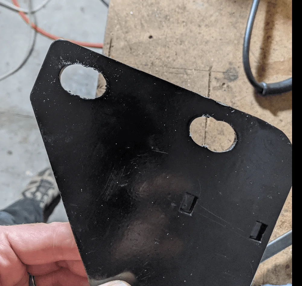

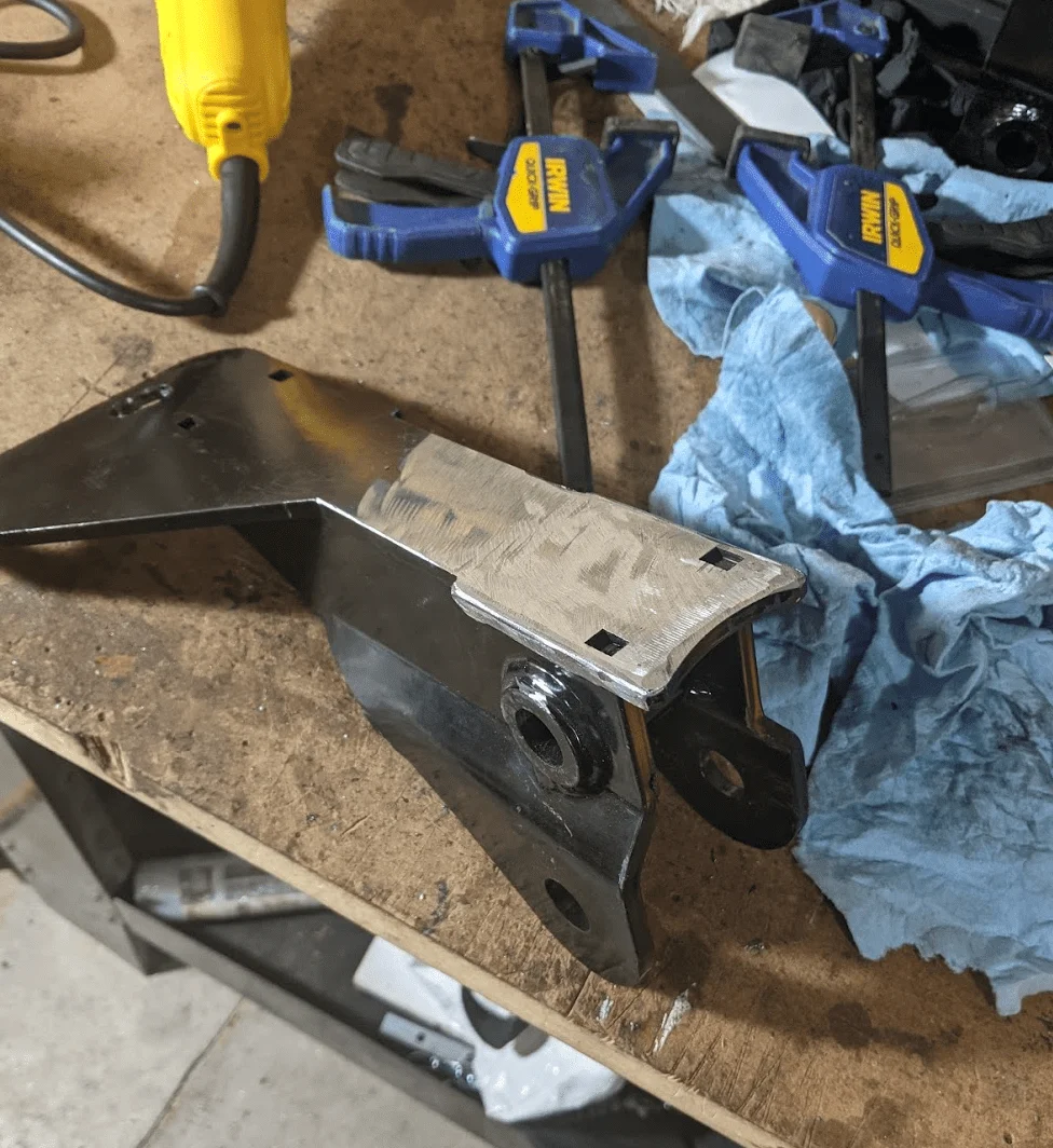

For caster correction I went with the MAF drop brackets for the following reasons:
- My usage does not include hard core rock crawling where clearance would be an issue
- I thought they would be easy to install (they were actually the hardest part of the whole installation since grinding + drilling was required to make them fit)
- My control arm bushings do need replacement (age not obvious damage) but they are in ok shape and I didn't want to tear into those just yet
- I didn't want to mess with caster bushings (no press easily available, plus reliability concerns) or caster drop brackets (no welder easily available)
As for the outcome I've been very pleased. The cruiser drives great on the highway, great on the trails, no vibrations, no twitchy handling, etc.. The only downer is that my older dog can't make the jump into the back on her own anymore (she tried but cased the landing pretty hard). Now I'm shopping for a dog ramp.🐶

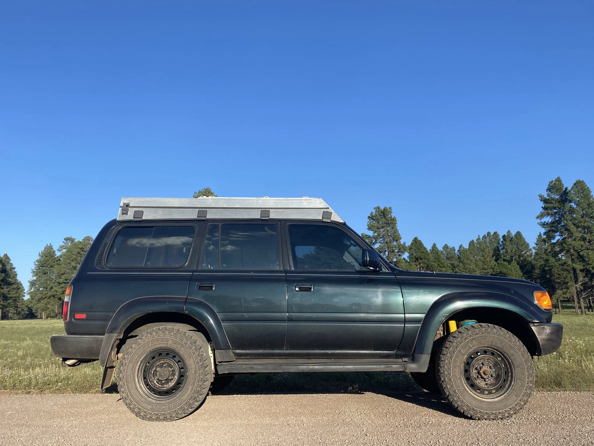

As promised, here’s how that sits. This is unloaded shot with iPhone--should have brought a 50mm lens to avoid the slight distortion. Anyhow... Nice smooth ride, eats up the washboards, and corners without body roll. I like it. We’ll see how she ages and holds my touring weight.

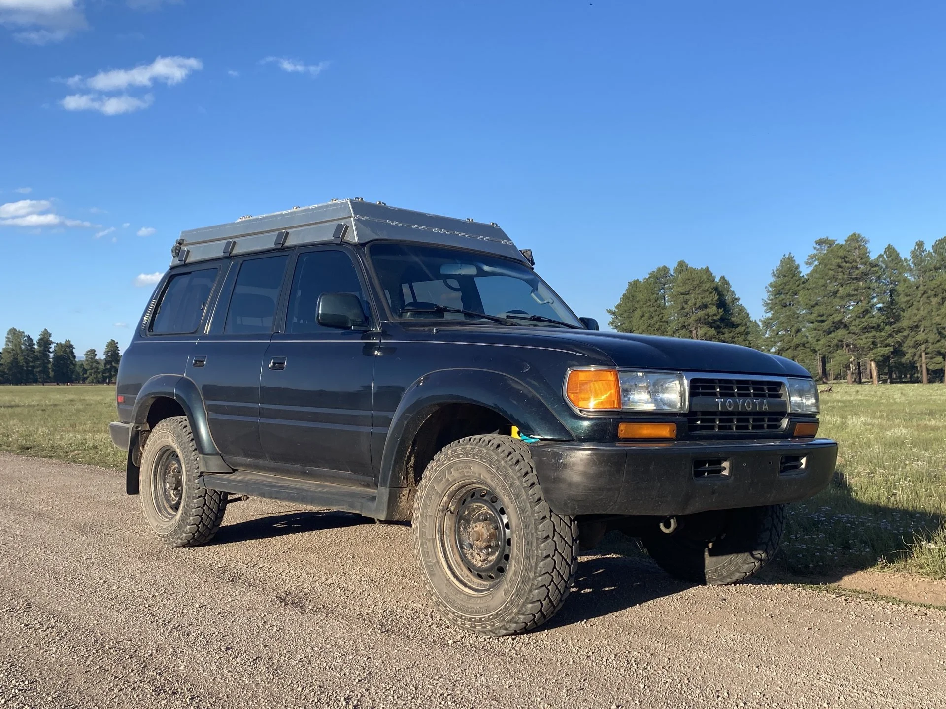

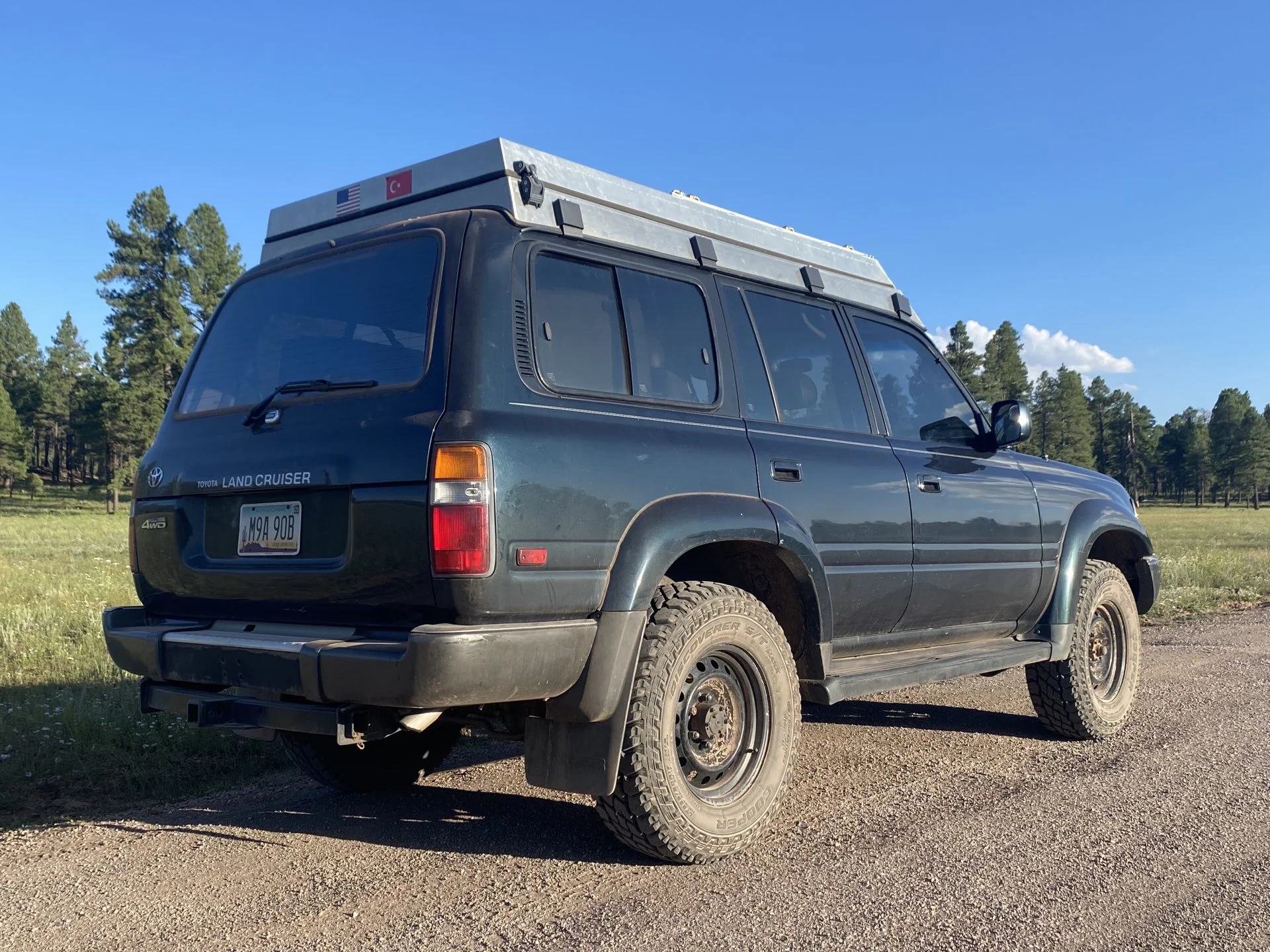

Would you mind post up some photos of how they look at ride height with the truck just sitting on the ground? Many people ask me for photos (for some reason) but I don't have any saved of the 220V, 222V, or 223V's. I think they want to see how the variable rate sits, like how many top coils are touching and how far apart the bottom turns are.
Good stuff! I’m wanting to run some variant of these springs with 255/86R16’s. Waiting to see how it settles our once I get my diesel in, before I commit to a certain spring. I’m also a fan of pictures. 😂
That's really great to hear!!
Standby.

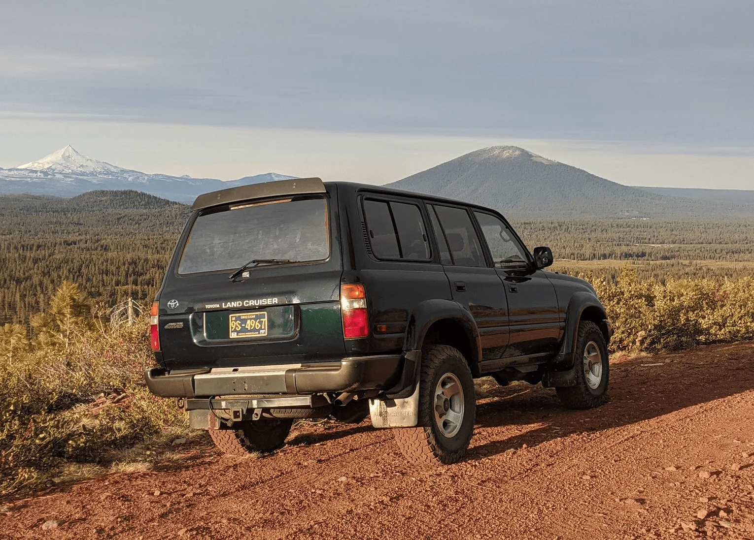

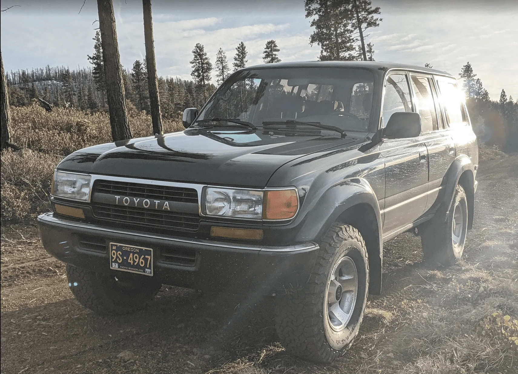

I installed the 222V/223V springs and Dob's IMS shocks on my rig in November 2021. I have probably 3K miles and about 6 off-road adventures on the setup right now. I'm very happy with it. I did install 20mm spacers up front and 15mm spacers in the rear. My truck sits perfectly level, and I actually wish it had a bit of rake. I might go back in and install 30mm spacers in the rear. My truck feels much more composed on the trail now, and I don't have such nosediving in the rollers on the trail. I can move much faster over rolling terrain without fear of bottoming out. The springs do feel pretty stiff in the rear, like when I drive over seams in the road. My old TJM progressive springs were much softer, but that is part of why I got rid of them. They couldn't handle any load. I have a 55Q Dometic fridge in back and usually at least another 100 pounds of food, water, recovery gear even on light trips.
Overall, I'm very happy with my Dob's setup. No one setup is ideal in all situations, and it's hard to buy such expensive parts without being able to drive the options back to back in same circumstances to really test them. But I'm happy with what I have now and I don't plan to change it again.
