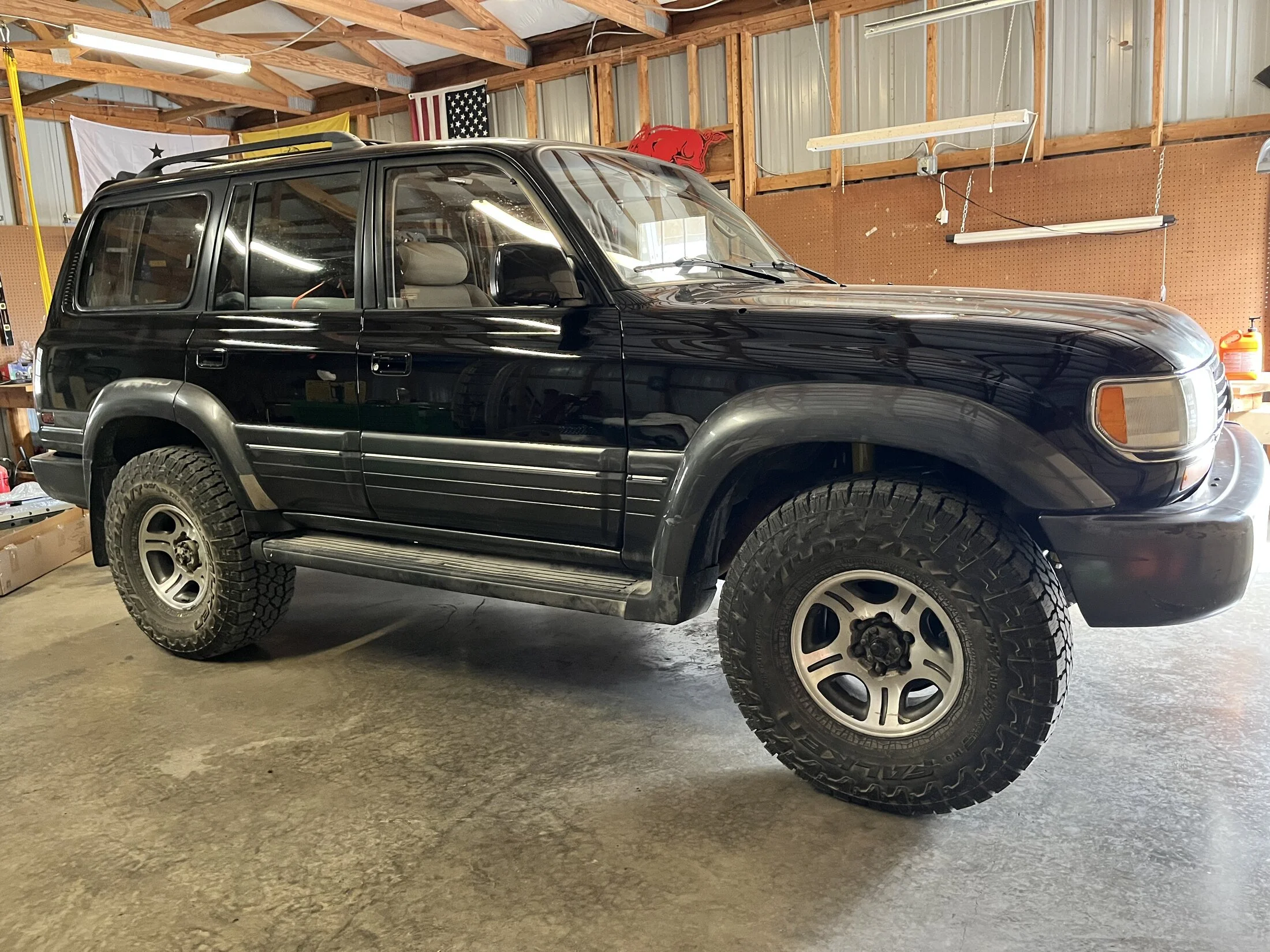

Report, I got these installed yesterday and love them. Ride is not harsh at all and I'm running the basic yellow dobinson shocks, didn't even get the ims that I was planning on. Saved me good amount of money. The entire kit installed with shop labor was 1500 which is cheaper than just the ironman lift kit stage 1 by itself without labor.
Bumps seem smooth on the road and the height is perfect. I'm not running spacers and I have a rear dual swing bumper with a 35 inch spare. Arb front bumper and it sits level. I am not running any caster correction and the rig seems to drive fine even at 70mph. I will get readings though and adjust as necessary.
Will have pics later. Will also test offroad. On the road it seems to ride better than stock and absorbs speed bumps with ease and smoothly. Special thanks to Mike at exitoffroad for answering my questions regarding this lift.
Here she is. Perfect stance in my opinion. Car is on a slight downhill. Front may go down a little once a add a winch, we will see. This is the 222v/223v combo

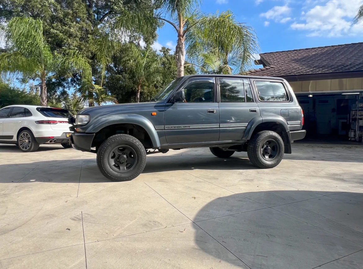

While these coils are by far the nicest I've experienced in an 80 (and ive driven alot of different 80 setups), I would like abit more clearence and want to run 37s. Does anyone know what the closest 3" coil would be to the 222/223v combo as far as ride comfort and general characteristics. Thanks

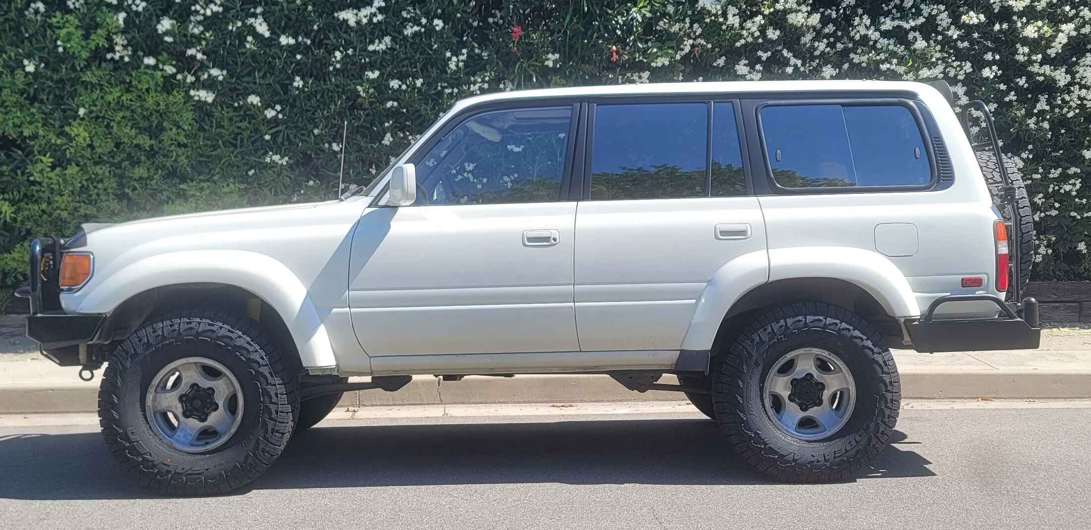

Thank you to everyone who contributed to this thread, you played a huge part in helping me make a decision for my daily setup.
222v/223v paired with IMS shocks.
22.5 on all four corners (stock weight with no spare, no third row)
Shouts to @crikeymike for the swift transaction and extra goodies :)
After about a week, the springs have settled to 22 on all corners.

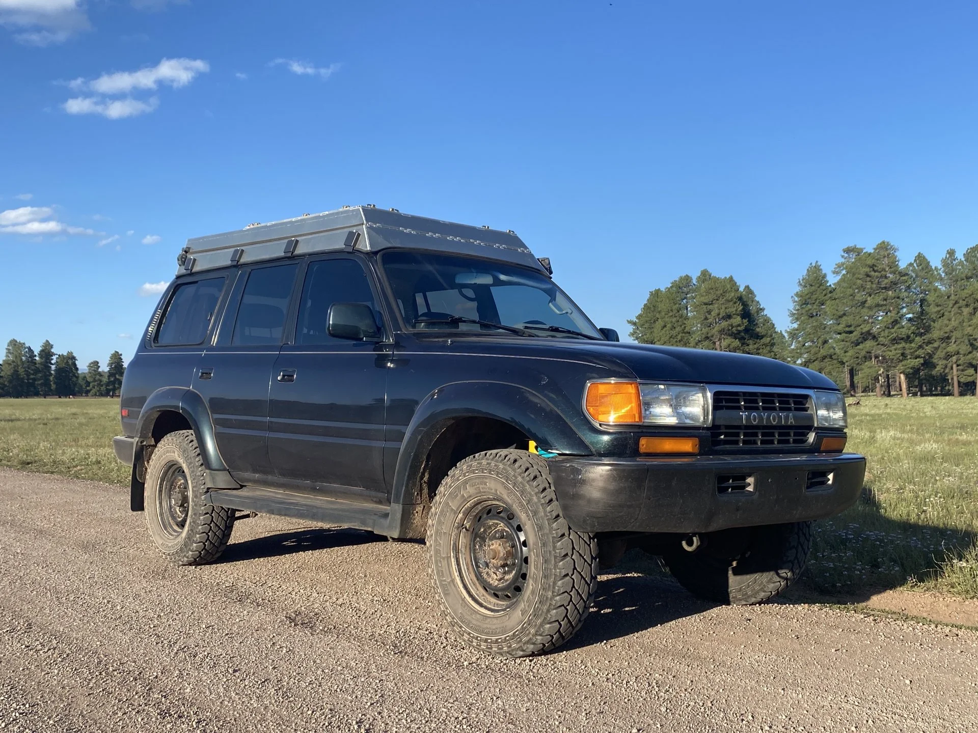

I ended up with the 234s up front as the 220Vs were back ordered for several months. Tires are 315/75/16. 223V in the rear
As promised, here’s how that sits. This is unloaded shot with iPhone--should have brought a 50mm lens to avoid the slight distortion. Anyhow... Nice smooth ride, eats up the washboards, and corners without body roll. I like it. We’ll see how she ages and holds my touring weight.
