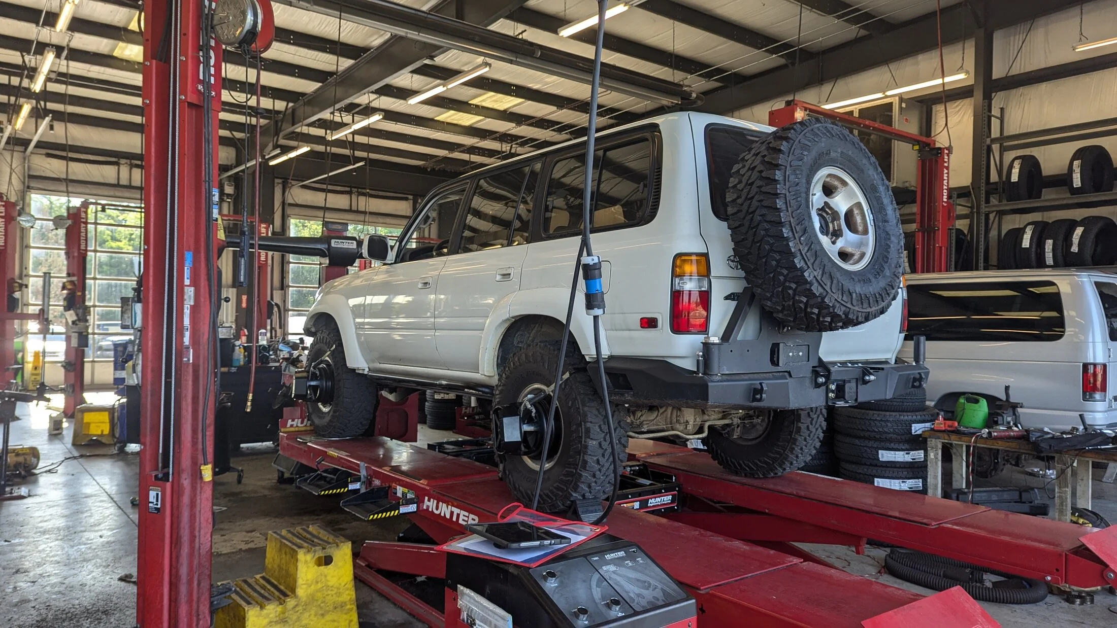

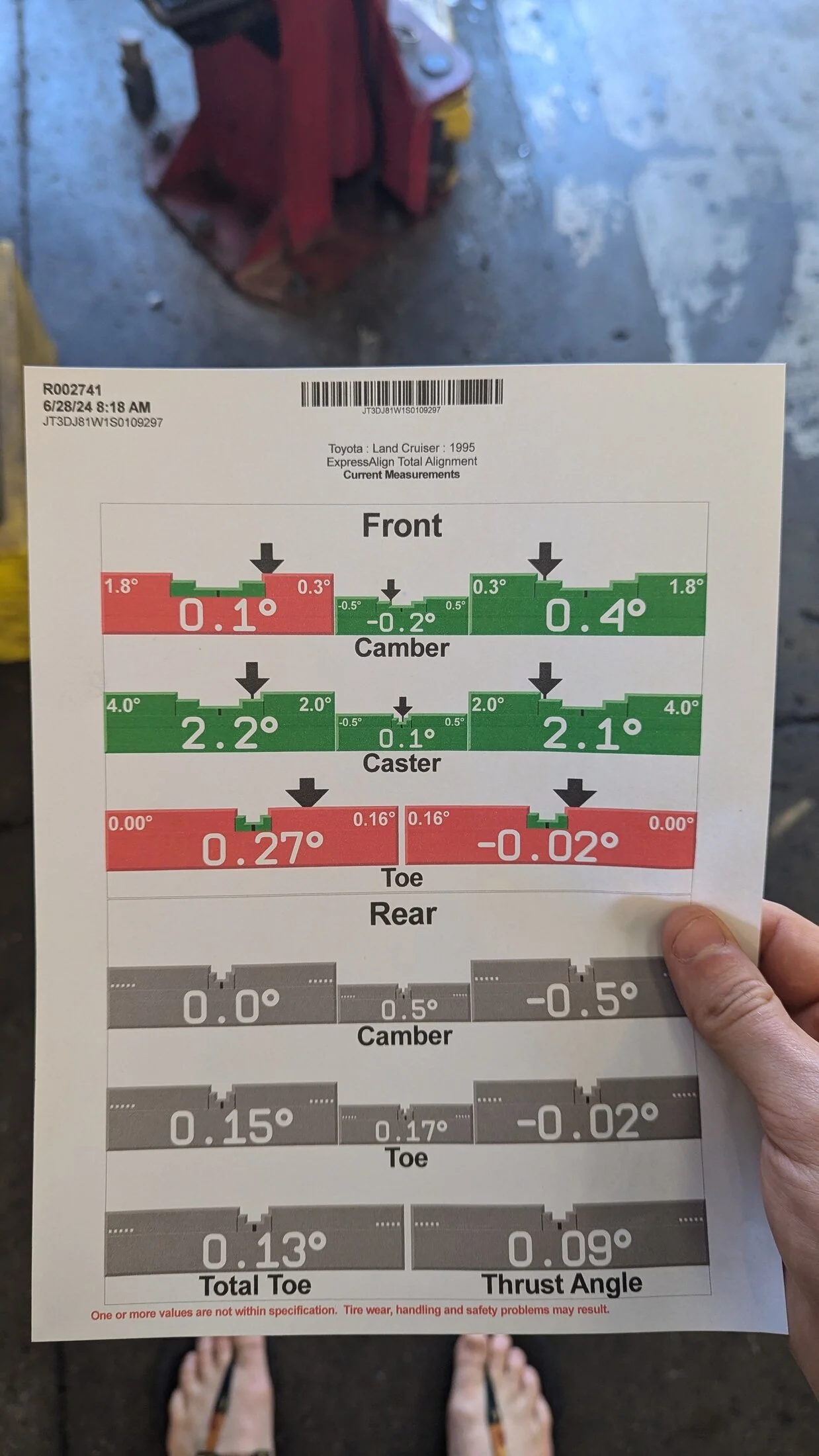

Got some caster numbers for my rig with the 222/icon rear combo with 2" @Delta VS arms. Truck handles pretty good but I would prefer a bit more caster for return to center, tracking, and highway stability. I'm also planning on installing an HD swaybar which should help.
I also have a set of 3" arms - those should put my caster right at 4° and that's exactly where I'd like to be, but I suspect the u joints / pinion angles won't like it. I have new driveshafts coming on the brown truck this week since my slip yokes have play. We'll see if a fresh driveline can handle the increased pinion angles. If not it's decision time- either

My current hub to flair measurements are 22.5 in the front and 23.5 in the rear unloaded, darn near perfectly flat with a weekends worth of gear.
I really dig the ride height but I could lose an inch and be fine, I'm no crawler, too attached to this rig to trash it on the really challenging stuff.

Rear toe variance could indicated worn out bushings, wallowed out bolts/sleeves/mounts, or bent upper or lower arms.
