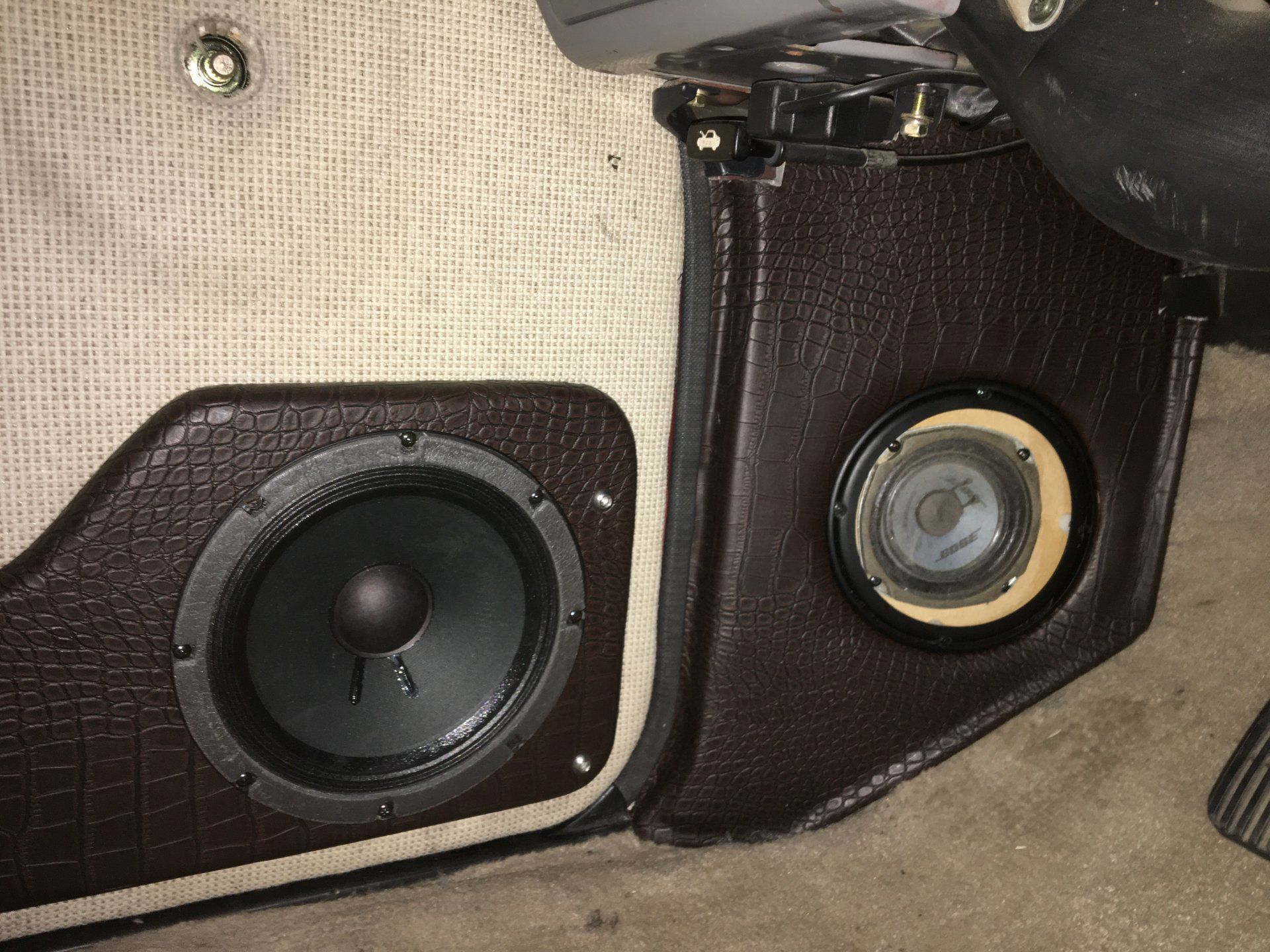

I now have 8” drivers in the doors and a double din HU in the dash. I added some 3/4 inch baffles.. no where near stock anything but I love it
Do you have a picture of that from another angle, I think you’ve put it near where the ecu would be and somewhere on the door but Is it in the door where there’s a larger opening? That’s one spot I was thinking I could put something larger, with a diy adapter.
what speaker are you using?
My ecu is under the hood ( LS swap). The door opening was enlarged a bit. Those are Italian Fatal Pro 8” drivers courtesy of my brother Al. Bose 4” midrange in the free air kick baffles and I have a 1” sulk dome tweeters in the upper door card ( not pictured). 12” Infinty kappa Perfect in a downfire sealed enclosure to round sub bass freq. It’s a simple 3 way active soundstage driven by 3 Japanese Denon SQ amps. Sounds pretty good but I haven’t played with tuning yet

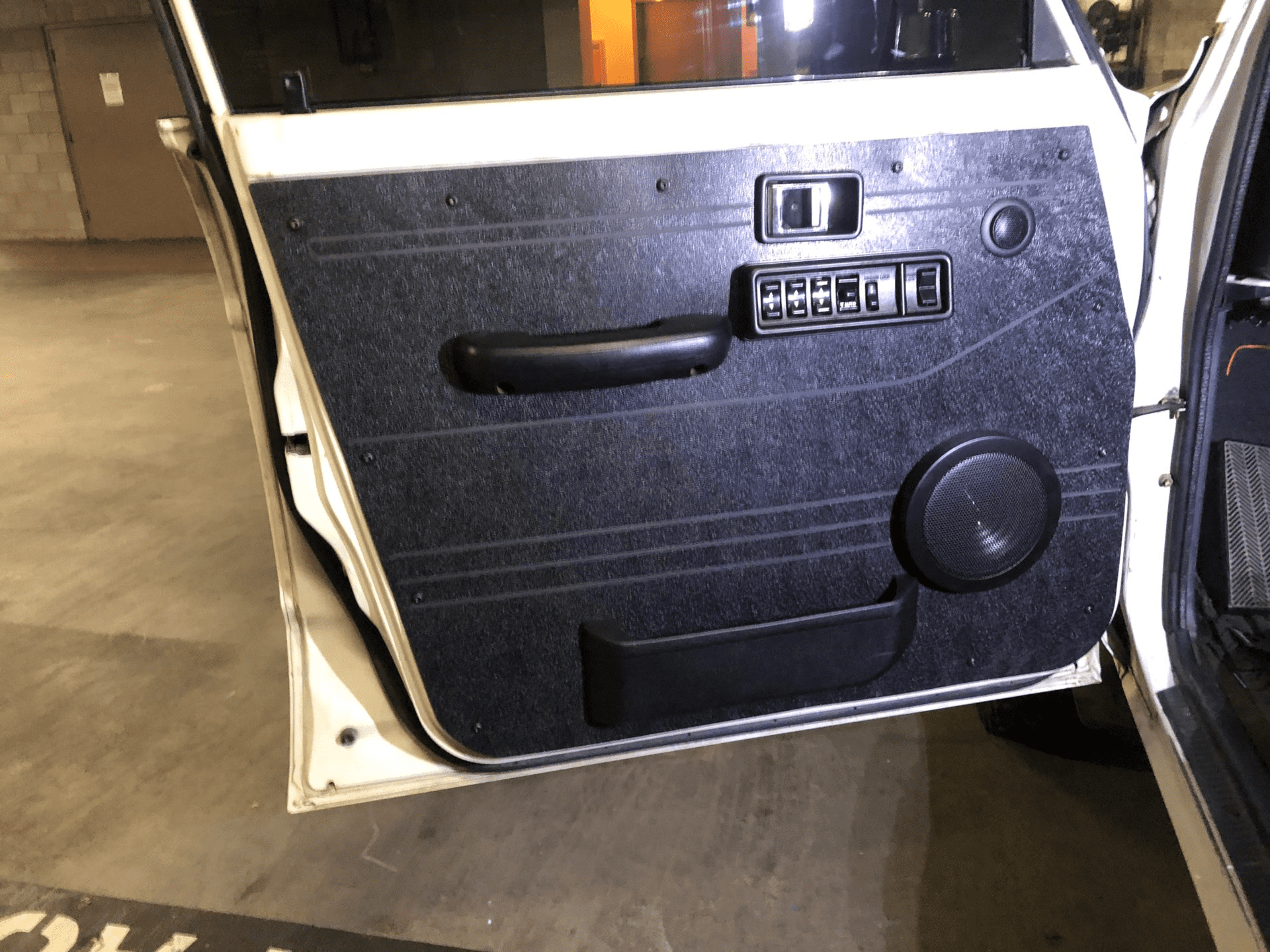

I have a pair of angled speaker rings (3/4" at their thickest, 1/2" at their thinnest) that I'm going to try to mount a pair of JL Audio Evolution 6.5" speakers with. Idea is to have them angled slightly up and back. The speakers are shallower than the older style, so my hope is that the section of cone that passes through the door will fit through the 5.25" hole (which I can modify if need be, but hoping not to). Planning on building a fairly nice system if that works out, so fingers are crossed.

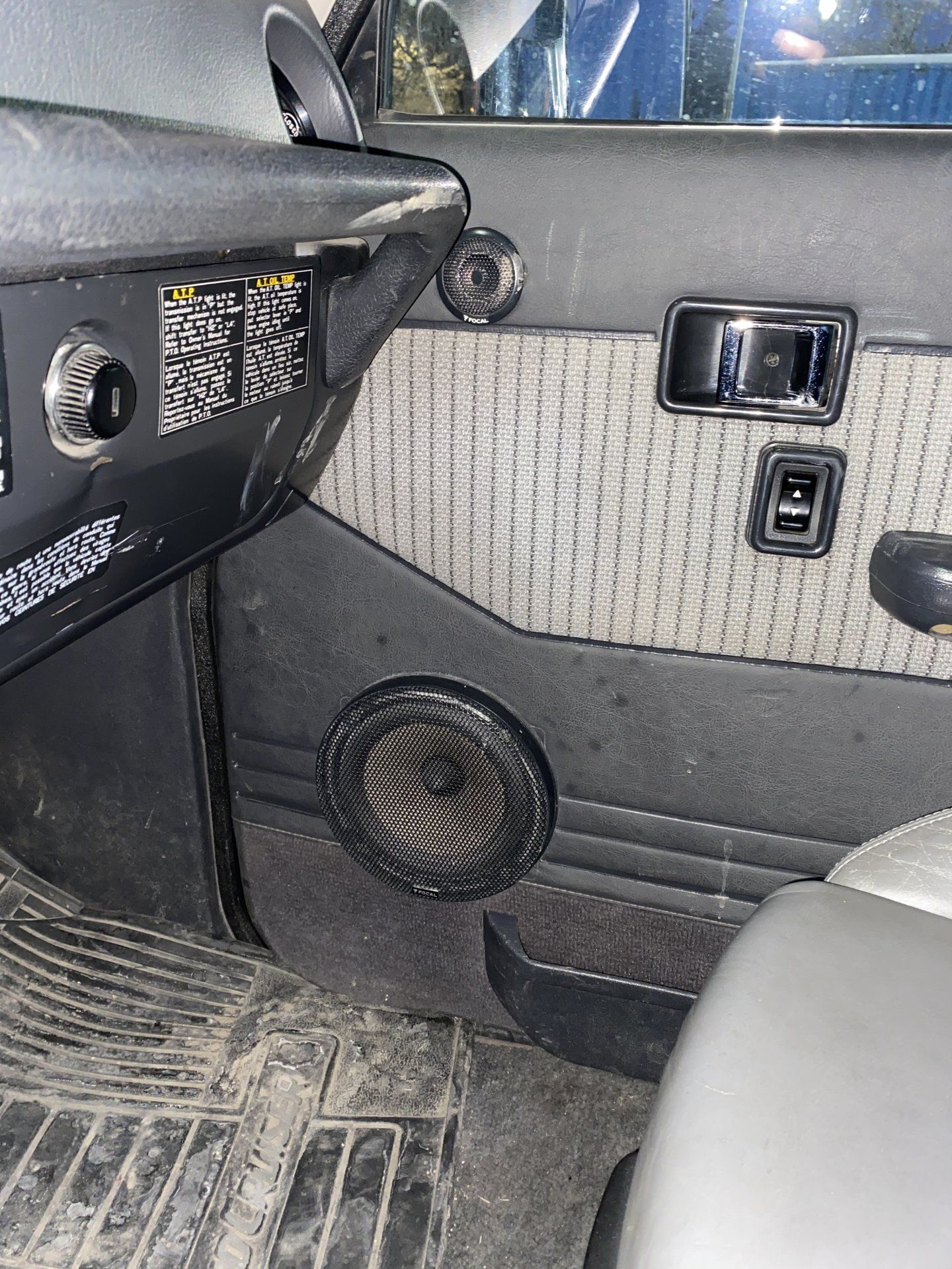

i have focals in my truck. love them. this is how i set them up. there is a small spacer between speaker and the door card. i also put a vented plastic speaker cone cover to keep any water off them that might leak into the door from the window. it wasn’t vented to start with and really affected sound quality. i took the old grille in and got it paint matched. i painted the focal grille to match. it looks pretty good and sounds great. i have 6.5 rounds in the back (not component). sorry my truck clearly needs an interior wash. and i never hit my feet on them they don’t get in the way sticking out the little that they do
That’s exactly what I was hoping for. Get them out enough so the narrower part of the cone passes thru the 5.25 without trimming the frame.
I like the idea of angling them.

i have focals in my truck. love them. this is how i set them up. there is a small spacer between speaker and the door card. i also put a vented plastic speaker cone cover to keep any water off them that might leak into the door from the window. it wasn’t vented to start with and really affected sound quality. i took the old grille in and got it paint matched. i painted the focal grille to match. it looks pretty good and sounds great. i have 6.5 rounds in the back (not component). sorry my truck clearly needs an interior wash. and i never hit my feet on them they don’t get in the way sticking out the little that they doView attachment 2576198
Not much of a spacer at all! Do you remember which model they are? I know the AS and the ISU didn’t look too deep when I took them out of the box at car toys. I was pretty sure with the door card as a spacer they could fit (but I bought a 1/2 spacer to use too)
I wasn’t sure the cone would pass the 5.25 frame cutout. Did you have to cut anything besides your door card? Good tip on the vented cone.
i really dont remember if i cut my door. i did for the tweeter but i don’t think i did for the bottom. ill look tonight if i remember and let you know. ps 165 FXE is the model i have
