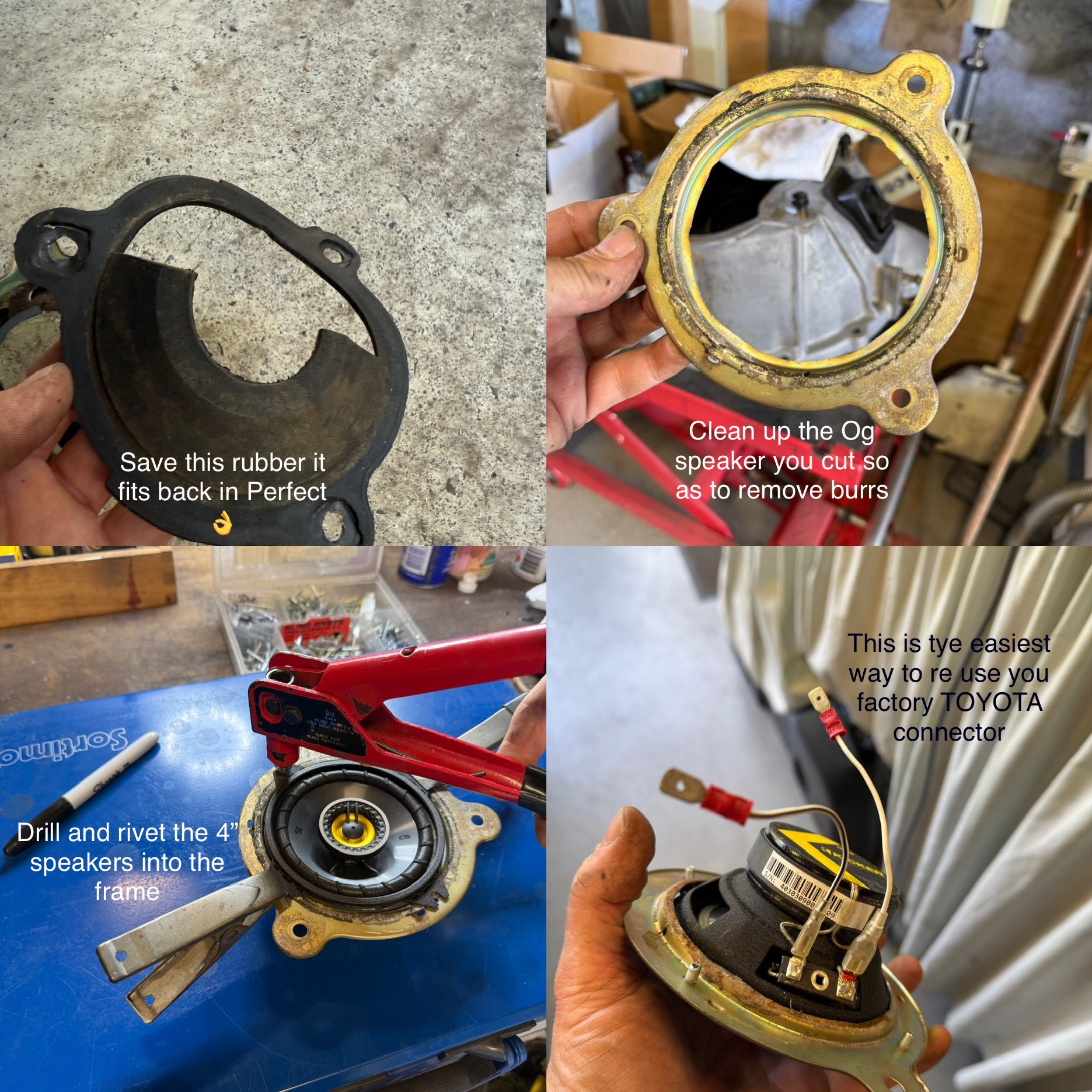

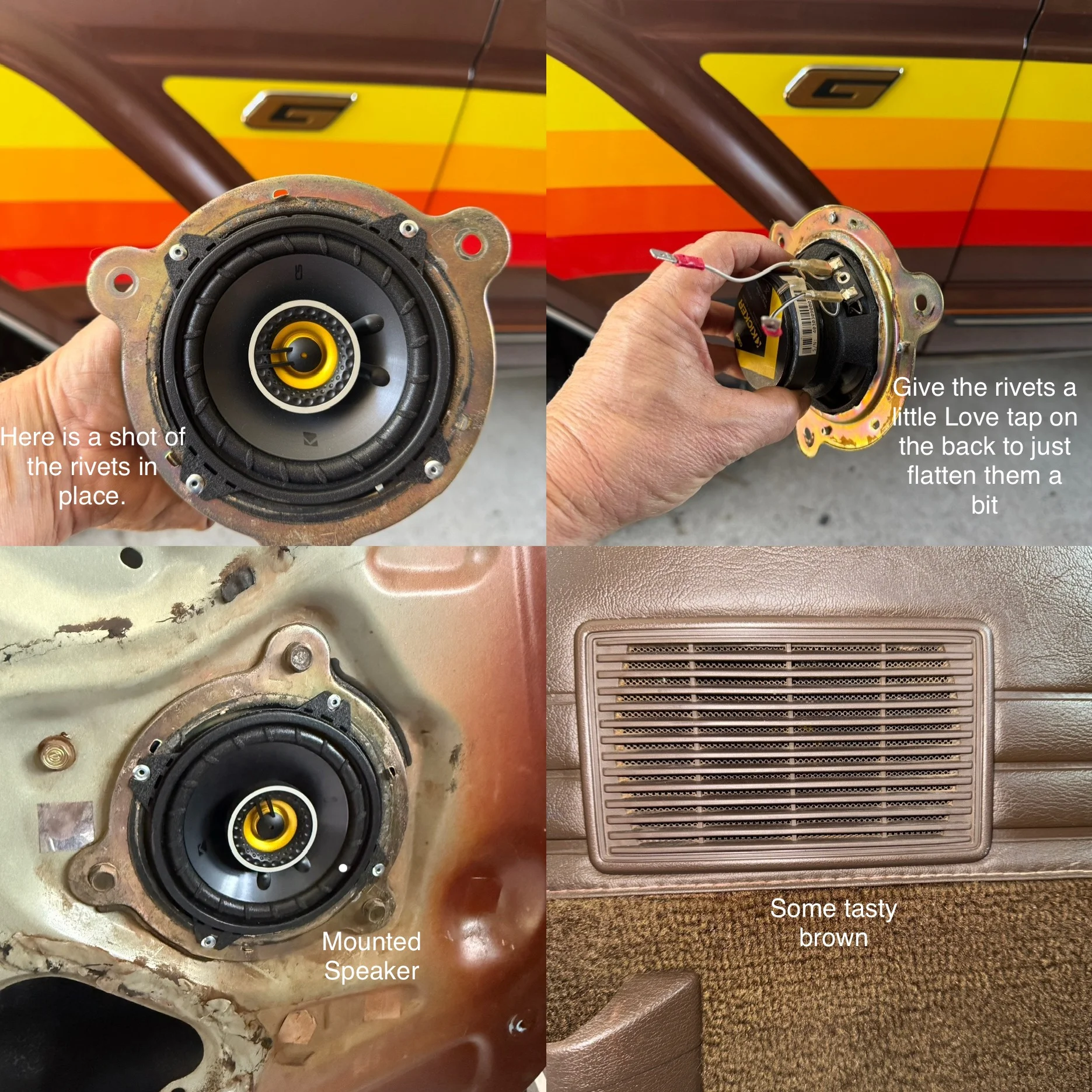

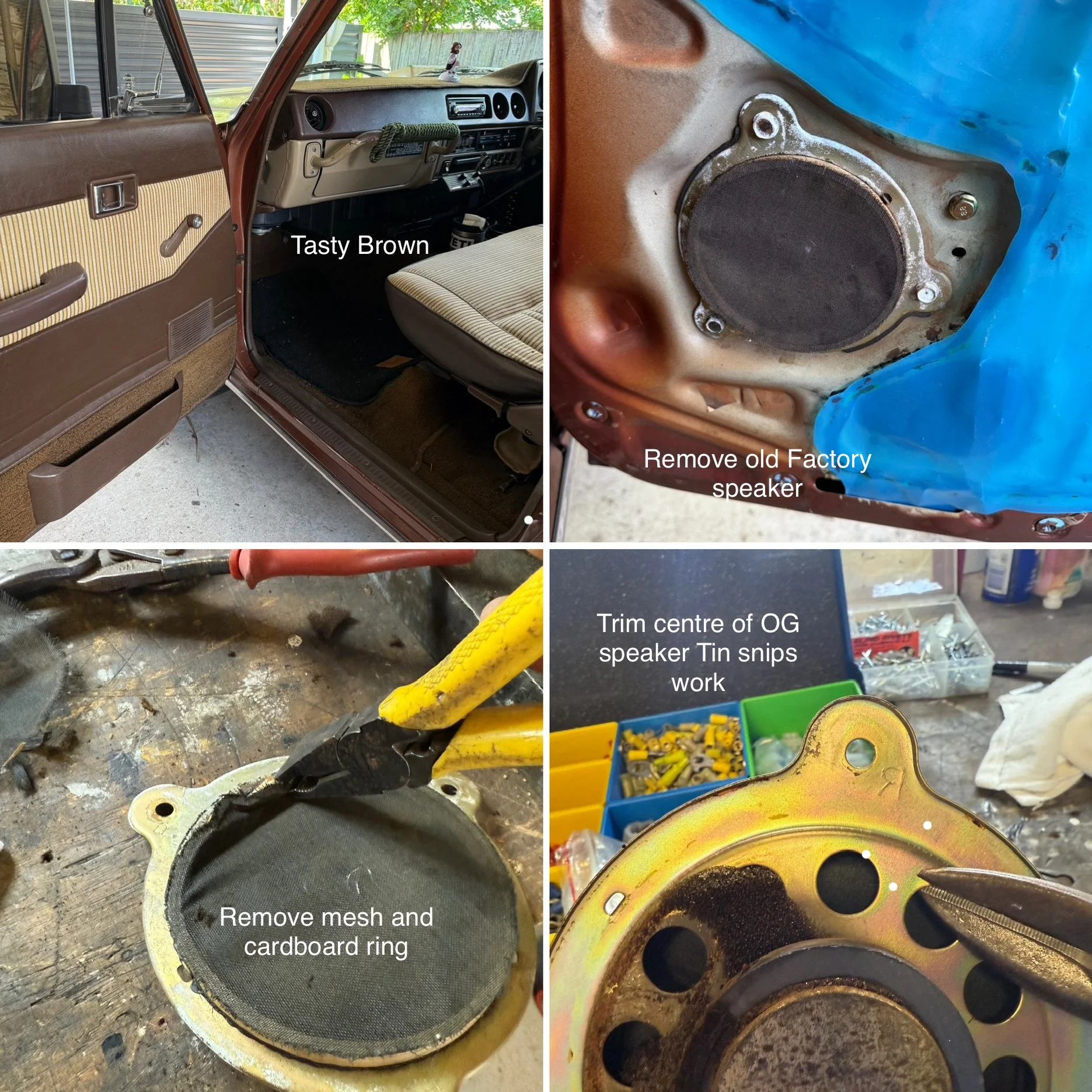

This is how I mounted my front speakers. I am very fond of the original colours and not messing up any of the “80” character these Cruisers have.

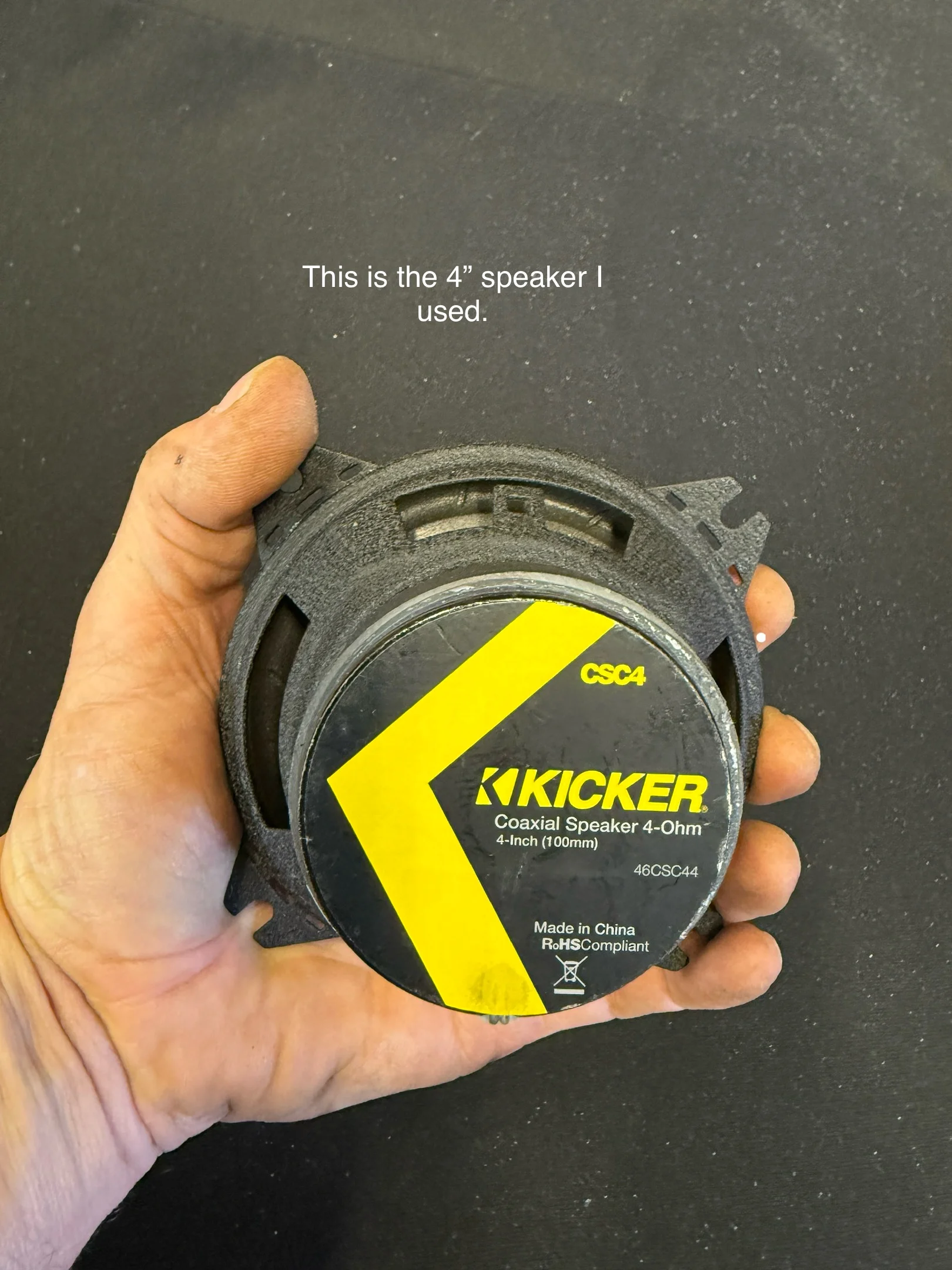

The speaker is a 4” kicker which seems to line up with the factory plastic grille and a actually has very good sound. Its not going to win a Sound off comp but will let you here your Nirvana tapes with ease😀
