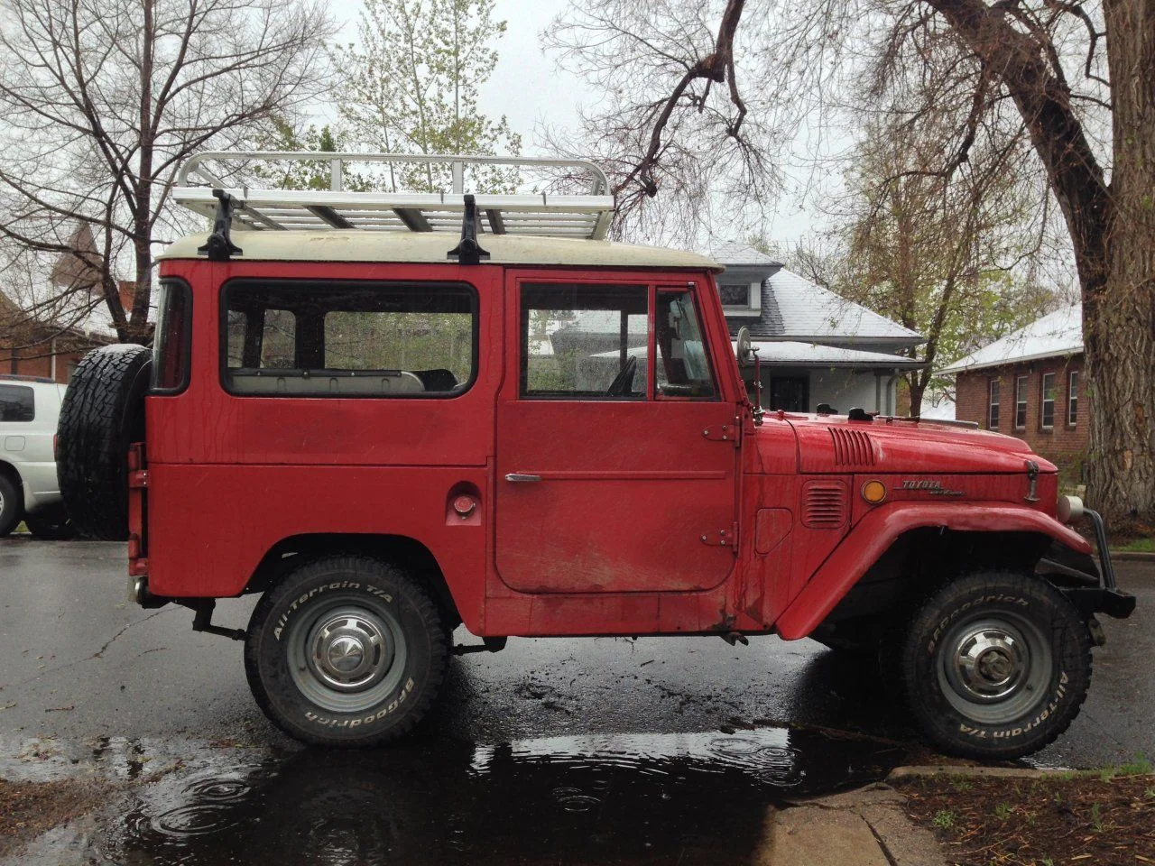

I drove my 74 from NJ to Colorado 3 years ago. The big rigs will blow your car sideways so slow down when you're getting passed by them. Also I went through 3-4 fuel filters because my truck sat in my parents garage for 12 years.
