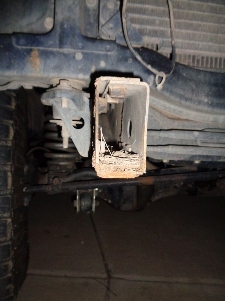

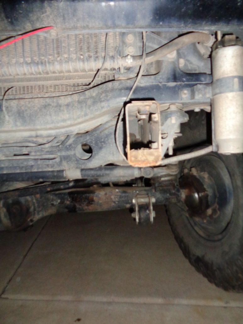

after having to cut my arb off the marshmallow due to mud filling the front frame ends and rusting the bolt, then pulling it off fat bastard only one year after putting it on to find this mess again, has anyone thought of cutting holes, like 1/2" or so in the bottom to help clean this out? these frame rails were immaculate when i put the bumper on. that's just one year of wheeling.

after having to cut my arb off the marshmallow due to mud filling the front frame ends and rusting the bolt, then pulling it off fat bastard only one year after putting it on to find this mess again, has anyone thought of cutting holes, like 1/2" or so in the bottom to help clean this out? these frame rails were immaculate when i put the bumper on. that's just one year of wheeling.View attachment 1167156 View attachment 1167157
Please dont cut holes in the top or bottom of the frame... that is where all the strength is!
