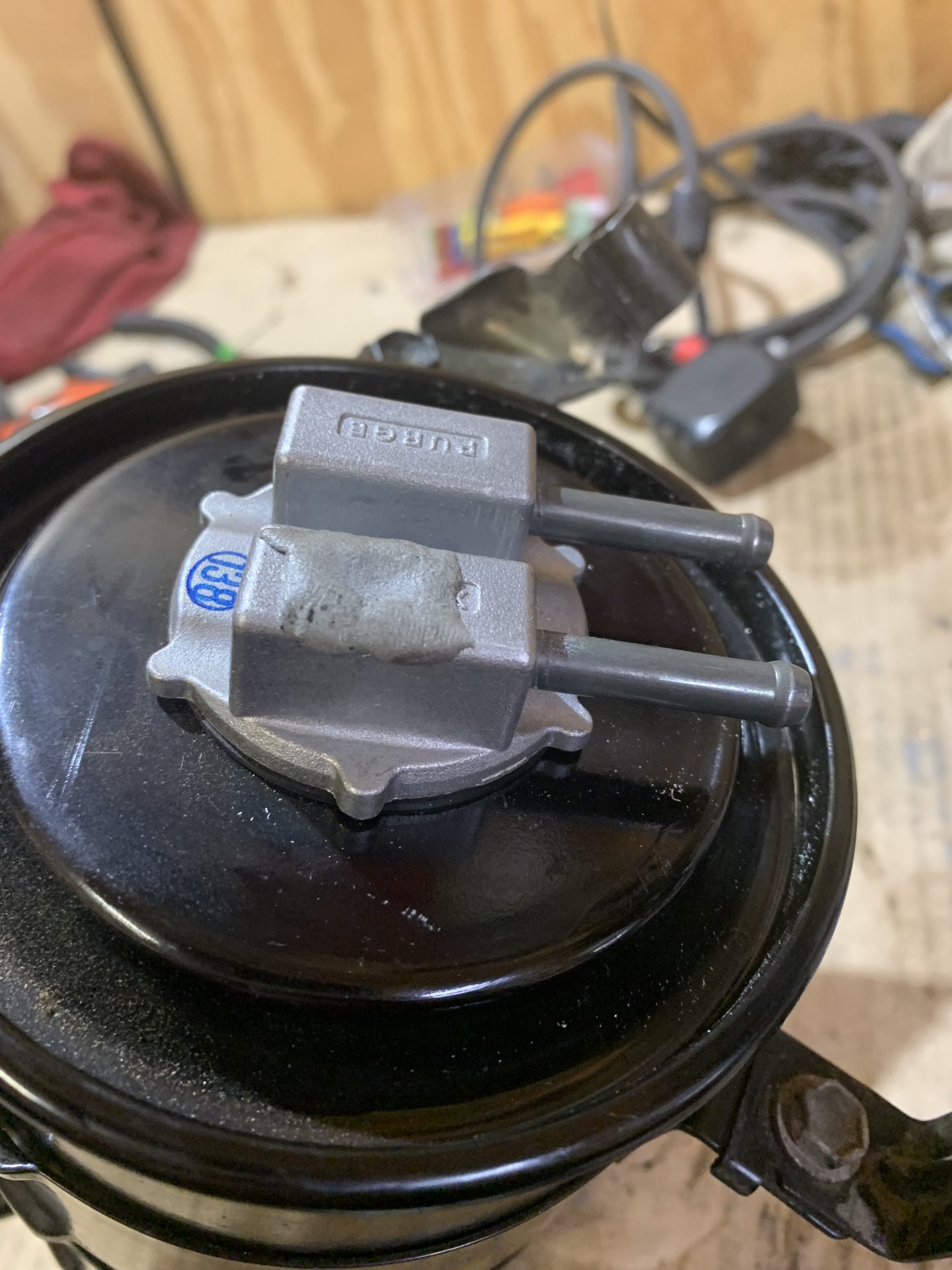

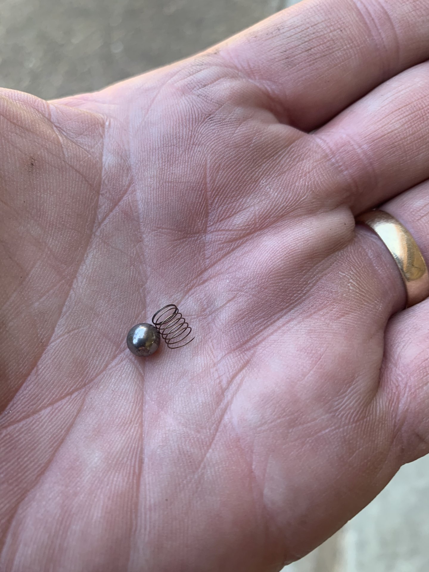

Haven't popped the lid off to drill out the BB, but did pull the line off from the tank (installed a small fuel filter) and blocked off the line running into the VSV. Fingers crossed, but seems like it may have solved the problem. Planning to complete this mod just to keep things 'stock looking'.

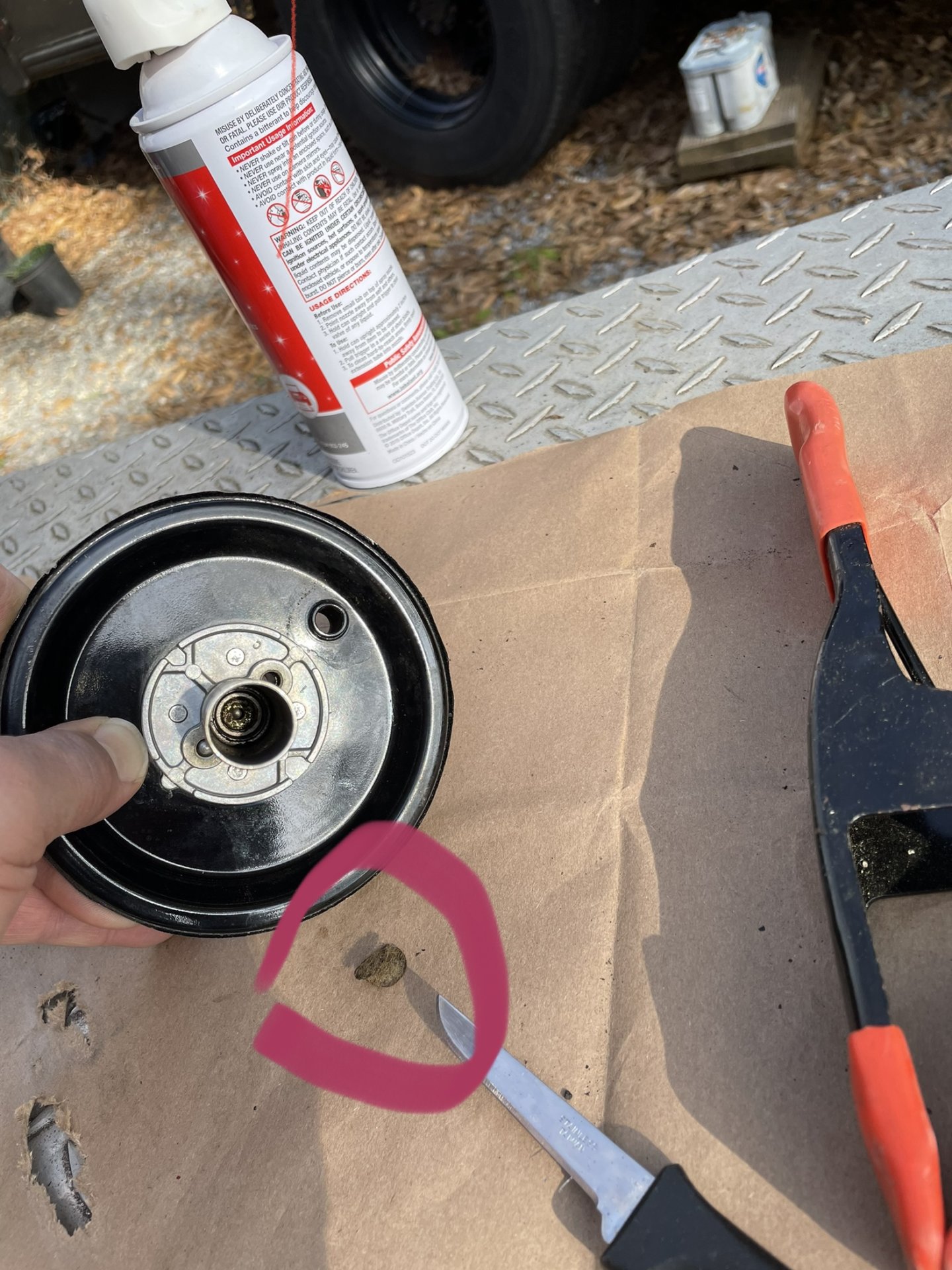

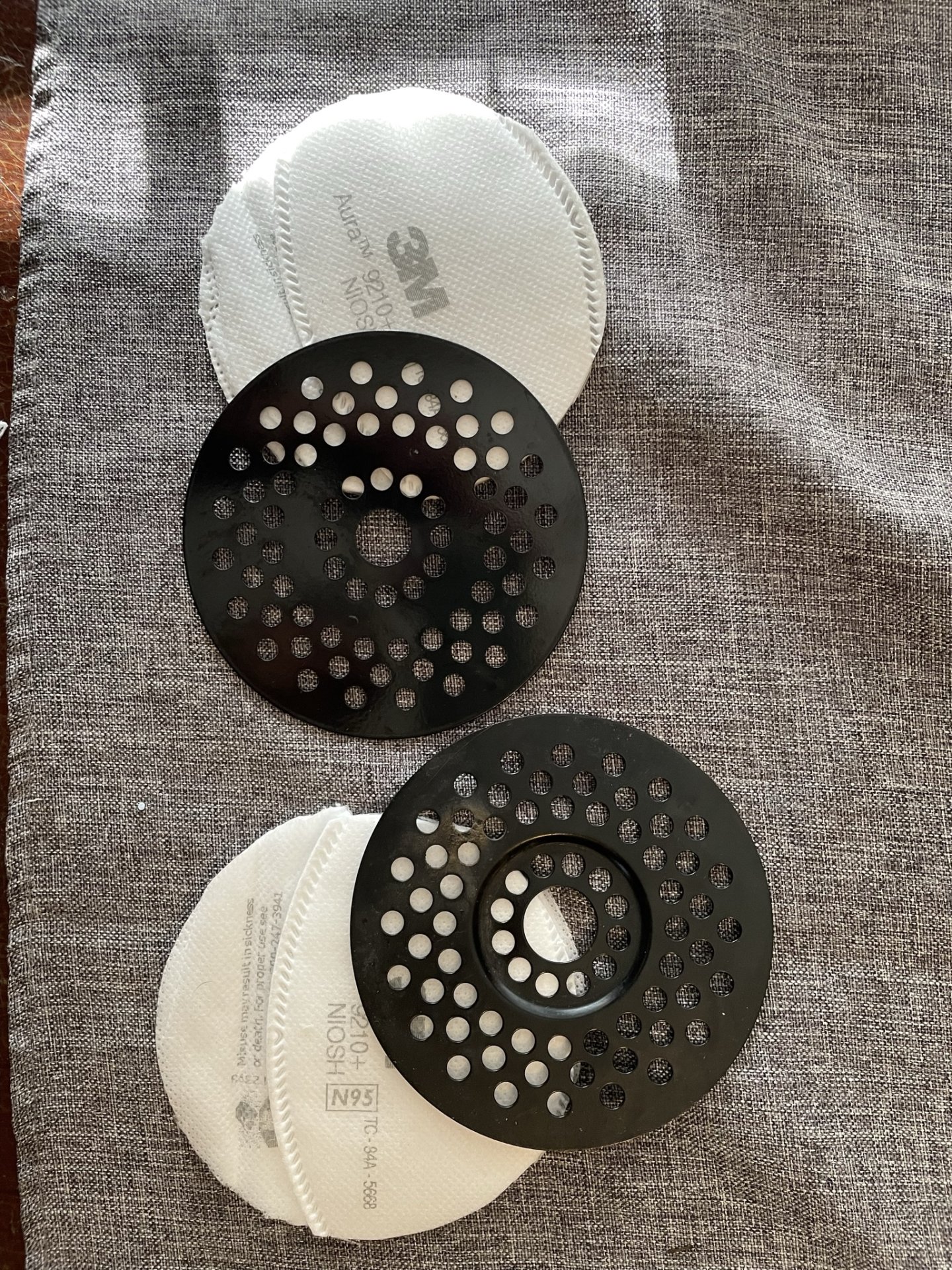

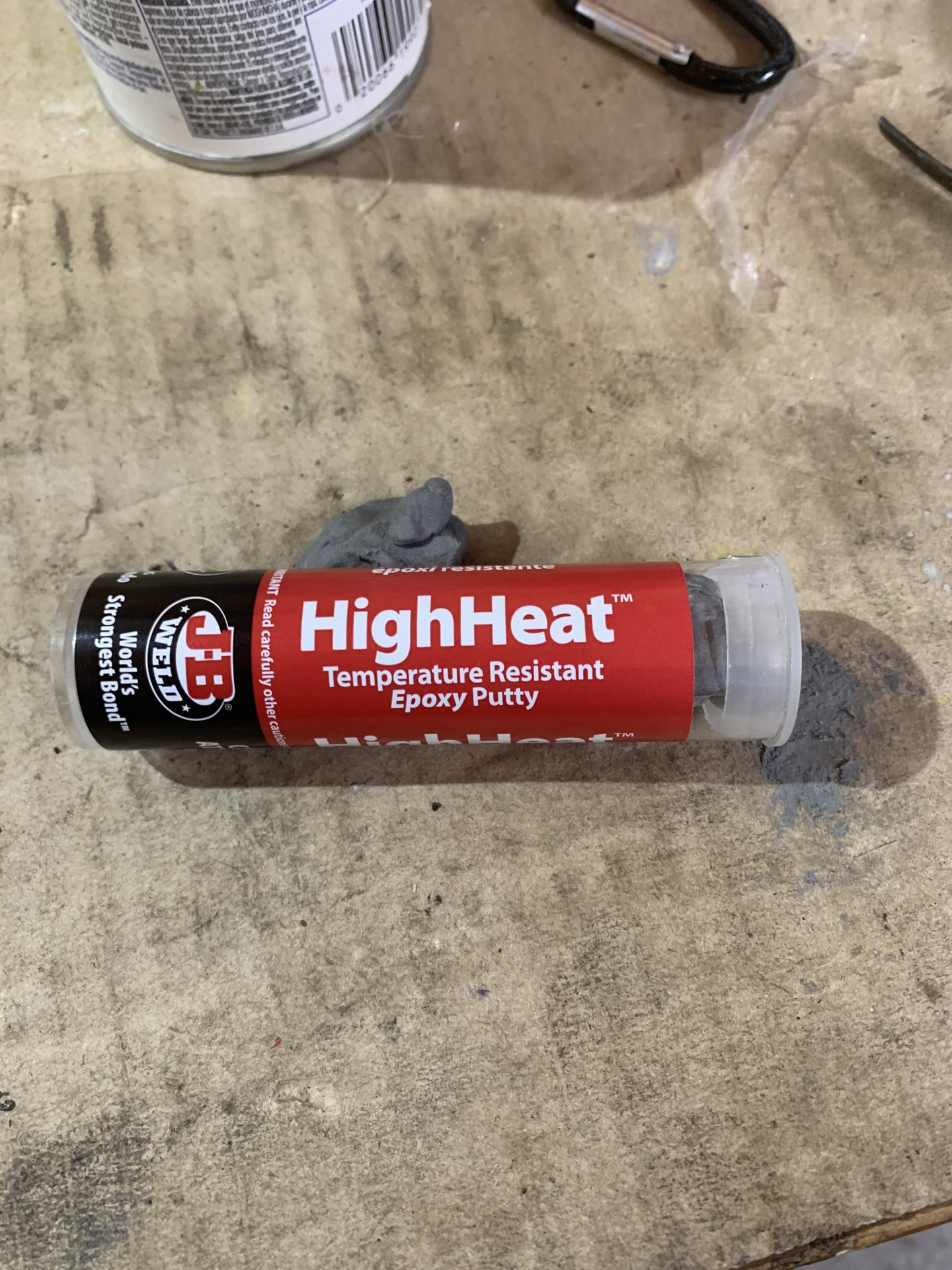

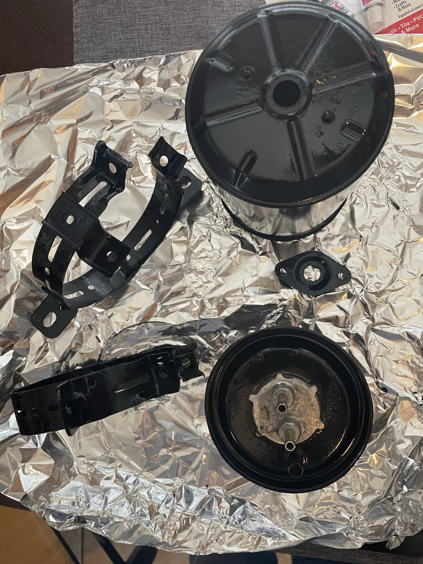

I didn't bother with epoxy when I did mine. Just cut it open very carefully and there will be a decent friction fit between the lid and the can. When you put it back together, just apply a coat of your favorite flavor of silicone gasket maker around the edge of the lid and pop it back in there. Stable enough it won't go anywhere, but easy to service in the future.Giving this thread a bump as I just got the canister open and drilled out the bb (thank you @LandCruiserPhil for the excellent write-up). Cleaning everything up this afternoon, adding charcoal, then epoxying it back together. Paint in the a.m. and install tomorrow evening.

Thank you for all of that. The gasket sealer sounds like a great idea.I didn't bother with epoxy when I did mine. Just cut it open very carefully and there will be a decent friction fit between the lid and the can. When you put it back together, just apply a coat of your favorite flavor of silicone gasket maker around the edge of the lid and pop it back in there. Stable enough it won't go anywhere, but easy to service in the future.
I definitely drilled out the BB on mine as well. I played with it for a bit, trying to understand how it was supposed to work. It was free to move and should have been free to vent as designed, yet my tank was OBVIOUSLY building too much pressure, venting for several seconds every time I opened it. A gas station attendant once said, "I think you got a snake in there!"No more BB, no more problem.
I used regular ol Toyota FIPG.Thank you for all of that. The gasket sealer sounds like a great idea.
