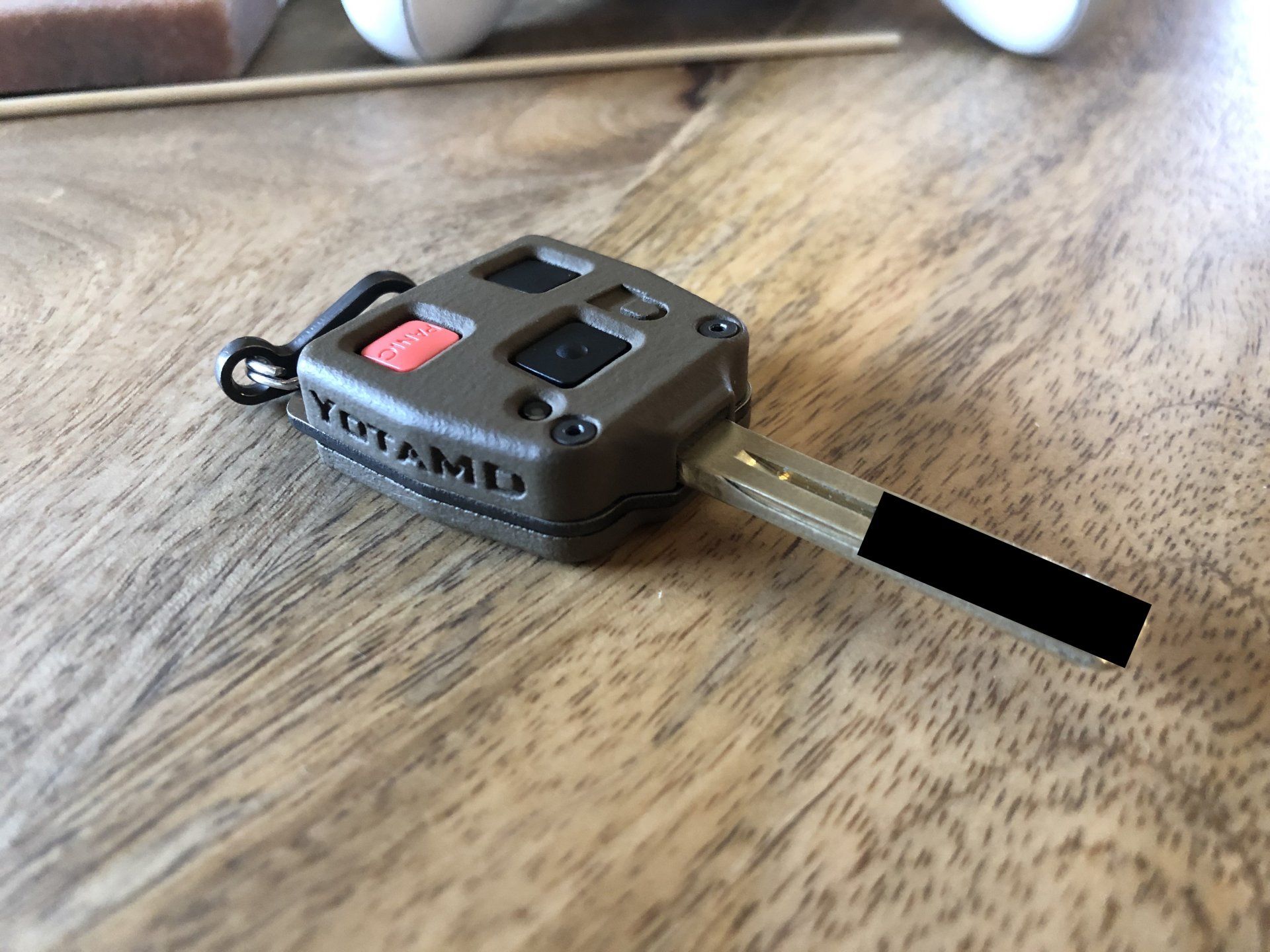

I ended up putting the transmitters in @suprarx7nut's YotaMD shells. Super nice upgrade. YotaMD.com - Home

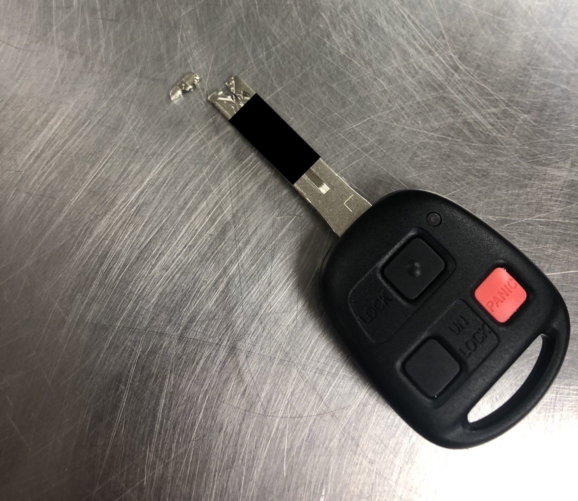

When I went into the dealer to have them cut a pre-assembled YotaMD key with a blank, the parts guy did a quadruple take on the blank key. It was funny to watch his reaction. "You want a key cut. Ok, great, let me see the ke...." awkward pause as he grabs the key and flips it over a few times... "Did you b..... this is.... Did... did we.... uh... hmmm. What is this?"

Thanks again for taking the time to research and explain this. One quick question... Am I totally SOL if my truck only came with a valet key?
No idea what the solutions are in that case. I do know that while you can copy the cut, there is no way to reset or add new master keys the the immobilizer with a valet key alone. That’s the point of the valet key (your valet can’t make a working copy).
I have seen videos of people doing key additions with some kind of computer program and cable, but you might still need a master key for that. You will have to look around on that one.

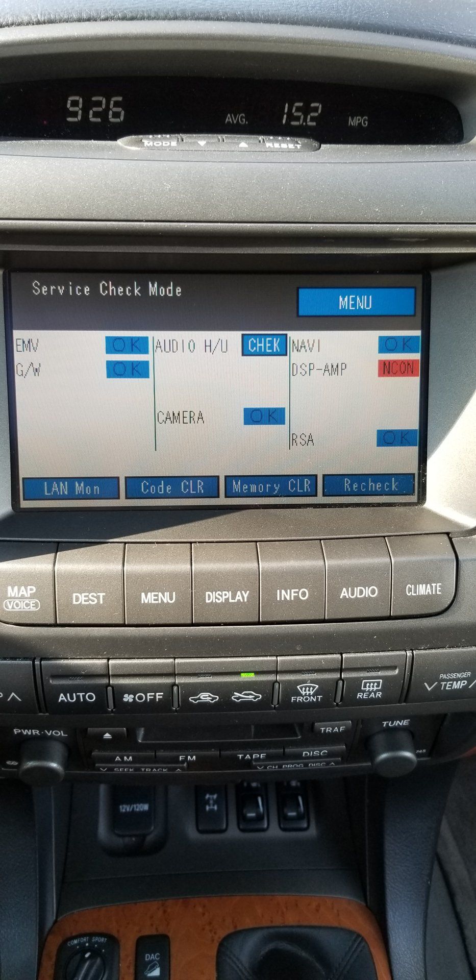

Seems like the ML amp is going out. Looks like some places repair this for $400. Anyone have clue what the repair details are?
EDIT:
More good details here:

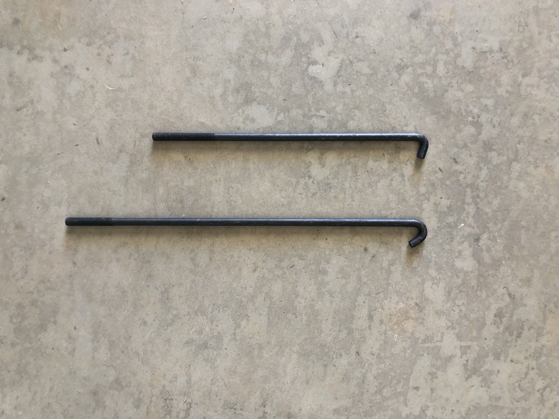

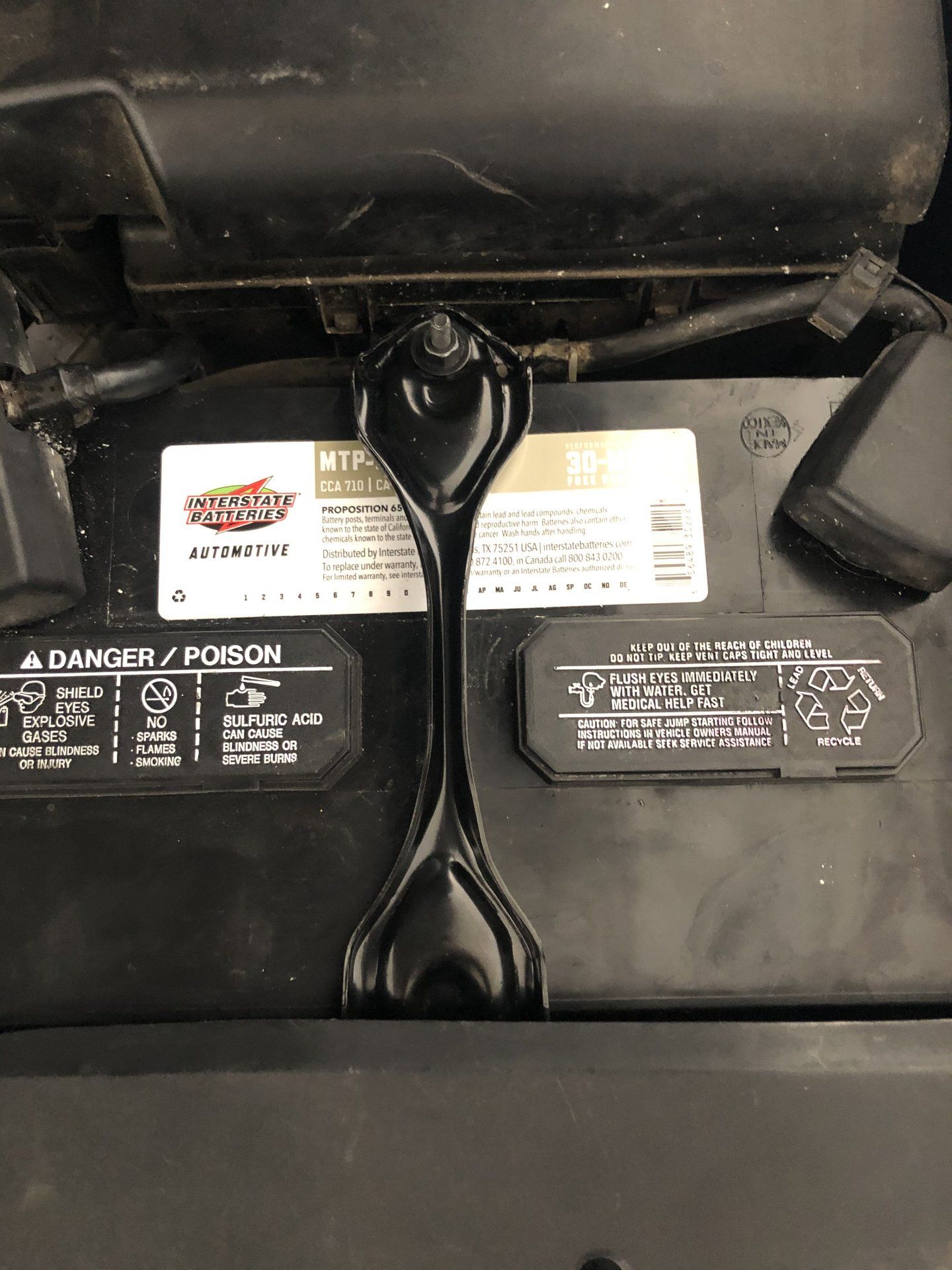

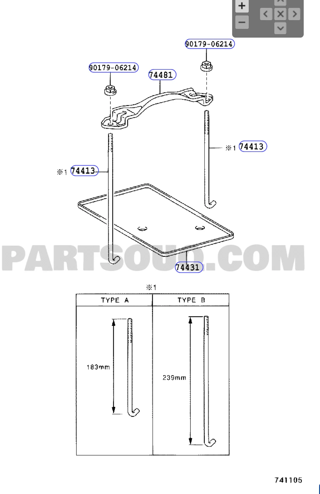

Dmall update, was missing a battery clamp, which now that I look at it, is at risk of falling down into the engine bay if you hit some big bumps.
There was some confusion over which j hooks I needed and it turns out you need both lengths, one of each:
I guess if you look closely you can see two different lengths.
74451-52071 239mm bolt
74451-30090 183mm bolt
90179-06214 x2 nut
74481-26020 battery clamp
Just got an update from United Radio regarding the ML amp.
- Bench tests fine...
- But my battery drain situation is almost always an issue with the amp.
- $475 for a refurbed amp, and they keep mine.
- If that doesn't solve it (or only partially solved the issue), then the head unit may have issues.
- Head unit (the take deck, knobs and buttons) is $189 to repair.
So... going with the refurbed amp, since from what I can tell, thats at least part of the issue, and is defiantly a source of battery drain when you shut the car off when the audio isn't working.
Happy to hear the head unit repair is < $200 if I end up needing that too. This is definitely a price negotiating point if you every buy a GX, and the PO hasn't taken care of this.
Also shoutout United Radio customer service. You can talk to the tech actually running the bench tests and repairs, and they will fill you in and chat about the symptoms without compromise. Really cool to see that level of repair service still available these days.
Ok, I got a refurbed ML amp from United Radio, total price was about $535 which sounds like an increase from what they charged in the past. Bummer I can't replace it with something better/cheaper, but its cool the repair service is even available and will keep this running for hopefully another 10 years.

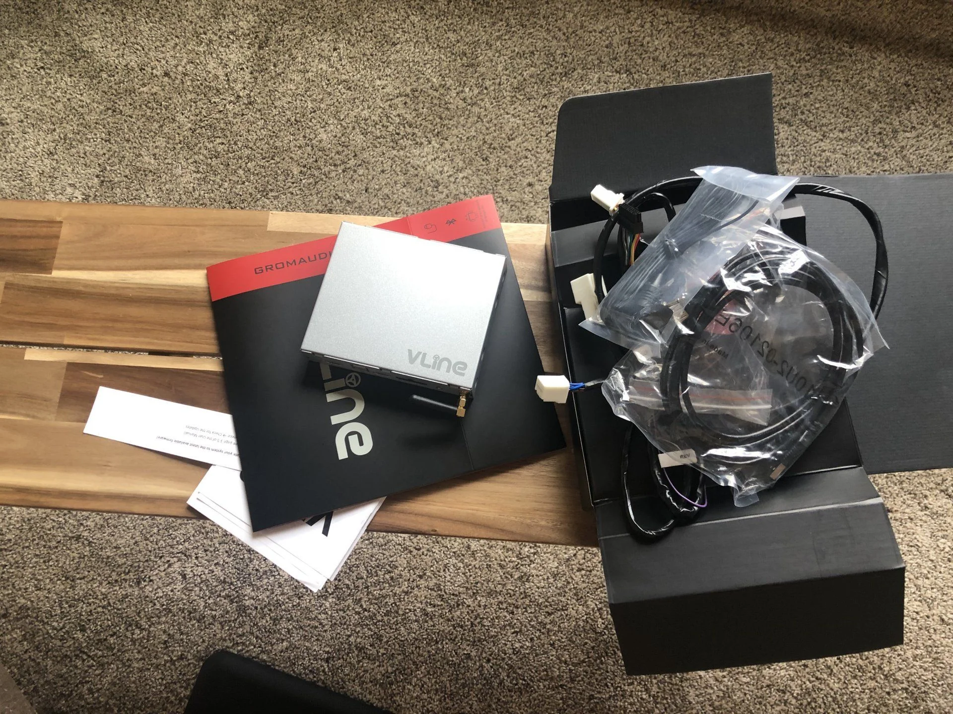

I made a video of my GROM Audio VL2 unit. I captured some thoughts below as well. Posting the video ASAP.
- I like it, it provides carplay to my 2004 GX 470
- The 2004 screen is really bad and its the worst part about the whole experience.
- Its pricy, but for the esoteric R&D grom has to do to get these to work, the price is fair.
- Group buys are the way to go when you buy one.
- Some people have issues in their cars for hard to diagnose reasons (usually video issues). In this case, they claim no questions asked returns which I have not tried, but in theory its a nice policy.
- Wireles Carplay works as well as it does in other systems (which is to say, not that well). Wired is the way to go.
- Installation is easy, but you will break some tabs on very expensive trim. They still will function the same.
